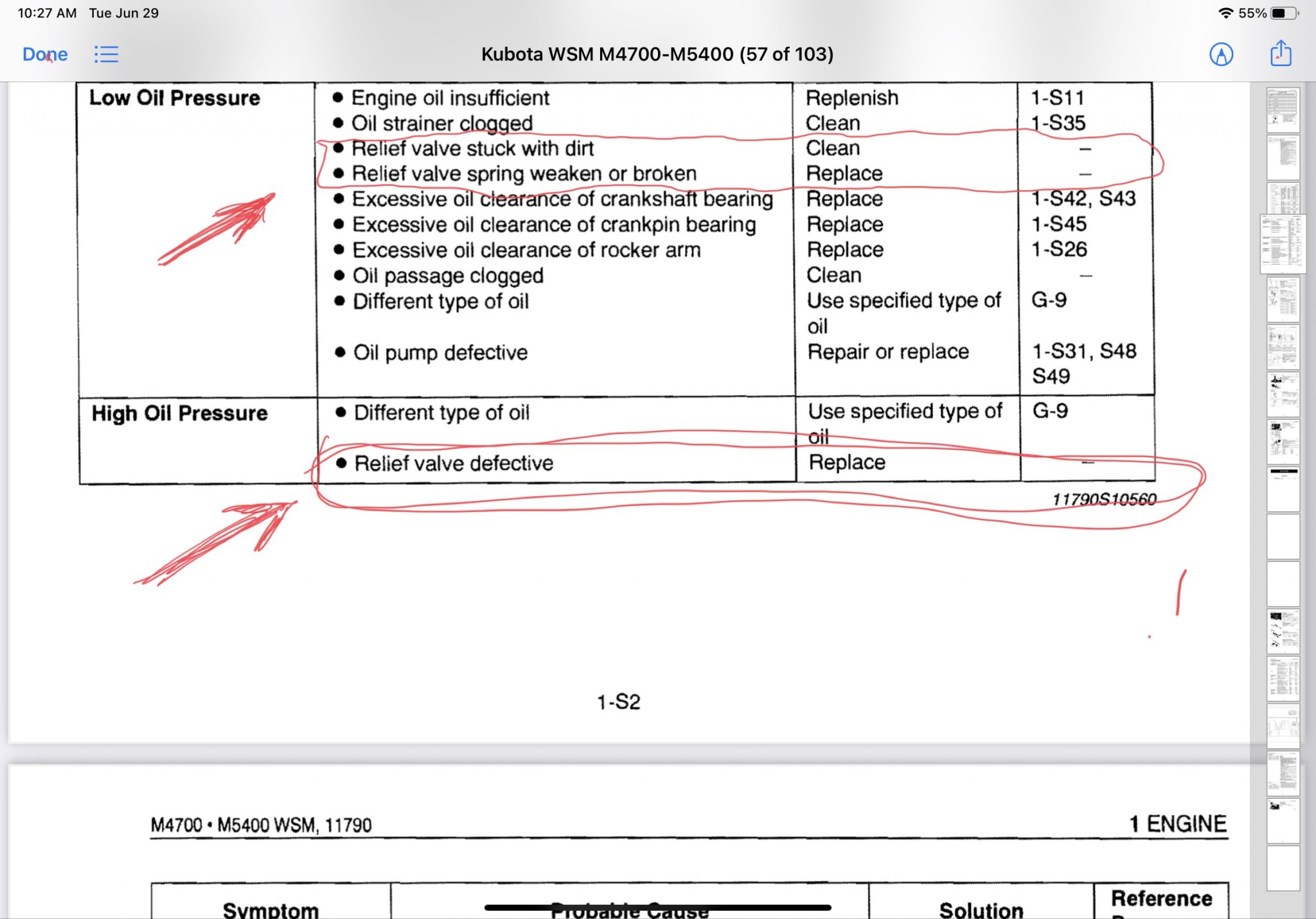

But just to support my comment… If one visits the WSM one will not likely find in the “Engine” section any references to the oil pressure relief valve which is incorporated into the engine design … and which is completely separate from any reliance upon an oil-filter bypass valve.
HOWEVER… if you reasearch engine overhaul comments… you WILL finally discover that the engine DOES INDEED have it’s own and separately replaceable oil over-pressure relief provision. In the event of High Oil Pressure the relief valve..NOT the filter … is to be replaced. In the case of Low Oil pressure the relief valve is to be cleaned or the relief valve spring is to be replaced.
Here’s a screen-shot of what is not mentioned in the Engine Section….but IS mentioned in the WSM oil pressure troubleshooting section.…despite the lack of instructional help on where and how to replace that valve which does indeed exist: (Notice that NO reference to the oil filter or its’ by-pass having any possible connection to the issue.)
