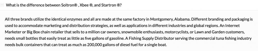

Want to know a little secret about Soltron? Read the below attachment from the soltron FAQ page.
