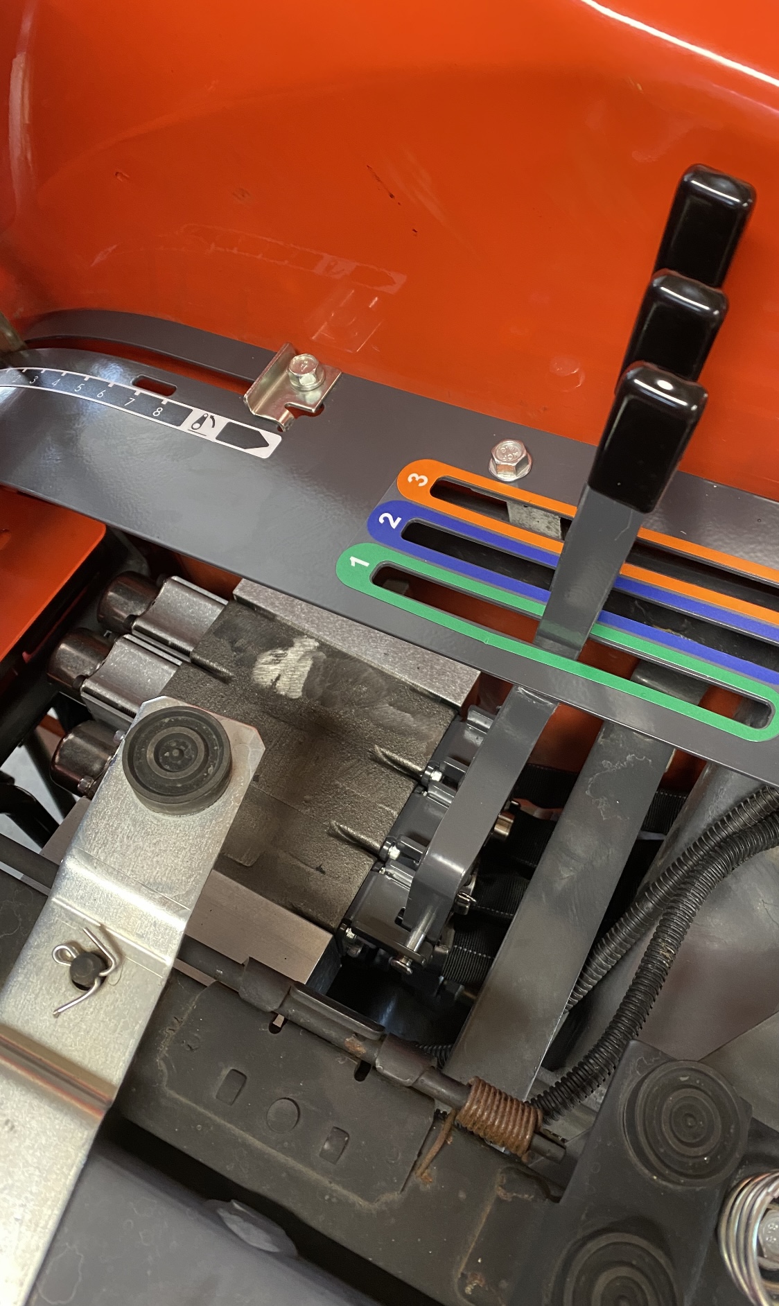

Well I got this done last week myself, after ordering in all the position kits, three valves, and the extra parts needed due to also having a backhoe. It wasn’t bad at all, even with having to take the rear tire and fender off to be able to slip that third valve over the studs for the stack assembly. I did just a little bit before work each morning and finished at the end of the week. Learned a good bit about properly making connections on each of the various types of fitting and hose connections and when I was done, there were no leaks and the system pressure was still at about 2450psi measured at the backhoe hose (last stop before heading back to the main hydraulic block at the PB port there).
Thanks. I really do like the cleanness of filling the three empty slots on the right side of the seat rather than getting creative with it. The way yours looks has me even more set on that.
I’m currently waiting on my dealer to source the parts and get back to me with a firm quote. Service manager said with the OEM valves they do sometimes have complaints of leak down while the engine is off. He said with the relief valve there’s no way around that but they don’t have complaints of leaking down while in operation. If the price runs up much over the $3k ballpark I’ll check on how much is labor and consider doing it myself. I wouldn’t mind paying $500 or so for labor but if it’s much more than that, I’ll probably pare the order down to just parts. Even if I have to wait a while, I’m pretty set on getting it done one way or another.
They quoted me $350 labor to do two valves but ultimately I decided to do it myself, and add a third one as well.
