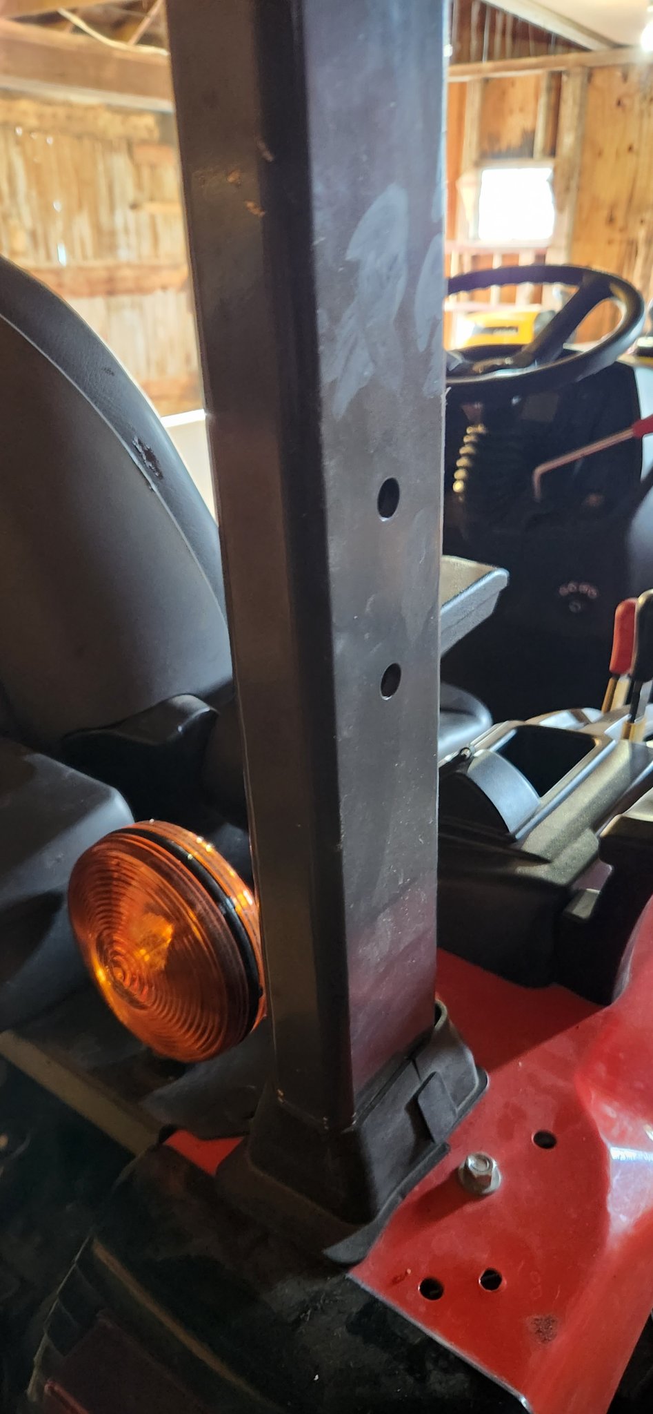

I have a couple of holes in the fender I was thinking of mounting the light and switch to, or maybe on the the side of the rops.

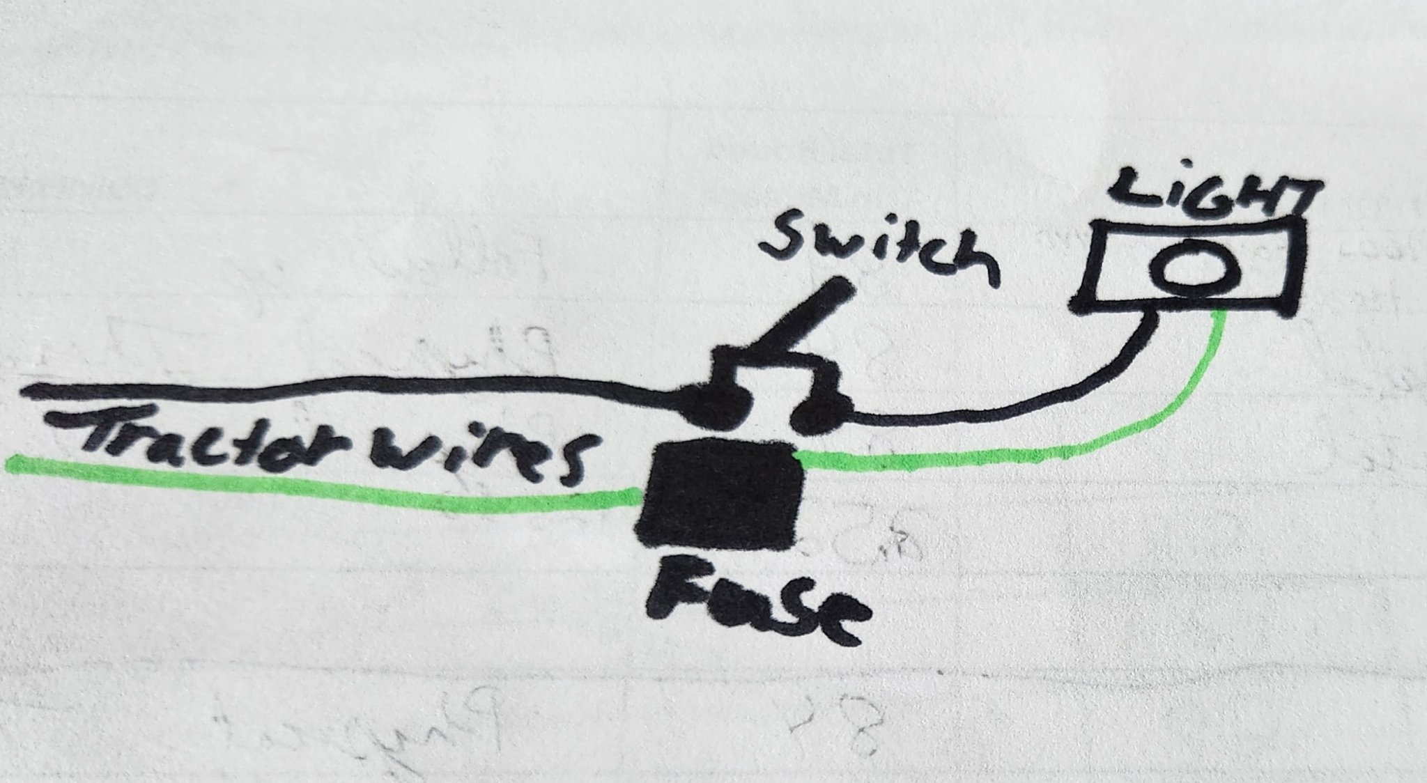

But I can hook 1 tractor wire to a switch and the switch to 1 light wire, then the other tractor wire to a fuse( for extra protection) and the fuse to the other light wire. Correct?
You're all open to laugh at the drawing.

It looks like the lights you have shown us draw about 4 amps. I believe that the circuit you would use is rated for 10 amps, so you should be OK

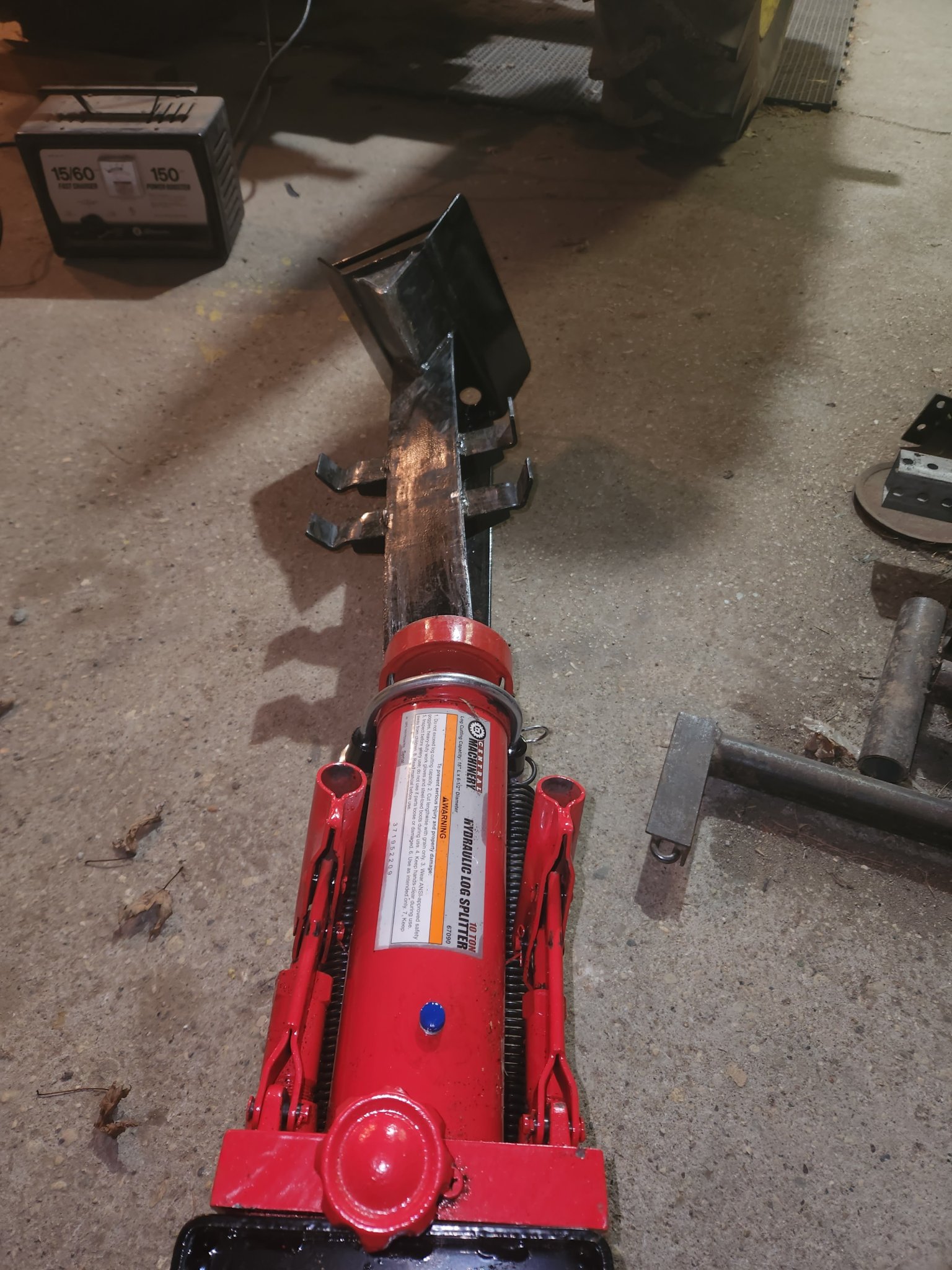

I'm sure there could be a whole discussion on HF stuff. I bought an 8hp pull start Honda clone engine there and love it. I bought a manual log splitter and lasted 3 hours....... 20221127_170146.jpg
No issue returning it and took that money and got fiskars maul. Night and day difference between a basic maul and that. Truly one swing.

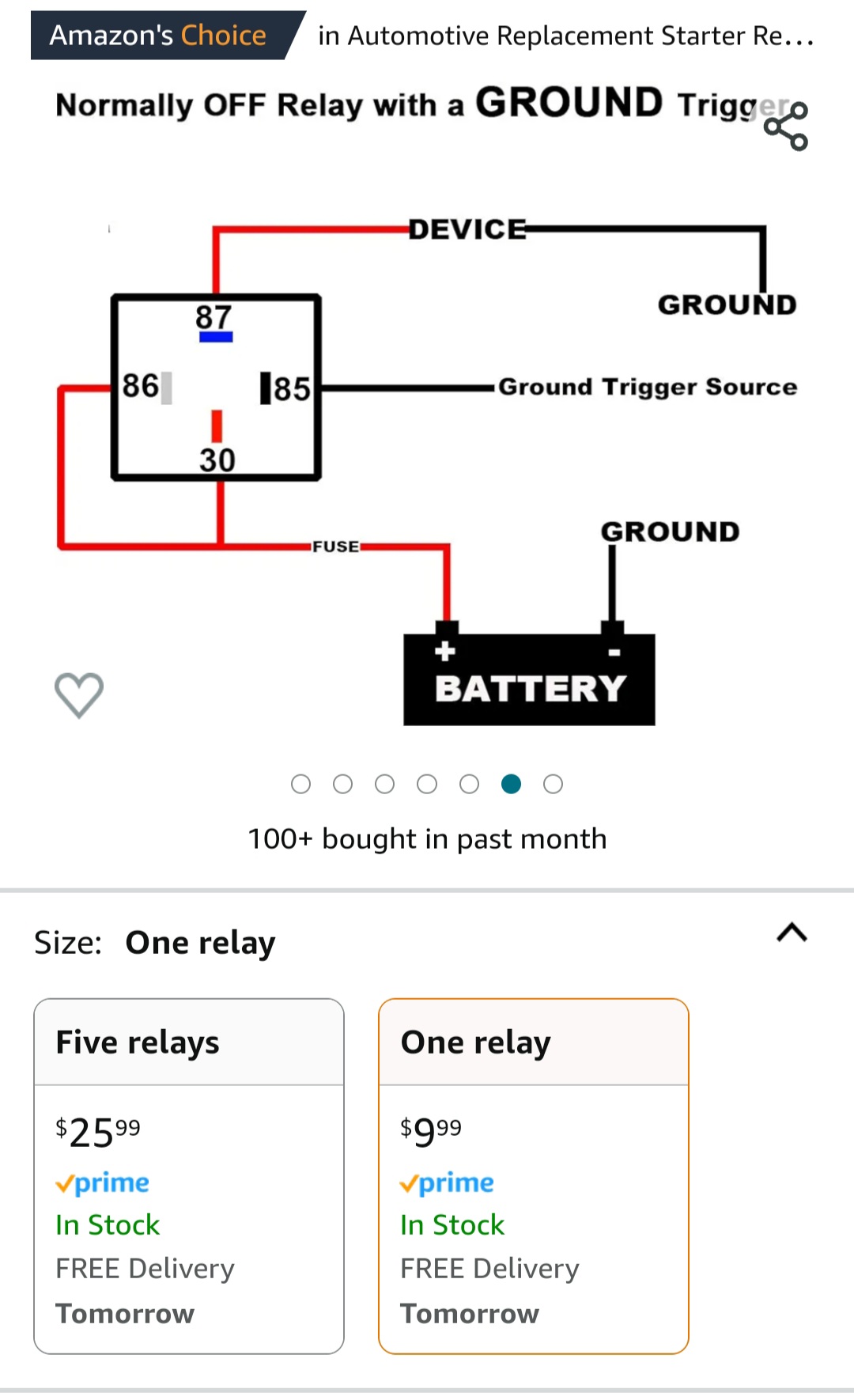

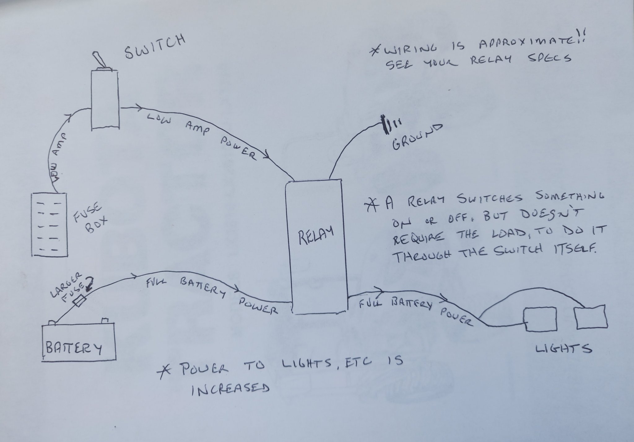

I would suggest that you use a relay.
You'll get WAY more power to the light(s) and take a load off of your fuse box.
In the OP's original post, the power to operate the lights goes through the fuse box and switch.
With a relay, the power to operate the lights comes direct from the battery and puts out as much power as the wire guage you use and the batteries capability. The switch wire only tells the relay to turn on or off, and at low amps.
Sorry for my chicken scratch, I've got the flu today...

They are cheap. I use them for lights and lockers and such on my Jeeps, trucks and tractors.
This one's wired different than my chicken scratch drawing. (Ground switch based) But I hope you get the idea.

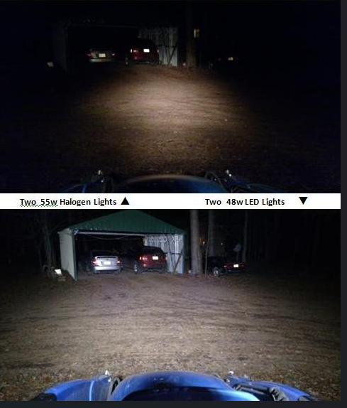

I wouldn't cut the wires. Just buy matching plug ends for your system. Here are the type of lights I bought, and the difference from 55w halogens.

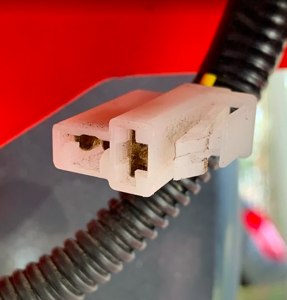

This is the type of plug that matched my New Holland.

Take a picture of it and take it to an auto parts store, or do google lens. (or post a picture of it on this thread)

I thought you found one for your Kubota. Lots of people ask, so I was interested where you found it. It's been the source of numerous threads.
It was faster to pin a water tight automotive connector it than it was to go to the parts store. Searches yielded nothing useful. Lots that looked similar, but no measurements.
