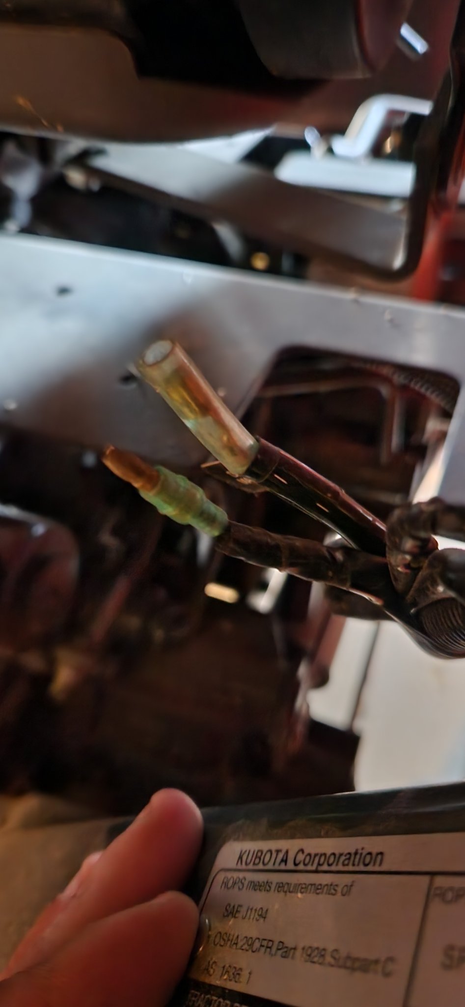

There is one advantage to running halogens over LEDs for winter work. As mentioned above, halogens will create a lot of heat. The snow will melt off of the lamp. I haven't used mine in winter yet, but other lighting posts (I believe here on OTT) complain that LEDs in the front headlights won't melt the snow off of the plastic housing.

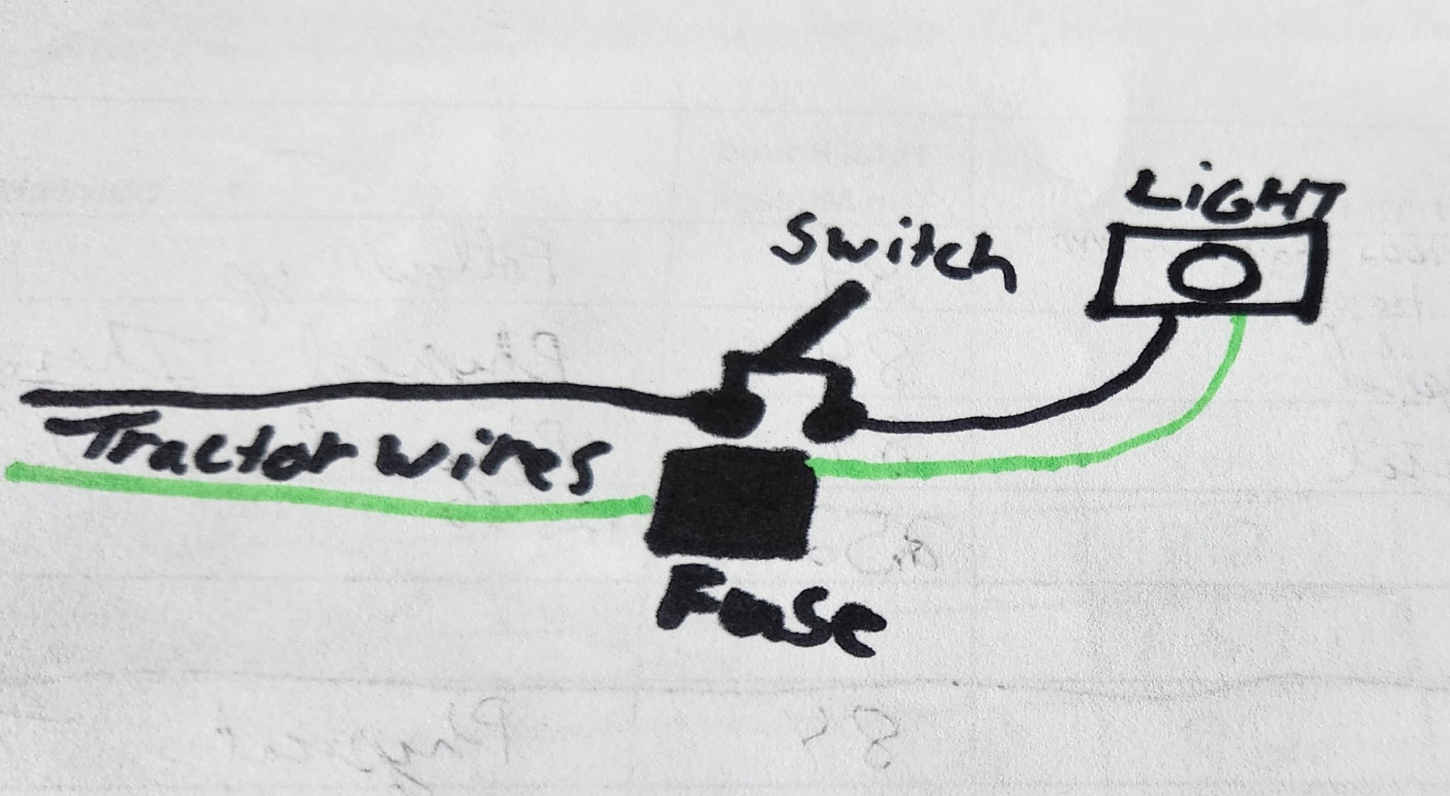

As for wiring, I'll second what others have said above. The connector you located should already be fused for a 5A work light. You can buy the bullet connectors so you won't have to cut the existing connectors on the tractor. Add a weatherproof switch on the positive lead between the bullet connector and your light. Don't forget the heat-shrink tubing and split loom to protect the wires. Lastly, crack open a cold one and bask in the glory of a job well done!

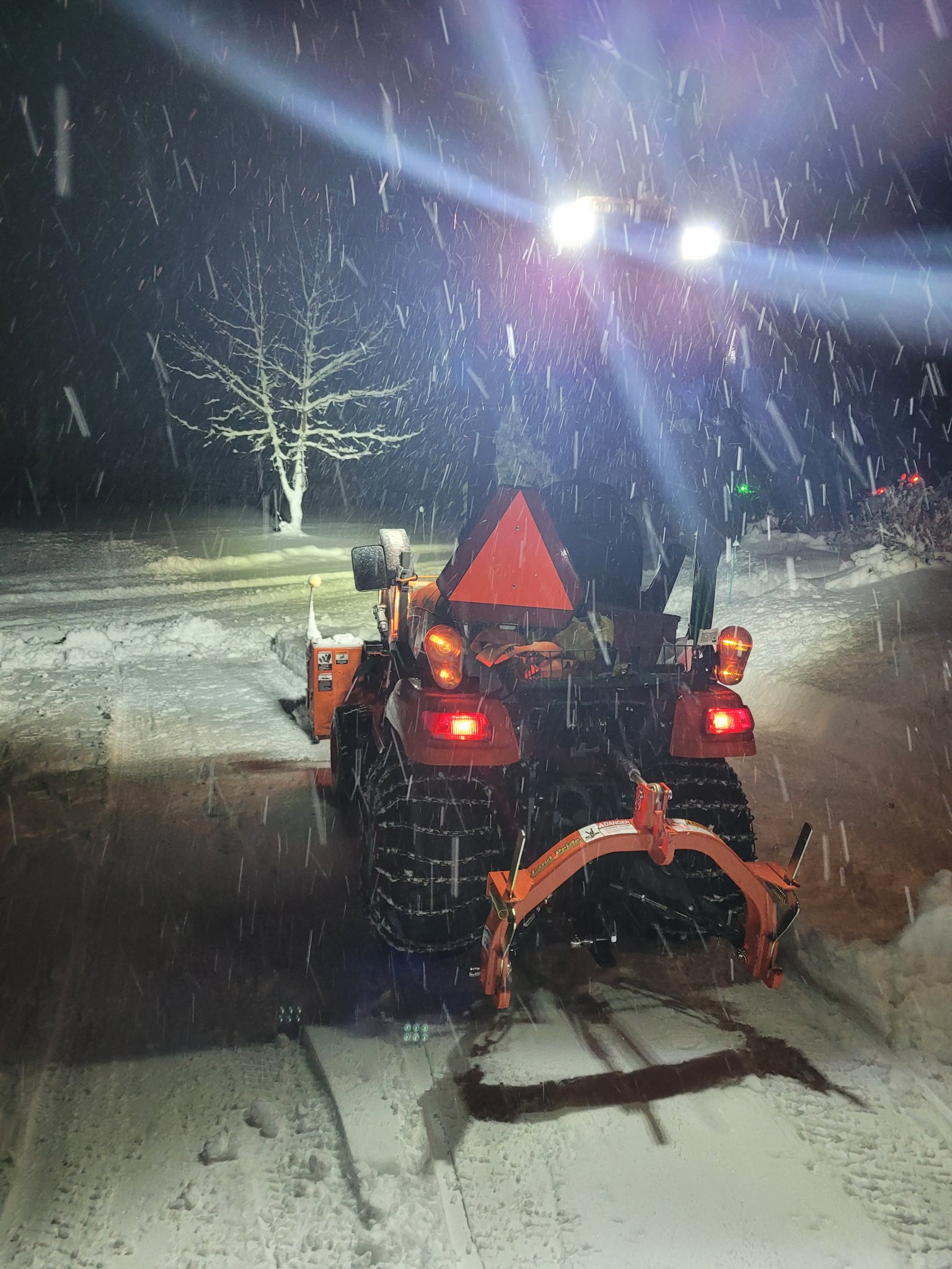

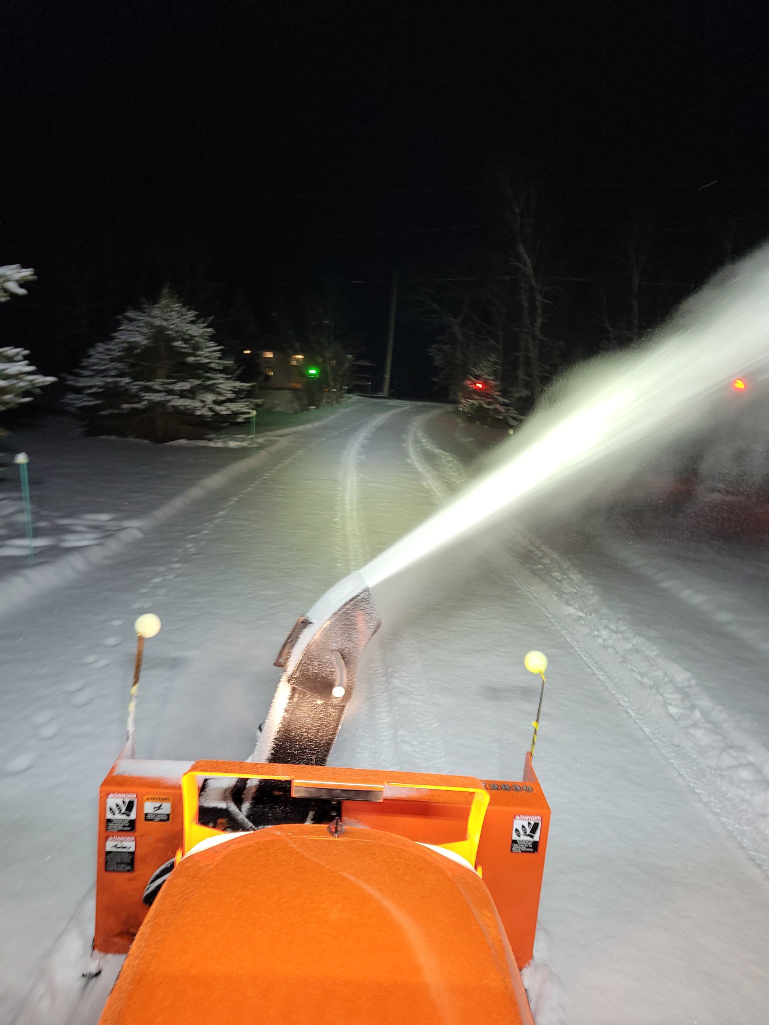

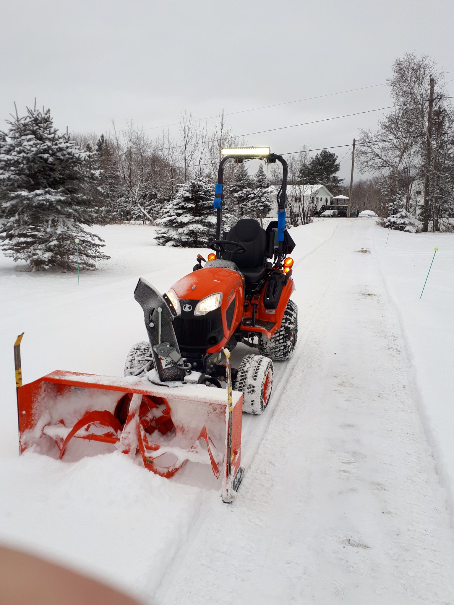

The difference is night and day (pun intended) between the regular lights and when I turn on the LED rops lights. In my case I am snowblowing, not plowing, but I'll assume it's even HARDER to see with a big bucket out in front of you, raising it up/down.
I spent MAYBE $100 on Amazon for a big LED light bar (facing forward) a couple floods facing more-or-less backwards (slight angle) and a strobey-dooey (not shown in these pix) for when I am near the road or have to cross it to help out a neighbour.
Best $100 I ever spent on lighting, hands down. Night time here in the country it's as dark as the inside of a cow...no street lighting and far enough from houses not to get really anything in the way of porch lighting illuminating the driveway. You can see it looks like daytime in my driveway.
Watched my neighbour struggle for a decade with an old International with 2 piss weak bulbs facing 1 fwd and 1 backwards and he ran into stuff all the time. Even ran the machine into the ditch once and had to yank him out with the LAnd Rover.
My advice: Spend the $50--$100 so you can see where you're going. You spent $30k or whatever on a beautiful machine. Protect it and yourself and the belongings in the yard at night, in the winter.

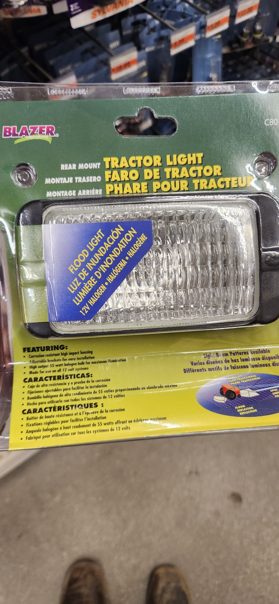

I have an lx2610 open station I'm going to plow snow with using the front loader and a rear blade. As of right now I'm going to try with the front lights or atleast led bulbs this season and then maybe next year upgrade more.
I'd like a single rear light to see backing up and the rear light. Growing up that's what most of our tractors had and I don't need to light up the countryside.
I found this light that'd seem to match or blend in with the tractor.
I found 2 wires under the right fender that are hot when the key is on .
I hate to snip the ends off of a brand new tractor.......and I'm sure it could be used against me on any warranty but clean secure wiring is my pet peeve and know I can make it look clean and work.

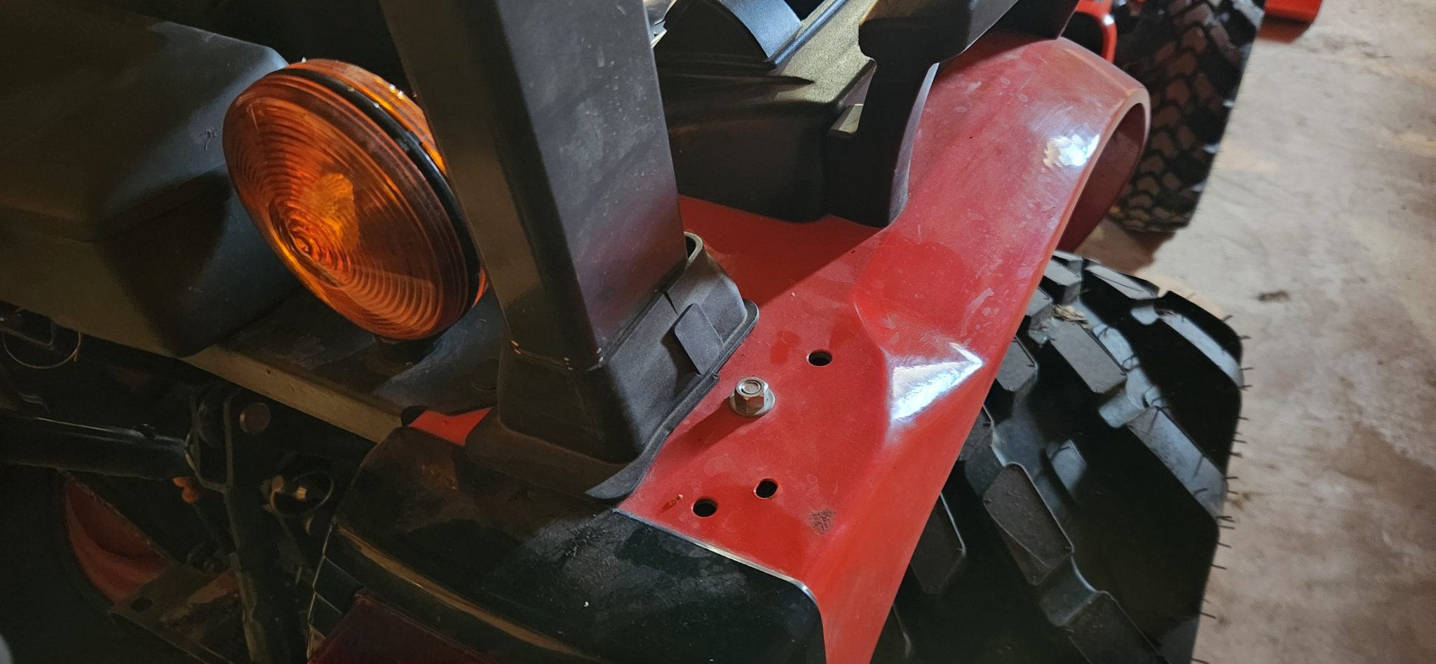

I have a couple of holes in the fender I was thinking of mounting the light and switch to, or maybe on the the side of the rops.

But I can hook 1 tractor wire to a switch and the switch to 1 light wire, then the other tractor wire to a fuse( for extra protection) and the fuse to the other light wire. Correct?
You're all open to laugh at the drawing.

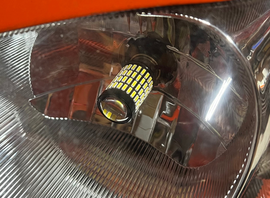

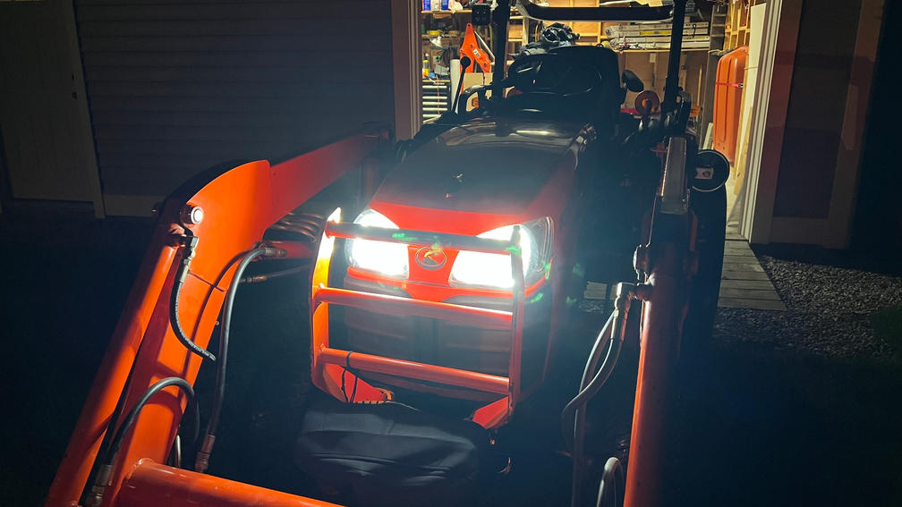

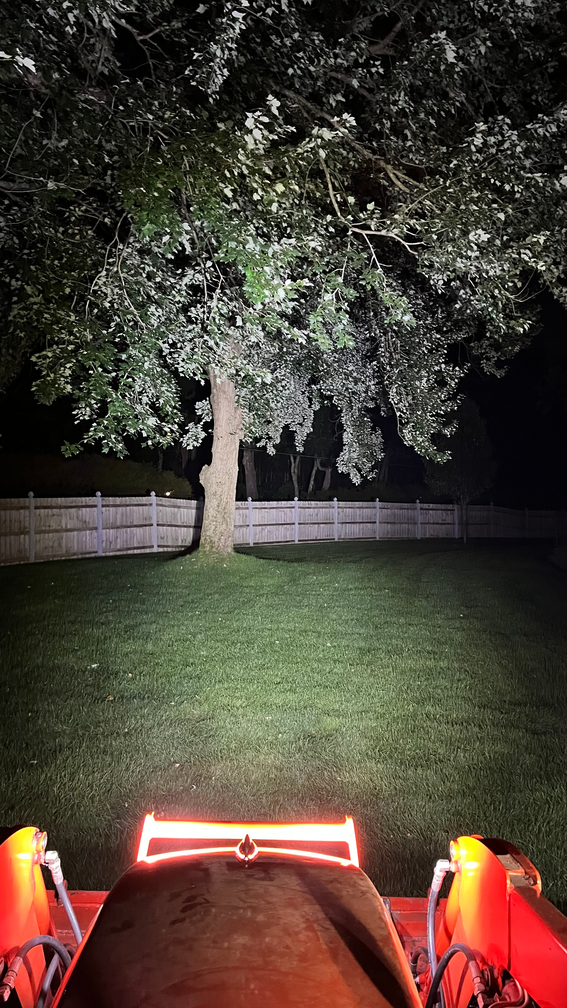

I just installed these LED headlight bulbs and really happy with them.
I also installed a magnetic mount LED Spot and used this Wiring Harness.
I tapped into the work light wiring under the right tail light. I cut the connectors, soldered them and used heat shrink tubing with the harness. I also mounted the relay up under there as well. Ran the switch back to the dash.
Head lights AND LED spot on ROPS...
GrizBota
Apr 26, 2023
1,147
733
Oregon
Wow. Those OEM replacements seem to be a huge improvement.
06B3030
Sep 21, 2015
170
233
MA
OOPS...the picture at the bottom was with the LED head lights AND the LED spot on the ROPS.
The LEDs in the head lights did make a big difference by themselves.
Well now, that explains why I was a bit surprised at how well they worked.

The rear work light circuit is fused at 20A in my tractor (B3030). It should be called out in the Owners Manual...

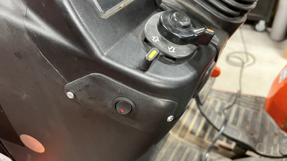

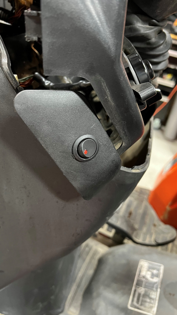

It was very nicely made. There were some comments about the switch quality, but I think it's fine!
It fit nicely in a "snap-in" panel I had on the side of the dash. Better than drilling a hole in the dash panel itself. I just have to paint another set of screws black.
That looks sharp. I was thinking of a box or side panel so I wouldn't have to drill into the dash and could be removed if I wanted to.

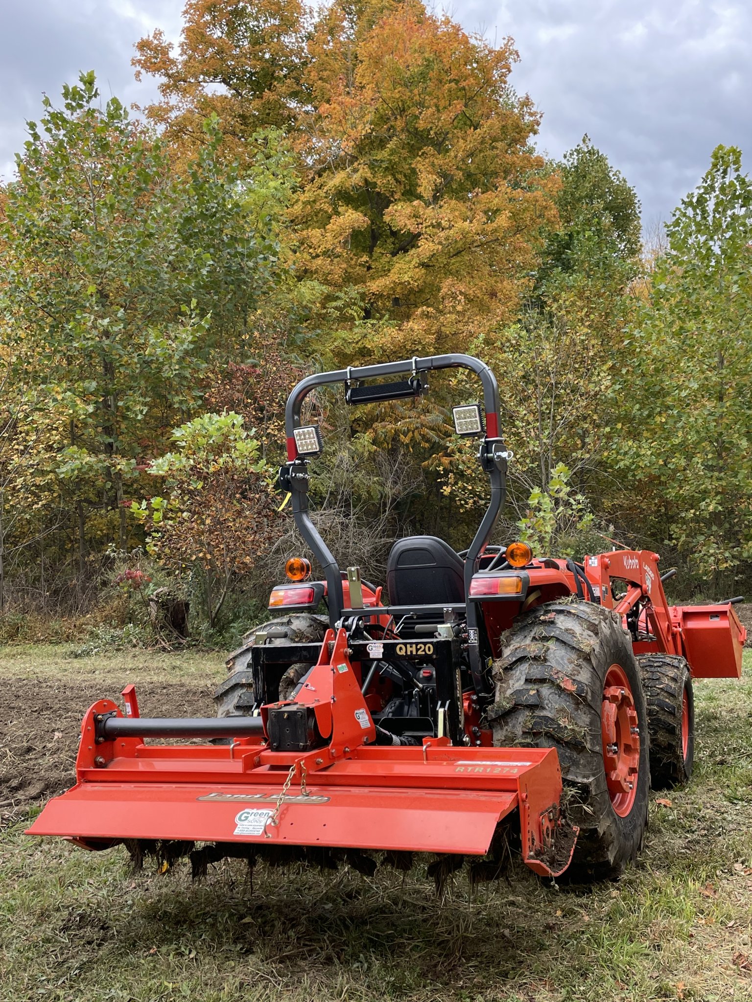

I have a light bar (aimed forward) on the underside of the top cross of the rops and two smaller lights for behind on one of my machines. I did it this way thinking I could angle one of the lights down to the implement and PTO area and still have one so I can see further back. The combination works very well (it’s nice if want to hook up or un-hook in the dark) as well as if loading on a trailer at night…I even use when backing down the lane at night if tractor is on the trailer), however I am contemplating a canopy and I worry the light bar will have some shadow effect from a canopy. If and when I get out of the analysis paralysis I may have to switch or move the configuration. I guess my point is if thinking anbout a canopy I’d think about that when mounting the lights. Eventually I’ll add them to my B as well. They are super helpful and I suspect it if prevents me from hitting something it was money well spent.
That's why I mounted it there...if the switch was to fail...it would be an easy fix!!!! :cool:
Thanks for the extra info. A canopy crossed my mind but at the moment need to fold down the rops from time to time.

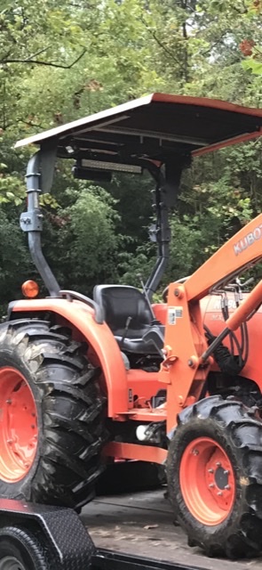

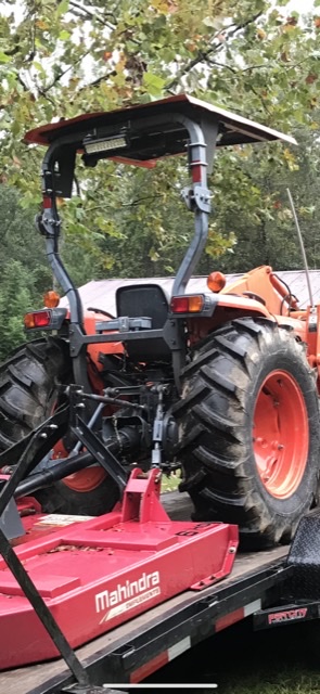

I’ll add older picture of mine with a canopy.
I have mine setup through a main auxiliary fuse block mounted under the dash. Its a 20” light bar facing forward, 12” facing rearward and two cube led lights on each side.
Single double pole double throw switch is mounted on the dash for the lights and separate push button switch for the overhead fan. Wiring runs up the left side of the ROPS, leave enough slack in the wires at the pivot point to fold the ROPS down as needed. No issues with shadows from the canopy.
