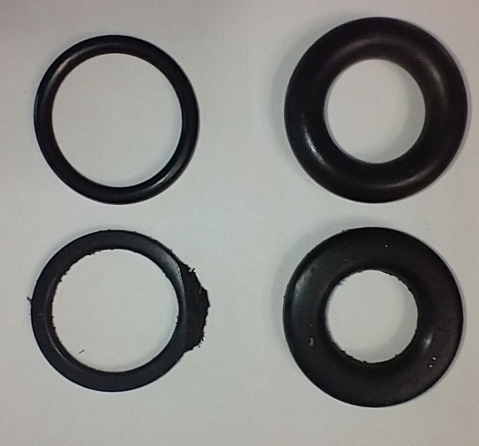

I GOT IT!! I was able to get some vise-grips in there and clamped them onto the sleeve and held them and worked the lever(120) back and forth until it finally started to move a bit. Slowly it started to move a little and then more and more! Finally it came free!!! Here are the o-rings that were in there and the new ones that are going in. I thought that they were the cause of the leak and now I am pretty sure. Flat crushed and stiff. I guess we will know when I get it cleaned up and put back together!

Wow! The difference is unreal! Almost to the point that I would wonder if the replacements are the correct ones.
Just my initial impression as a novice with little o ring knowledge.
They are Kubota O Rings ordered from Messick's. Correct part numbers on packages so I am gonna assume they are. They are the same diameter but the old ones are flat and these are still round.
7,520
2,555
New ones on top, old ones below, I think. I was kinda confused myself for a minute.
