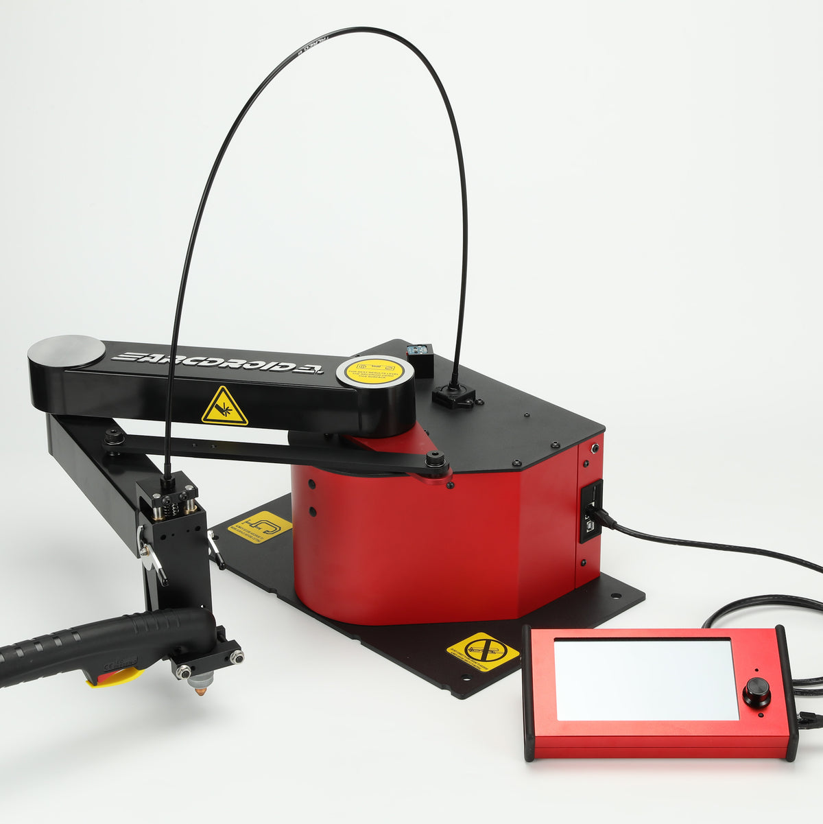

Looks good. Same thing I said before building a CNC table. I saw this a while back and wonder how good it would work.
I've watched a couple of videos of these and they look pretty good. I think if I was going to spend that much is probably also build a CNC table too. I haven't really looked at this seriously yet, and I'm most definitely open to suggestions.
