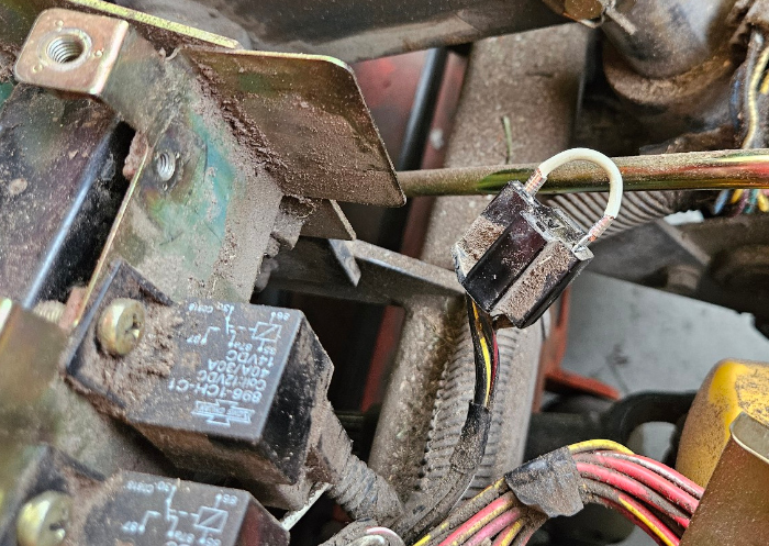

I jumped the relay, and the mower runs like a dream. Well, it did on the right tank. Looks like the left tank has some diesel cheese in it somewhere. Maybe the original owner treated it like a one-tank mower and rarely emptied the left tank.
I made a jumper for the relay and then wrapped it in electrical tape.
Someone recommended Clear-Diesel, so I put some in each tank. Maybe the left tank will clear up. I don't look forward to draining 5 gallons of diesel and finding a home for it.
The fuel filters are just fine. If they weren't, the mower wouldn't run well on either tank. I may change them anyway once I get the electrical problems fixed for good.
The mower looks nasty in the photo. It was a lot cleaner before it met this dusty yard.
As for 555 timers, I have some somewhere.
I think I've found the ECM ground, but I didn't feel like wrestling with it today.
There is no good reason to touch the starter system until daytime temperatures go below 75, so apart from putting in the new relays I ordered, I will try to leave it alone.

Wrt to the NC brake switch... is that really open when the brake is applied? I believe the NC refers to the switch lying open outside the tractor. For a safety function I would imagine the switch closed being safe (brake applied). So is it possible that it is mounted mechanically to be open when brake is open?

It's a different part from the lever switches. You can see it in the schematic.
Yes, I know it's a different part. What I meant was that I cannot believe that it is open when brake applied. I think it is closed when brake applied.
The schematic shows the switches in the normal position, and only the brake switch is closed.

When I described the purpose of the controller, I completely forgot the third function. It runs the horn that goes off when the mower overheats. The mower has a perfectly good temperature gauge on the control panel, though.
Interesting thing: my L3710 is a more complex machine than the ZD326. It has HST, 4-wheel-drive, two PTO's, and more hydraulics, but it runs fine with no ECM.
