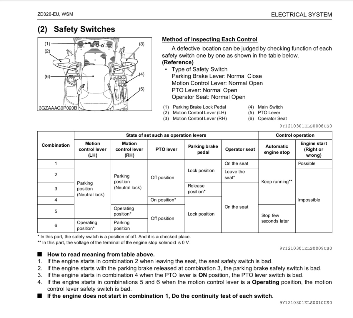

I was tired, so I put off coming up with a new plan for putting safety switches back in the loop. It appears to be astonishingly easy. Someone tell me if I'm wrong.
The controller has a receptacle and plug. All the safety switches go into this connection, as does the RW wire that carries hot to the starter.
All the safety switches (arms, seat, PTO) I care about are NO, and I could convert the brake switch to NO just by installing a different switch (same part as the arms and PTO, already in my shop) that fits perfectly. This gives me a whole bunch of NO switches in series.
It should be simple to wire them in series with RW, right at the connection, with tiny jumpers or a modified plug. If I do that, if any one of them fails to close, no start. If this is correct, Kubota's decision to run all these switches through the $340 controller is more mysterious than ever.

The brake switch has both contacts, NO and NC according to schematics. I still do not believe switch being open when brake applied.

"Normal close" in the manual means it's closed when it will not let the mower start. Normal is when you sit in a stubborn mower and curse at it.
I do not think this is the way NO and NC contact descriptions on spring loaded switches work.
When the Park Brake is engaged, the ZD300 series mowers do not depress the actuator button on the safety switch. Only when the Park Brake is released does the safety switch button get depressed.
The Park Brake safety switch is a closed circuit with the Park Brake engaged and an open circuit with the Park Brake disengaged.
Thank you very much, that confirms what I suspected and also explains the NC contact use.
