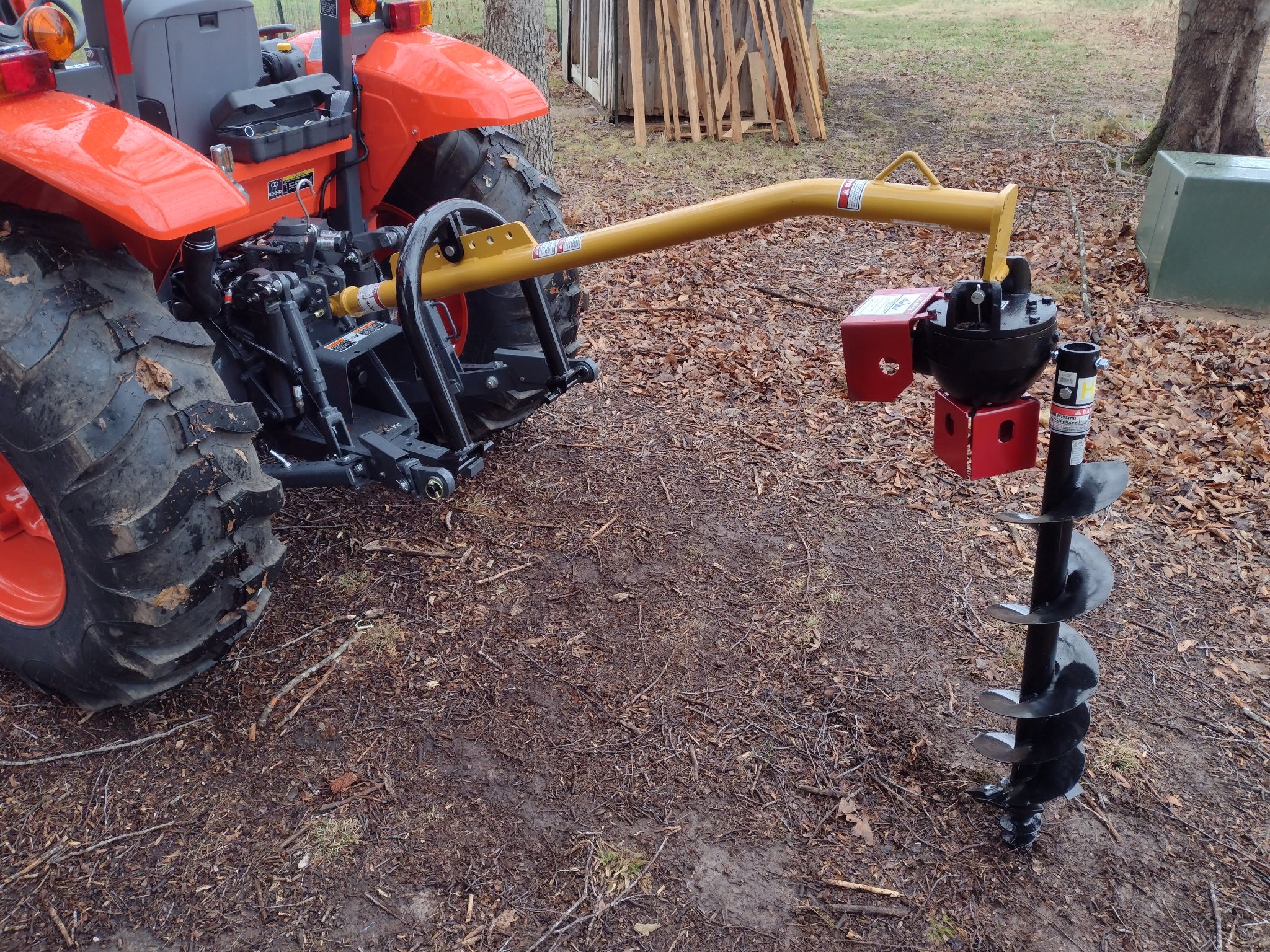

Move to lowest hole on tractor AND move top bolt on auger frame as far towards business end of auger - even if you have to lift auger (minus flights) by hand.

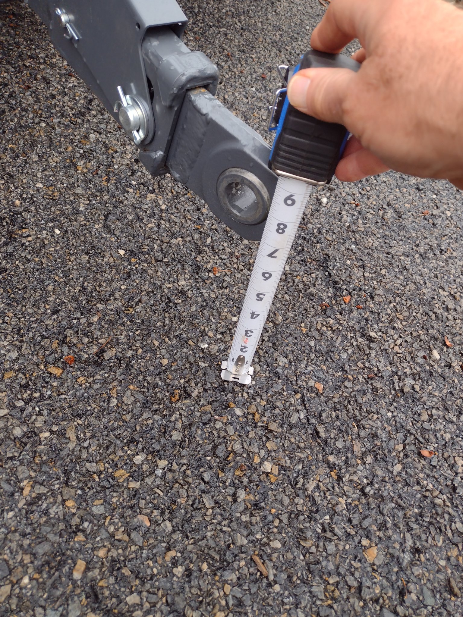

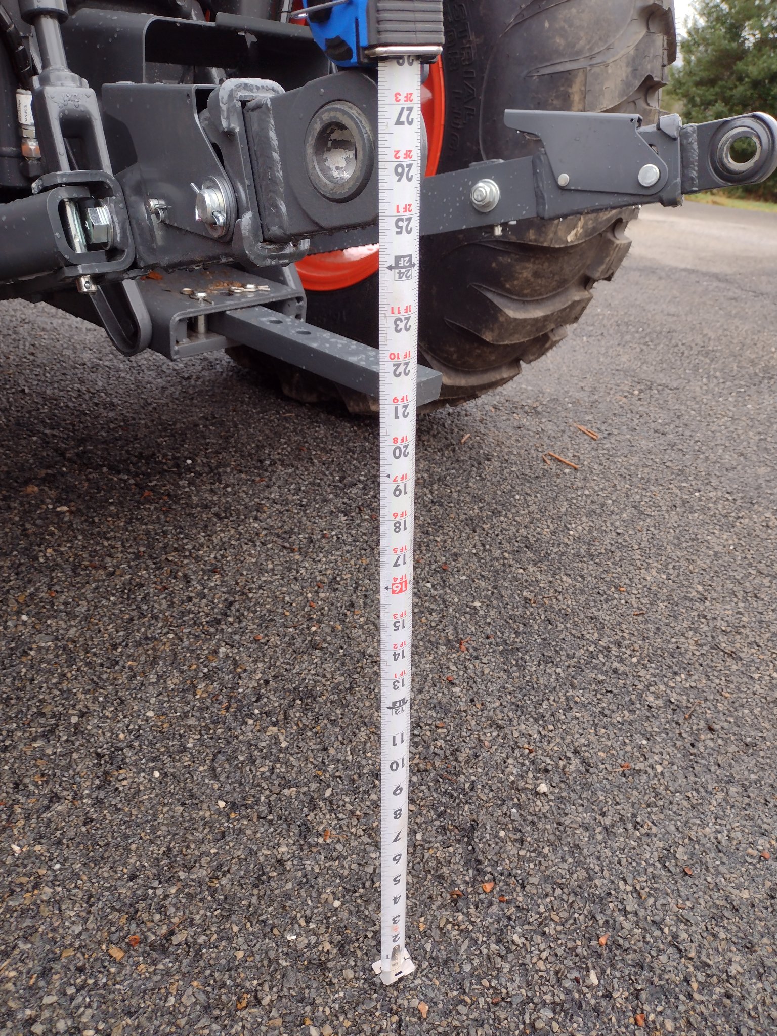

I would be curious if your max/min height is same as mine as shown below with no attachment 26 max - 8 min

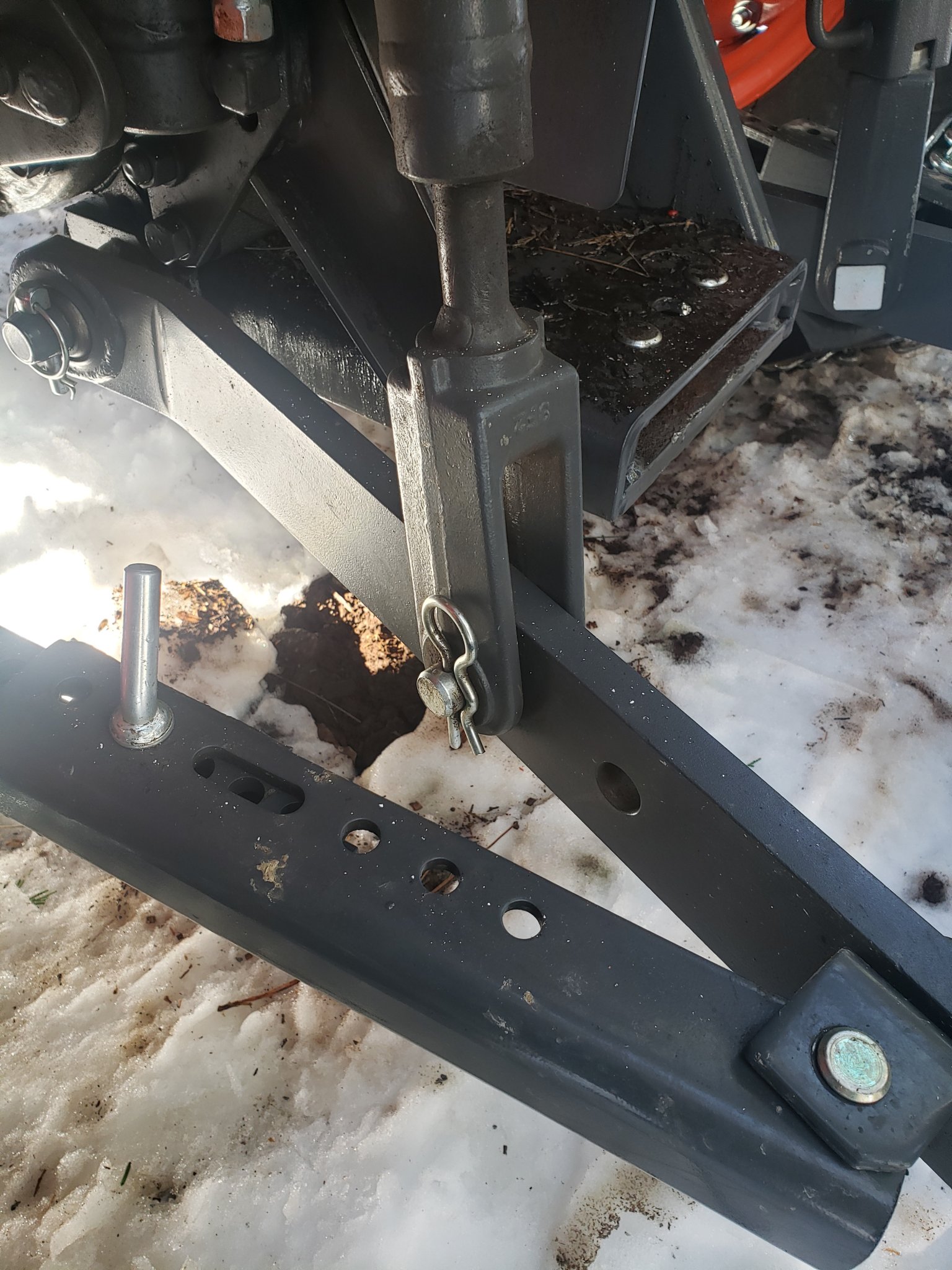

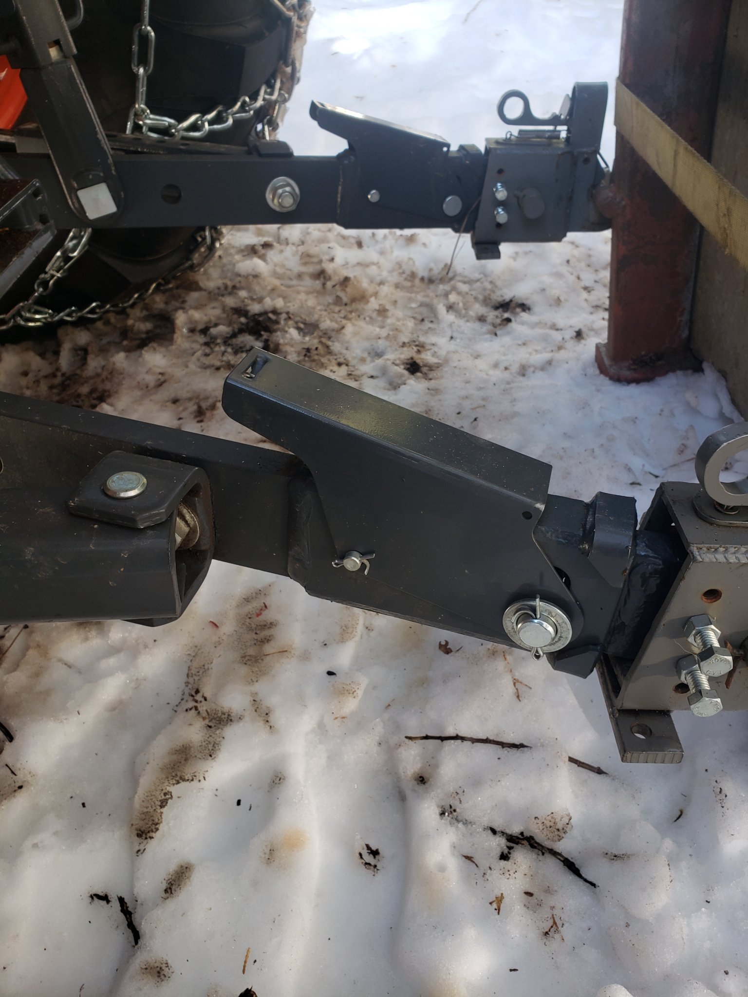

Tha cylinders move the vertical lift rods which are attached to the lift arms. Move the bottom of the lift rods (#1) to the furthest out hole in the lift arms. Than release the lever on the end of the lift arms (#2) and slide the end of the lift arm out to its max extended position.
View attachment 72669 View attachment 72670
it's and has been in the furtherest out hole and the extension to aid hooking up only has one "locked" position at it's shortest configuration
From this pick you have the top auger link in the wrong hole.
1. Move it to the lowest one on the tractor. (There are 3 holes shown). If you need to detach the lower links temporarily to do this go ahead. If you need to remove the auger motor (and you can) to lighten it up go ahead. You can see if this gives you the clearance. If not do #2 below as well.
2. Your Auger has 6 holes for adjustments on the boom arm, you are currently in the middle hole. You can gain more angle by moving it to the hole closest to the tractor.
3. Now adjust your bottom links to merry with the lower auger pins. The only limitation here would be if they wont shorten enough after doing #1 and #2. However hopefully they will.

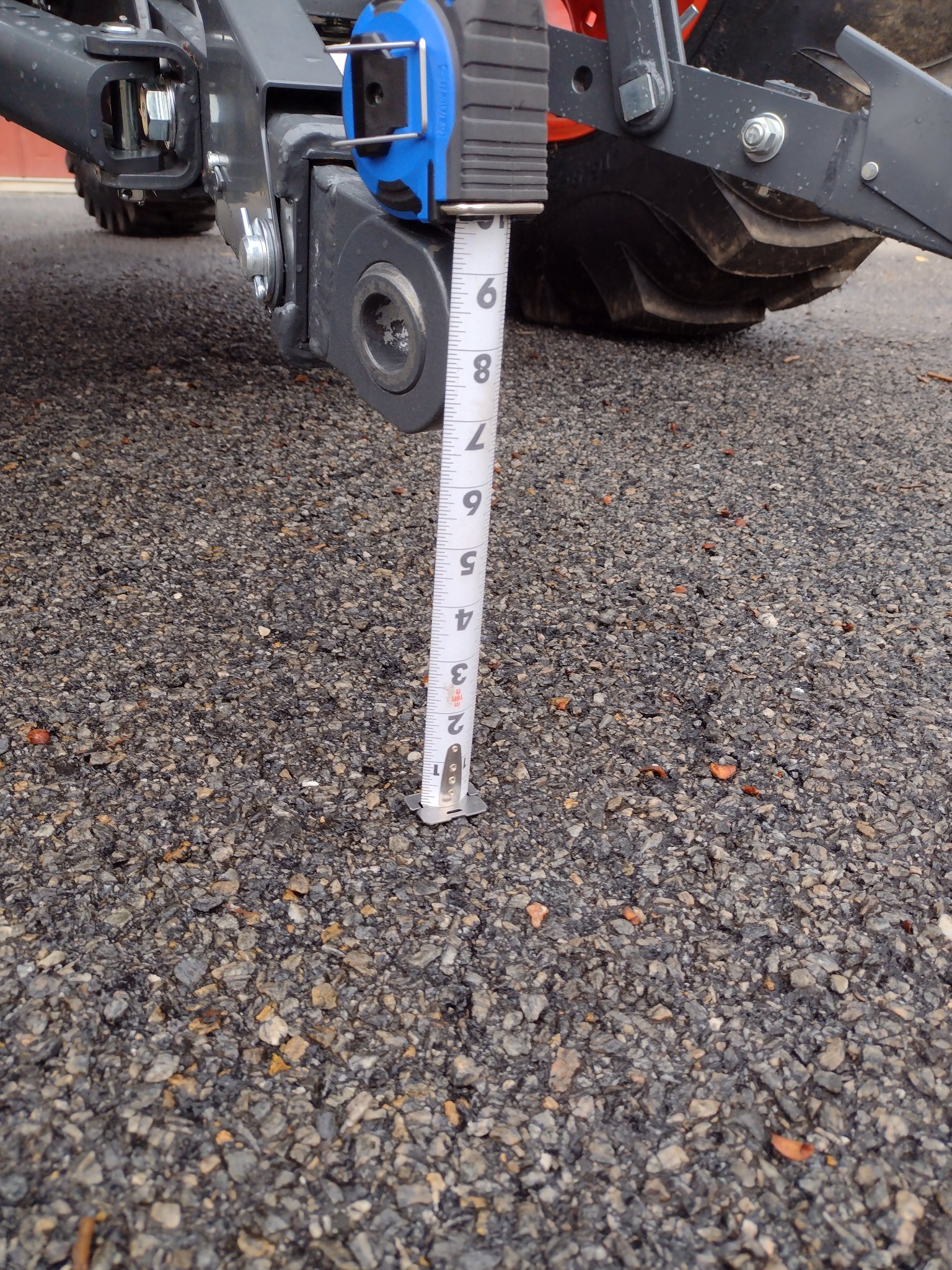

Retried it all and the middle hole actually has it the highest point as past vertical support angle change causes it to lower ... Gained a bit but still way off.

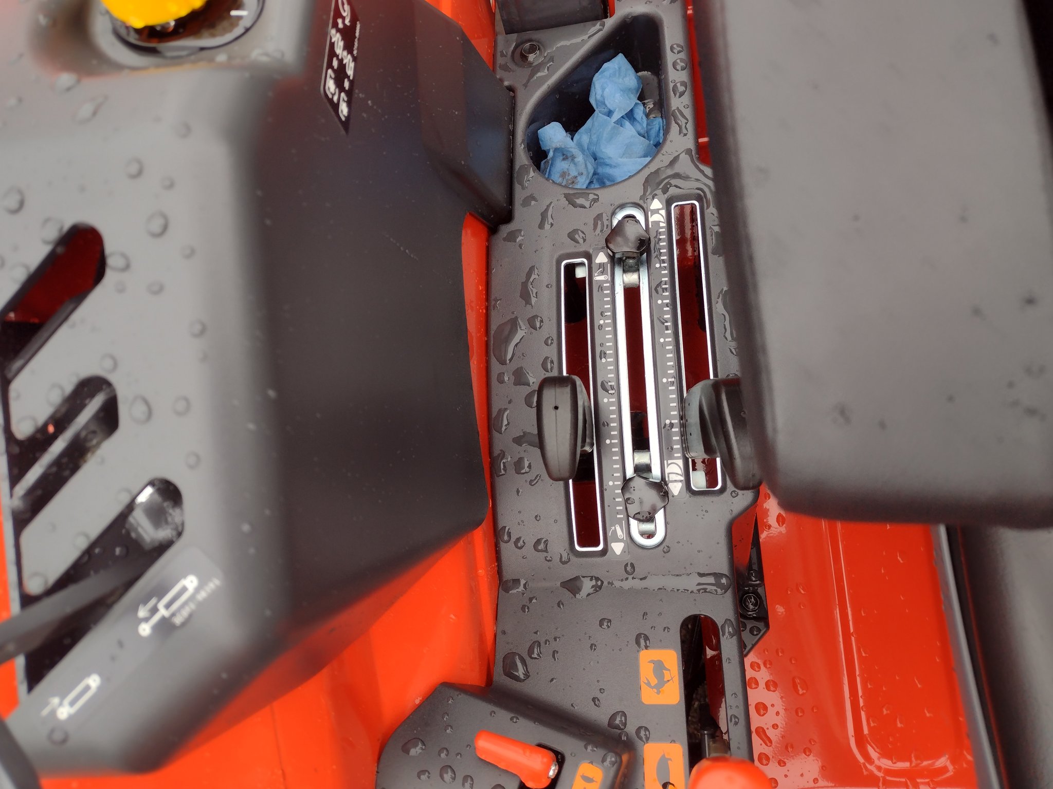

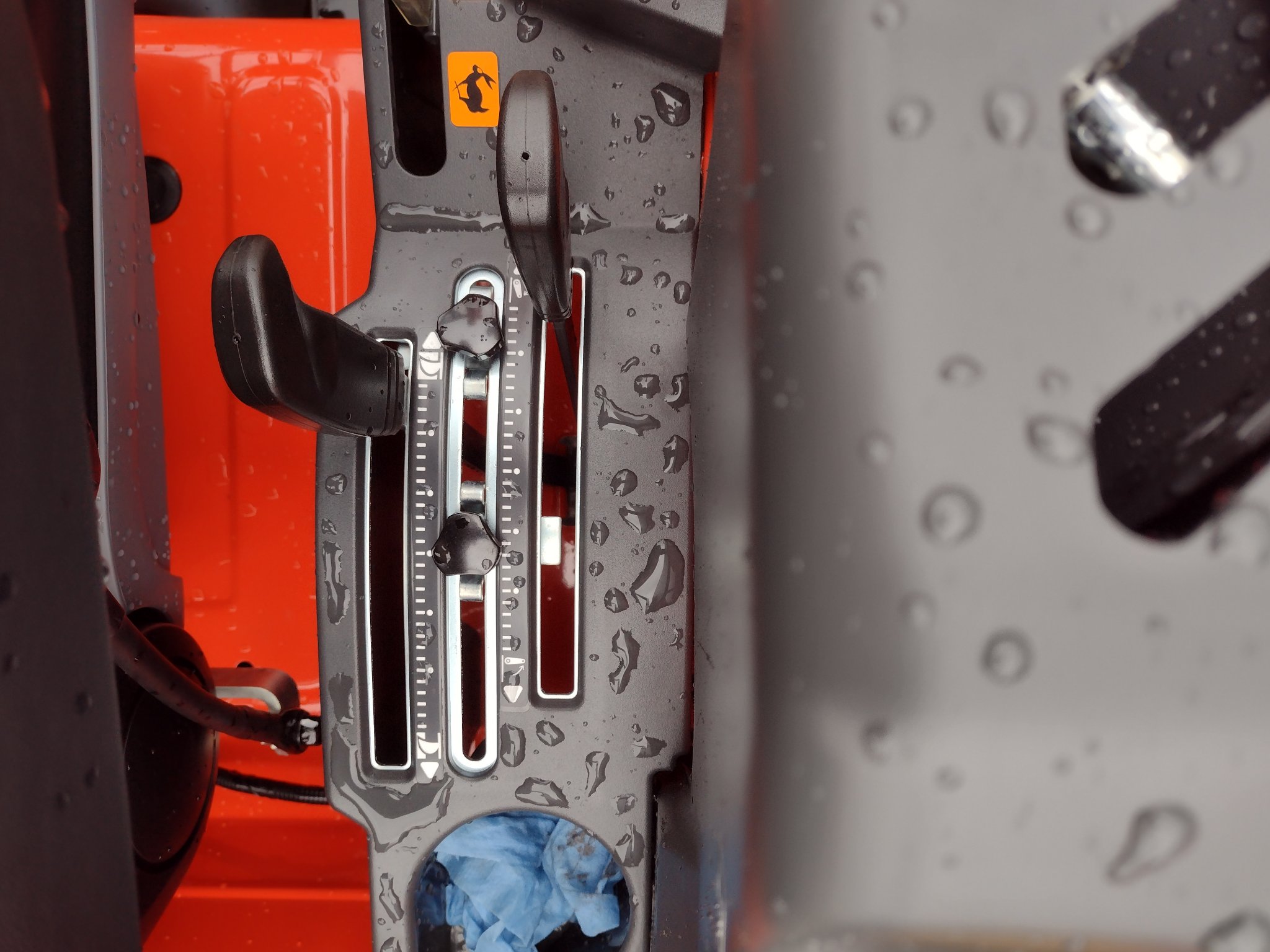

that said I noticed that from the lowest level I have to raise the control lever past about 1/3 to get the arms to move at all ... I am starting to think the control lever linkage needs to get shortened as I am not getting a full throw on the lever. In other words I am only getting about 2/3 of movement and there is some left but the lever has no more room to move ... It's 8 inches off the deck at lowest lever point AND at the 1/3 point. Anyway that's my working theory at this time but since it's only 3 days old I will talk to my dealer before I start adjusting it ... appreciate you helping me think through it all.
View attachment 72673 that said I noticed that from the lowest level I have to raise the control lever past about 1/3 to get the arms to move at all ... I am starting to think the control lever linkage needs to get shortened as I am not getting a full throw on the lever. In other words I am only getting about 2/3 of movement and there is some left but the lever has no more room to move ... It's 8 inches off the deck at lowest lever point AND at the 1/3 point. Anyway that's my working theory at this time but since it's only 3 days old I will talk to my dealer before I start adjusting it ... appreciate you helping me think through it all. View attachment 72673 View attachment 72674 View attachment 72675 View attachment 72676 View attachment 72677
Yes I think you have it now. control lever linkage adjustment. PM me and I can send you the WSM.

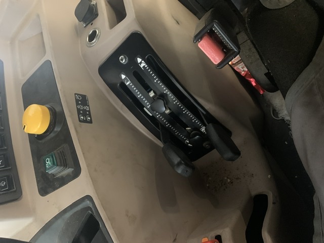

My 3PH lower arms don’t move until around setting 3-4 on the lever. I don’t know if that’s the case without anything attached though. I too have a QH so not sure I can help with measurements.

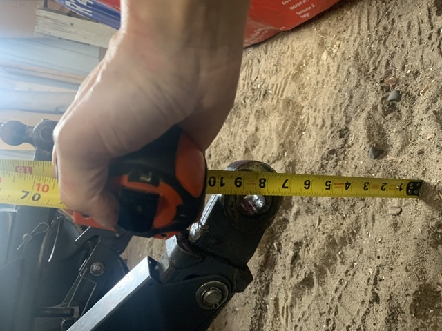

With nothing attached, the movement is only about 17 inches measured at the ball connector on the lift arm

I agree with jchonline that the location of 3 pt needs to be relocated to frt mounting hole on the PHD boom

I mean this with no pun intended, but are you sure you are in the right hole? I am not sure what make/mode you have but maybe those holes on the main beam there are not aligned properly for the height you are trying to achieve. I’m the pic above this post maybe try the furthest hole out and see if that lifts the boom…it should be the most exaggerated and the. Bring back to suit. But it’s hard to say from the picture provided. Good luck and be careful. Augers on the back are fairly dangerous to hook up.
Hole on boom furthest from tractor will lower maximum boom lift height not increase lift height.
Read what's stated in a PHD digger operators manual. Although operators manual is for a different brand PHD the geometry of 3 pt is the same. Also according to operators manual lower centerlink attaching hole on tractor will raise auger higher.

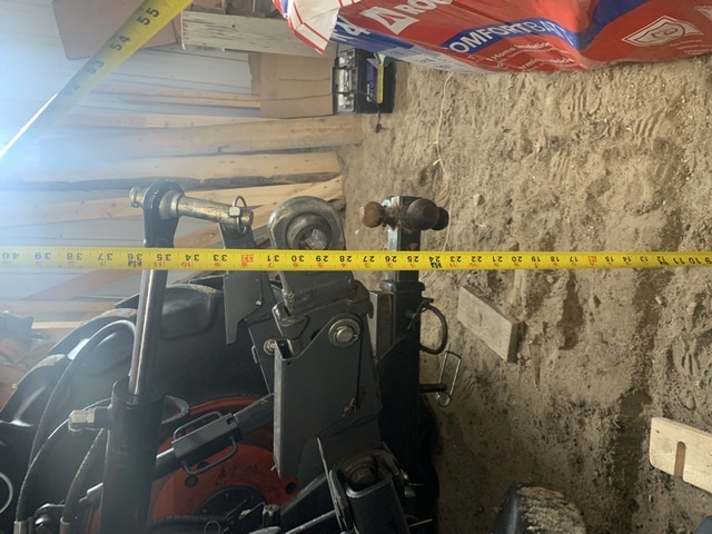

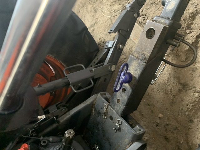

This is in my 7060…..
draft control is all the way down….. height control doesn’t start moving links till where it is in the picture (2nd dot)

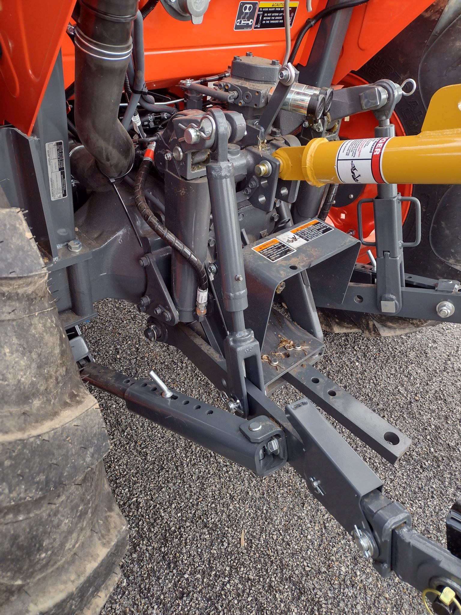

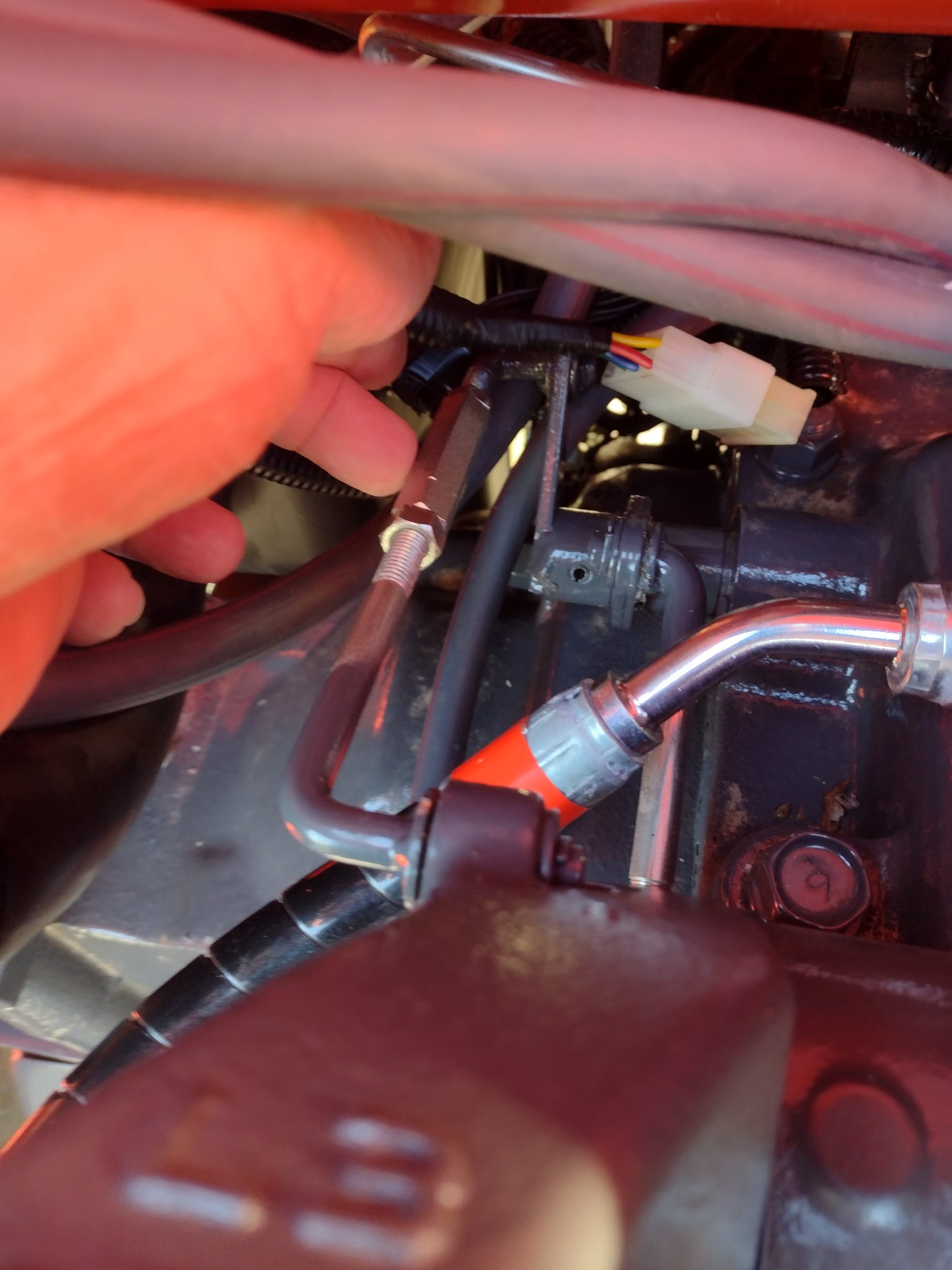

Hello All ... Closing the loop on this thread.
Spoke with my dealer and there is an adjustment (see pic below) that sets the upper limit. You can go as high as where The lift arm would hit the bottom of the hydraulic cylinder - you want 3/4 of an inch for play.
By shortening the linkage it allows more movement so it goes higher. I still have a little more room if I decide I need it.
Simple adjustment, now that we know what it is ...
