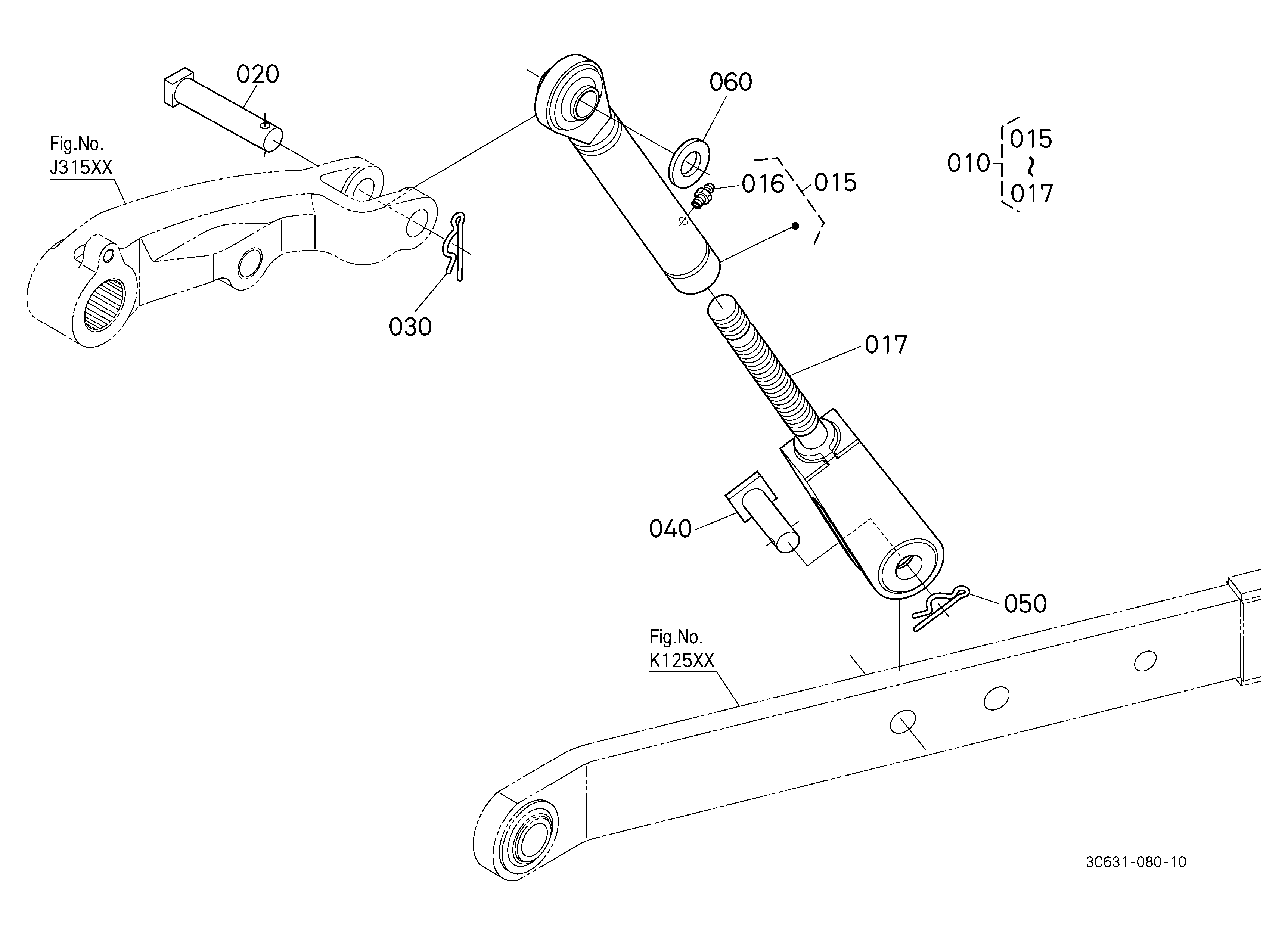

I just took delivery of a new M6060 and the 3 point will not raise high enough to mount the auger on my post hole digger. I also noticed it only lifts my BushHog about 5 inches off the ground.
I checked both side linkages to make sure they are as short as possible, and adjusted the hole on the lower arm to try and maximize lift
Not sure what else to try to get it to have more travel - it only moves about 17 inches total from lowest point to highest measured at the end of the lower connecting ball.
Thoughts?

With nothing attached to 3 pt hitch & 3 pt control lever fully rearward then after operating engine can 3 pt draft arms be raised very much? If so how much can the draft arms be raised? If 3pt draft arms raise very much it's possible feedback linkage needs adjusting

No issues with ours. The other obvious thing to check is the travel lock on the remote control lever...you don't have that restricting the full range of the lever do you?
If that isn't it I assume it would be the travel on the linkage? The M6060 has external cylinders to control the 3PT which is great...I guess you could also have an issue with the hydraulic cylinders.
Forgive my ignorance - but by Feedback linkage, is that the adjustable side links or something else?
I have shortened the adjustable side links to their shortest settings
With nothing attached, the movement is only about 17 inches measured at the ball connector on the lift arm
Travel lock is not an issue, side linkages are as short as possible ... Not sure about the hydraulic cylinders, I thought those were part of the draft control??
The hydraulic cylinders are what lift and lower the 3PT arms on the machine. At least the ones I am talking about.
Yes I went to look again, and see what you m
Ah yes, thanks I was interpreting what I was seeing incorrectly ... The link to the parts schematic is very helpful. Have you ever adjusted the feedback linkage to change the lift characteristics?
