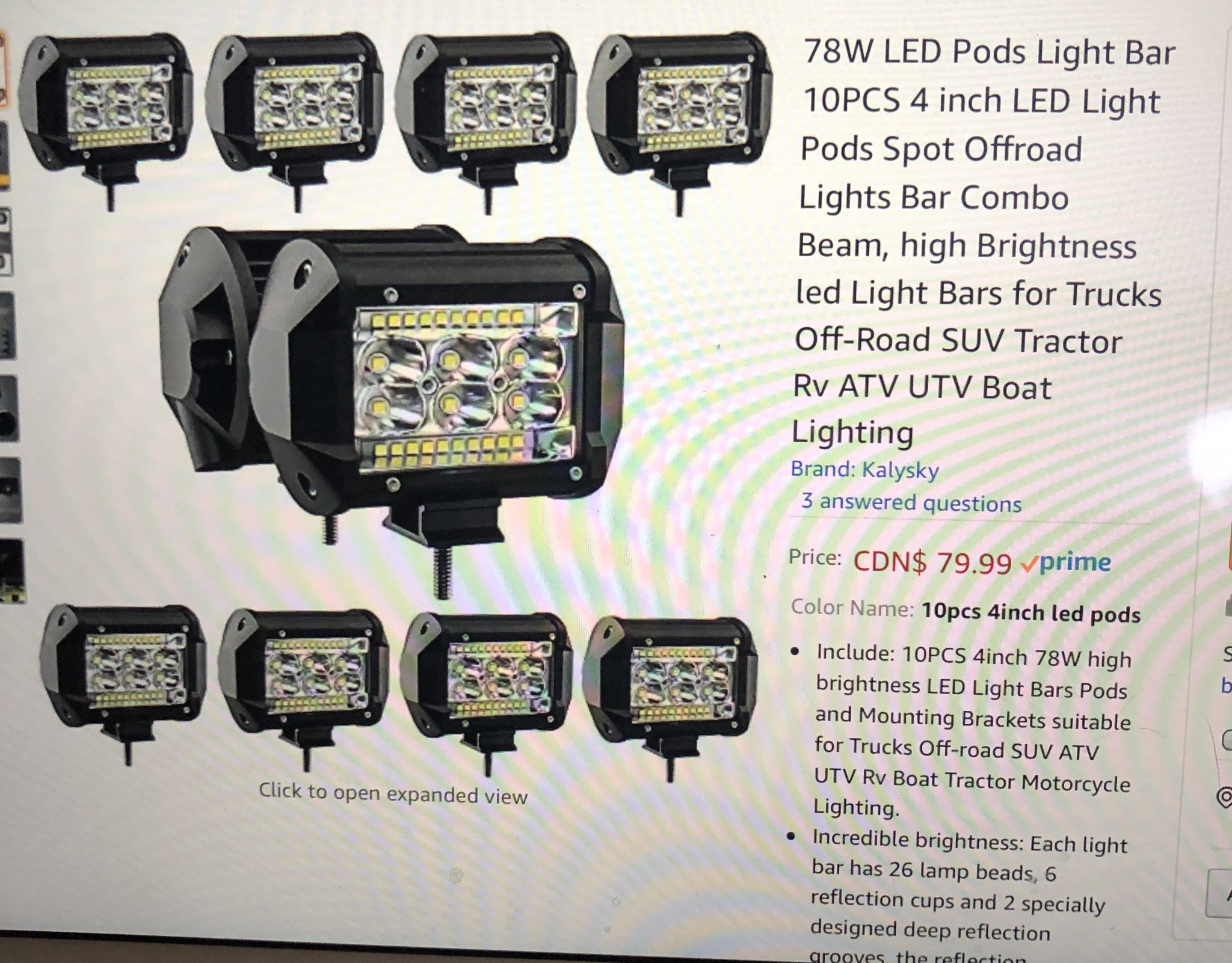

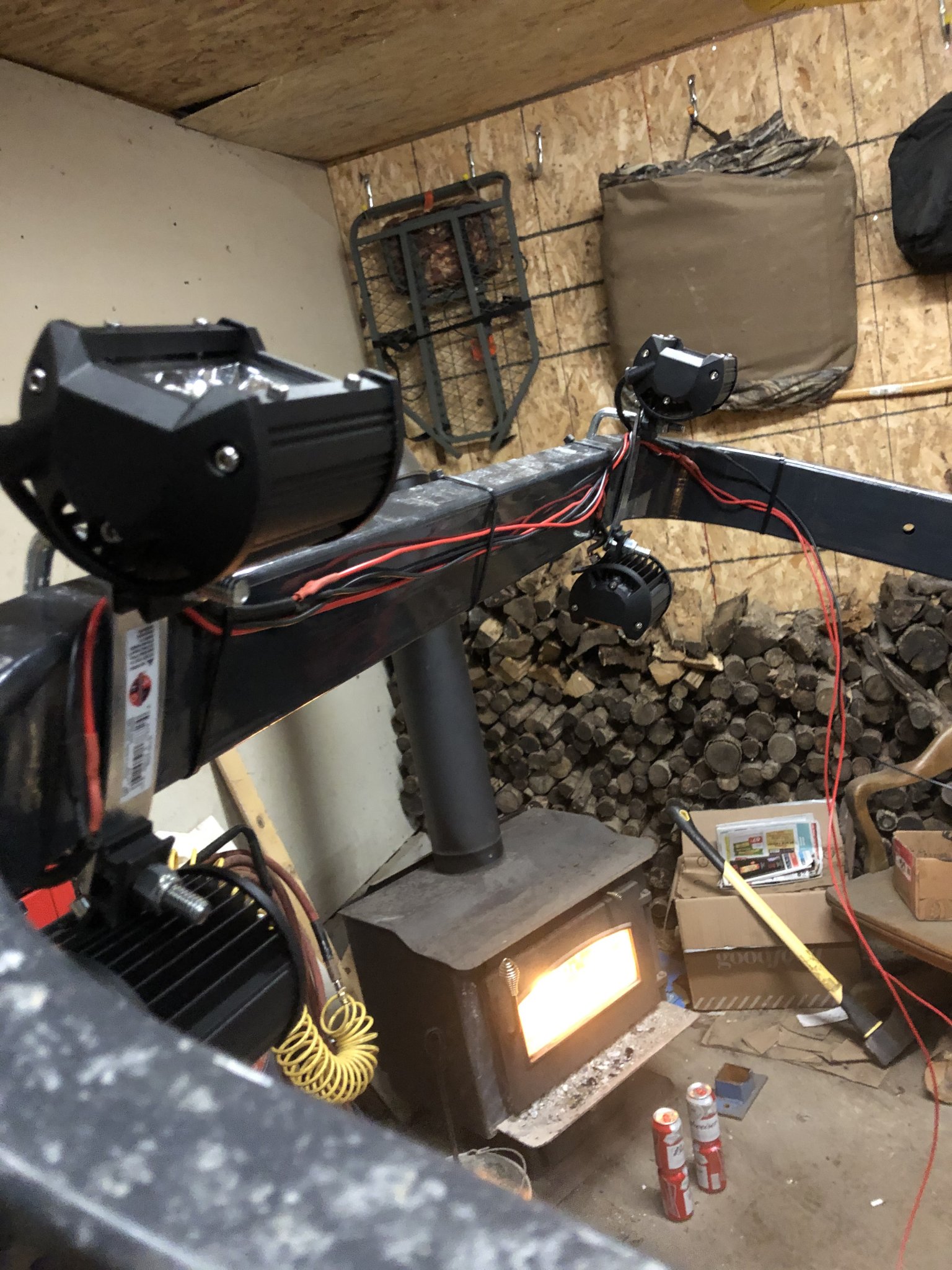

ordered these today.4 for me and 6 for a friend of mine. I am going to put 4 on his IH cab, 2 on his snow blower all on separate switches. Then 4 on my rops. I ordered small round waterproof toggle switches and relays, not 100% sure where I am going to mount my 2 switches yet.

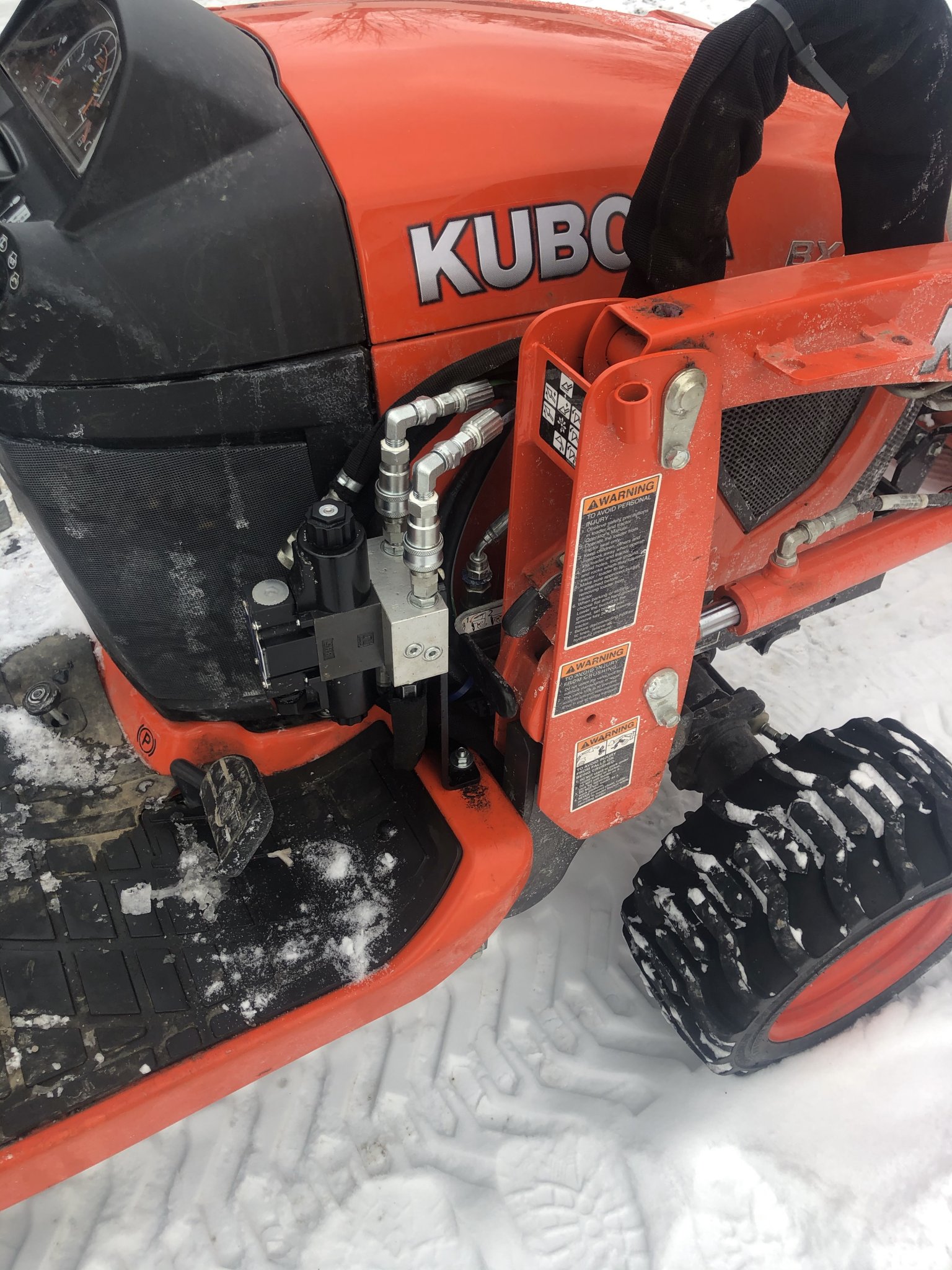

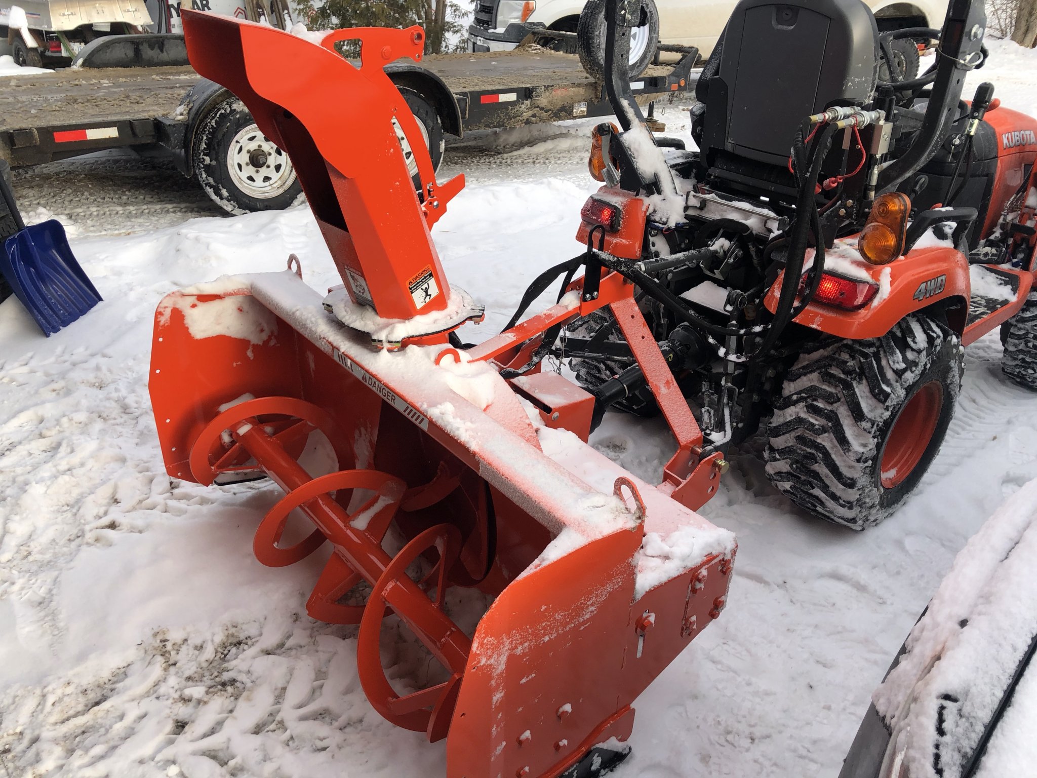

Got it back. Works great. Glad I got the hydraulic chute. They didn’t break the bill down into what the 3rd function cost. They installed the valve on the rops. The pic of the driveway snows what was left over from last night. This this is amazing.

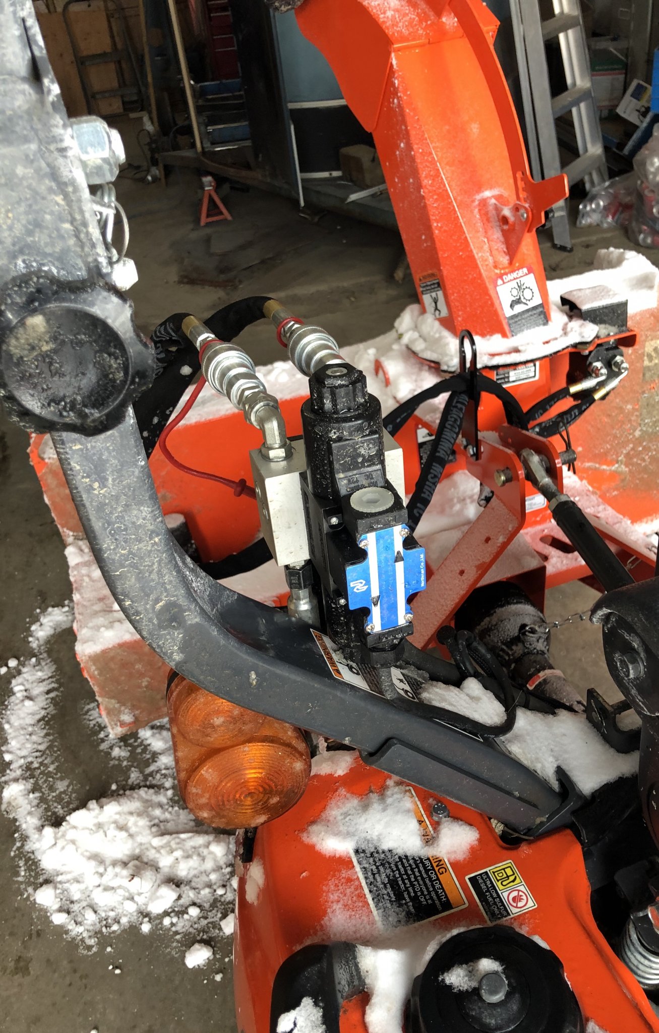

3rd function is what I wanted with it routed to the rear for the hydraulic chute. It’s gotta go back to the dealer to get the front lines installed still as they didn’t have the required connector for it. A Second set of remotes wouldn’t do me any good unless I decided I needed the hydraulic chute control For the deflector. Which I plan on installing an electric linear actuator on for next winter.

They will be installing the front lines for me with quick disconnects so I can still take my loader off easily. Linear actuator is only about $80 and I plan on running power to a quick disconnect plug for my winch, so the plug and switch will control the winch and the deflector.
when I bring it in for the front lines, I’m going to get them to make the connects in the 3rd function valve face down so they aren’t in the way when I have the hoses off.

waterproof orange led rocker switch, a relay, an inline fuse, and then 4 led spot/flood combos. Couldnt get wire loom today but it is all zip tied up nice and neat. I was originally going to wire up the front and back On separate switches but figured there’s no point. I will be installing 2 more lights on the snow blower and they will go on a separate switch that is going to be able to also power my winch at the front and rear of the tractor. I couldn’t get 3” u bolts so there are 4“ on there for now. I will swap them out once the stores are open to customers again. i was too lazy to move the truck and car to take it outside and get pictures of the lights on, will do that next time it snows as well as adjust the angle on them to where I want them.

Scratching my head about the 3rd function location... When you get a grapple you are going to have like 10 feet of hose. I would move the 3rd function back to the front right foot position. The rear double valve kit for the BX is a steal, have them install that kit when they move the valve. Its like $350. You will get all kinds of use out of it.
They are moving the valve to where it’s supposed to be. I wasn’t happy with it there.

Tractor arrived back home. I will grab a picture of the rear brackets later, it’s way better set up the way it is now. so I will be able to use the buttons on the loader for front or rear

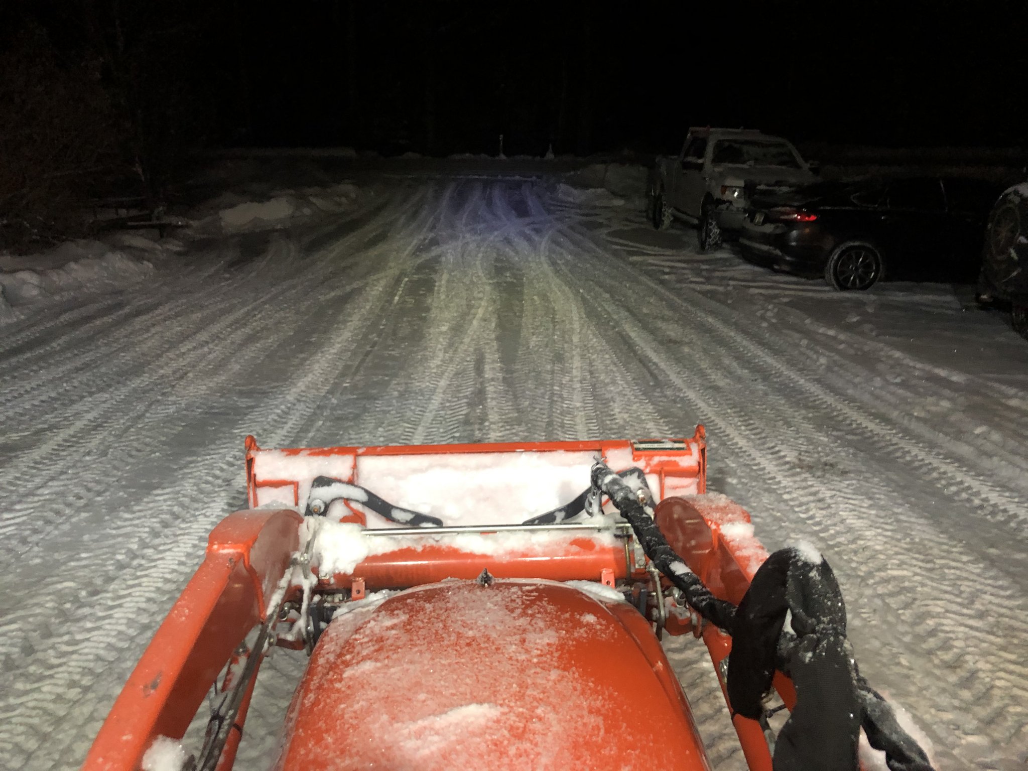

finally got to use my new ROPs lights.

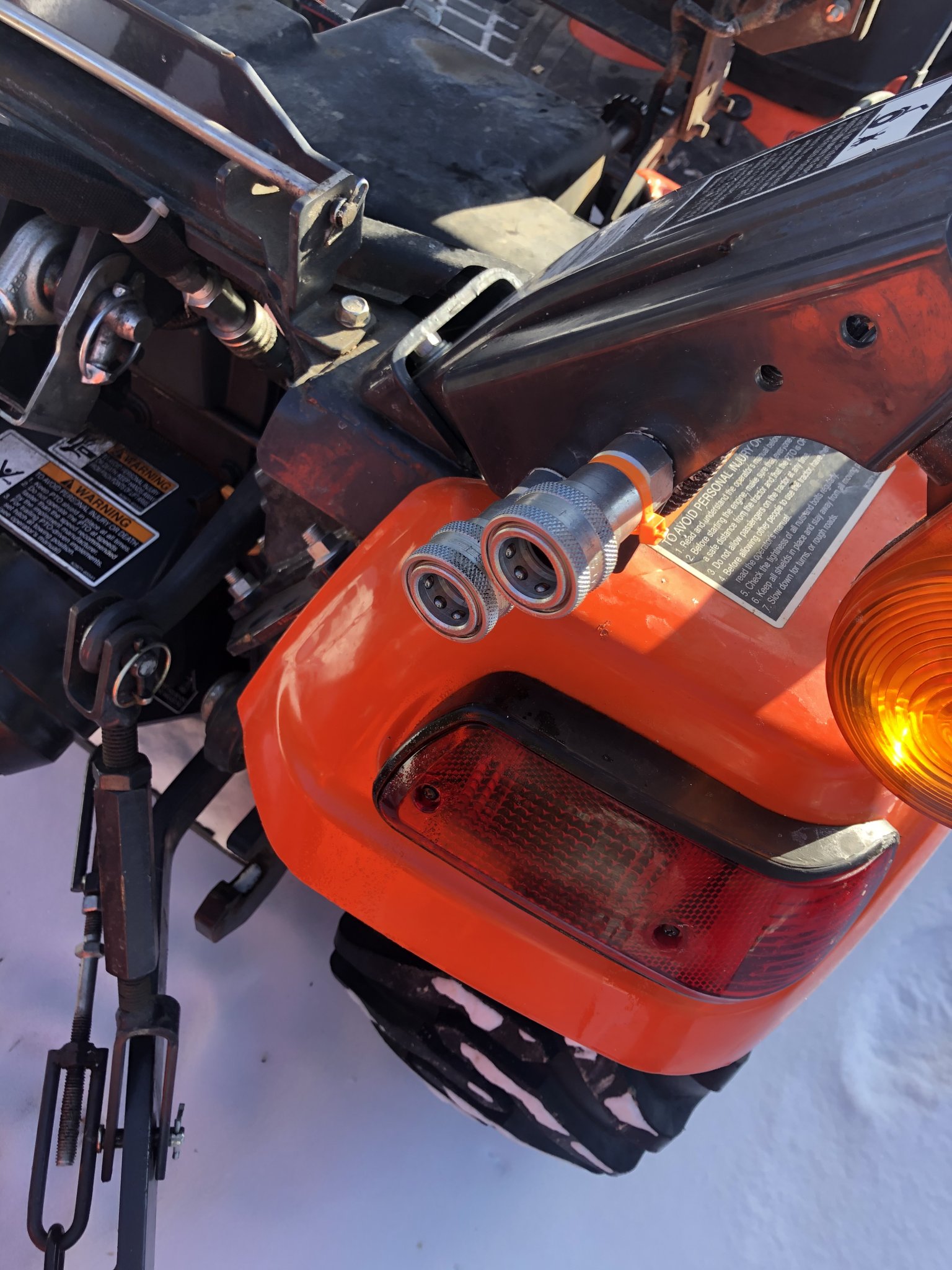

I don’t think I posted an update on my 3rd function. Dealer made good on moving the valve to the body. The rear fittings are nice and tight to the rops and well protected, the front lines can be removed from the loaded and kept on the machine so one day if I ever decide to get the k connect I have all 3 functions available.

I might be missing something here... but how are you supposed to disconnect the 3rd function plumbing to stay with the loader when you remove the loader???

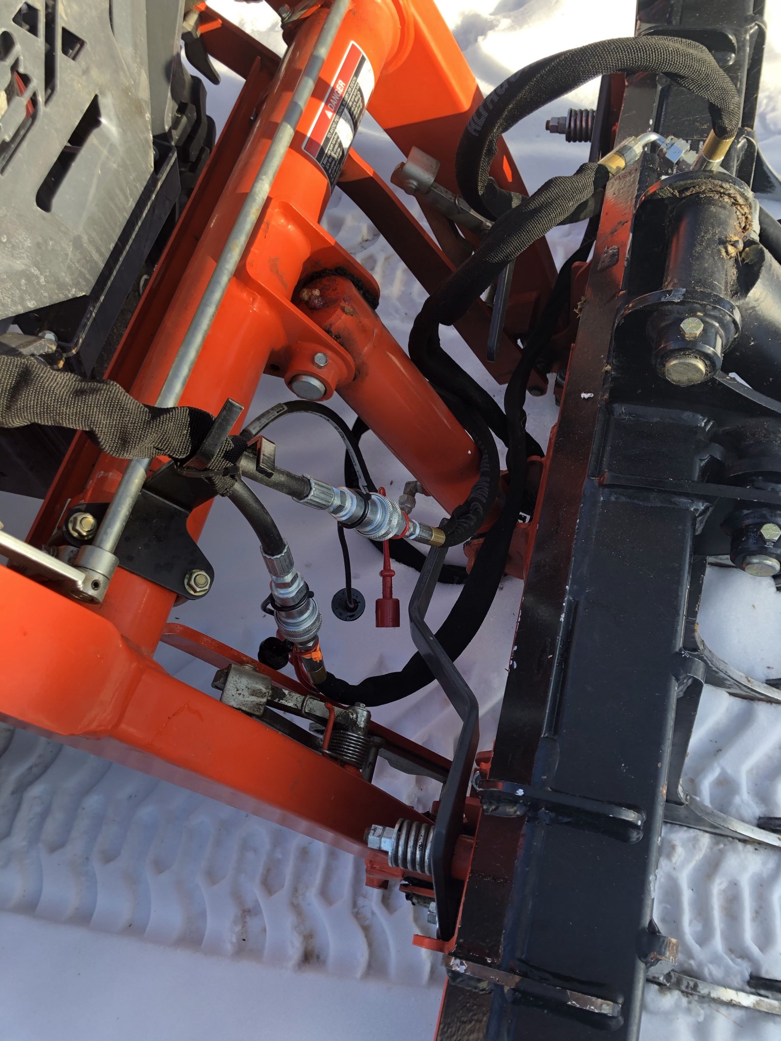

the lines to the loader are not hard plumbed at the working end. If you look at the third picture I can just slide them out of the bracket. Keeps the hoses with the machine. i only take my loader off when I’m mowing.

I would like to do something similar to this on my LX2610. Where are the tee fittings in post 36 used as it looks like they are quick connects going to your loader in another photo.
what I did was have them install lines to the loader and the ROPS at the back. So my third function also works as a rear remote. For whatever reason, kubota didnt have a rear remote factory kit for the bx23s. instead of having another set of fittings; might as well just leave the 2 lines on the machine and remove them off the loader.
I had an issue with the fittings so it had to go back to the dealer. Instead of having 2 sets of fittings sitting there and swapping them out for front to back I asked to have them hard lined in. if i ever decide i want to leave the lines connected to the loader I can reinstall a set of fittings to the hoses at the top of the third function and the loader lines.
