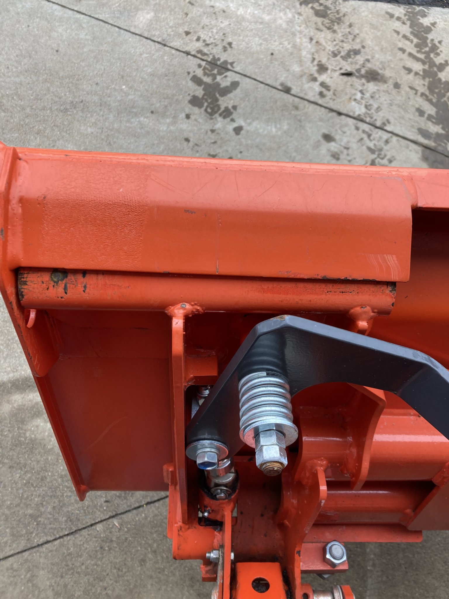

It'd be interesting to see picture of OLD bucket on NEW loader frame.....
Here ya go- first is old bucket on new loader, second is old bucket on old frame. I’ll leave the new one off, no sense of getting it dirty 🤣🤣🤣
