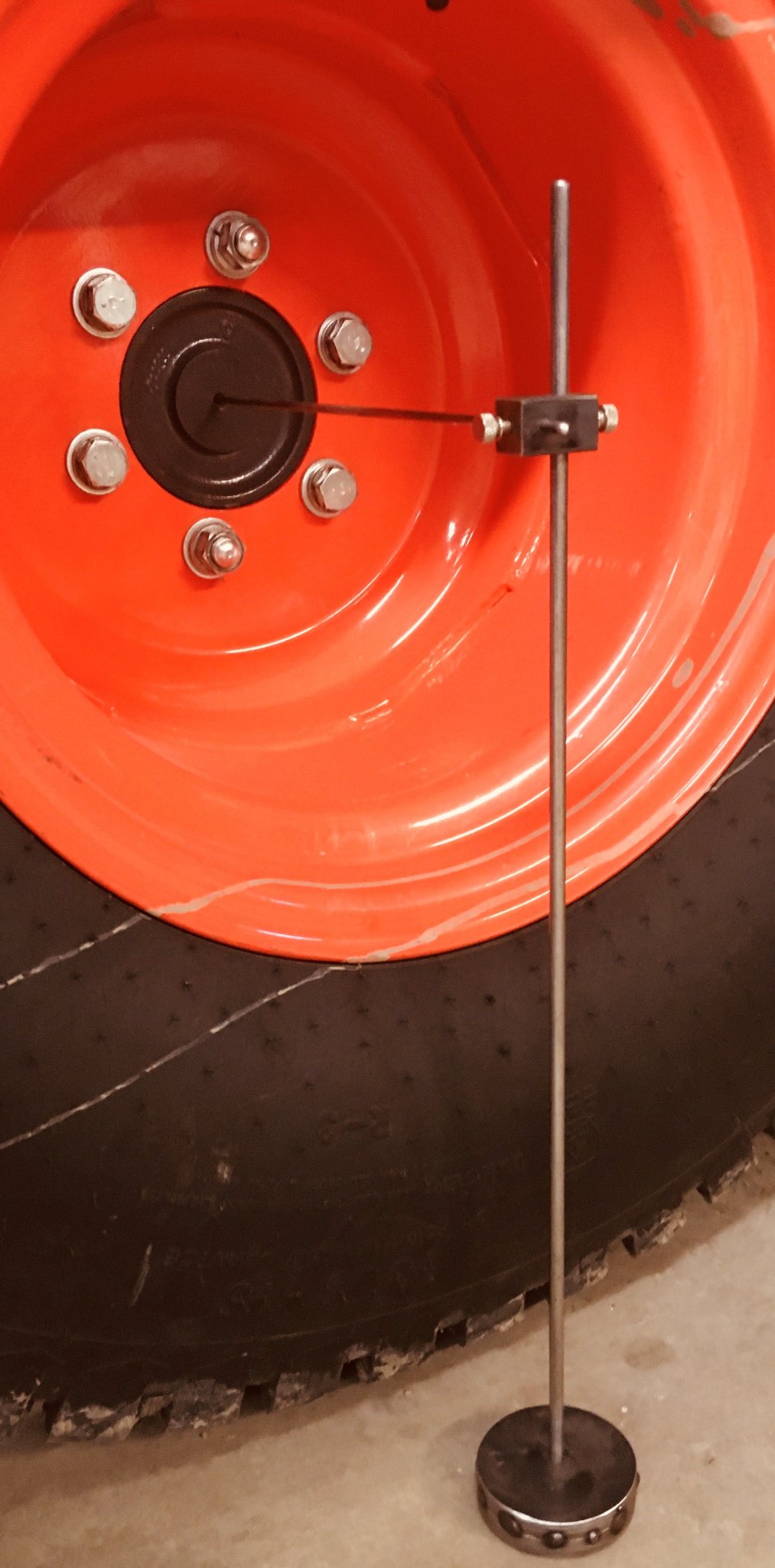

A neighbor had a similar problem....but with uneven cutting with his MM mower. He asked me to help him track down the problem.
We fabbed up this tool to help with our troubleshooting.
We first found an issue with part of his mower gear that he had bent and replaced but had not adjusted it right. After adjusting the mower per the manual it still cut uneven.
We checked and adjusted all tire pressures accurately. Readjusted mower deck again and it would still cut uneven on the sloped ground whenever he would turn around and come right back on the previous cut. ie 180° turn vs going around the same way again.
Checking the centers of his rear axle we found one of his rear tires was quite a bit different from the other. We matched the rear axle heights with air pressure and checked other points around the setup to make sure all was level or even, side to side. After resetting his MM mower, another trial run on his lawn proved all was well again. There was quite a pressure difference in one of his rear tires to make that back axle level side to side.
The combination of the maladjusted replaced part along with the difference in rear tire diameter made for some head scratching. That simple height gauge helped put things in perspective.

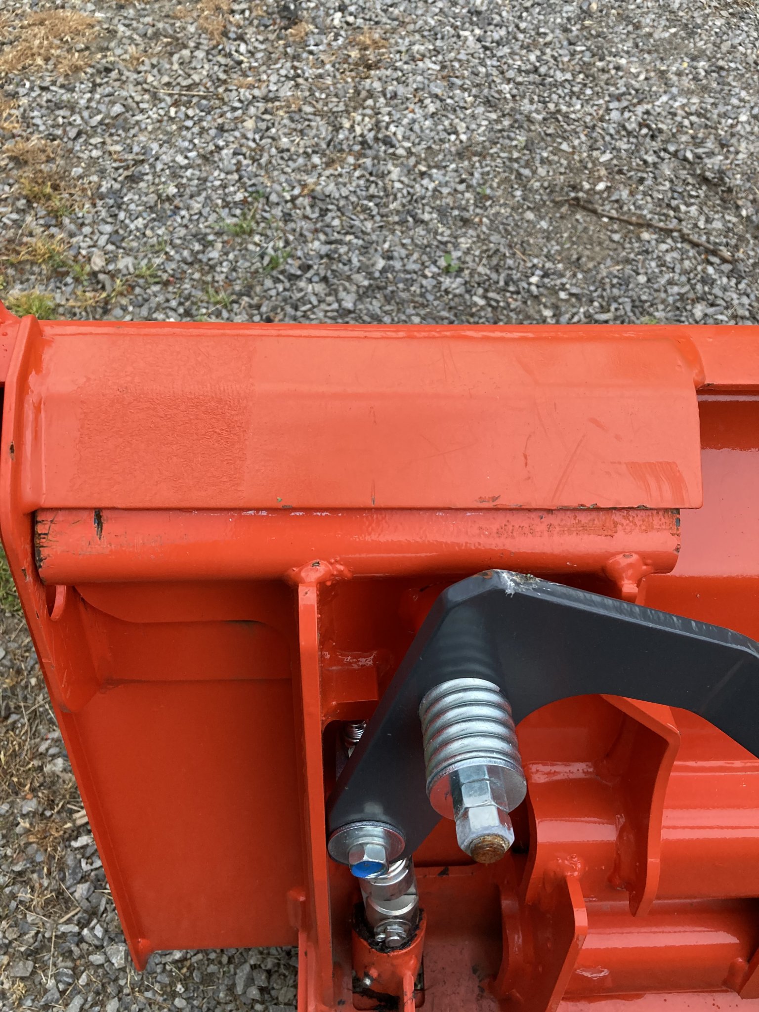

Dealer thought they got it couple months ago. Not quite. Then this past weekend after reattaching loader I think I found the problem. The ssqa plate looks like it is bent back ever so slightly on the left side…
dieselbob69
Kubota BX2380 (previously a BX1870 and GR2100)...
Jan 2, 2022
159
61
WNY
The left side you can see how the plate attaching point at bucket has a bigger space towards edge of bucket, latch is fully seated…. 6F9680BD-9C7B-437B-ACE8-59491EDA3244.jpeg E2D238E5-A057-49FB-B16F-ACE937A9E80F.jpeg
xrocketengineer
Nov 14, 2020
772
680
Merritt Island, Florida
I don't think that you will be able to straighten that out being a BX, since the center section is beefier and specifically designed to take the torsion load of the center curl cylinder. Unlike the larger tractors with two curl cylinders, that just have a tube in the middle and it would be easier to twist/untwist. You might have to go back to the dealer to have it replaced.
