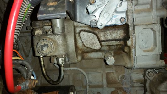

Here is what the side of the block looks like around the injection pump.

How is the primer pump assembly attached to the back or side of the injection pump housing? this is what I can't seem to see good enough in all V2203 pics so far.
Just looking if my hydraulic pump will bolt up to the rear of the IP hassle free and like another post a guy had here he ran into an issue with it in this post.

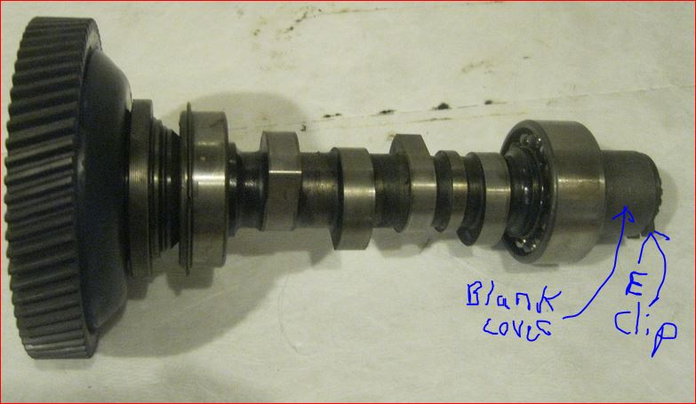

I'm not sure what his issue was, as they both take the same splined cam shaft end????
Maybe he didn't notice that there is a blank sleeve/cover over the splined shaft to hold the back bearing in place when they don't use the pump gear, like in the second photo???
Also note that even though they don't use the fuel pump cam on most V2203's it's still on the camshaft (it's the ring/skinny lobe between the 3rd and 4th cam lobes)
V2203 Camshaft
V1702 / V1902 Fuel Camshaft / with blank cover / sleeve over cam splines.
