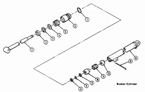

There is one variation in the lift kit parts for the bucket cylinder (item #13 is different from what's shown in the Owners Manual that was linked earlier). The diagrams in the link & in the OM are almost identical.

I wouldn't worry about small variations in the parts, sometimes they have just done upgrade to the kits.

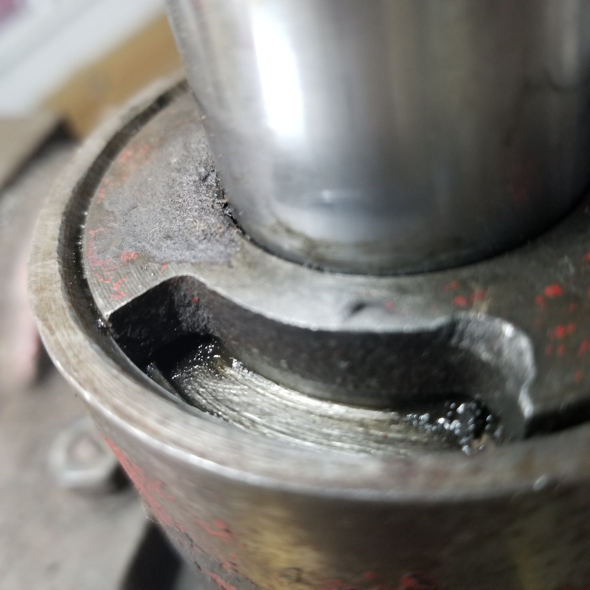

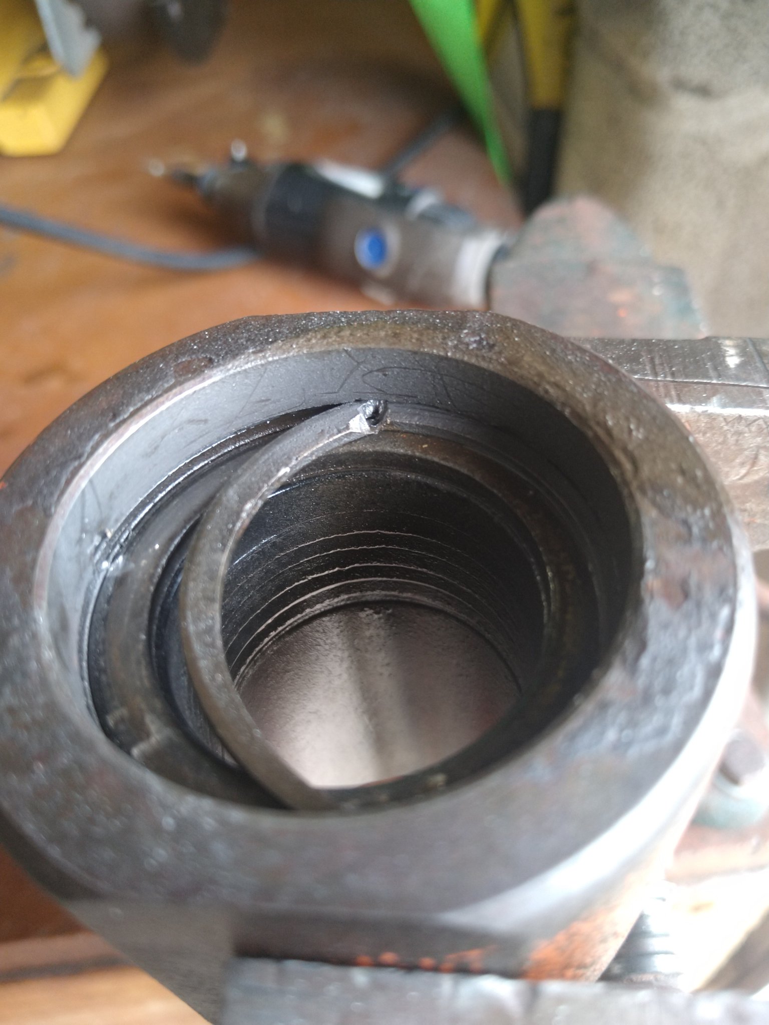

Nice job on getting that broken clip removed! Shows you have some patience. And we all appreciate the pictures of your progress

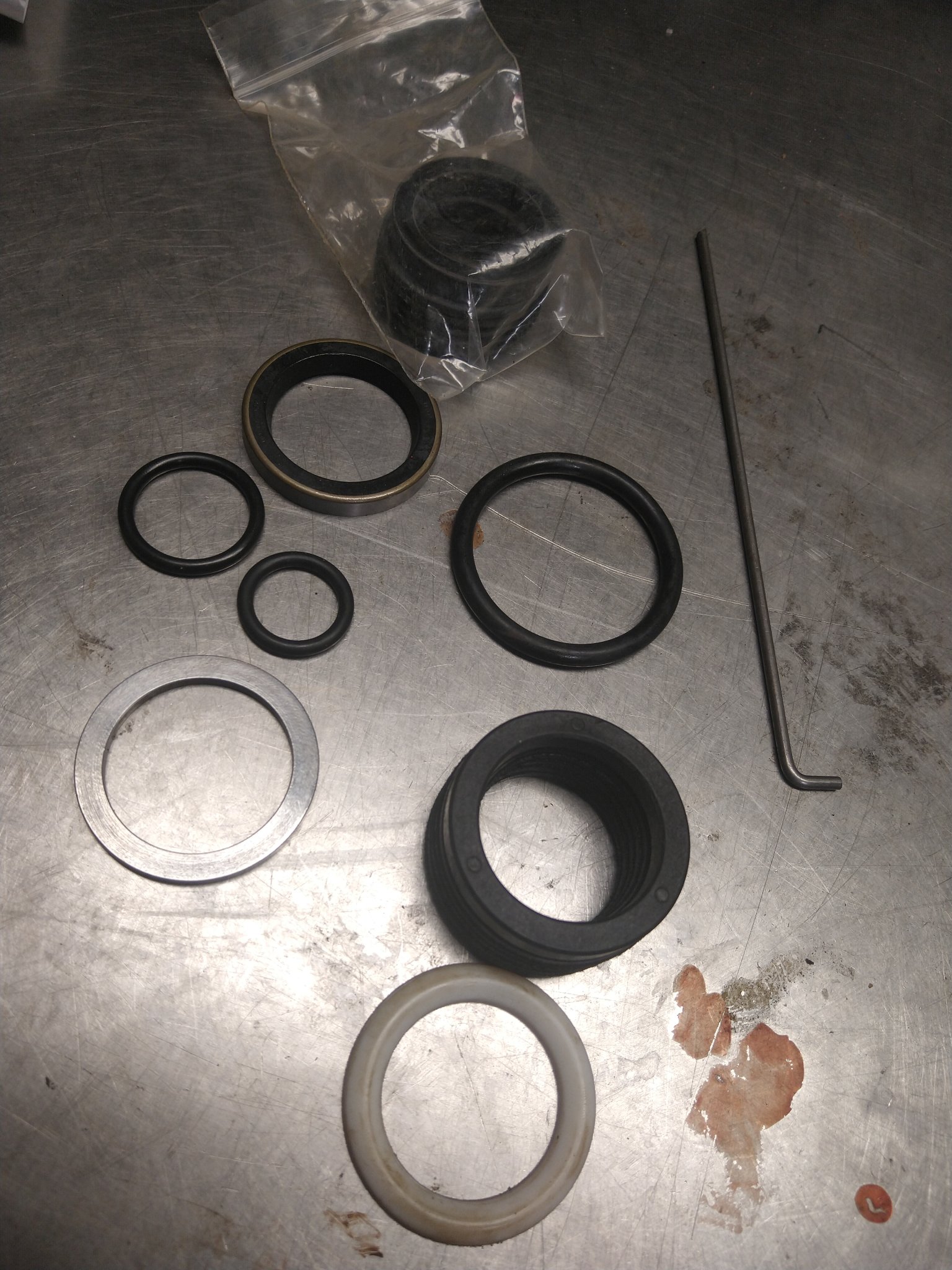

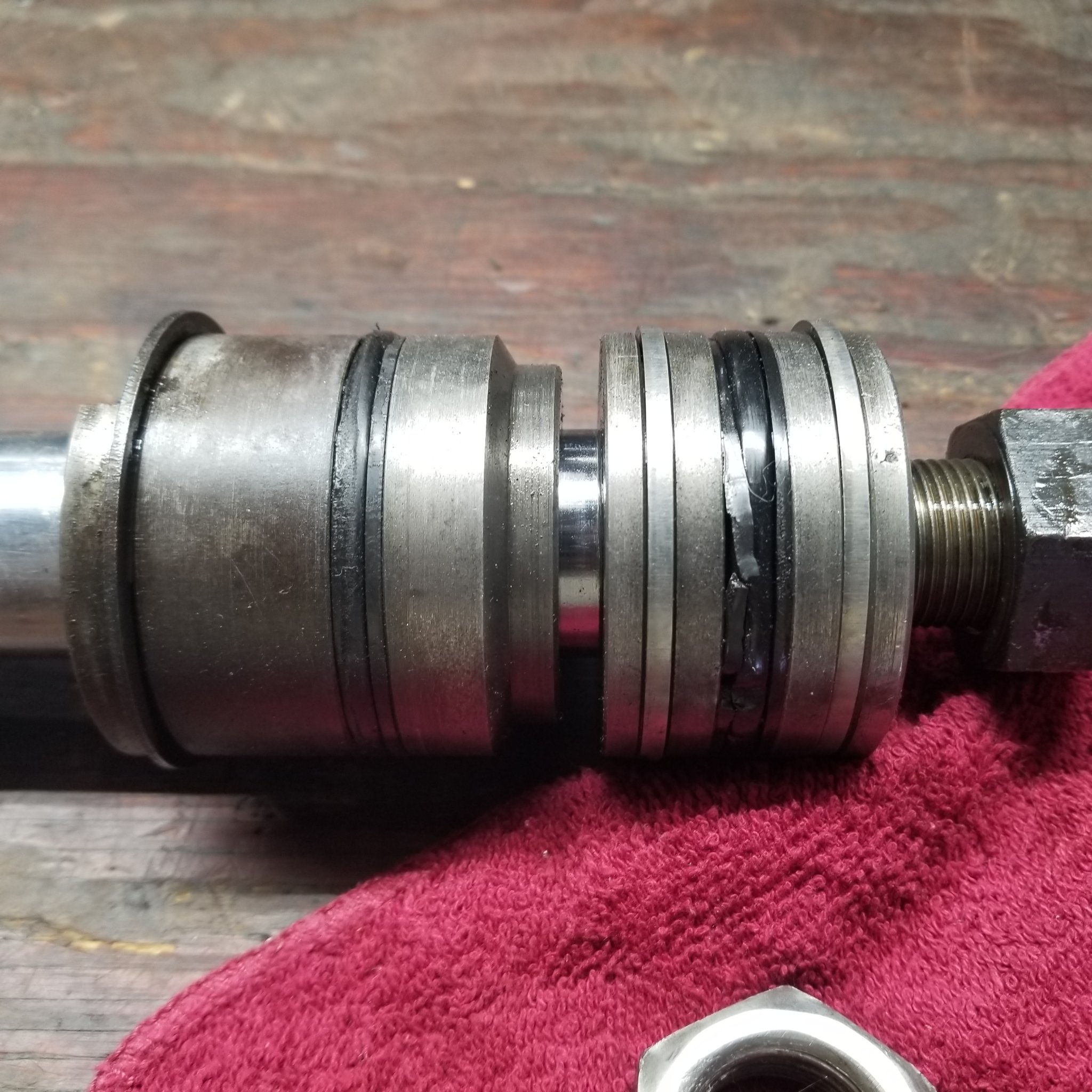

I received my Messicks order. The 70050-00301 kit doesn't have anything that I recognize as a snap ring replacement (item #3 in the lift cylinder diagram on their website - Kubota L2773 (FRONT LOADER) Parts (messicks.com)). When I search the site for item # 70070-00107, I don't see any picture. Unfortunately, there's no picture for the 70050-00301 kit either for me to compare it to.
Here's what I received
The snap ring that was in my cylinder has been replaced by another P/N. Does anyone know what this replacement is supposed to look like?

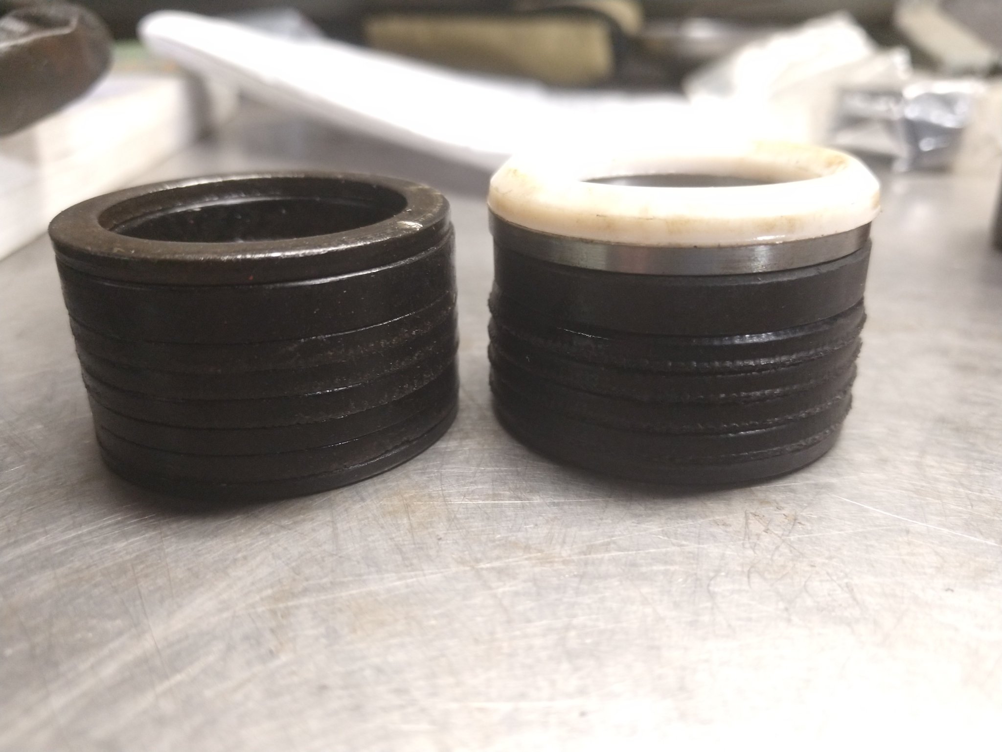

One obvious difference in the kit is the white chevron seal. What's special about this one? Here is my original seal stack on the left, and the new one on the right, plus the white seal (just added it on top, not thinking it's supposed to be in that order). The white seal makes the stack higher, otherwise it would be the same.
I have sent Messicks an email about this, but thought I'd run it by y'all as well.
33,943
9,158
I'm sorry I didn't catch this earlier that's the right kit.
You need this kit same as the kit for a L1730
You just need to get 70050-00315 snap ring, it's not part of the kit.
And yes you will not use the nylon ring, it was used in other models.

I don't know what is different with what you just posted. What did you miss that you apologized for? The rebuild kit # is the same in your & my link. Regardless, I'll have to order the snap ring. It's odd that they didn't include anything to hold in the seal stack - seems like a mistake. I'll find out what they say tomorrow.

Yea, the reason they don't include the clip is most cylinders don't use it, they use the white ring.

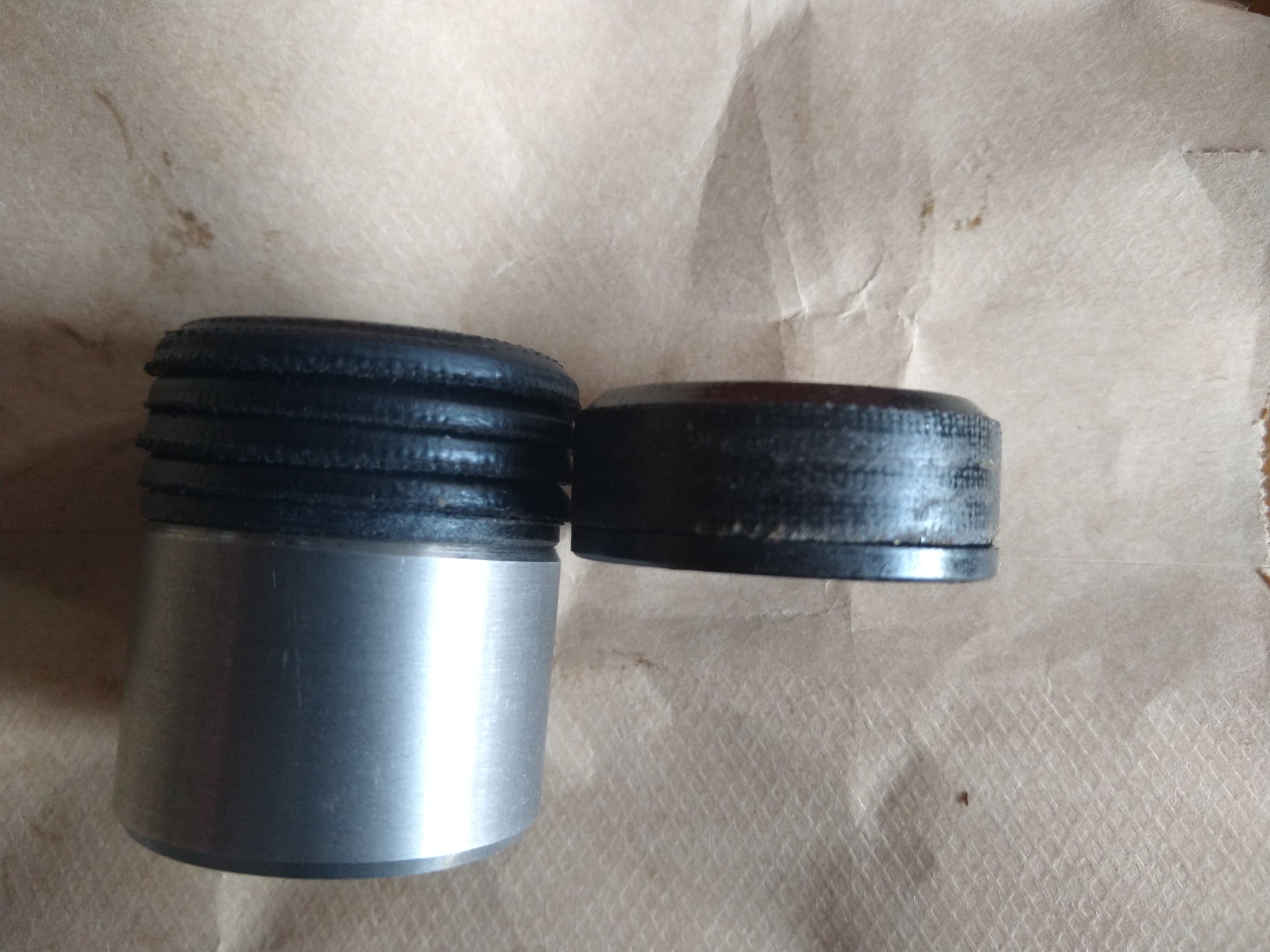

I'm putting back together the bucket cylinder and have a question about the main seal stack. The new one when stacked up higher than the old one. This is what I'd expect knowing nothing else, but earlier when I compared the new lift main seal stack with the old one, they were pretty much the same height.
Picture shows the stack on the piston, but the plastic end piece is not on yet, and the top seal is flush with the end. The piston nut screws onto shaft until it contacts the piston, IIRC. This will compress the stack a fair bit, making it spread out. If the OD increases because of the compression, I'd imagine it could be a PITA to reinstall in the cylinder.
I'd imagine this is typical, but thought I'd see what y'all have to say before going much further. thanks

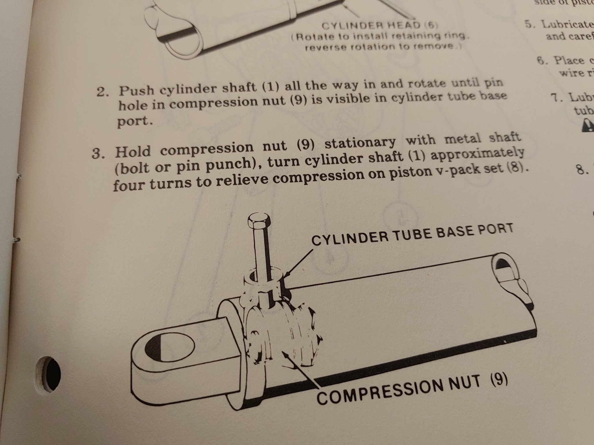

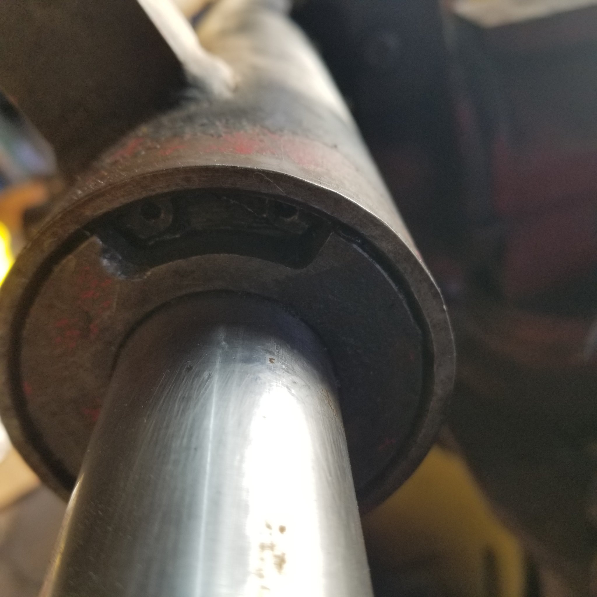

Do you have a owners manual ? It should tell you how to assemble the cylinder. It's tricky. I will see if I can find my copy.

Here's a picture. Install the assembly with the packing nut lose. Then put a punch in the lower port into the hole in the side of the packing nut . Then tighten it. If you would like a copy of the page send me a PM with a email.

Thanks for the pointer - much appreciated. I do have that manual thanks to the Wolfman. Why I didn't look at it before posting my question is a head-scratcher. Shame on me.

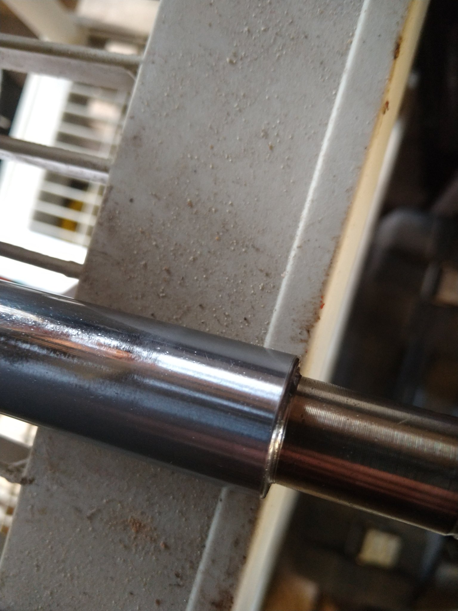

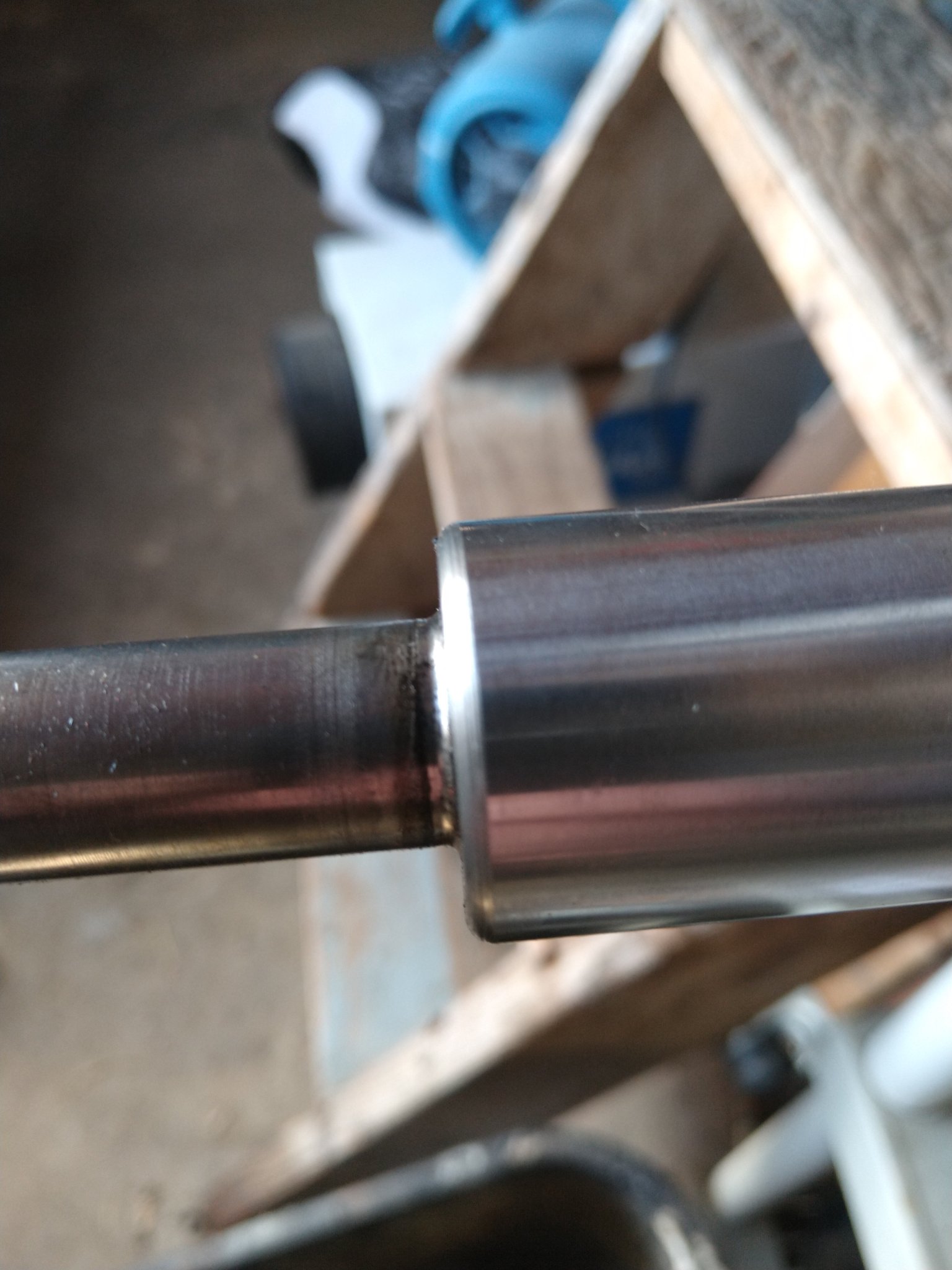

I'm surprised they don't manufacture these with a lead-in chamfer already machined. My lathe can't handle these pieces, but even if it could, I wouldn't want to clamp down on the seal surface. So then I'm left with a sanding disk on a side grinder or something similar. Not so great....
The top picture is the bucket rod, bottom is the lift rod. Bucket rod has just the sharp edge, but the lift rod has at least a radius. I wish it were more, because once I get the seal stack installed in the cap and compressed enough for the circlip to be installed, the seal ID will be pushed in enough that I can see the reassembly will be a bear.
p.s. The bucket rod picture shows what looks like a bad surface, but it is just a reflection of something above. They're also resting on plastic shelving, even though it looks like rusty metal shelving.

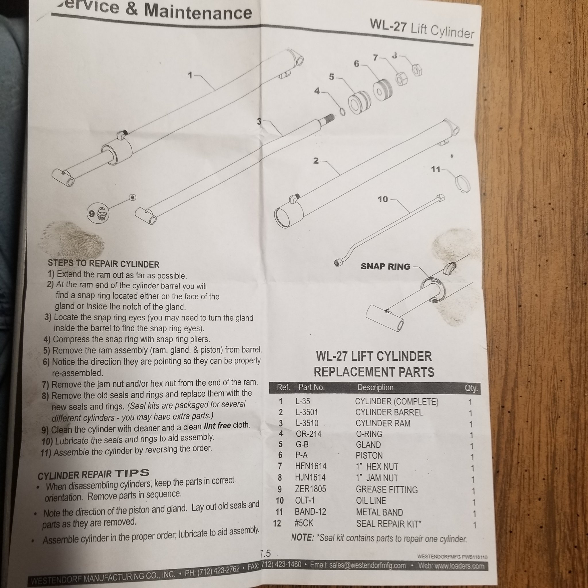

Timsch, I've been following your thread and what I have probably won't help you but may help others if they come looking for info on hyd repairs.
I have a Westendorf loader on my tractor and one of the lift cylinders is leaking. When I called Westendorf I couldn't get specific price because I didn't have the serial number, but she indicated price would range from $90-$160 for the seal kit. After removing from the tractor figuring out how to remove the ram wasn't clear. The gland has two slots in it and in those slots one has to locate the eyes of a snap ring, compress the snap ring and yank the ram with enough force to displace the snap ring. The KD snap ring pliers with the locking handle really makes this job easier.
Once I have all the components apart I take it the the local hyd shop. He had all the components, installed all the seals and wipers (including the inner seal on the piston, that is easier with the three fingered gizzmo). I had called him before I headed his direction. I visited with him as he measured and installed parts. Thirty-forth minutes and $17.
I told him to have the same components on hand 'cause I'll be back when I get the other cyl apart.

In the mean time, I started reworking the bucket cylinder since the kit was complete. Unfortunately, I buggered up one of the seals by not chamfering the piston rod, so that will have to be reordered.
Today, I chamfered both piston rods with my belt sander held in a vise. Cleaned up the chamfers with my dremel tool & some steel wool and started reassembling the lift cylinder. The 4-piece chevron seal stacks provided enough resistance that I needed the shop press to get the cylinder cap started (no surprise there since the stack had to be compressed to get the snap ring in place and the rubber could only spread to the ID the way it is contained). Once that was done, I got the seal stack on the piston, the piston on the rod and then inserted into the cylinder. I thought that might go in with minimal effort since the piston stack wasn't compressed yet, but there was enough resistance that I ended up putting the rod pin-end in a vise, hooking the ends of a ratchet strap to the vise after running the strap through the cylinder pin hole on the opposite end. Ratcheting pulled it together pretty well.
