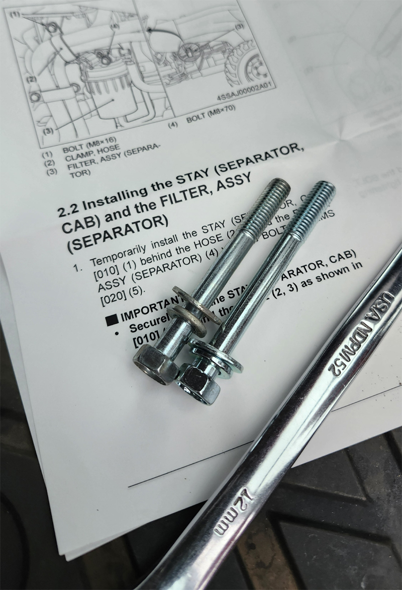

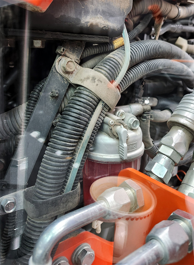

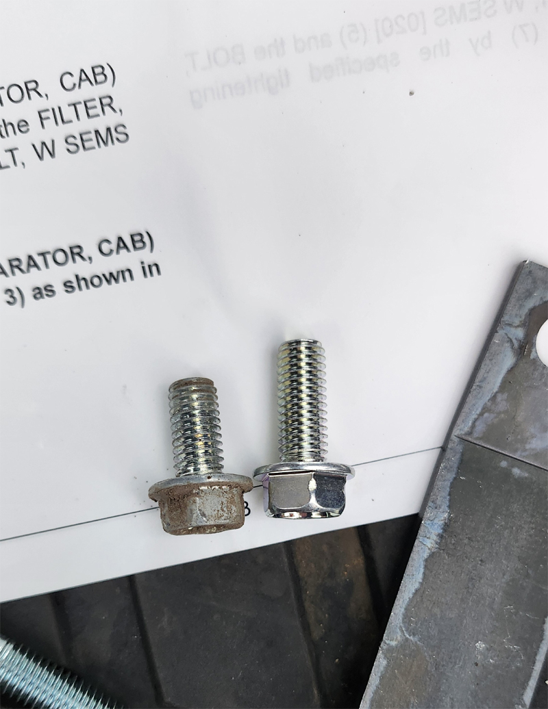

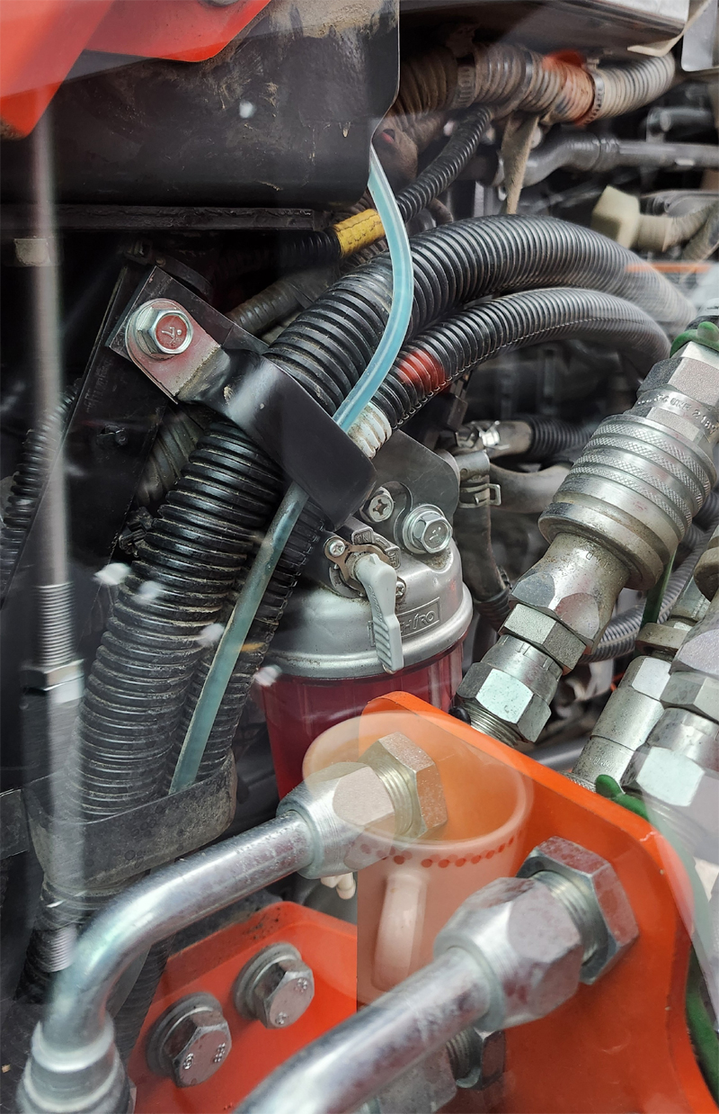

I installed the kit on my MX this morning. Access is a bit of a challenge but I figured it'd be easier to struggle for a bit rather than take off the loader and disconnect hydraulic hoses. The photos below show the before and after (some taken through the front glass), and the difference in the bolts used which have grown to accommodate the thickness of the bracket. I just noticed that I need to rotate the hose bracket a couple of degrees. 😂
Before:
After:
Must have been a real bugger getting that coffee cup mounted around that steel line. LOL
I only recently noticed that ghostly image. 😂 It's a 6oz cup that I use every morning for a Cortado or three. It took me a while to find suitable cups, but I have four of them.
