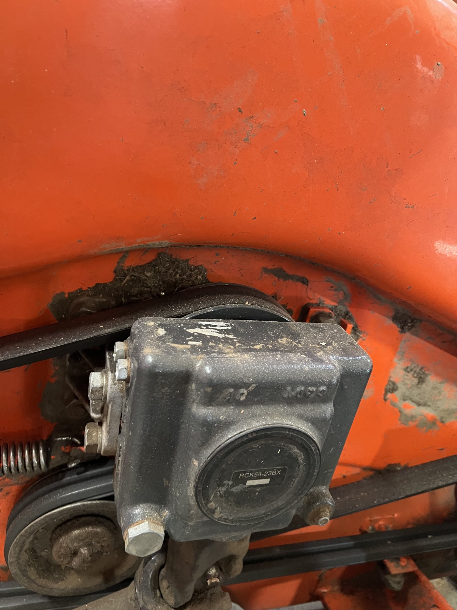

Going to try to suck it out with a syringe. Hope it works. Don't want a big mess to clean up.

Should work okay. Big syringe with a large tip - maybe a short length of tubing on the tip.

i use a fluid evacuator for that too, among many, many other uses. refill with a hose on the end of the gear oil bottle's nozzle.

The last time I changed my gear box oil I used the cap off of a paint can. I put it under it and let it drain.
When it gets near full, I cover the drain hole with my finger and dump the oil in a pan.

If i am reading this right, remove both plugs to drain, then put lower one back in and squirt oil in top hole until it starts coming out/the amount it calls for.
Probably does not really matter here but learning from car gear boxes and differentials I always open the fill plug first. Reason being is if you cannot open the fill plug you still have a driveable vehicle and can go to a work shop for help whereas drain plug opened and no oil in the gear box you would have a problem. With the mower you can still cut the grass and deal with the seized plug later.

Sucked it out today. Looked like it was new out of the bottle oil. Maybe metal particles I can’t see is why they recommend the oil change this soon. Will still change it every season for now on. That gear box can’t be cheap if replaced.

I just drain out of the fill port. Refill it when it set it down to put under tractor.
(I leave a note on the box that says NO OIL as a reminder. Sometimes I get it ready a couple weeks before I refill the gearbox- bad things could happen with a feeble memory…..:oops:)
Going to need to mow next couple weeks. Blades sharpened and back on. Deck greased.
I drained the gearbox out today. Oil looked perfect, but I can tip the deck a little, and last few ounces look like they may have some moisture in it.
Crap in the Cool Whip container is from many years of use...... ;)
Probably changing each year is overkill. My lawn isn't that big.

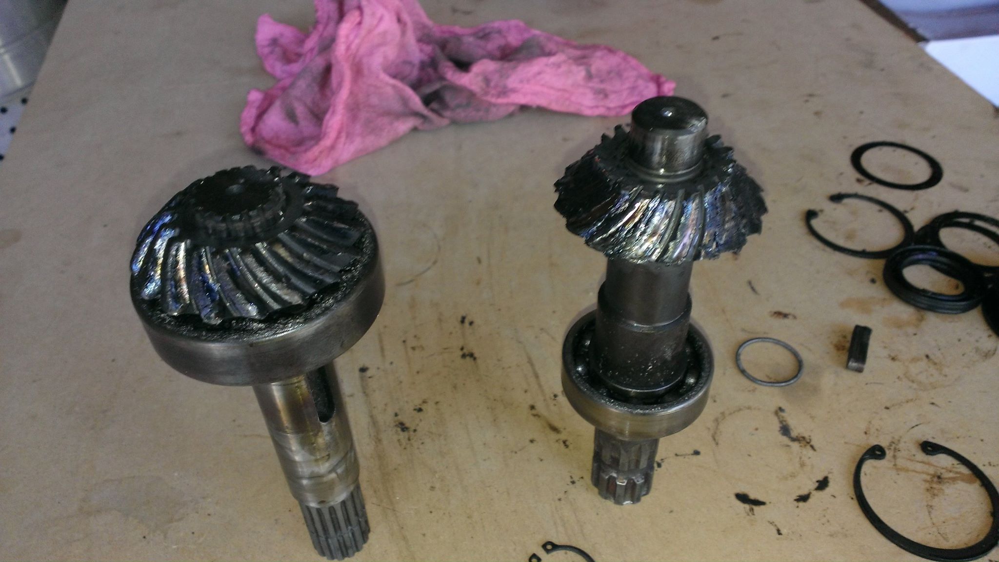

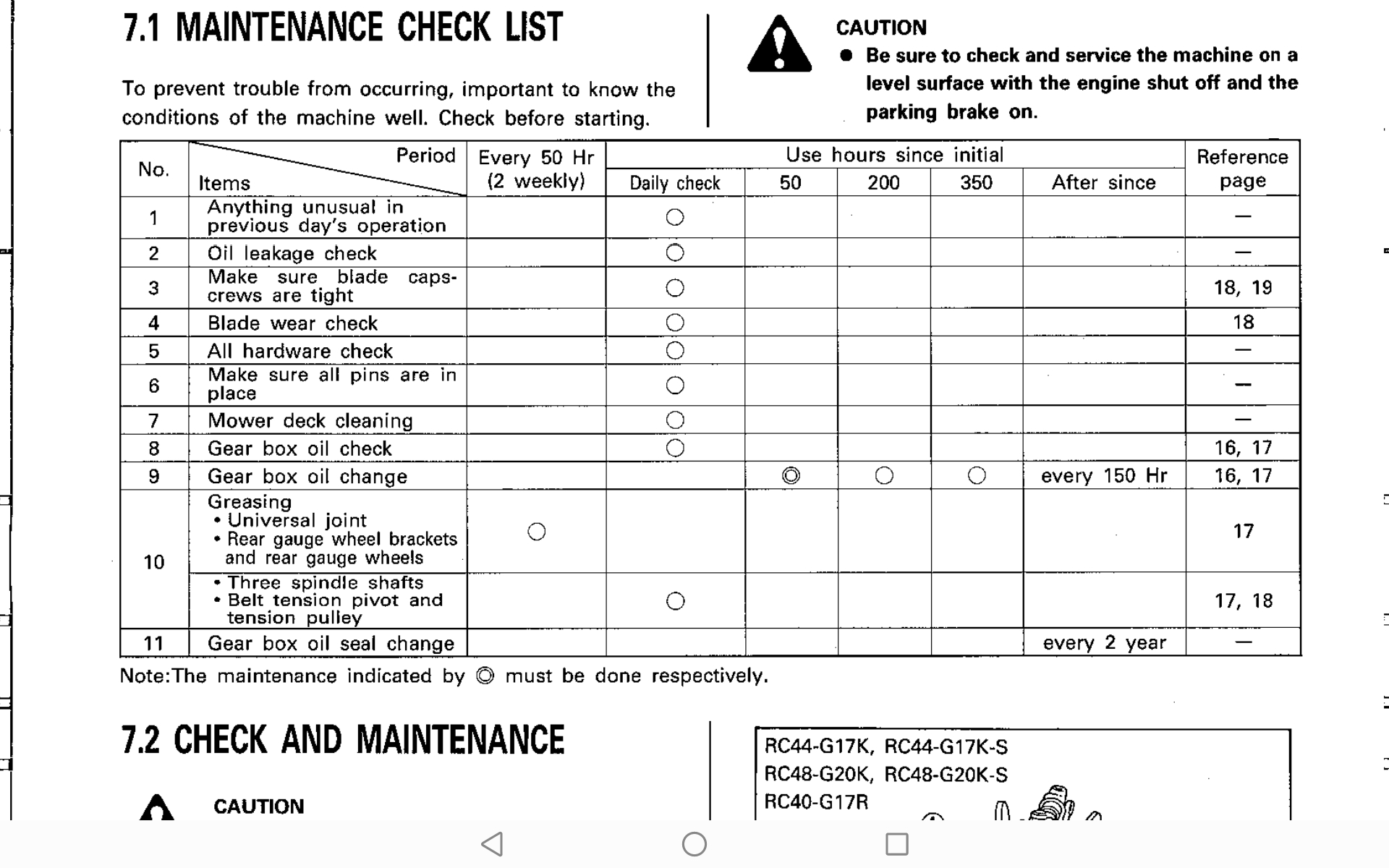

In my manual it says oil change every 150 hours. Gear box oil seal change every 2 years though 😲
As far as I know the SAE90 oil (used in my gearbox) is cracked mechanically by the gears over time, hence the oil change. Has nothing to do with wear and dirt that has to be removed.

The gearbox on mine was rebuilt by a Kubota dealer in WI along with the spindles just before I bought the machine back in 2021. IIRC it had about 850 or so hours on it. I now have just a hair over 1000 hours on it. I changed the oil in the gearbox Monday. Used Lucas Synthetic 75W-90. Seems all the high end gear oils are 75W-90 rated. Which I guess is OK since this time of year and toward end of season I run the deck in some pretty cold conditions. But, I'm not touchin that seal unless it starts leaking. LOL. I've changed the oil in the gearbox 3 times since I've had it.

I check the oil in my MMM gear box every 10 hours. A few years ago I lost a seal in the bottom of MMM gear box... and I am hard of hearing. Did not realize I had a problem until my neighbor told me something did not sound right. When I immediately looked into it .... the ONLY sound I could hear clearly was "Ka-Ching".
Hugo Habicht
G1900
Jun 24, 2024
1,533
2,199
Ireland
Interesting story, would not have thought this could happen, slow leak yes but not sudden loss. Thank you for sharing it ! To be honest, the tractor and deck is so noisy, I would not have heard that either. Possibly after the damage was done ...
Maybe time to reconsider ignoring the seal change maintenance. The seal ring has metal protection outside, could not find that anywhere. And I am not willing to pay the Kubota price for a standard part. Anybody an idea where those seal rings can be obtained?
