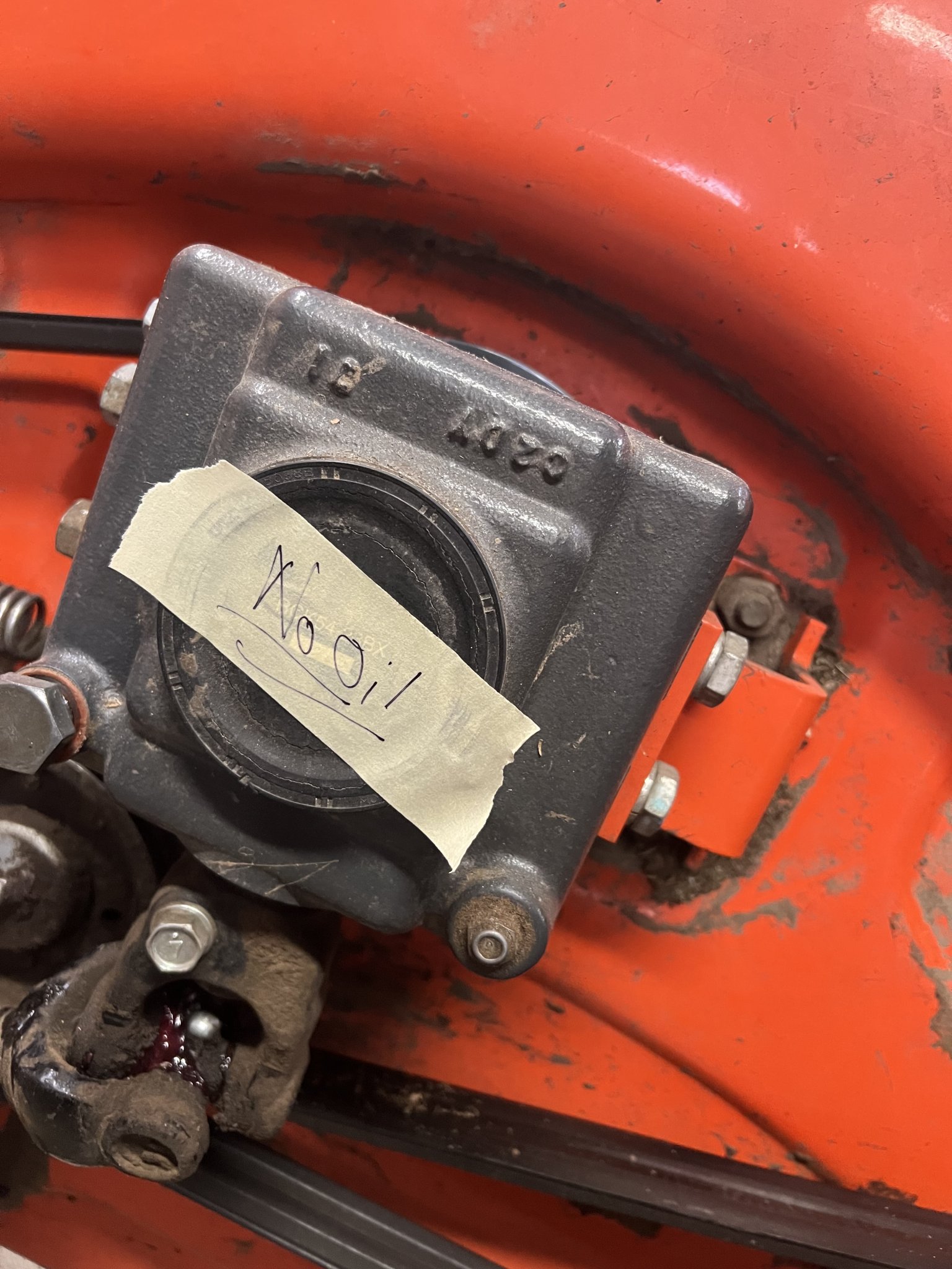

For what it’s worth, like @lmichael mentioned earlier my gearbox is vented.
It’s opposite the fill plug on a similar picture I posted earlier.
I make a point to clean it off each spring.
Don’t know if all are, but wouldn’t surprise me if they were.
It is the same setup on my F series 72" deck and the 72" midmount deck for my Deere 955 is also vented and the Deere manual makes note to clean it every time you check the oil level.
Gearbox oil (and air) both expand when hot so if there isn't a functional vent then one or more of the seals will turn into a vent. In addition to fluid loss, when the breathing occurs through a seal then damage will occur as dirty oil and debris is pulled back in through the same breach when it cools resulting in damage to the seal/sealing surface. I modified the rear axle vent on a Cadillac ATS I owned because a poor design that resulted in the overly complex vent sticking causing both pressure or vacuum depending upon when it decided to stick.
