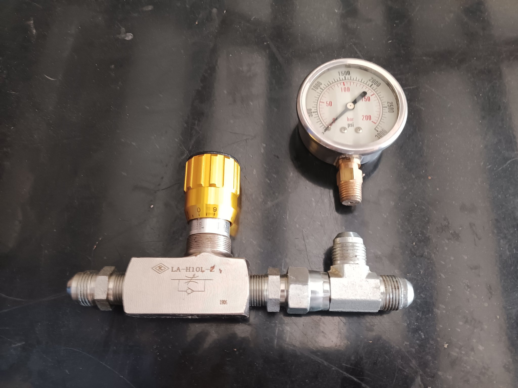

Here is a basic test rig.
Right end goes to pump delivery and left end goes to sump. You hook it in, open the flow control valve to max, and start the tractor. Then slowly close the flow control while watching pressure rise. You dhould get to 2500 PSI with the valve partially open. I can whip one up if you want.
10,058
5,367
Yes sir that would be money well spent for me. So I would just need 2 short hoses to hook to the male ends on the tractor
Yes, in this case you can just replace the factory U-tube with the test equipment.
I will get this made up ASAP. Are you OK with male JIC-08 ends?

Yes sir that’s fine and I can get two short hoses made to fit the nipples on the tractor.
