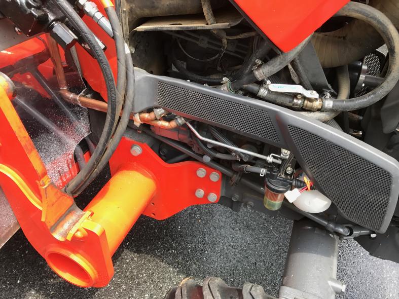

Here is what is in relief valve location.
Is this possibly a bypass plug of some sort?

My guess would be that the component might be a special fitting used for temporarily defeating the relief valve as part of a testing procedure, or as part of the installatiion of another optional hydraulic function where relief valve function normally at this location is intentionally moved further upstream. Howver all of that is a RANK GUESS - which, given the service history of this machine is an irresponsible way to approach it. What does Messick's say about this part?

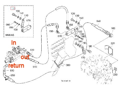

That is a factory part, you have a valve assembly for a LA1002-61R/6R1, and yes it was installed on that tractor model, and no it does not have a relief valve, just has that plug that you are showing us.
Now as far as testing and pressures.
Make 100% sure that In/Pressure is plumbed to In/Pressure, PB/Out is Plumbed to PB/Out, and Tank/Return is Plumbed to Tank/Return.
Use a gauge connected to Quick connector set and a tee, and put that on one of the lift or roll lines and bottom the ram out both ways, that will give you the proper test pressure reading.
Now if it all tests out fine, then many a different things could have happened, like relief valve stuck, or maybe just the pump crapped out, no real way for us to tell.

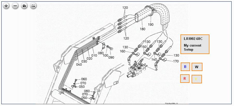

Thank You Wolfman! I Appreciate that information, based on what you said. I have some questions to be clear.
I have a LA1002-68C loader, see serial pic below. My hose hookup from tractor is like below. It is my understanding that the pressure in is forward hose and PB is rear hose or if looking at it from right side of tractor, the pressure in is closest to the pump on right side of online block and PB is second from pump or left side of block.
Is this a correct statement?
If so, my PB and Pressure in hoses are opposite of the 68C hookup below.
Should I swap them?
Was it common to put a 68R/6R1 control valve on a 68C loader or is this something someone has done after factory?

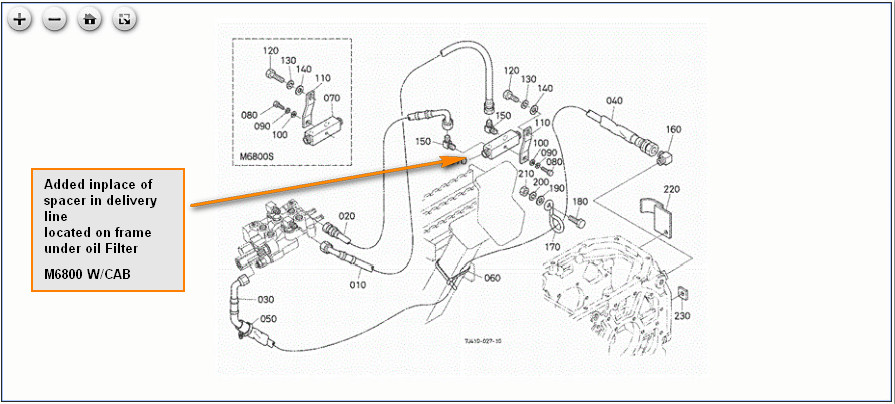

The Moment we have all been waiting for.... In Short, The Control Valve I have on my Loader belongs on a LA1002-68R and will not work on My M6800 SDT W/CAB and LA1002-68C loader.
I will explain why along with Diagrams. Please bare with me its been a long night of research, but I believe I can say with confidence, this mystery is solved.

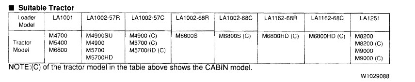

I will start with a section from WSM for LA1002 Loaders. Please look at the snap shot from my manual.
The only Model the LA1002-68R is compatible with is M6800S (No CAB)
The LA1002-68C is for Cab type.
Now why is this a problem?

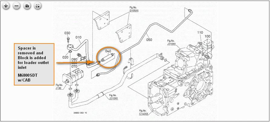

Well, the 68C Pump and Power Beyond Lines are inline right after pump.
Prior to any relief valve, That is why the 68C has a relief valve
See illustrations

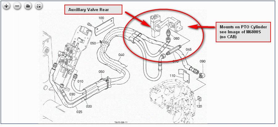

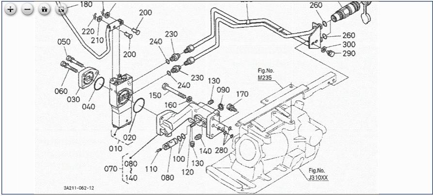

Now the LA1002-68R is only compatible with M6800S- NO CAB.
Therefore, the control valve is mounted on the loader and the Pump and Power beyond hydraulic lines are supplied from the accessory mounting arm connected directly to the 3PT Cylinder AFTER THE RELIEF VALVE.
See M6800S no cab below
As for why my loader does not work when I hook the Pump and PB lines up correctly. I will explain in a second post Shortly.
See illustrations

For whatever Reason, the Lift(yellow) and Curl(Red) Lines are swapped on the 68R vs the 68C in regards to position they are hooked up on Control valve. I am assuming the Internals are slightly different because the 68R is operated with lever mounted directly to it and the 68C has lines running from the CAB. The Pump, PB, and Return lines are the same. I would have to get the internal schematics to find out why 68R works on mine when I have the Pump, and PB lines inverted. I bet if I swapped the loader lines and the Pump and PB lines the loader will work, however still with no relief.
Looks Like someone put some thought into this setup to get it to work. Obviously, with disregard to the fact that it would not have relief. I suppose the gentleman I bought it from could have used it for years with out ever maxing the pressure long enough to blow anything, but I doubt it. I used it an hour and blew 3 hoses and a pump:mad:. I will ask him tomorrow at work.
