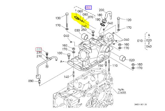

Hi Wolfman, does the front case on this engine (4 cyl 3.3L) get forced engine oil or is it a splash system? Is the forward pump chamber steering or main hydraulics? The suction side of the forward chamber's seal must be getting submerged in engine oil somehow (??)
The pump on this model is different than most other tractors in that it sits below the fuel pump and thus is under the oil line and or might be getting oil forced to it from the gears in front of it. ;)

Good pictures -
In view of this tractor's difficult hydraulic history it would make sense to take the pump
apart and inspect everything. The damaged seal looks like there could be more damaged
seals further in allowing pressure to get to the outside seal.
At some point in the past the system may have been dead-headed without a functioning
relief valve, possibly damaging the internal seals. Normally the relief valves protect the pump
unless defeated or bypassed somehow (log splitter? pump testing?)
The 060 seal kit 35890-12970 contains the internal seals at the gears - 2 kits per chamber.
Good luck - and good doing so far.. Take care, Dick B

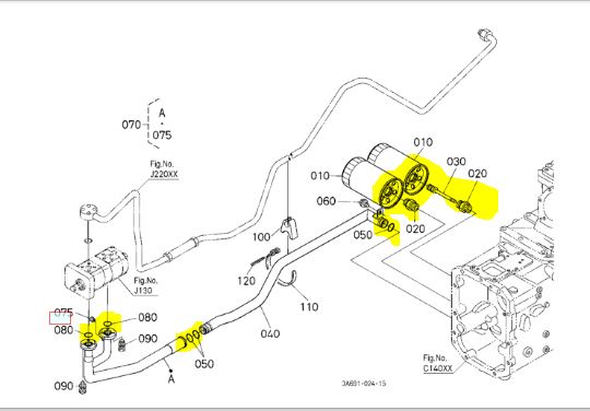

I would be checking the relief valve, a bad Valve could be causing the pump to over pressure and blow the seals.
Also a pump can blow the seals if it cavitates and sucks air.
Have you replaced all the O-rings that seal the system?
I would also be doing a pressure test.
There will also be relief valve in the loader valve that could be bad and causing you issues too.
Relief Valve:
Suction line seal points:

The original problem before pump replacement was air in the system. Dealer only replaced pump and 2 pressure side o rings on top side of pump.
When new pump was installed, I blew 3 loader hoses in the first hour of operation. 1 hose for loader lift, 2nd was the short supply hose from pressure line to loader control valve. 3rd was on tilt of bucket.
I ended up changing all loader hoses, including both supply hoses and big return line on loader control.
With that said, the foam would return (visible on hydraulic dipstick) immediately after starting tractor. I believed the air being compressed is what was blowing hoses. I then replaced the five orings sealing the suction line. At this point the foam seemed to be gone after a short run. Different from before when foam would return immediately. So, I assumed I fixed the problem. Well, that brings me to the engine oil problem we are currently dealing with. I did not run the tractor hard or for very long periods prior to this point for fear of air bubbles in hydro fluid causing damage.
So.... here we are with what I believe is a sealed suction line and a blown front seal on pump.
Next steps????
I have new seal coming today for pump shaft.
Should I disassemble rest of pump?
What is best way to test pressure relief valve on PTO and loader? Or should I just change them?
I should also note: the dealer technician (prior to pump install) checked pressure on the accessory port on top of PTO and it read just over 2500 PSI while lever was held open.
I appreciate any and all feedback.
