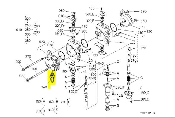

The loader is a LA1002-68C with the B00104 control valve. I could not see a relief valve in the diagram, I will post next.
Looking at the relief valve above PTO it looks like it has not been touched from Factory. Paint on adjusting screw and nut has zero marks on it.

Here is the loader relief valve:

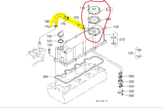

You have a engine venting issue!
I'll have to do some research, but it sounds like you have a PCV valve that is plugged.

Yea that's not right at all.
And just to confirm that was with the oil set at the proper level too right?
Pull the line off in yellow ad check for air flow out of the engine, if none then you have an issue with the PVC valve (in red).

Thanks Wolfman, I ordered the complete assembly for breather valve.

I assume there is no adjustment on this relief valve like in the PTO?

Both relief valves are or should be adjustable.
You might want to go one step further and pull the valve cover to clean the PVC incoming screen and ports. ;)

I wonder if the technician that told me pump should be 3500 psi, may have set one of the relief valves that high.
Also, I have the other loader control than one you posted earlier in the week. I have the one that is under return hose on flat control valve
