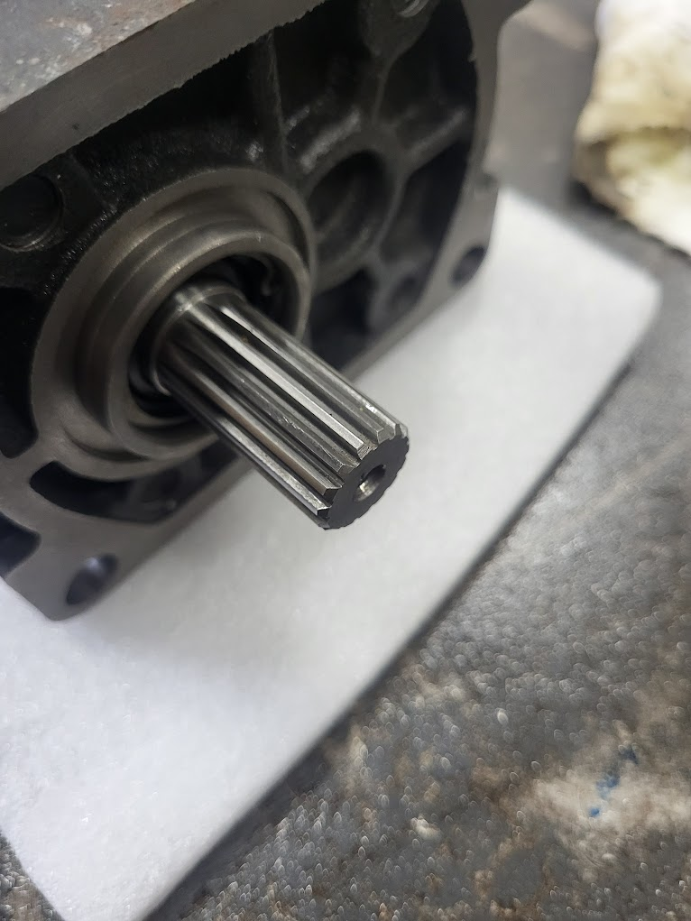

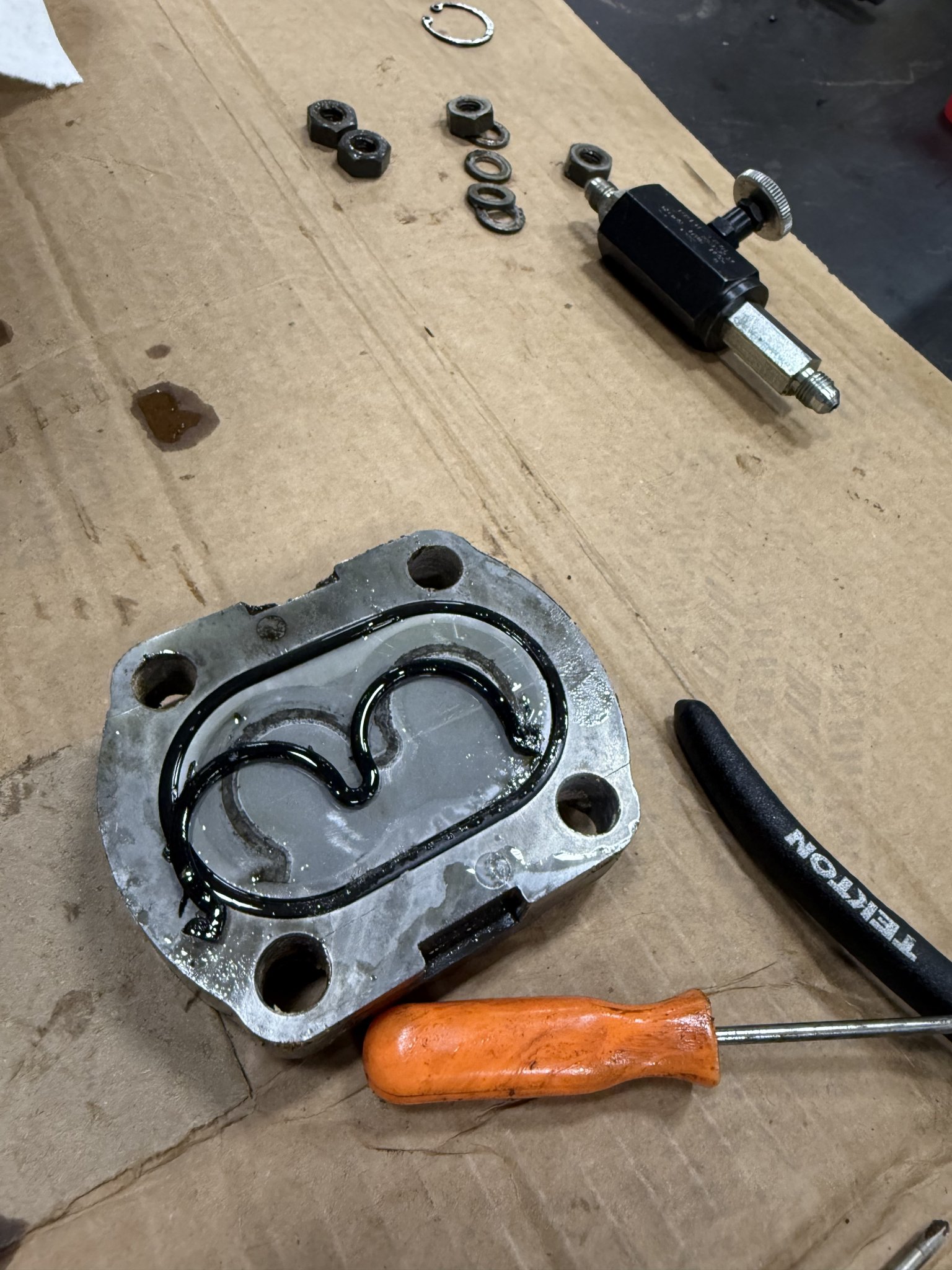

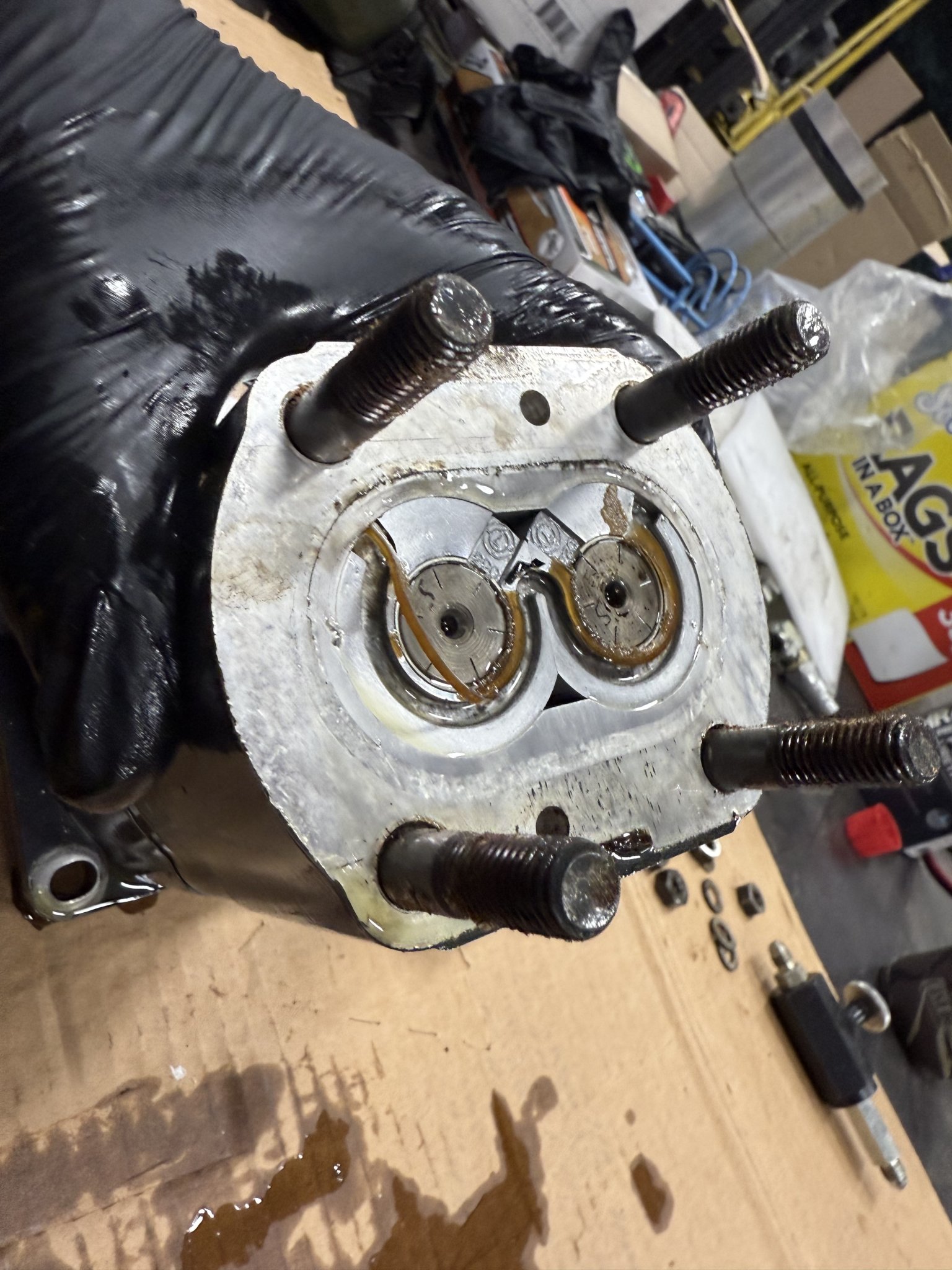

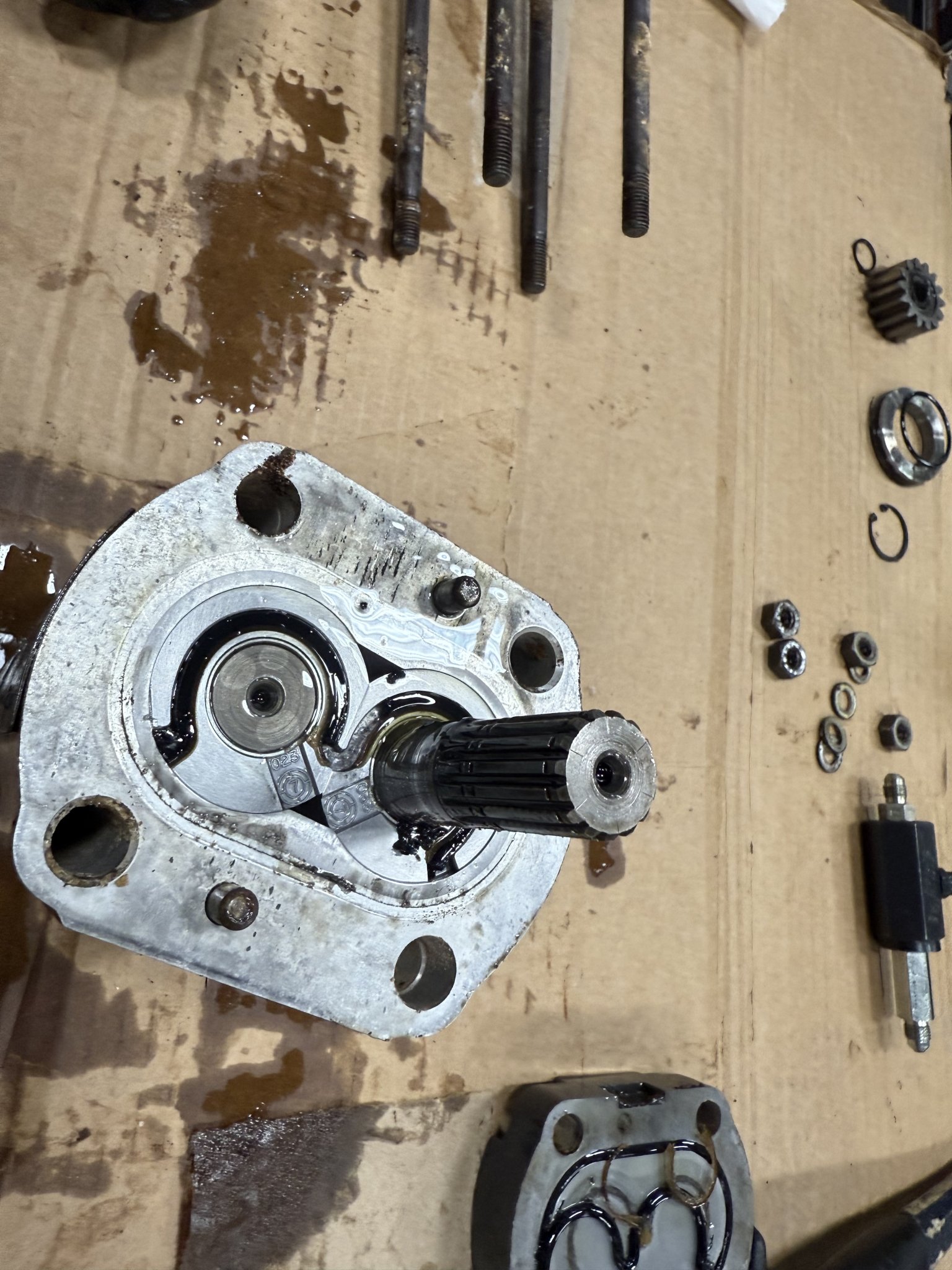

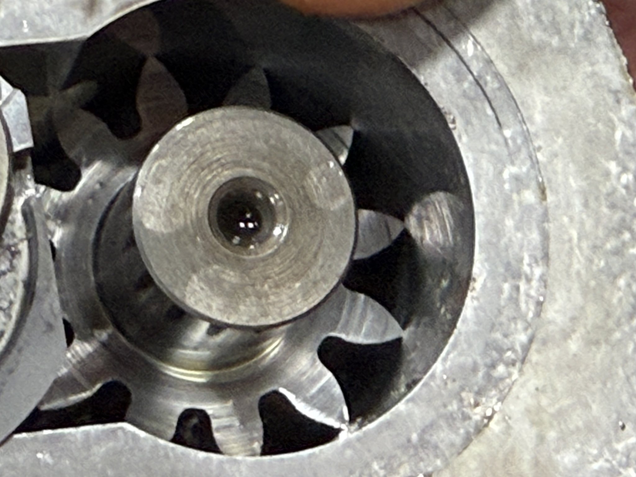

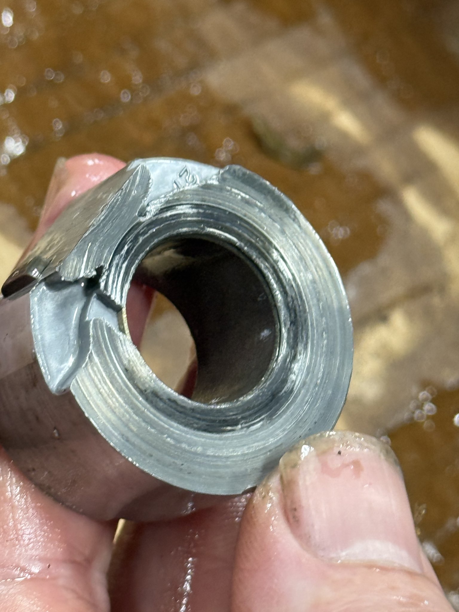

Alright experts, seal kit? Worth a try for $100? I thought there was varnish in there at first, but looks like it's a backer.
The only real concerning thing I can see is the wear on the aluminum bushing holders. Not actually sure what they are called.
Pics. IMG_4694.jpg IMG_4694.jpg IMG_4695.jpg IMG_4696.jpg IMG_4697.jpg IMG_4699.jpg
13,202
7,452
Pics. View attachment 155574 View attachment 155574 View attachment 155575 View attachment 155576 View attachment 155577 View attachment 155578
The pump has self destructed from oil starvation or over pressure. A seal kit is not going to fix it. If the new pump will fit put it on. If not a new OEM pump is $2K.
I could cut the intake tubes and reweld them to fit this pump, or make an adapter plate, but with the shaft also not having the two grooves for the snap rings, I'm worried about what else in the pump is wrong. I'm probably just going to buy an OEM pump.
What I really want to know is why this pump failed at that moment, so the new pump doesn't fail the same way. There was plenty of fluid at the time of failure. All I had done for the previous 6 hours was use the mower and push around a little dirt from irrigation ditches with the loader. There was not lack of power, noise, etc...
The seals were not in good shape. Did the seal cause the failure or did failure chew up the seals?
I will add another line to the cylinder on the mower. Maybe 1000's of times of hitting the relief valve pressure caused this? The last time was just the straw that broke the camels back?
The new gear is probably pressed on or retained in some other fashion. I doubt its a manufacturing defect and would not worry me in the least. There are probably other internal differences.
I am assuming the bushing blocks in the old pump are also wear plates. A common design technique is to provide an internal oil passage that uses the oil pressure generated by the pumping gears to push a movable wear plate up against the gears. That compensates for normal wear and limits oil loss (slip) caused by excessive end clearances. From the looks of your failure the wear plates were destroyed by the gears. Two things come to mind - excessive pressure and/or insufficient oil. I dont think the case seals had a role in the failure.

The gear is probably pressed on or retained in some other fashion. I doubt its a manufacturing defect and would not worry me in the least. There are probably other intermal differences.
I'd still have to cut grooves for snap rings to locate my gear correctly.
Ok, but why now when it wasn't really being used hard? Mainly, I just don't want to repeat this.

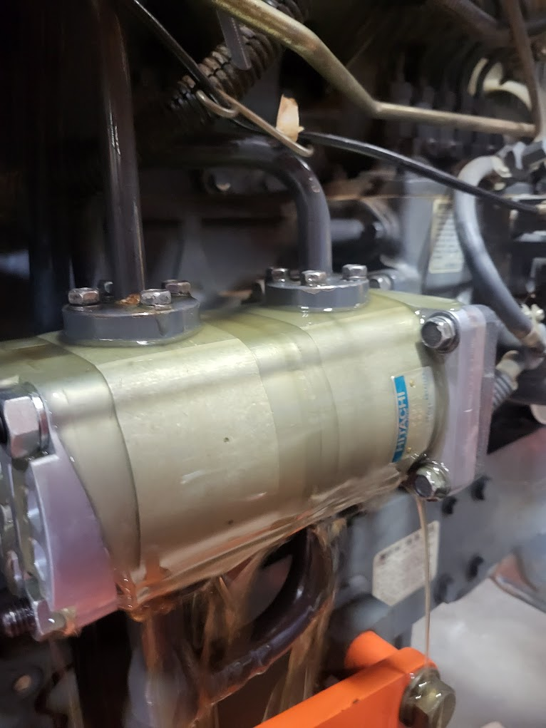

Finally got the pump in yesterday. Looks like this ordeal is over.
After installation, I had the relief valve almost all the way out and started up the tractor for very short periods and couldn't get any flow. I did this less than a handful of times and less than 10 seconds. Enough to know that the pump wasn't getting oil. I had searched on bleeding and priming and didn't see anything in the manual or many posts regarding this.
I cracked both outputs, pulled the engine stop and cranked. It probably took 5 times of cranking for the main pump to burp and even longer for the steering pump. I did this until I had good flow. Bolted both outputs back down and immediately had pressure after it started up. I hope this might help someone in the future.
Pump had some pretty thick assembly lube in it, so not too worried about the initial startups.
Now to set the relief pressure and get this thing buttoned up.
I think I'm going to sample the fluid in 5 hours or something arbitrary.
