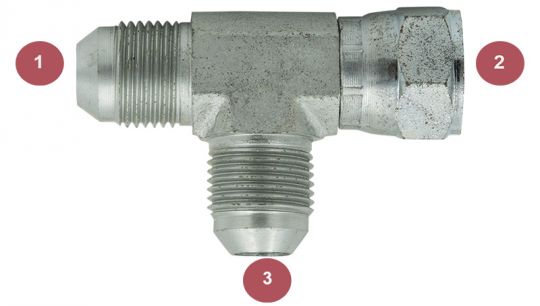

This type tee and a JIC cap will let you hook in for both tests with minimal changeover.

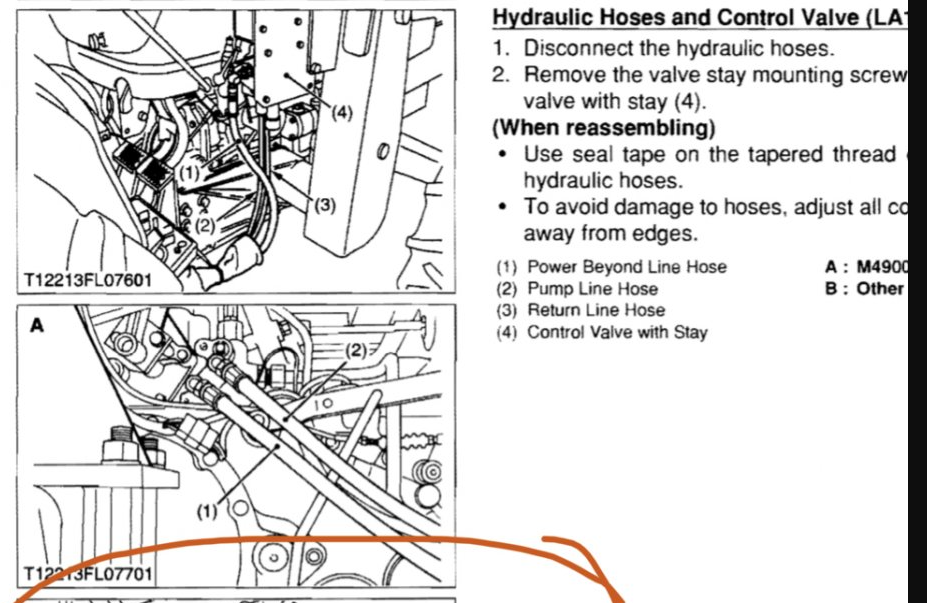

Hmm, this thread from 10 years ago has me concerned about what port is the power beyond. https://www.tractorbynet.com/forums...yond-line-hose-installation-to-loader.323149/
I have the manual that came with the loader from the original owner. It's labeled differently than the pics in the post above, even though it looks like it's the same valve block. Definitely double checking tomorrow when I get to the shop.
Edit: Found this snippet from another thread. This confirms what my manual shows, however, I think a few people mentioned it's the port with the "extra nut". There definitely was a port on the side of the valve block that had a stacked nut on it. I'll look where it goes on the tractor tomorrow.

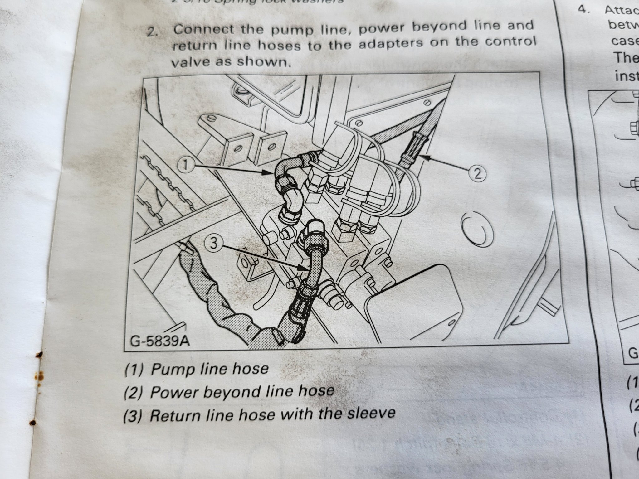

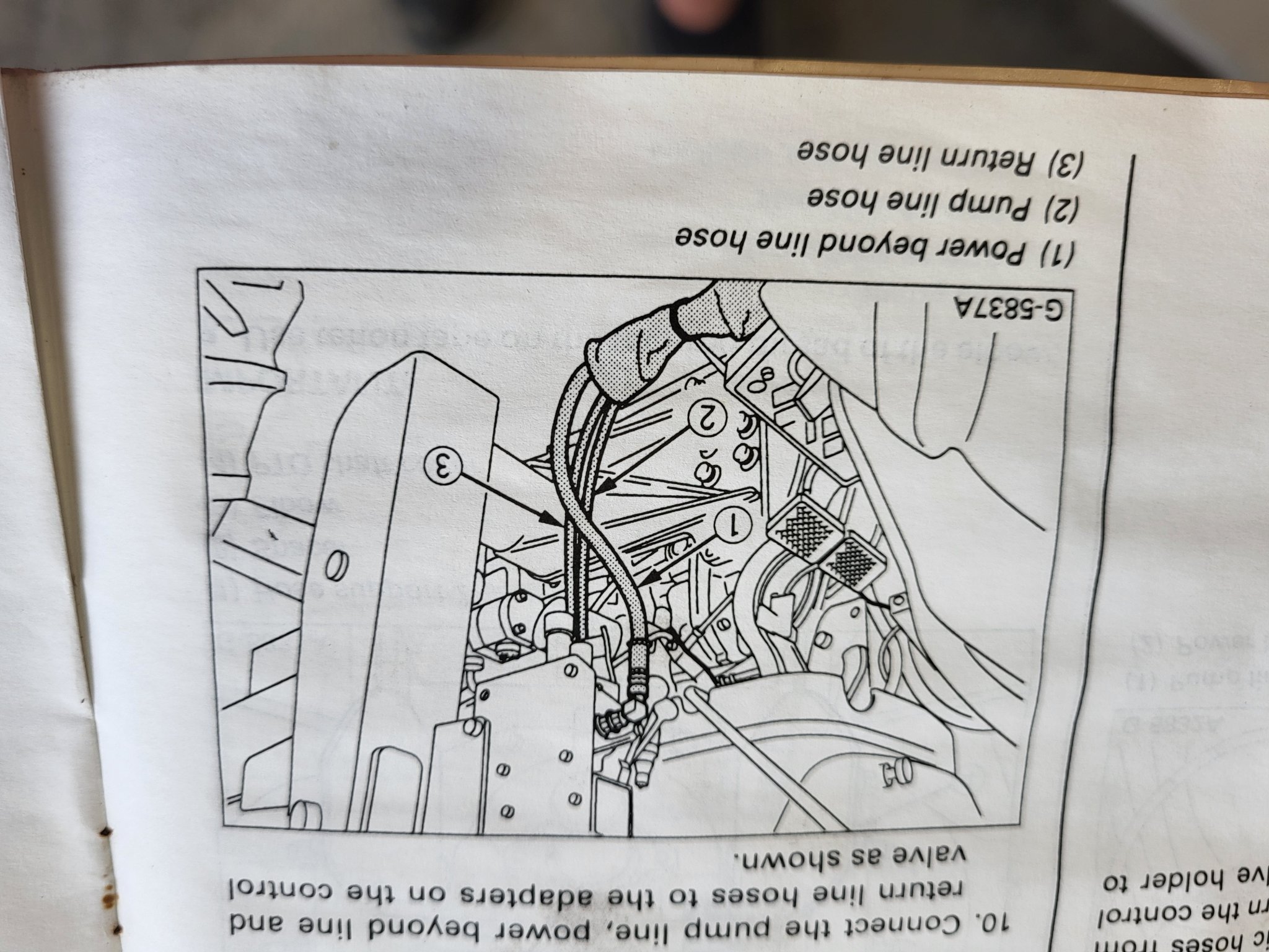

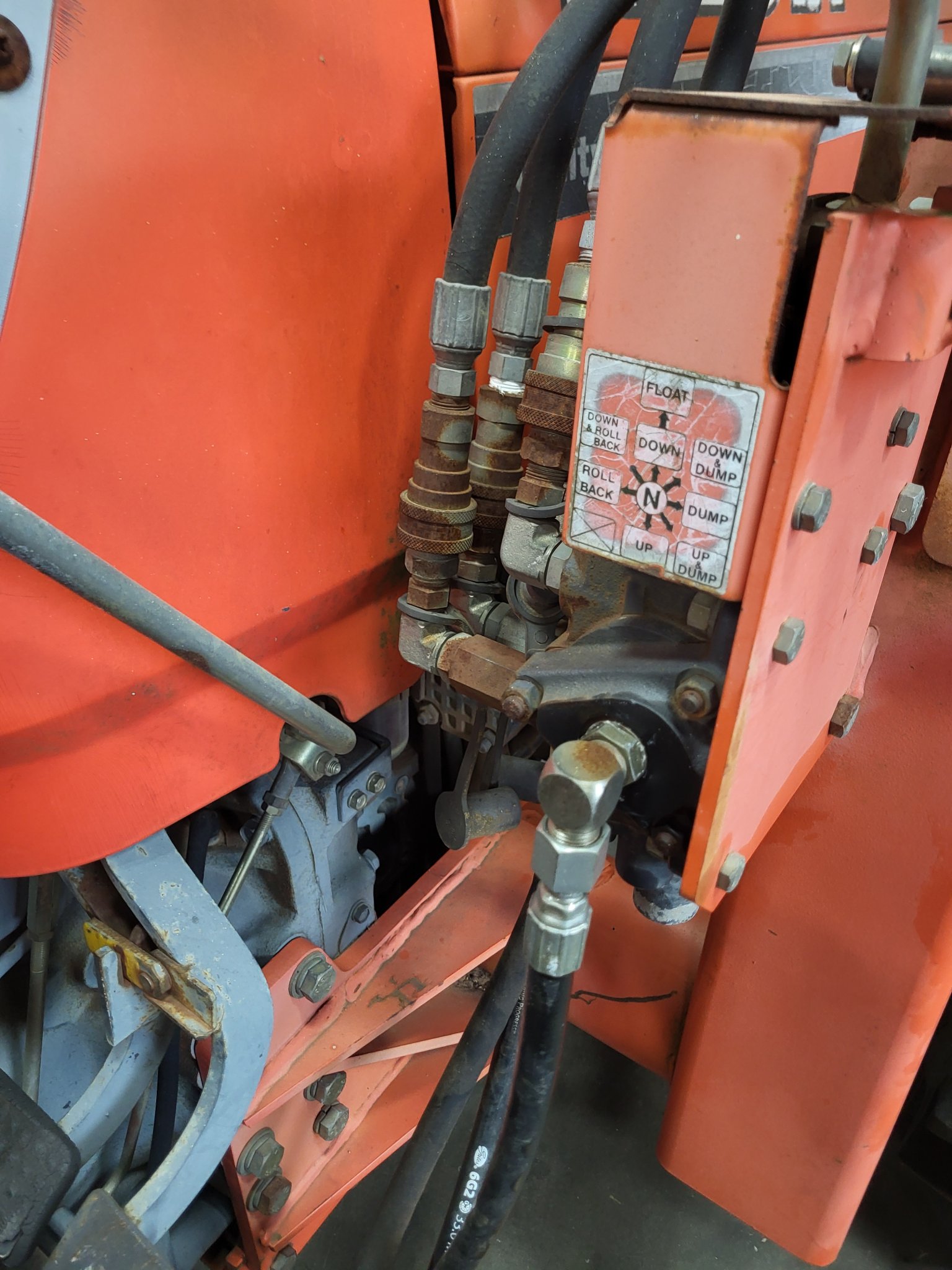

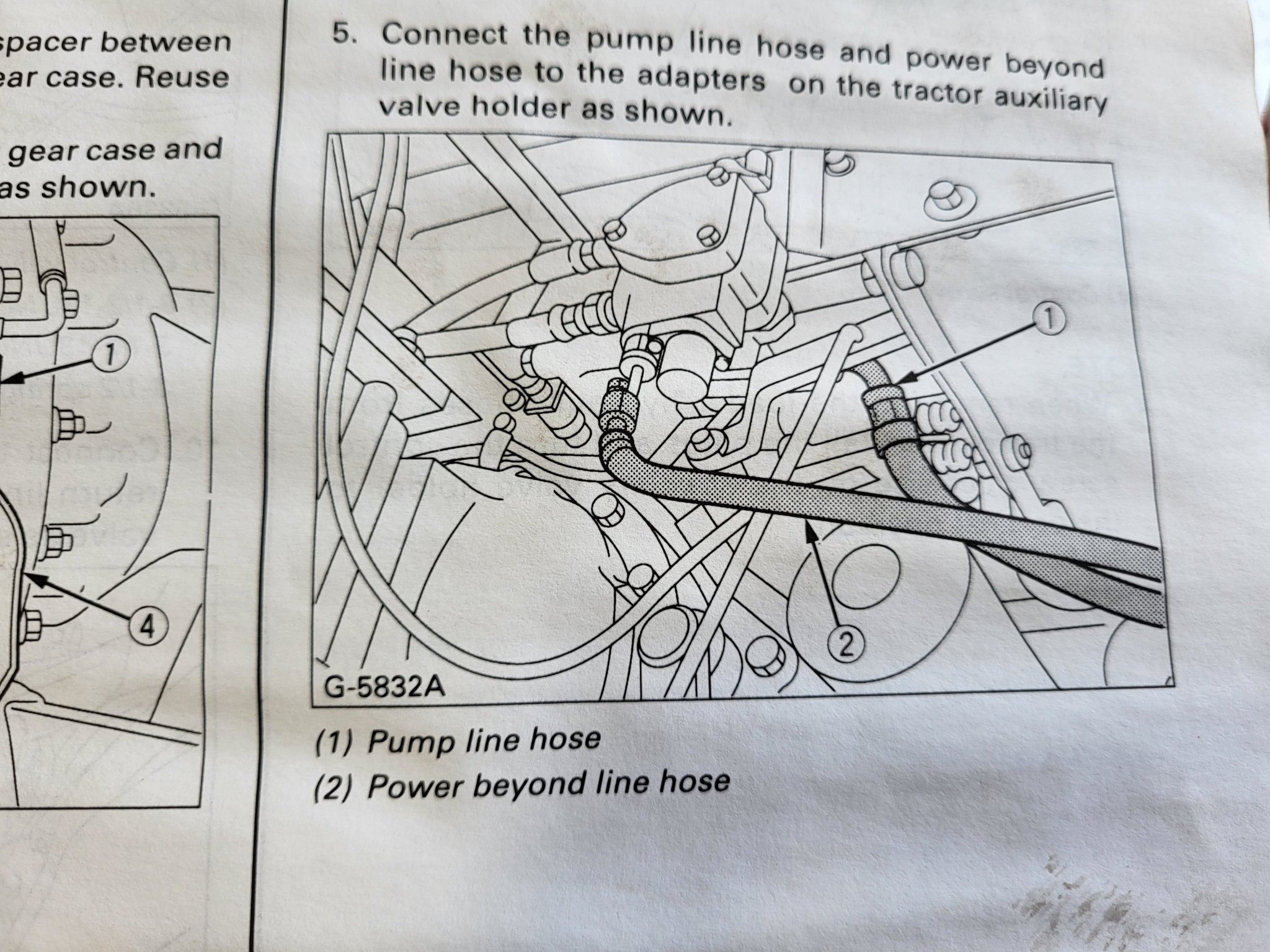

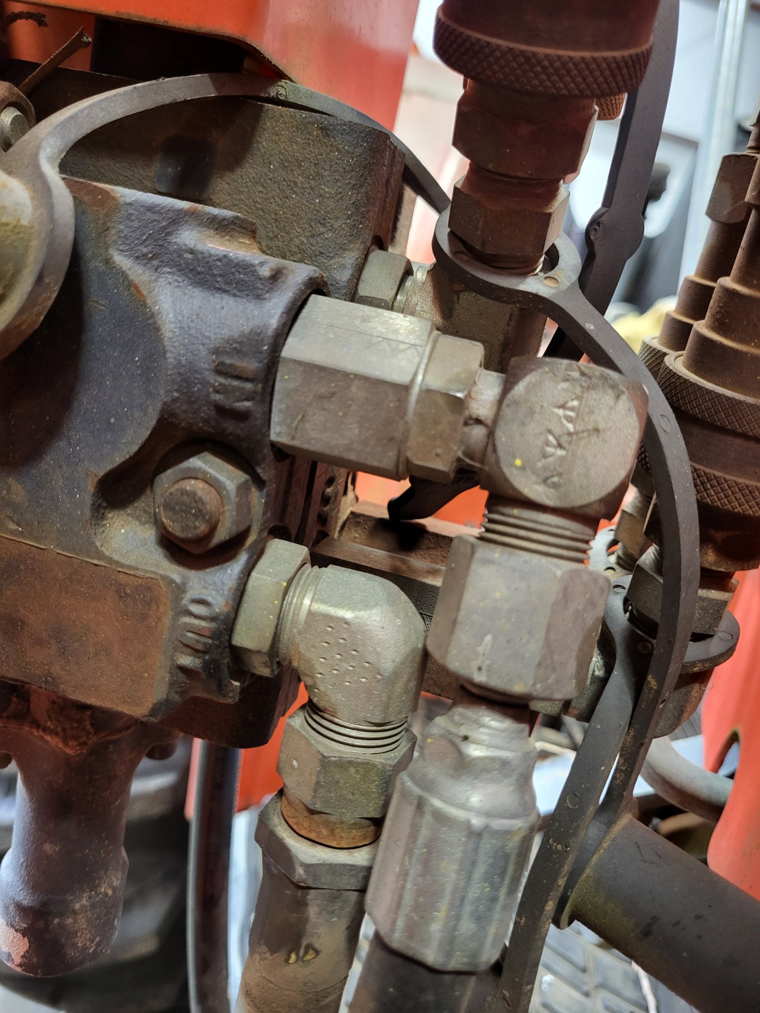

What did you remove from that port before installing the swivel fitting? Put things back as they were originally and post some pictures of that.
13,172
7,420
The lines on my loader are hooked up exactly as in the manual that came the tractor from the previous owner. Attached are pictures of my loader and the pictures from the manual.
Thats quite clear.
Disconnect the hose on the port labeled IN and connect your gauge to the hose. What pressure do you get there?

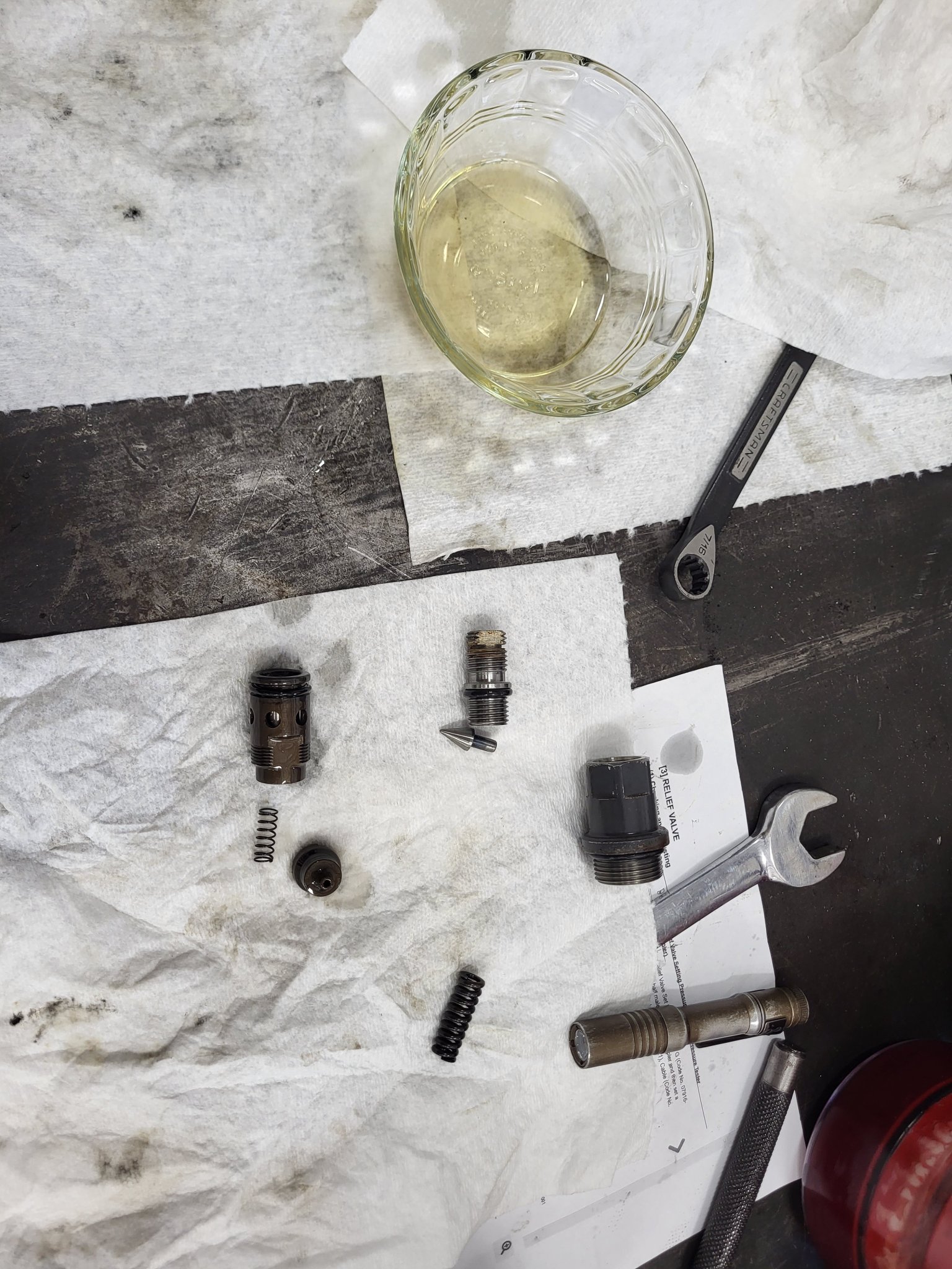

I will second the "well crap". Are you sure you removed the relief valve and not the safety valve?
I am also of the same mind as you with regard to the pump. Just to be sure about your inlet pressure test. You removed the hose connected to the IN port and screwed the gauge DIRECTLY onto the end of the hose. No tees or branches?
About 99.9% sure. Here is valve I took out and inspected. And yes, I hooked the gauge directly to the hose.
Not sure where to go from here. Is there another relief valve in the 3pt system? I'm hesitant to mess with the pump because I think I'll just end up with the same result.
