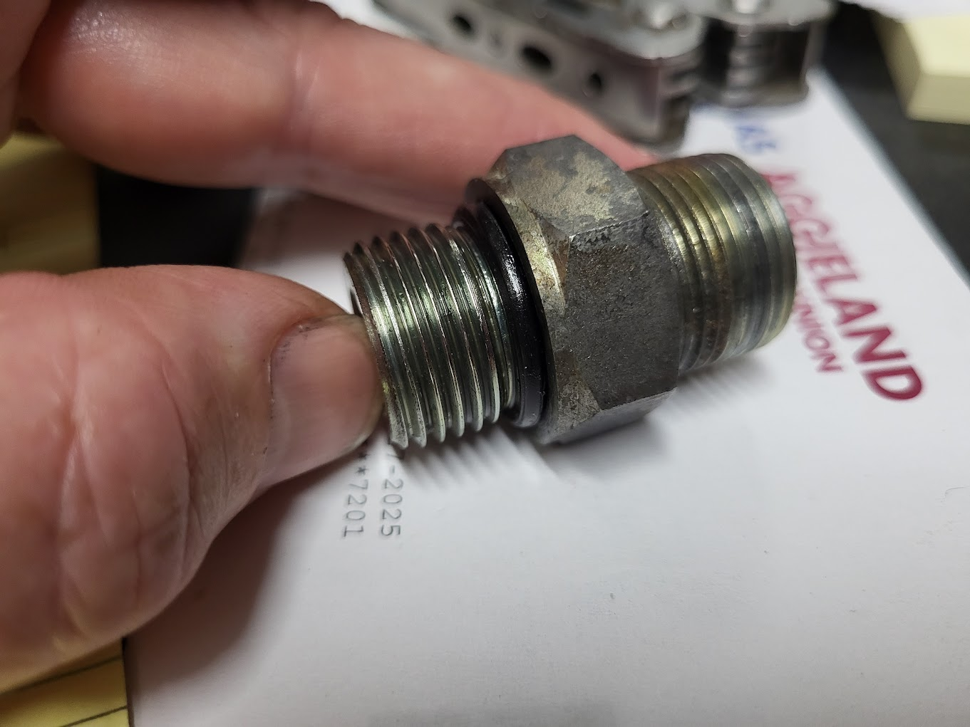

Adapter plate is no problem for me to make, but I'm too busy to machine something right now. I'm going to go by the hydraulic shop tomorrow. It looks like a BSP with o-ring for a seal. 1747858936498.png
13,291
7,487
Adapter plate is no problem for me to make, but I'm too busy to machine something right now. I'm going to go by the hydraulic shop tomorrow. It looks like a BSP with o-ring for a seal. View attachment 154910
So you are thinking a male JIC to female BSPP port adapter? Thats not going to be common.
I think you could make that adapter plate in the time it takes to source the BSPP/JIC fitting

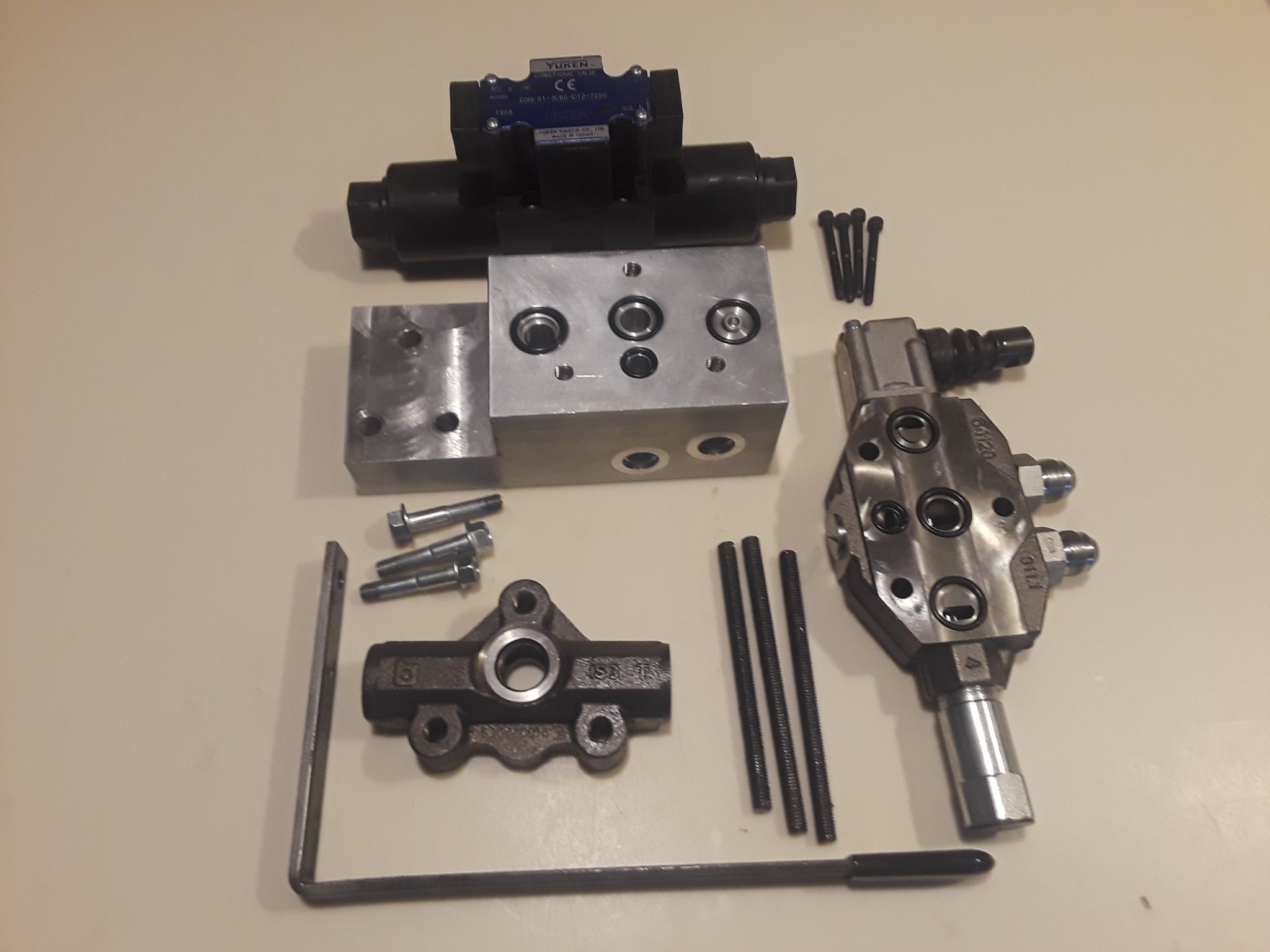

Drill and tap test port then counterbore for -113 oring with a 3/4" endmill. I have done many this way. Here's an example.

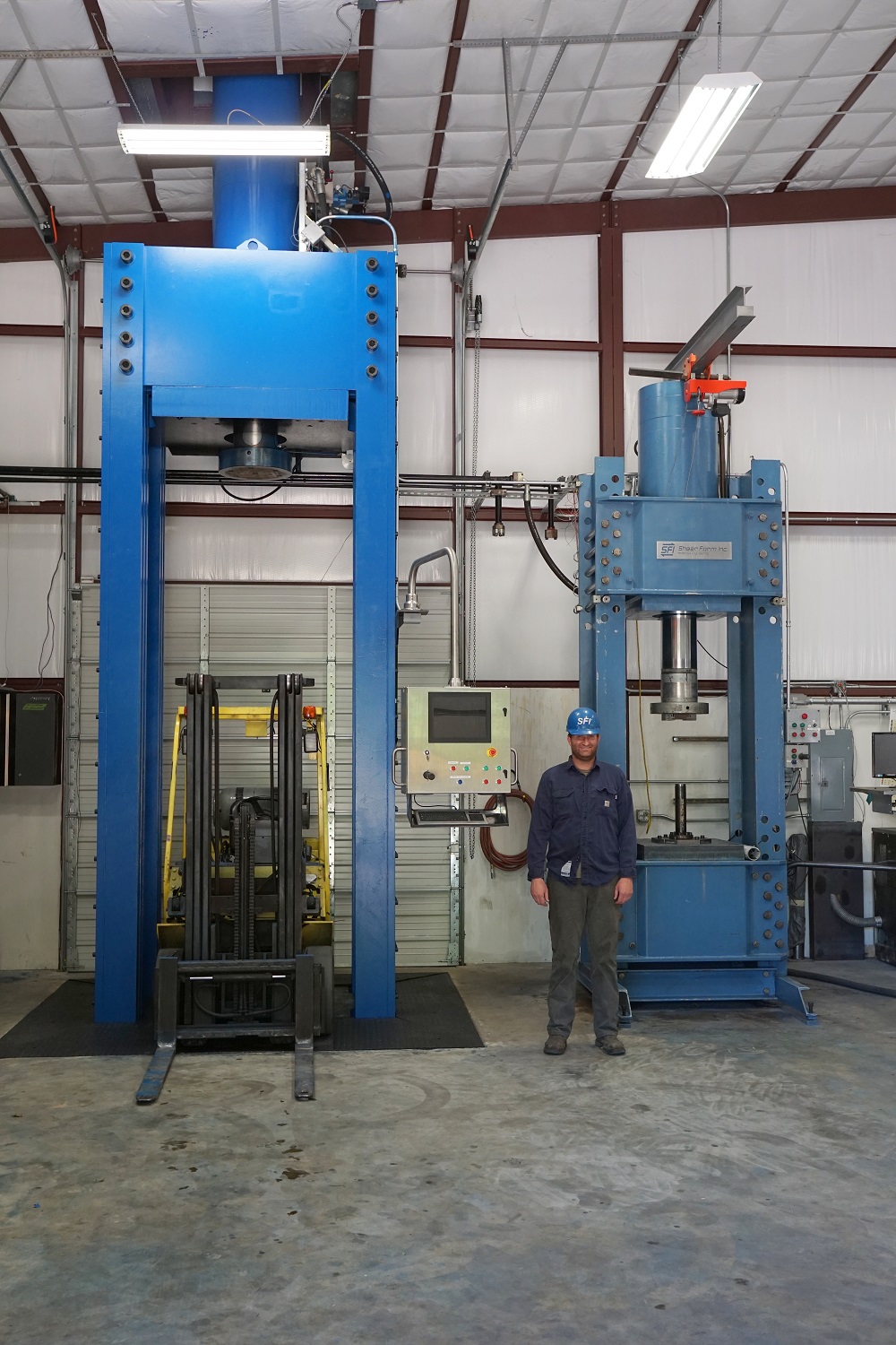

I keep forgetting how small this stuff is... I'm used to working on larger hydraulic crap. I don't do it a lot, but every couple of years we build a press or some kind of odd hydraulic machine.
Anyways, yes, I'm thinking like 1.5" O-rings... Your example will obviously work perfect. I'm stilling going to go by the hydraulic shop as I don't have enough correct hoses fittings to make this happen anyway.
