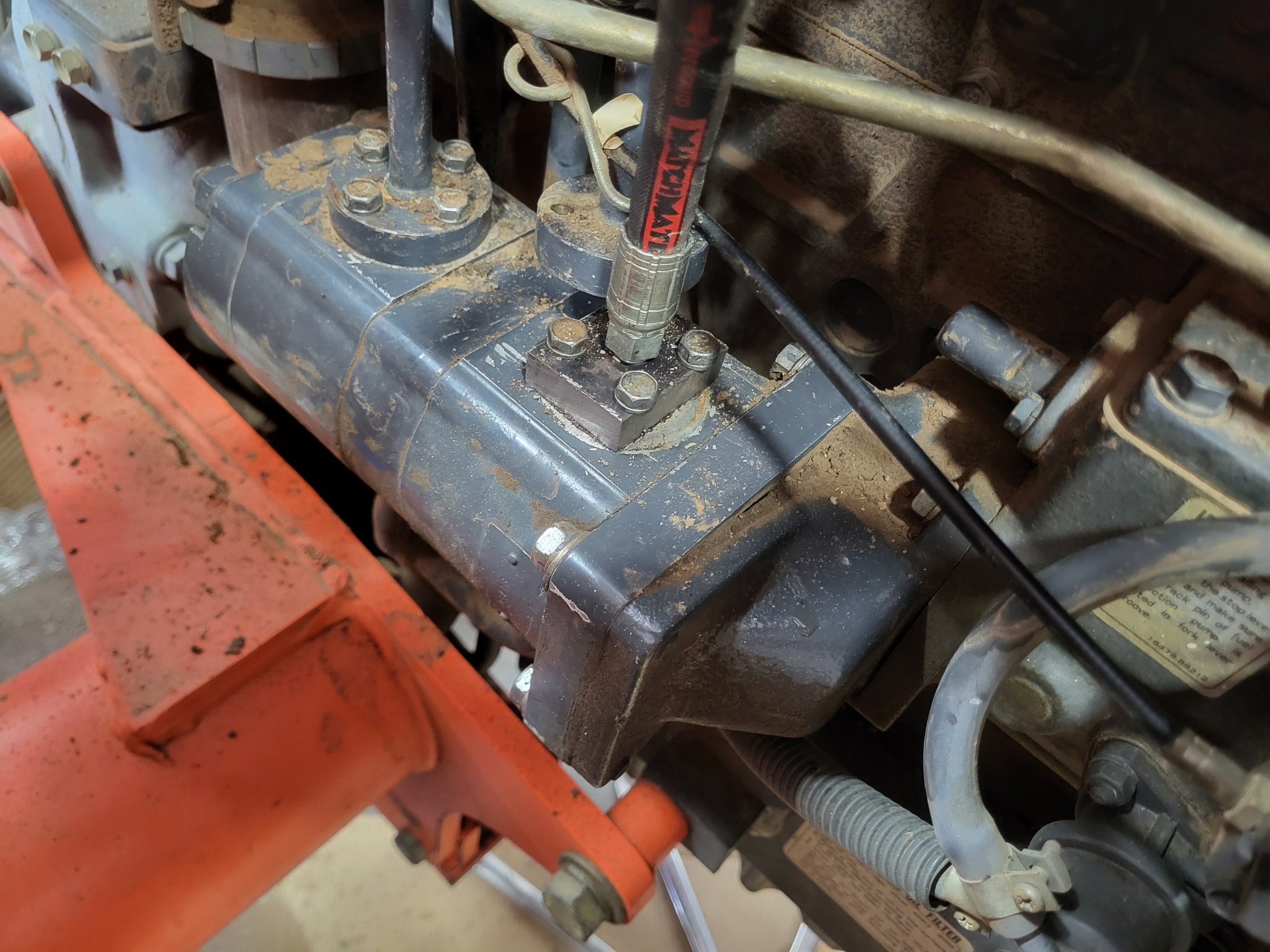

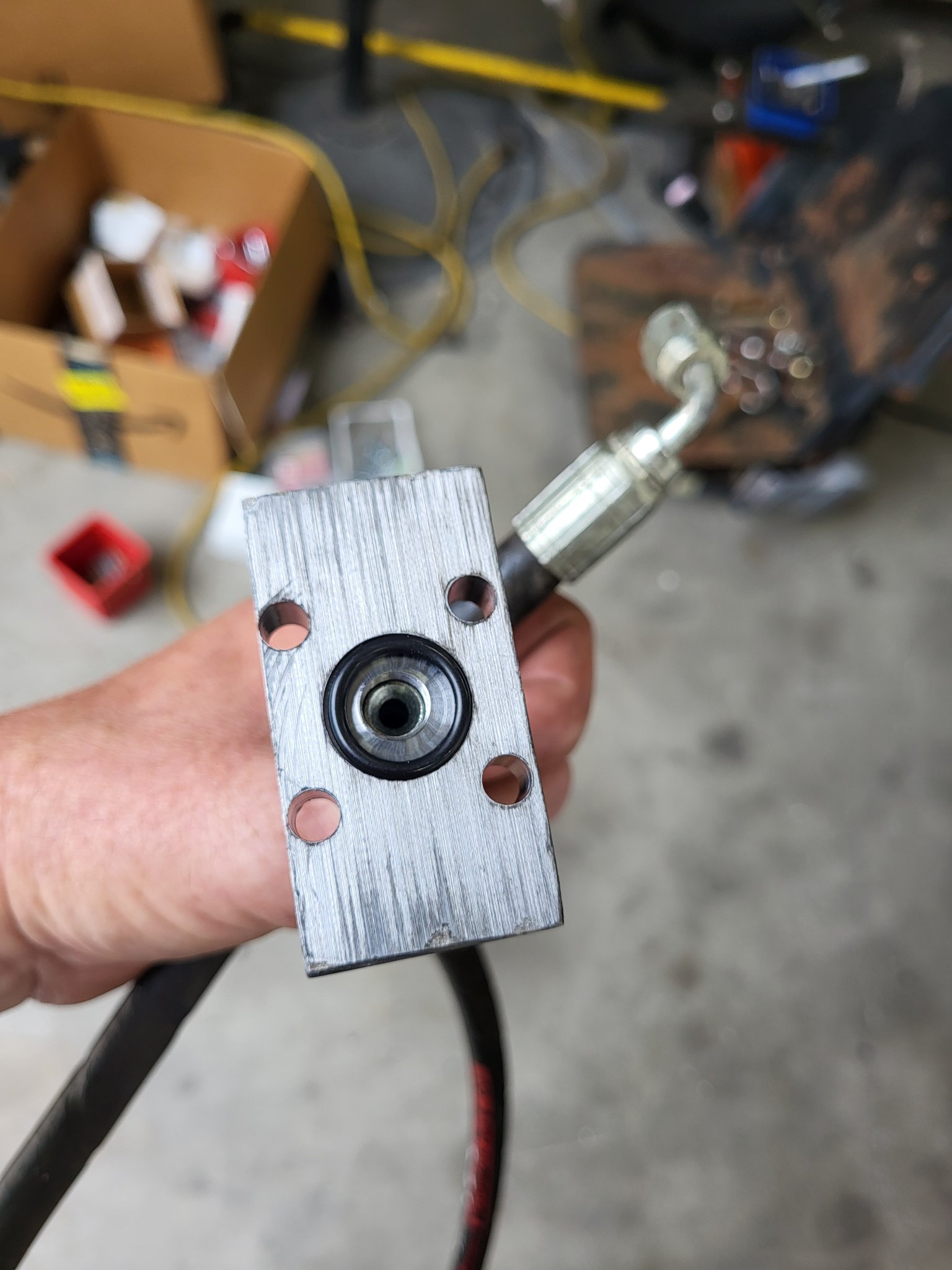

Well crap. Made an adapter, hooked it up, needle valve all the way open, start tractor, keep closing needle valve. Crap, needle valve is completely closed and gauge only reading 750psi at 2300 RPM's.
Going to check intake side for leaks but other than that, I guess it's the pump? The local hydraulic shop says they have a guy that specializes in rebuilding these guys. I guess I'll get a price.
Edit: these Chinese pumps are tempting, I'm assuming garbage.
Edit 2: I still don't understand how the pump shit the bed that fast.

Thats pretty definitive. Buy the mew pump and 86 the rebuild idea. The new pump will outlast you.

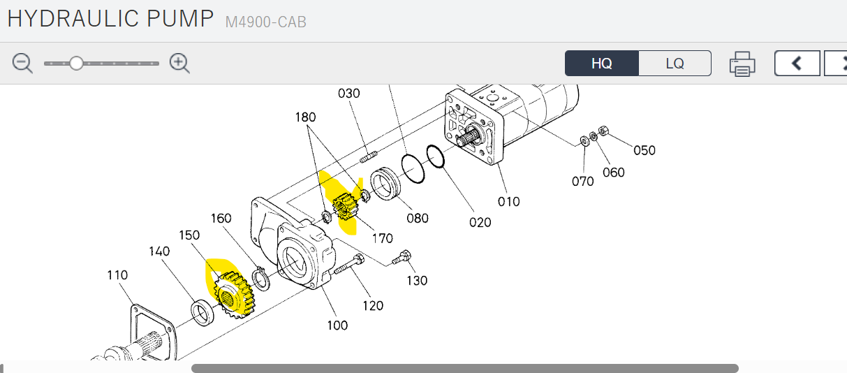

Both of the below statements tell me to check the pump drive!
I heard a noise and the gauge shot up to 1300 psi. I was at about 1800rpms. 3 point is now not working.
I shut it off and then started it back up again and now I have under 700psi again.
The sound came from the front. I'm assuming the pump area since the pressure line isn't hooked to the loader.
36,892
11,567
Pull the Pump drive while looking into this issue.
I've seen drive gears internal splines stripped

Could the drive gear in that section of the pump be slipping on it's shaft ? That would allow the steering section to function normally. It may have sheared it's key, but still have enough grip to pump up to that lower pressure. That would also explain the momentary jump in pressure.
13,291
7,487
The shafts and gears are machined as one piece.
