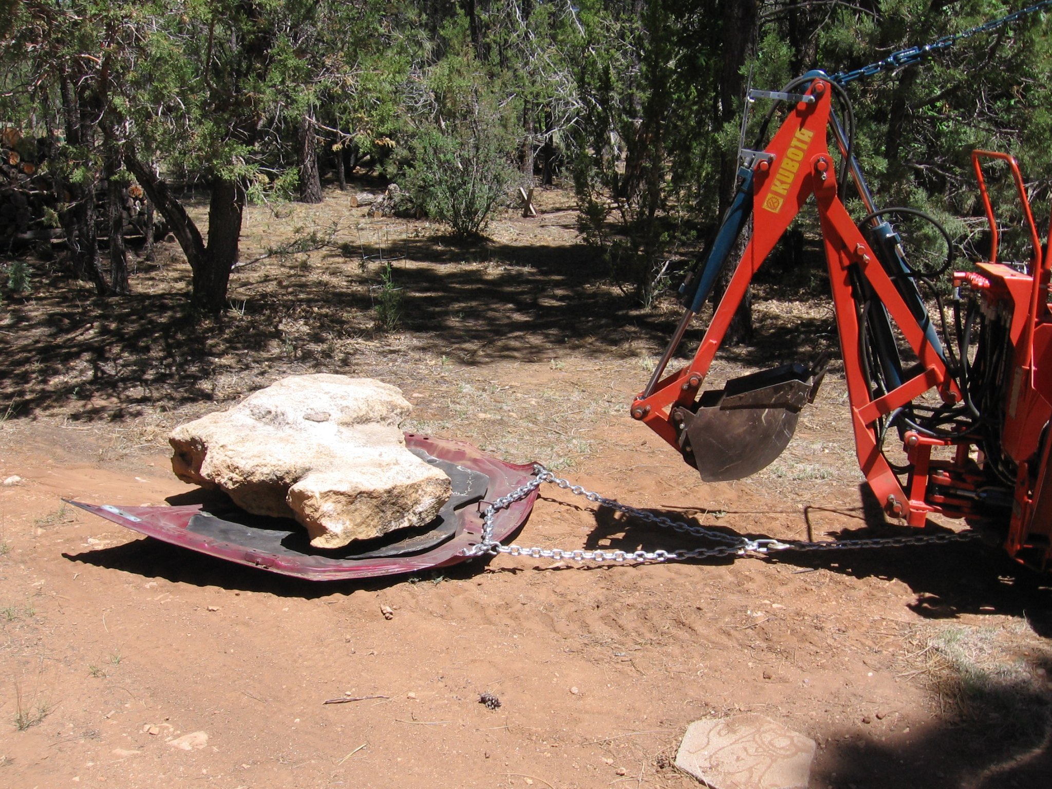

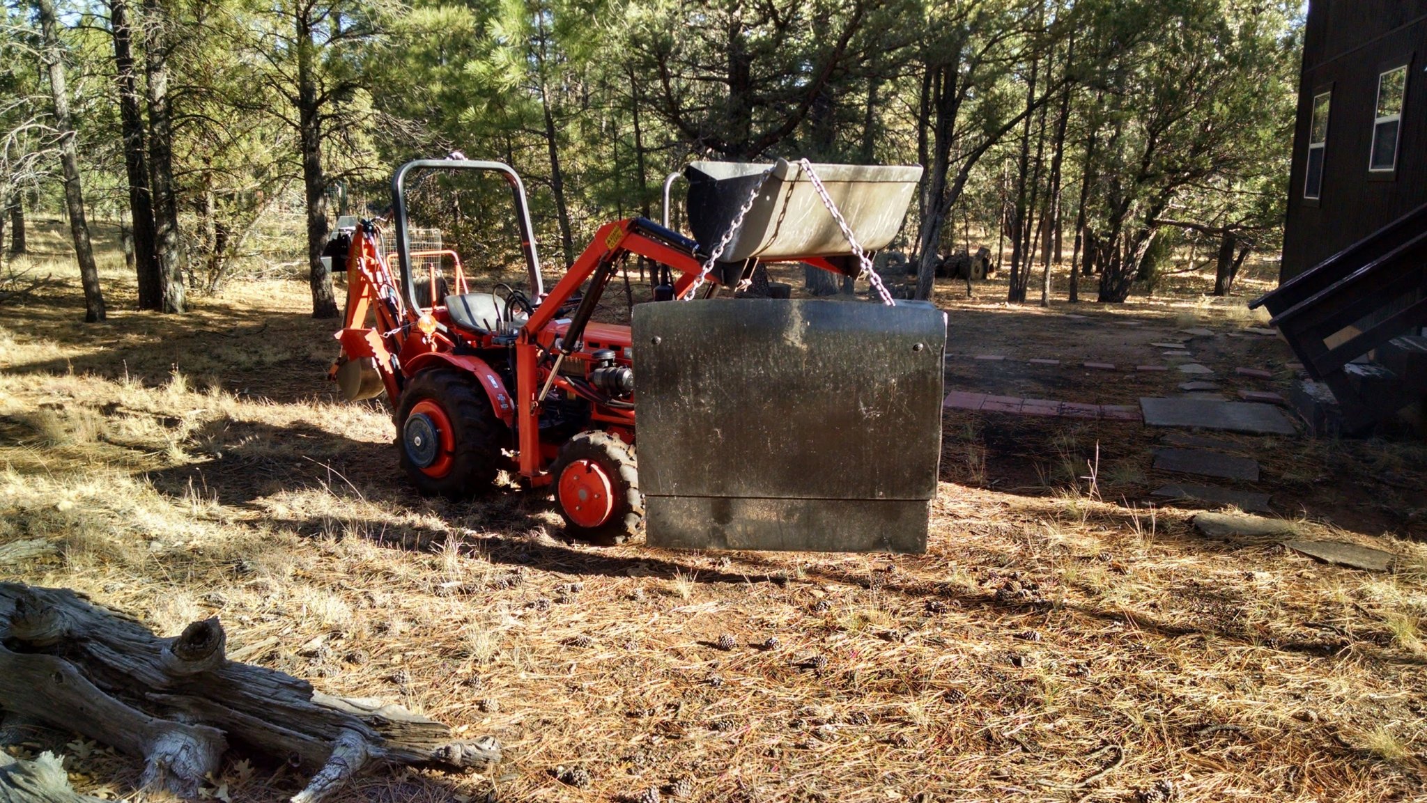

Tell us more about that Rock Sled? Material....how you made it?
Mine is just a truck hood. 2 eye bolts in the front. later this week, i'll get a pic of it. its nothing special, Lil Foot's looks better.
7,877
3,129
It is 1/4" mild steel; the steel supplier called it a mill end.
Apparently it is the start or end of a run of flat sheet, & that leaves it with the compound curve- the curves are just how I picked it up.
It is 48" wide, but it was a little short, so I added the tailpiece from my stash, just bolted on with 5/16-18 bolts.
They had 4 or 5, and I took the longest one. When I went back maybe two weeks later, they had none.
As soon as I saw it, I knew it would make a perfect skid. (or rock boat)
It's only disadvantage is that it is too heavy to move by hand, but I have a tractor for that. :)
I had used a car hood in the past, but they don't last long, and are full of sharp edges.

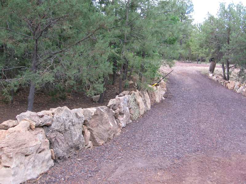

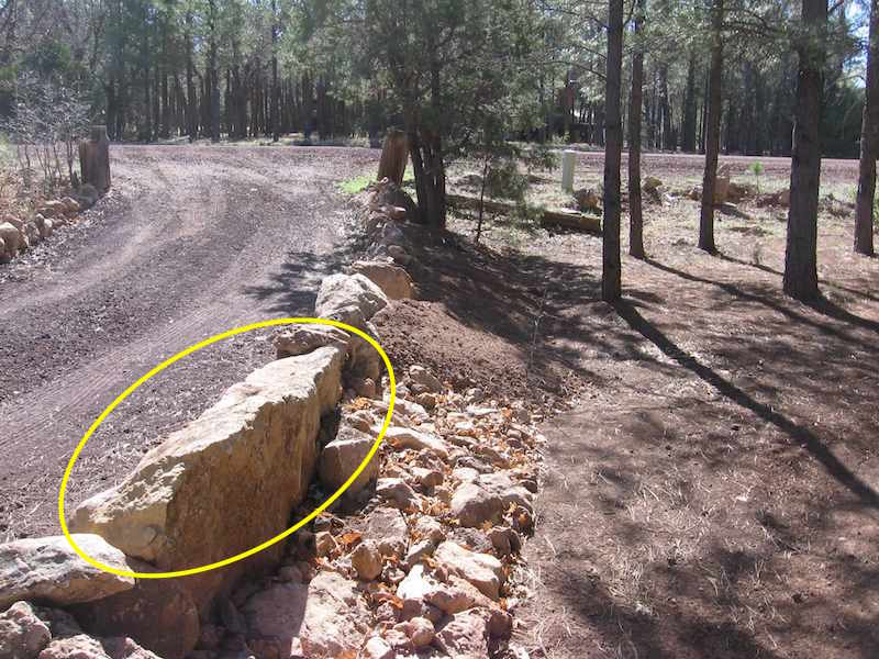

It is amazing how big a rock can be moved with the skid. The 3 big rocks (from left) in the first pic were all bigger than the one in the pic above, and the one in the yellow circle was probably at least 3 times the size and weight of them. When I pulled it down the county road, you could hear it crushing the gravel to dust.

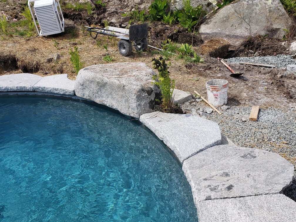

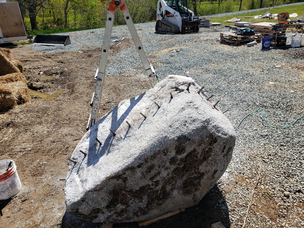

Just get your bucket under half the rock then wrap a chain around the rock and drag it to where you want it to go.
Or split it.
Dexpan works but Feather wedges will be able to split 100 rocks before they wear out, dexpan is one shot and done.
You can get a set of feather wedges for cheap on Amazon. Youll need a hammer drill or Rotary hammer and bit to drill holes either way. You can rent one of those for cheap.
This is a 9000lb rock i split and used one half to place on the end of a pool as a jumping rock.
