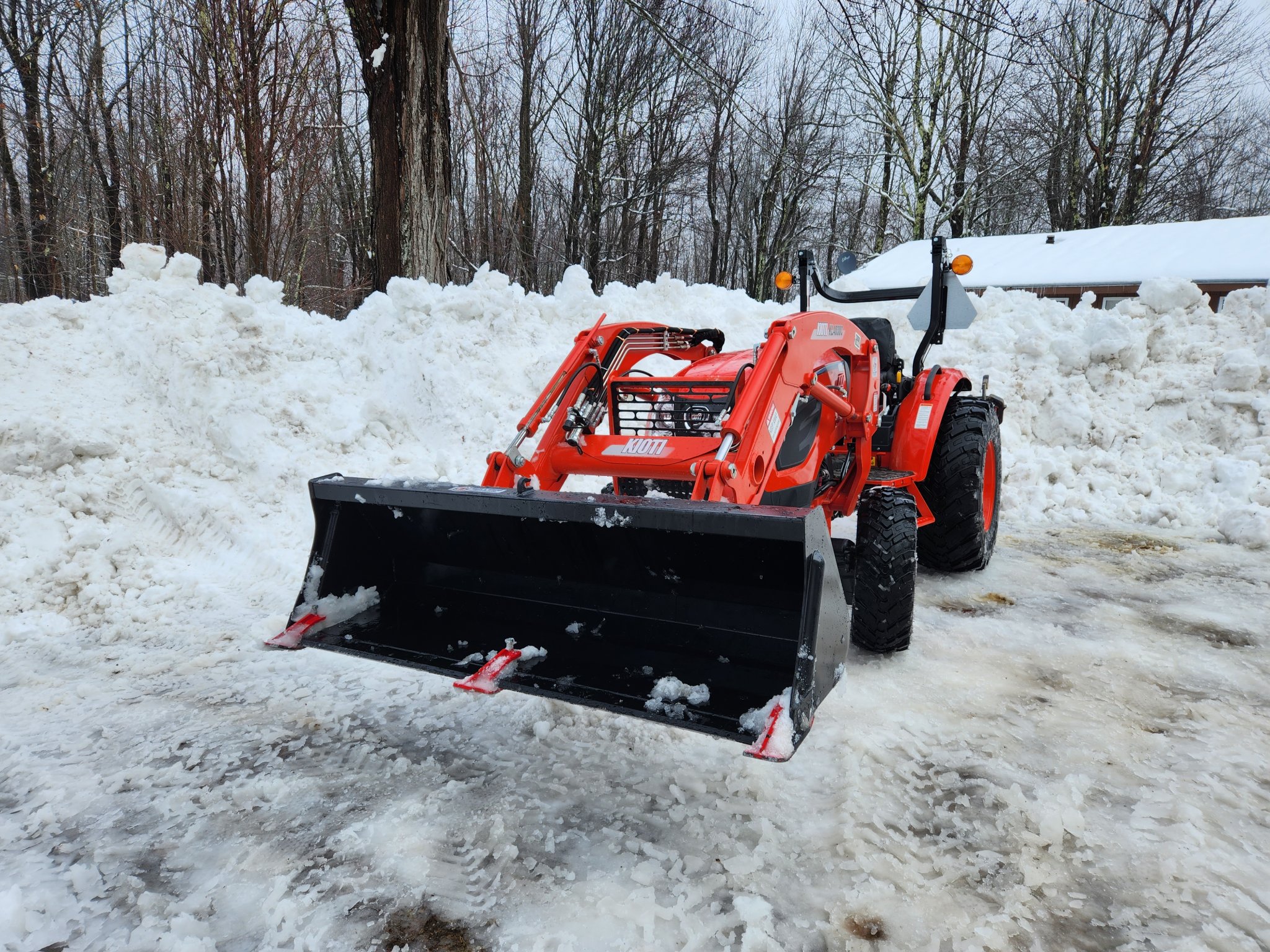

From my experiences it will depend on the range you're in; running about 2.2k RPM in mid-range I can start to feel the machine bog down and I'll back off, in low-range it'll lift it's own ass end up.
This is while breaking into large snow banks.
So the HST range affects loader hydraulic pressure also? I can't recall if I was in M or L necessarily. I just know that with 300 lbs on the back of the box blade it would neither lift the rear or the front. The engine loads up but does not bog down. 2k rpm on the infotainment panel.
The machine may have bogged down more to it coming to a standstill than the pressure applied to the loader, now that I think of it. I'm not knowledgeable enough with hydraulics to really give you any detailed answers, but I can't think of a time when having a load on my 3 point seemed to have a negative impact on my loader.

The CK2610 comes in about 2700 lbs without loader , R4 tires. Real close to the L2501. I tend to agree. I do not feel as if I would like more capacity than my L2501, loaded R4 tires and some rear ballast and LA525 loader is able to muster. I however do tend to be conservative when operating unlike a famous implement maker when testing his new designs to the limit! LOL.
