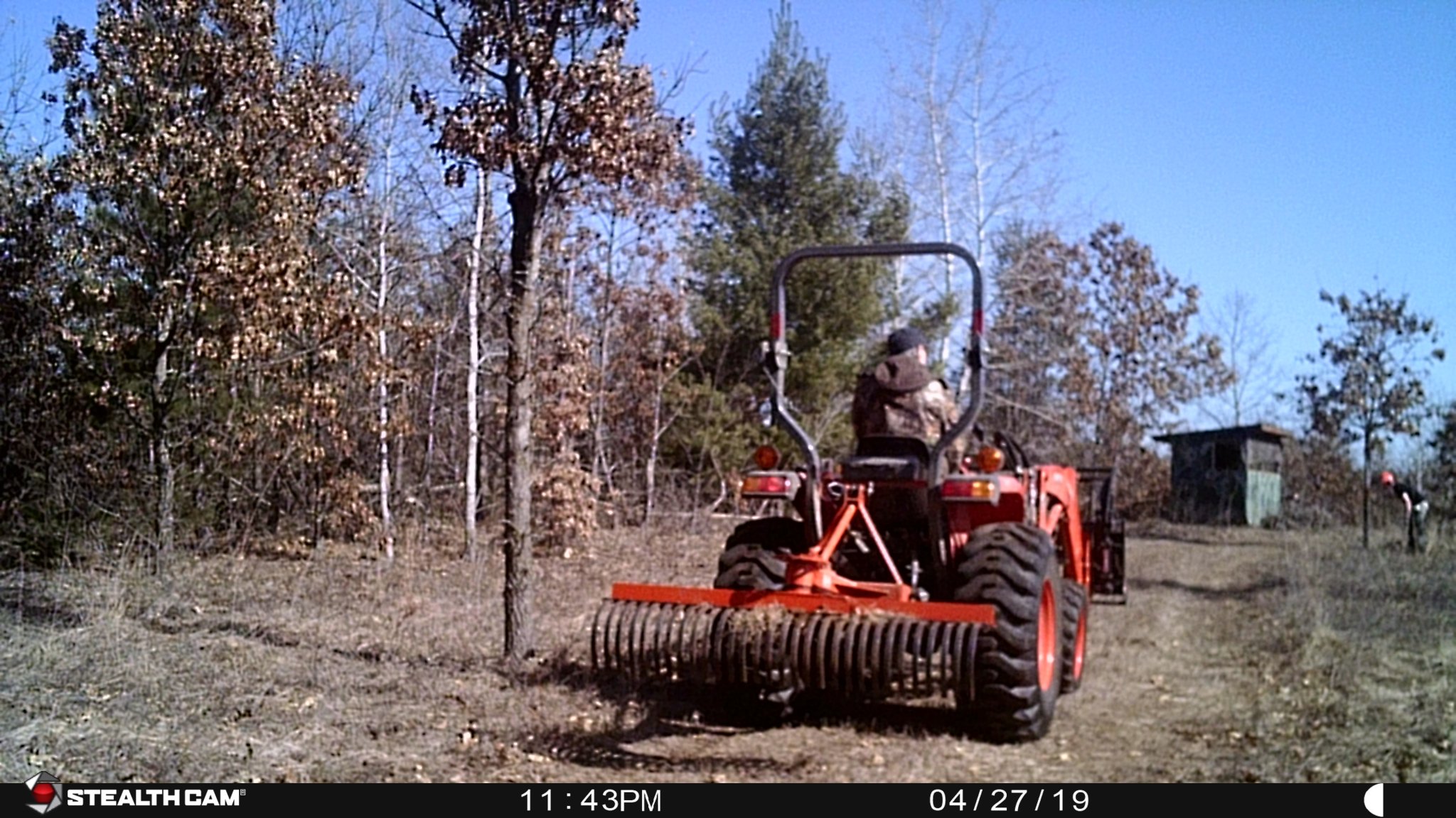

I borrow a neighbor's 7ft beast for a stab at collecting rocks out of large newly graded areas - It generally works well, but the composition of my "soil" is partially rock to some degree.
Also works GREAT for doing the same on trails and evening out erosion gullies on gravel powerline 2 track across my property that I use to walk dog all seasons. FWIW It has the wheel kit which I have come to realize is a game changer for these uses. I am on a ridge so it's a constant fight with newly emerged rocks

I have a 6' and a 7'. I use the 7' with the top link shortened as much as possible and drag a field to spread "cow pies". Does a nice job as long as they are not rock hard. I may have to wait a couple days after a rain in that case.
Also good for ranking gravel and other material.
Also use to rake area of pine trees to clear cones and other debris.
