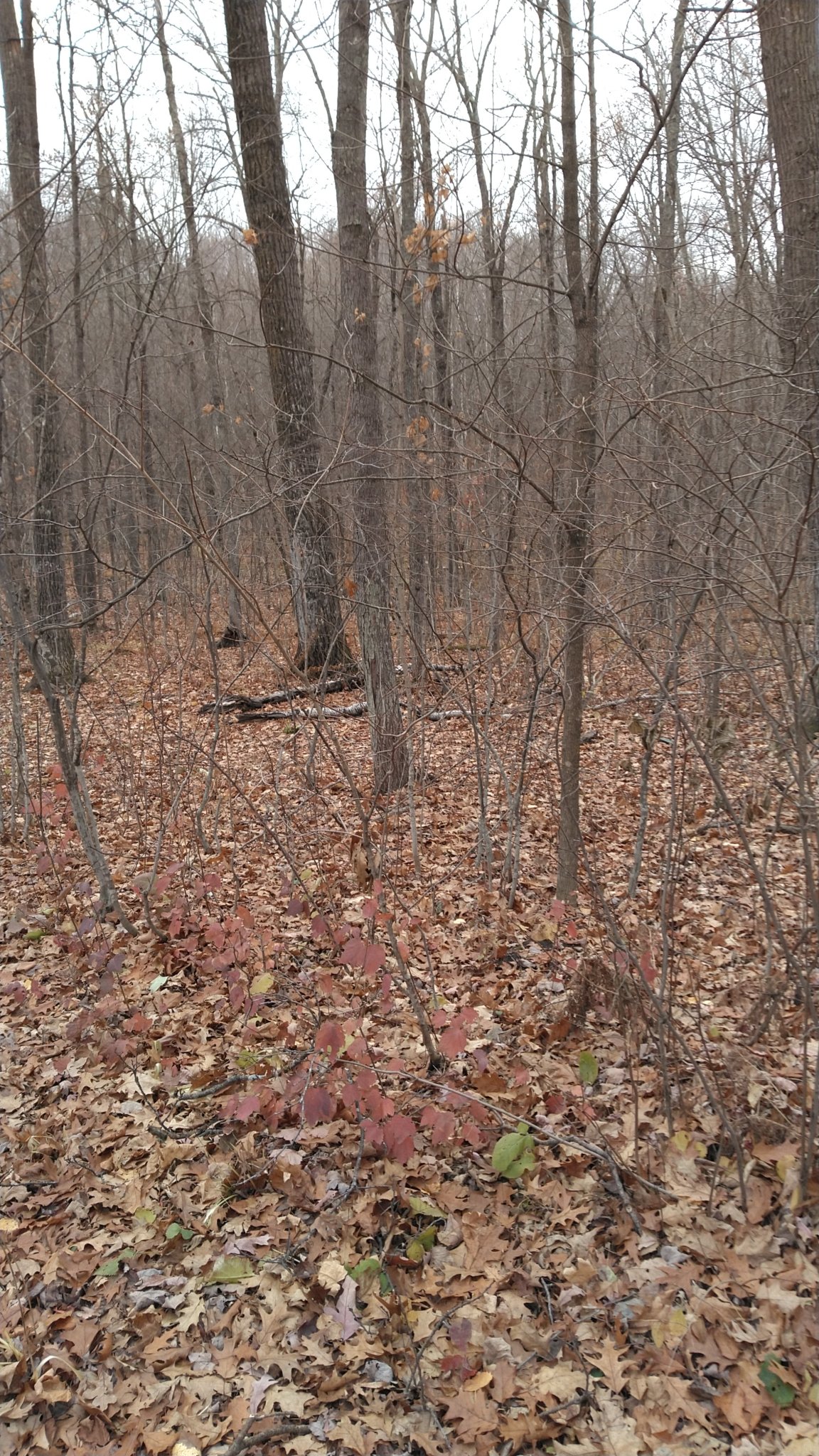

Thanks. That's excellent. Put an essential saw blade on my Stihl string trimmer.
I plan to do that for areas I can't drive a tractor into.
I find it hard to believe that there isn't a tractor implement made for clearing out 1" or less saplings.

I was going by the statement the op made “I'd like to clear out anything 1" dia trunk and smaller in some areas.”
That doesn’t give me the impression he was talking about clearing that land down to dirt Removing everything By that statement. No I don’t think a rotary cutter will take down those full size trees and I don’t think you need to be a forester to size that up.
Viewed by the eye of a forester, that stand needs thinning of lots of trees greater than 1” diameter.

One other thing, what's the best implement to knock down saplings in the forest? A flail? Rotary cutter?
I've got acres of this:
I have a forested property that is less mature than yours with much denser stands of saplings than you picture. Mx and an rcf27 will easily handle what you have. You can lower deck down and when you are done you could run a tiller if you so desired however the trees I. The picture might have some roots…you’d have that no matter what. But to clear off the Mx would do that easily. Only thing that will stall that machine is some thing you should not be going over. The deck has stump jumpers, how ever it’s possible if you find something big enough. The brush hog is good for it’s designed purpose without question. That one is 3” per land pride and it easy handles that paired with an MX.
The key point is that this is a mid aged forest, not saplings in an old field. Maneuvering with a tractor in that condition will be difficult to avoid destroying the machine and the forest needs thinning of larger trees than just saplings. The foresters who visit the property will no doubt recommend a thinning of trees up to and greater than 5+ inches in diameter ( maybe larger). This is a forestry project for forestry equipment, not a tractor.

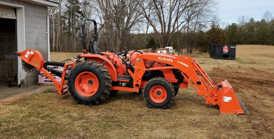

I bought a new MX 5400 gear drive, rops this past spring. I knew I wanted R4's this time around, a tooth bar on the fel, and rear remotes. My old MX 5100 lacked these things. To say I love this tractor does it injustice; this is a GREAT tractor. As far as the saplings go... get the tooth bar, pops them out of the ground like weeds. nt.jpg

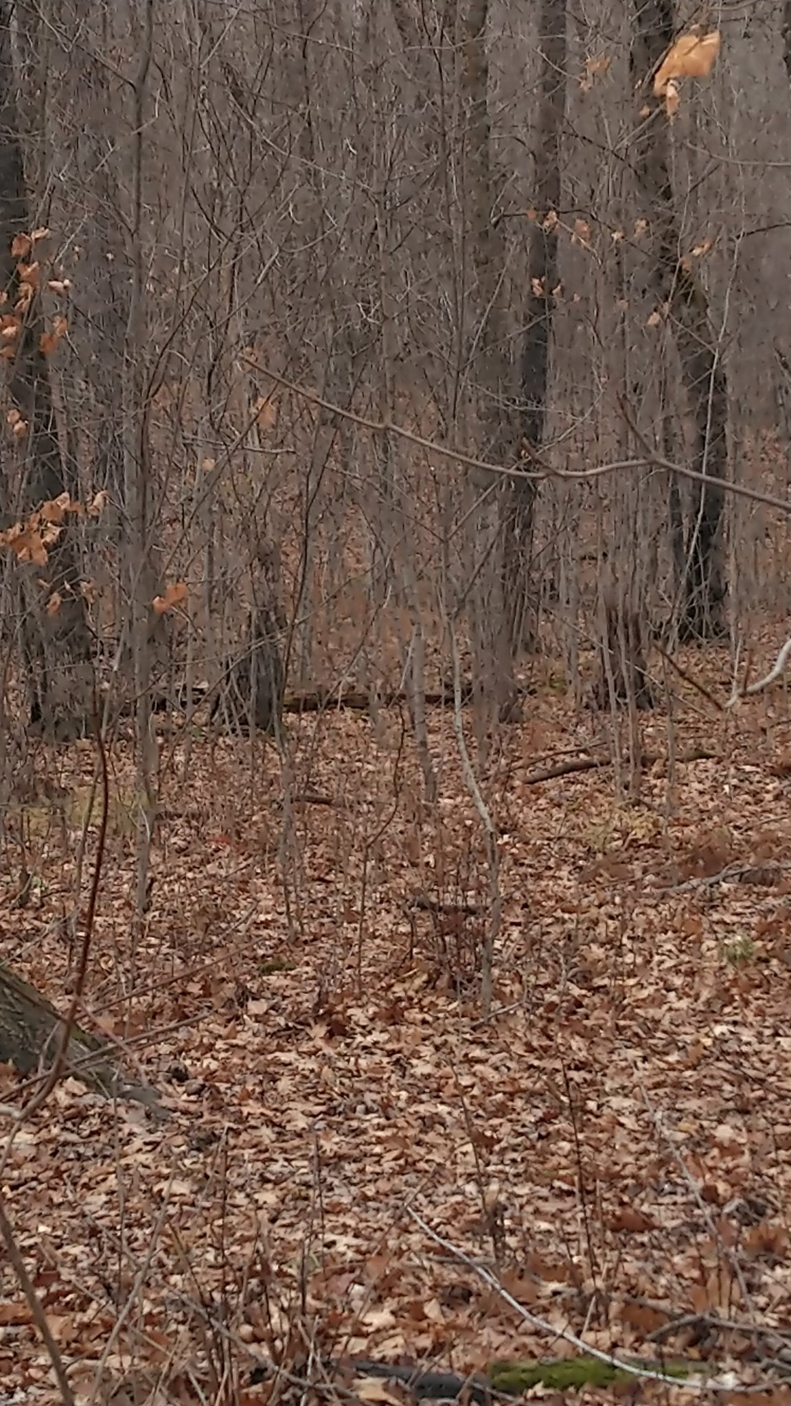

These photos look like younger forest conditions than the previous photo. If most of the area is more like this, you may be able to use a rotary cutter and chainsaw thin larger trees.
I’d recommend you drive what ever you are considering and if you have some idea of implements ask dealer to put on the ones in you wonder about visibility. If they have a barn door you can drive in and out all the better. Playing in the woods visibility can be an issue. I can say that the MX has awesome wheel/tire package…however if you plan to run forks there is a visibility issue, at least there is for me with my set up. Before you purchase forks I’d consider the length f the forks to have visibility. Tractors in general have poor visibility for forks….tires are usually in the way…that being said forks are one of most versatile implements. The MX has really tight turning radius for its size…almost unbelievable due to the bevel gears…that being said when you test drive, you want to understand and feel difference from the other models with implements hanging off…if close quarter operations consideration. Reverse is your worse condition to be aware how front end is swinging with forks and in forward a bush hog that hangs off 10ft. Pretend you are trying to hang a hard right through a 10ft door or whatever your barn door size is. It’s the one place you are limited to raise the forks to maneuver. If you can get through and around a door way you’ll be fine in the woods. As fast as necessary and as slow as possible is helpful in a bigger machine. I am happy to answer any question of concern about b series or Mx that I have experience with. Happy shopping.

I bought a new MX 5400 gear drive, rops this past spring. I knew I wanted R4's this time around, a tooth bar on the fel, and rear remotes. My old MX 5100 lacked these things. To say I love this tractor does it injustice; this is a GREAT tractor. As far as the saplings go... get the tooth bar, pops them out of the ground like weeds. View attachment 69013
I have a toot bar on my current tractor and like it. Where did you get it and how much did it cost for the MX?

I put a Piranha tooth bar from BXpanded on the bucket of my B2601 and I could destroy those saplings in short order. Try watching the movie Patton beforehand to put you in the mood. Thats all I have to say.

If you are cutting brush 1-1/2", with occasional 2" or so, a fairly heavy rotary cutter will work. You'll probably want to back in to avoid snagging wires and hoses on your tractor, and even then be on constant alert. Tire punctures are a real possibility. Unloaded tires, low pressure, and R4's should be tougher. Also leave the blades dull and lower your PTO speed. You want to shatter the stems, not cut them clean and sharp.
Up to about 6", I cut with a brush cutter using a 9" blade with carbide chain saw teeth.
What kind of trees are these? If they sprout back from the stump like sweet gums, you're wasting your time if you don't treat the stumps with herbicide.
