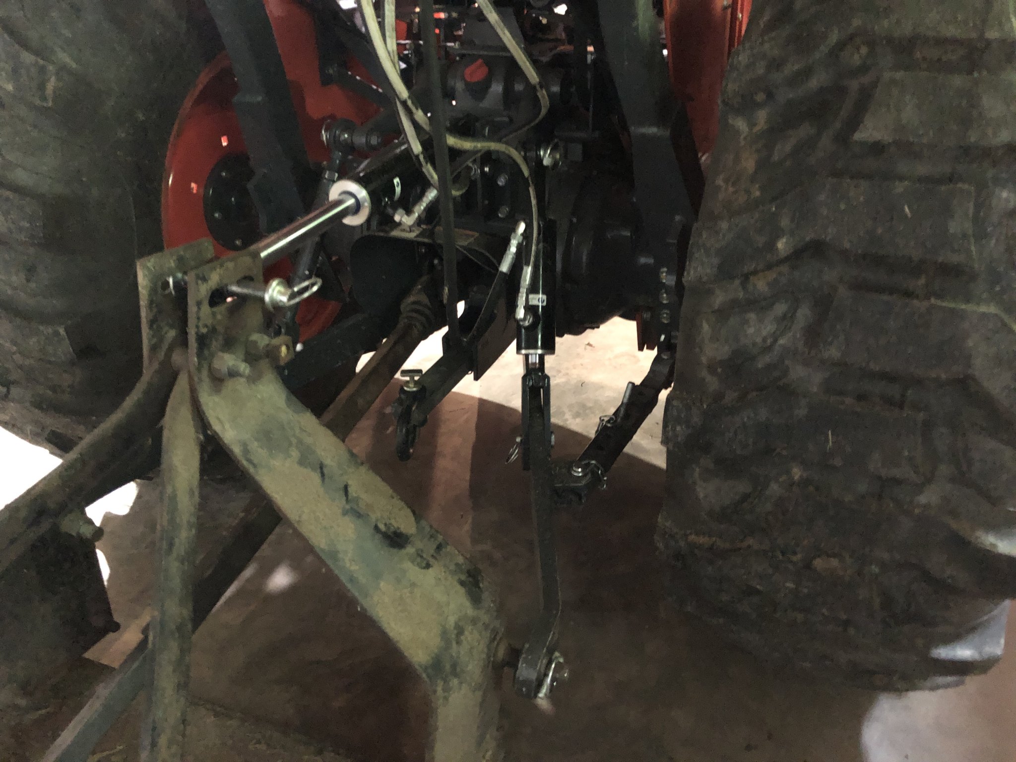

What is top n tilt?

What is top n tilt?
Hydraulic top link (top) and hydraulic sidelink (tilt). That will take up two of your rear remotes. Suggest getting at least one of the rear remotes with a float detent so you can float the top link or side link. Float capability can be useful for grading and mowing.
Got it. Thanks.
I could have used that a few years ago on a grading project. Beats turning the top threaded shaft by hand. Gotta get that too.

I have top-n-tilt on my current MX and ordered the same for the new one. My BX didn't have it but I wouldn't be without it now. Not only is it really easy to hook up to rear implements that aren't conveniently aligned with the tractor, but it makes grading so much easier. I have a magnetic level on the quick hitch that tells me when the rear implement is level even if the tractor isn't. The only possible downside to the factory top-n-tilt other than cost is that the cylinder controlling the side link tends to blead down.
