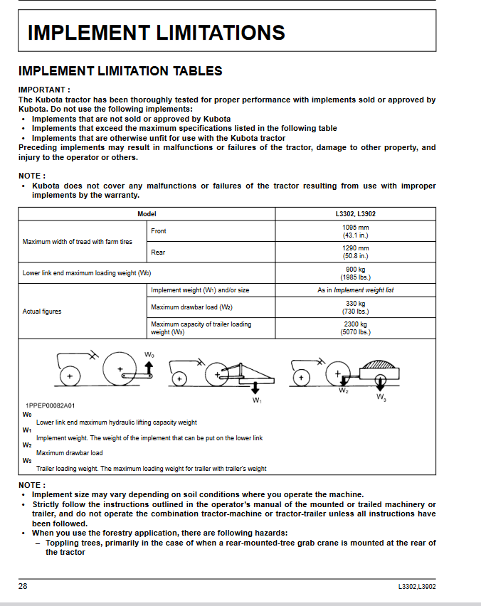

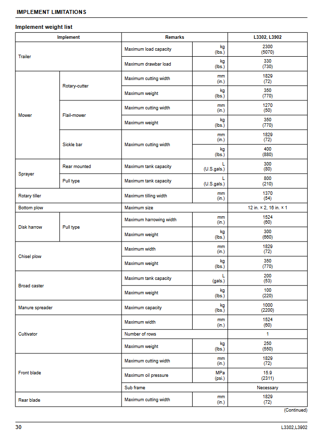

Dealer said the L3302 can handle a 6' box blade. Sound right? Also, what size rotary cutter ( brush hog) ?
check out about page 30 of your operators manual.
of course much comes into play like commercial/homeowners use, type of soil, type of brush, etc..... but the Kubota Op. Manual will likely have you conclude these sizes are to large.
Don't own one. Thinking about one.
