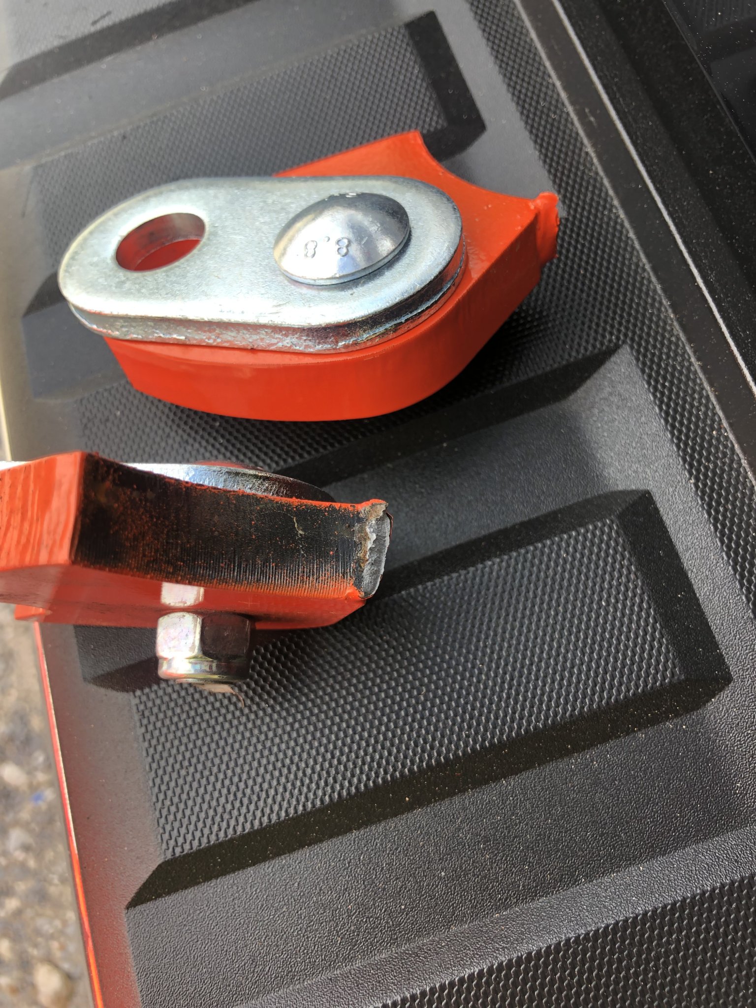

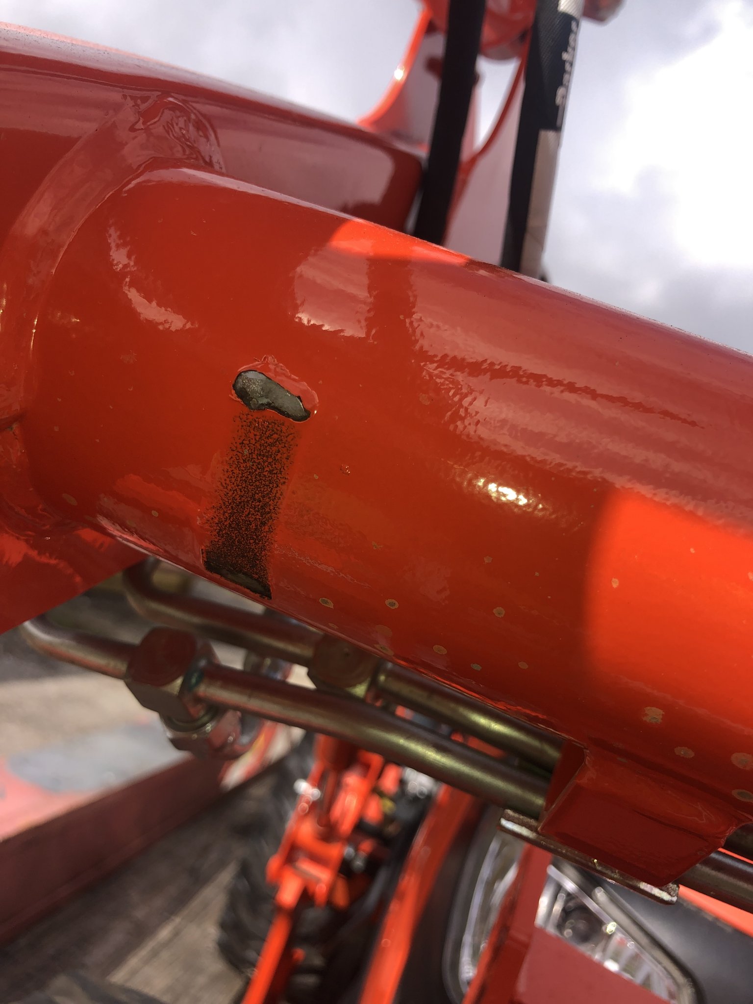

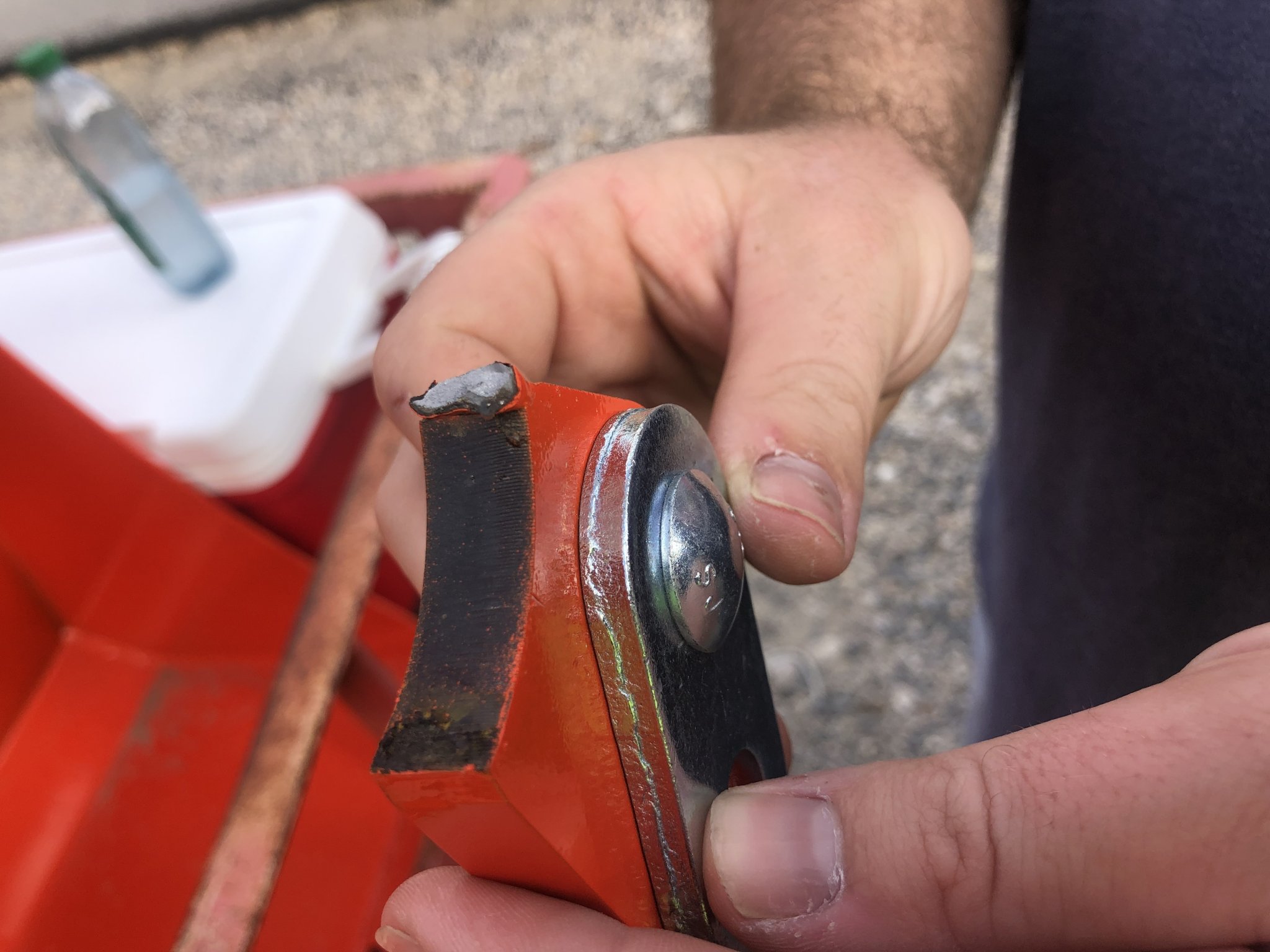

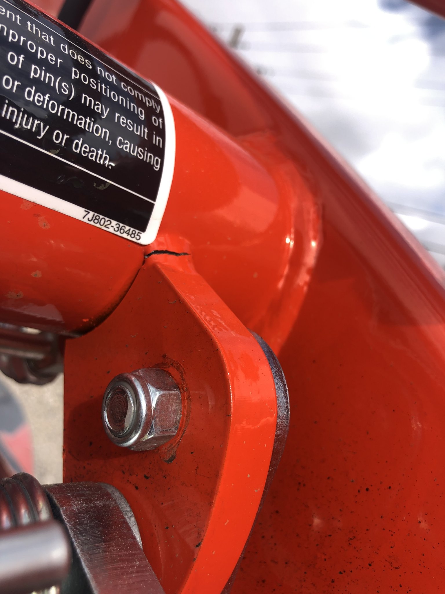

July 2022, new M5-111 with Cab and loader. Tractor has been perfect but the loader was built in Jefferson and has several defects. The front brackets that hold the support legs on the bottom, and the bucket tilt linkages were welded on crooked. This means the pins are in a really bad bind. It took a 4' cheater pipe for us to be able to remove or install the pins because of linkage twist. The stands also point out at an angle when down and causes the loader to shift towards the hood when removing the loader.
Someone didn't get everything properly aligned in the jig before it got welded. Kubota will have to replace the main frame but none to be found and they are on months backorder. They "seem" willing to fix it, so hopefully they do. They talked about cutting the welds then weld back on straight, then spray bomb the welded area. Although that works, it seems it would directly impact any resell value if I had to sell it. I mentioned safety and resell value so they are going to replace the frame.
Everyone is having issues with QC after covid, and it seems the Jefferson plant has had its share of issues as well. Hopefully, they take care of all these loader and backhoe issues folks are having.
