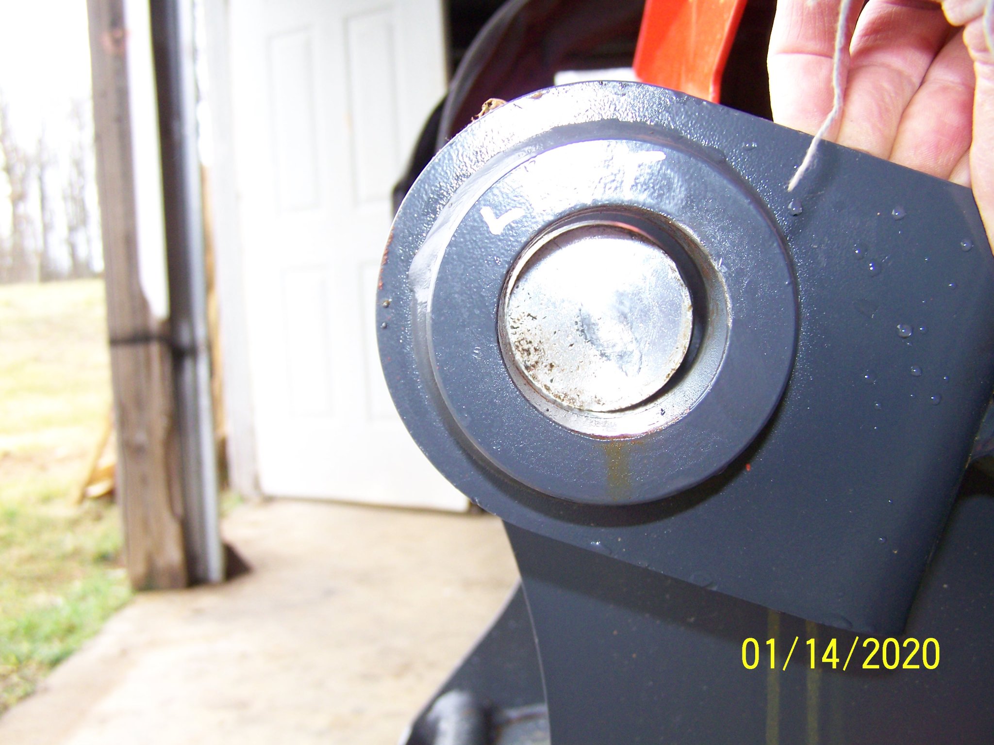

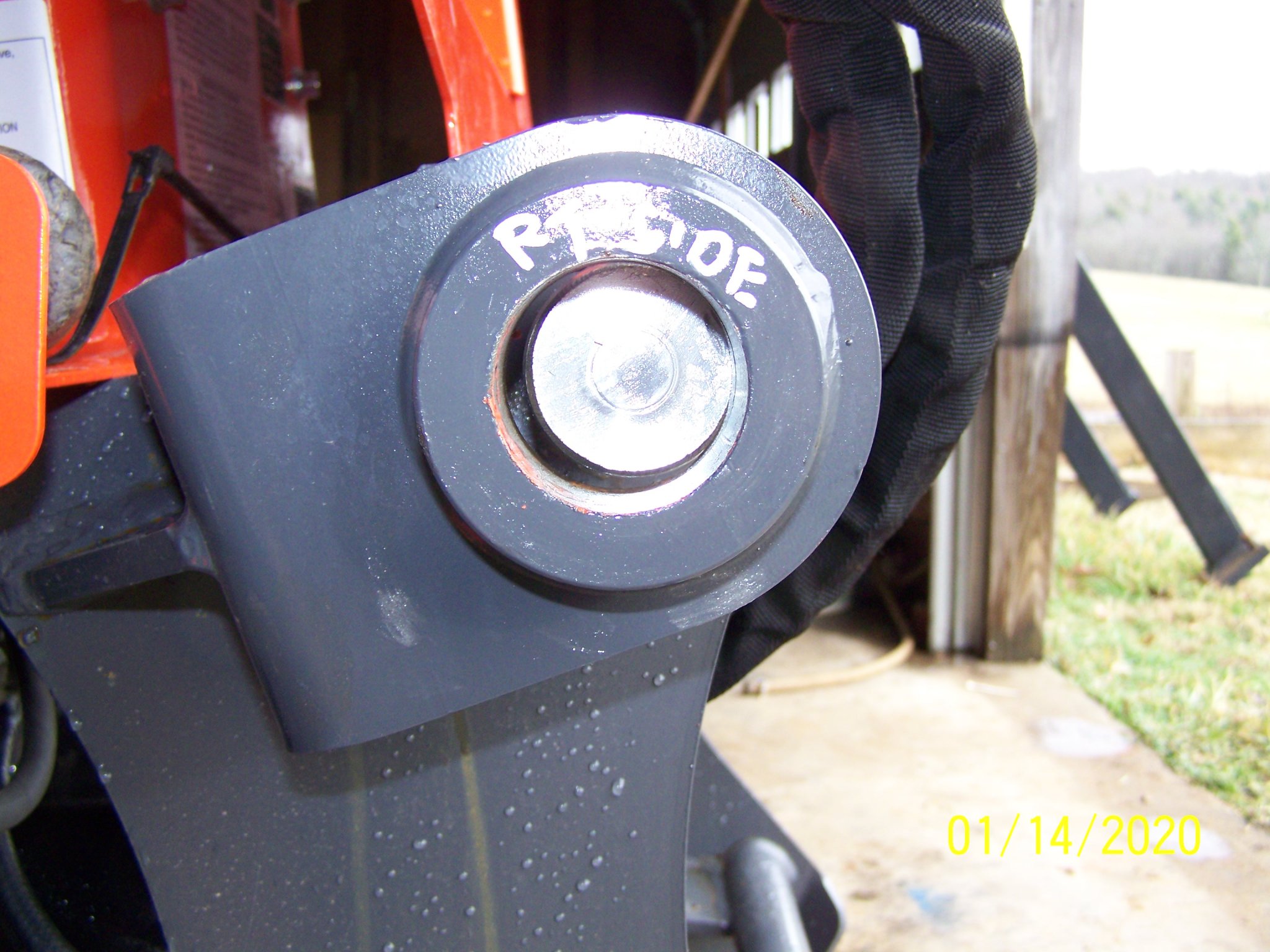

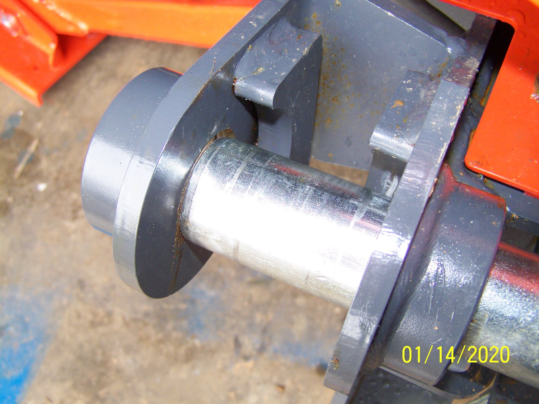

July 2022, new M5-111 with Cab and loader. Tractor has been perfect but the loader was built in Jefferson and has several defects.
Someone didn't get everything properly aligned in the jig before it got welded.
I bought my backhoe attachment separate from my tractor loader.
It came disassembled on a pallet. When the time came to pin the backhoe to the tractor I couldn't get the pins in. After pulling the tractor away from the backhoe I discovered that the pins wouldn't even go through the attachment clevis itself. It had to be out of whack in the jig when it was welded. My dealer gave me another backhoe they had in stock.
Note the photo date. View attachment 94198 View attachment 94199 View attachment 94200 View attachment 94198 View attachment 94199 View attachment 94200
GOOD on your dealer !!!
