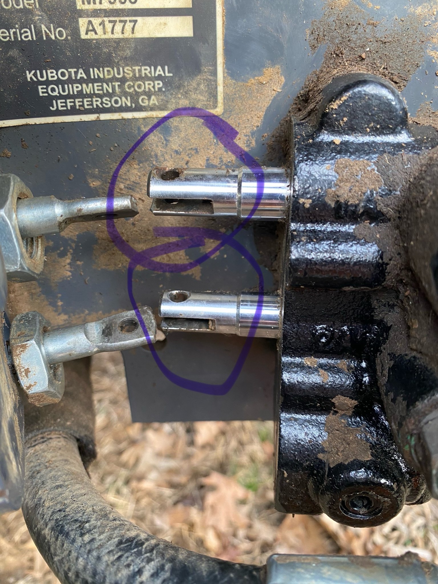

Pulled the pins and the spools (circled on pic) spin pretty easily with the use of a flat head.
The ends of the cables move when wiggled. I will remove the plastic housing and check the cables.

The Spools don't spin to work, they push in and out to work.
If you have the cables removed from the spools and the block, they should move freely
If they are not then something happened in the back.

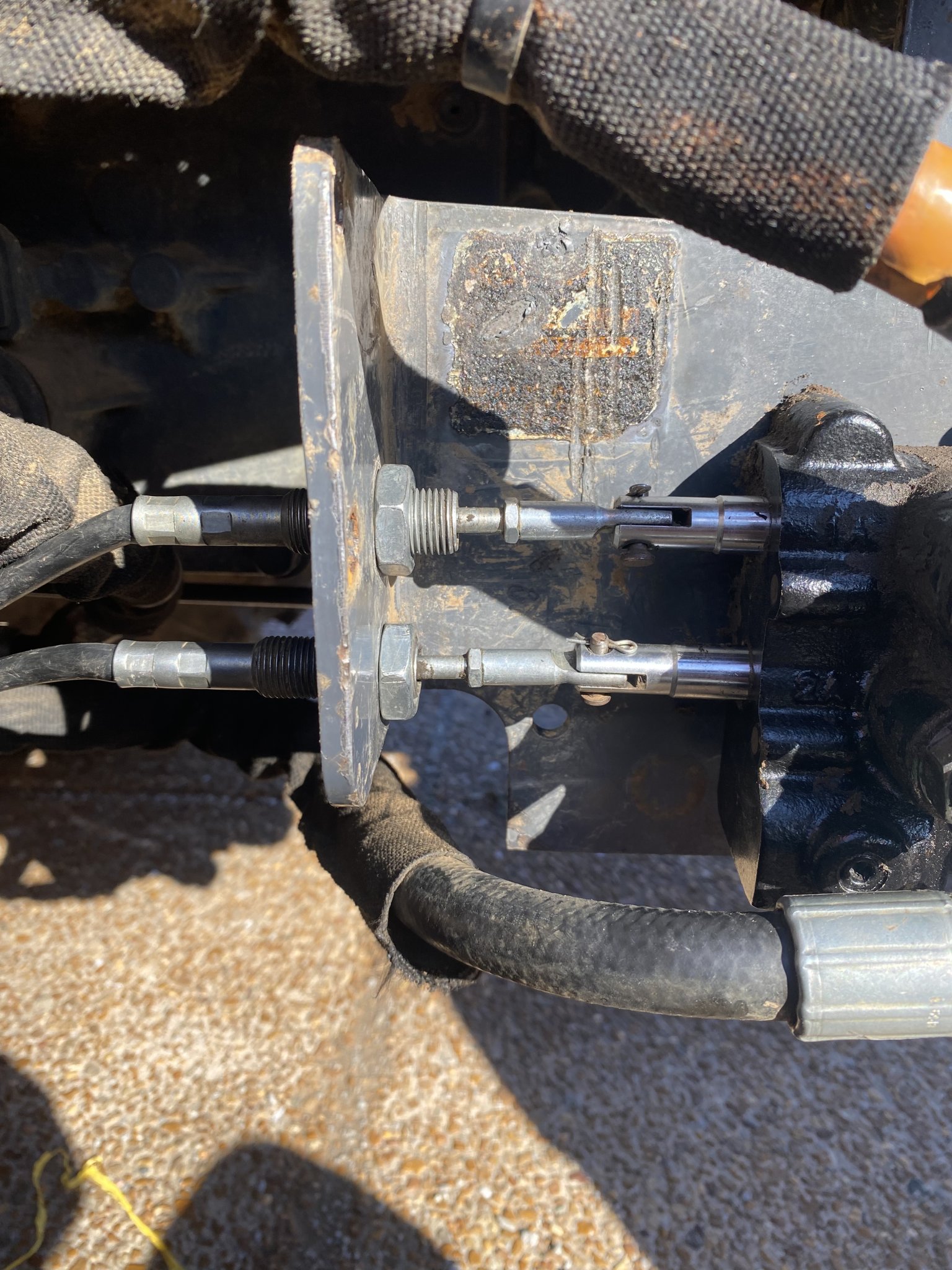

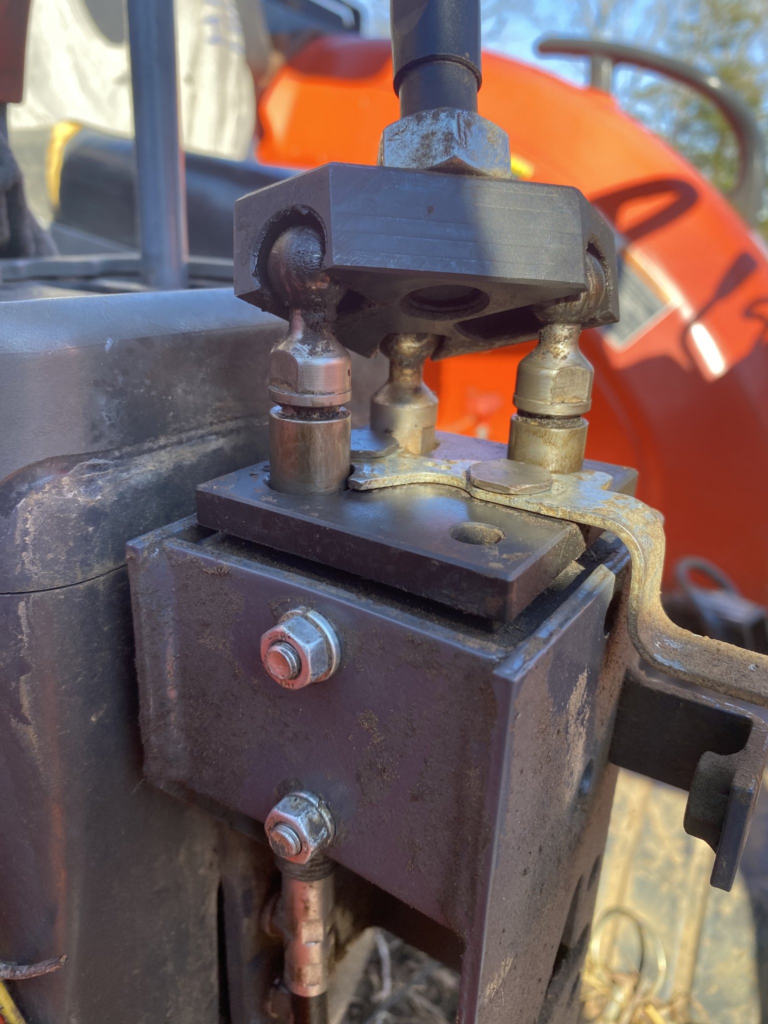

I believe I have found the problem. The valve mounting bracket is bent (see pic). It bent towards the front left tire approx 3”. I'm going to take it off and attempt to straighten it.
36,749
11,468
I was wondering about that, the picture you just posted really shows it.
That bend in that bracket will bind everything up.
If it's bent too much you can get a new one, but ouch!
13,199
7,451
I think you have found your problem. Looks like its just a flat plate?? It should be easy to fabricate a replacement if you cant straighten the original.

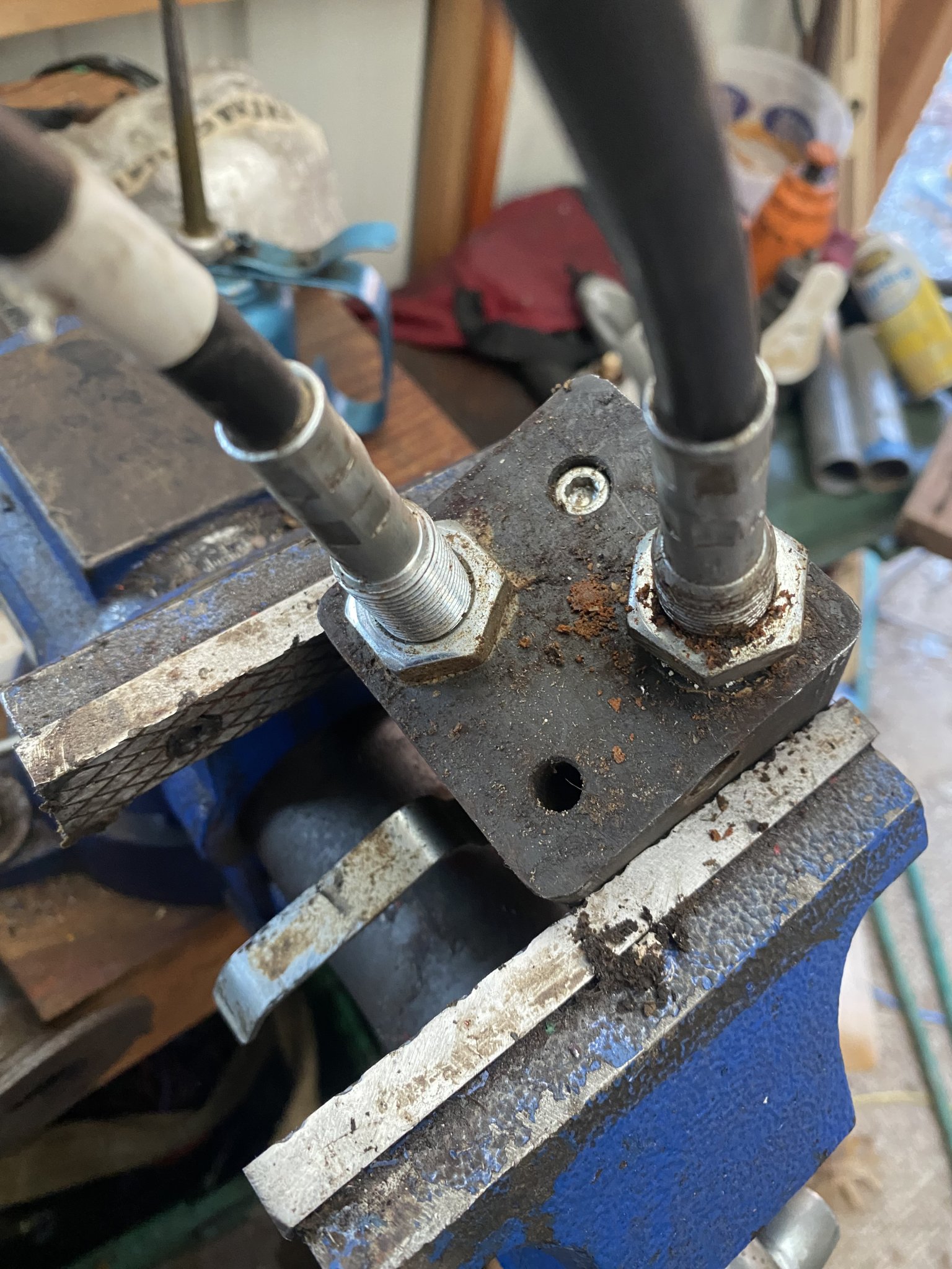

After days of pouring down rain, I finally got the bracket off and straightened. There is a nice 90 degree in the bracket now and no curves.
I’ve put it all back together at this point. How do you adjust and set the cables from the lever correctly? The lever controller is just wabbly now and won’t control anything. Is there a method to set them to a default setting and adjust from there?

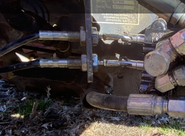

Look at the first picture you posted and set them like that. ;)
Looks like the outer nut was almost to the end of the adjustment.

I’ve just adjusted the calbles to match the original picture. The controller lever is just a little wobbling all over. It won’t be even stand up in a neutral position. It just leans whichever way it falls.
36,749
11,468
So when you move the joystick do the cables move?
Did you do any adjusting of the cables at the control stick side?
Please provide a new picture of the control stick bottom (pivot points) and the cable mount (that you straightened) at the valves.
CrimsonClay
Kubota M7060
Aug 4, 2021
25
Lewisburg, TN

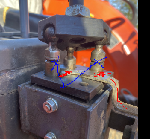

When I move the joystick the cables do not move. I did no adjusting up at the control stick side. Just cleaned up the gunk and sprayed wd-40.
Here are the pics you requested. If there are any other specific pics you want, just let me know.

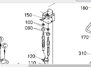

Sounds like the cable have become disconnected under the controller.
Or they got damaged.
Remove the 2 silver bolts on the side and the controller will lift out the top.
If you disconnect them at the bottom you will be able to pull the controller and the cables all the way out.
Need to check that the cables are connected to the ball ends that go up into the controller.
These are the cables ends that attach to the controller.
060 are the ball ends
36,749
11,468

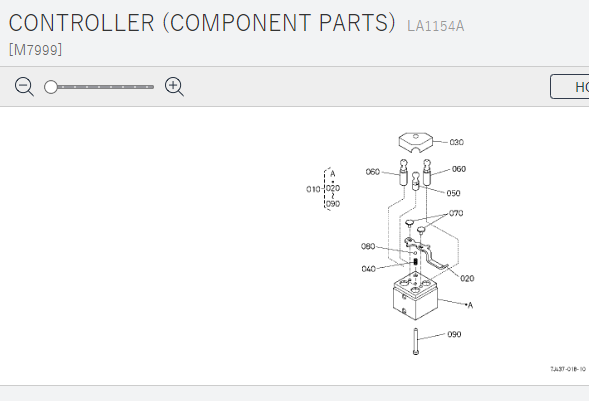

To adjust the cables properly, you would put the controller in a lock position.
The slide lock ( RED #020) would go into the slots just below the balls ( Blue #060).
That puts the controller in neutral.
Then you would attach the bottom cables to the spools, as the spools sit in neutral.
Does this Allen screw come out to separate the block and check the bottom of the joystick and cable connections?
36,749
11,468
I'm pretty sure the allen just holds the fixed pivot point in place.
But you will remove it to get the block to separate from the other 2 joints.
The cables will unthread from the block after you unlock the lock nut on the bottom.
Before you take them out note how many threads they are into the block and note their location.
What you would look for is that the ball ends are seated on the cable and the small lock nut is in place.
