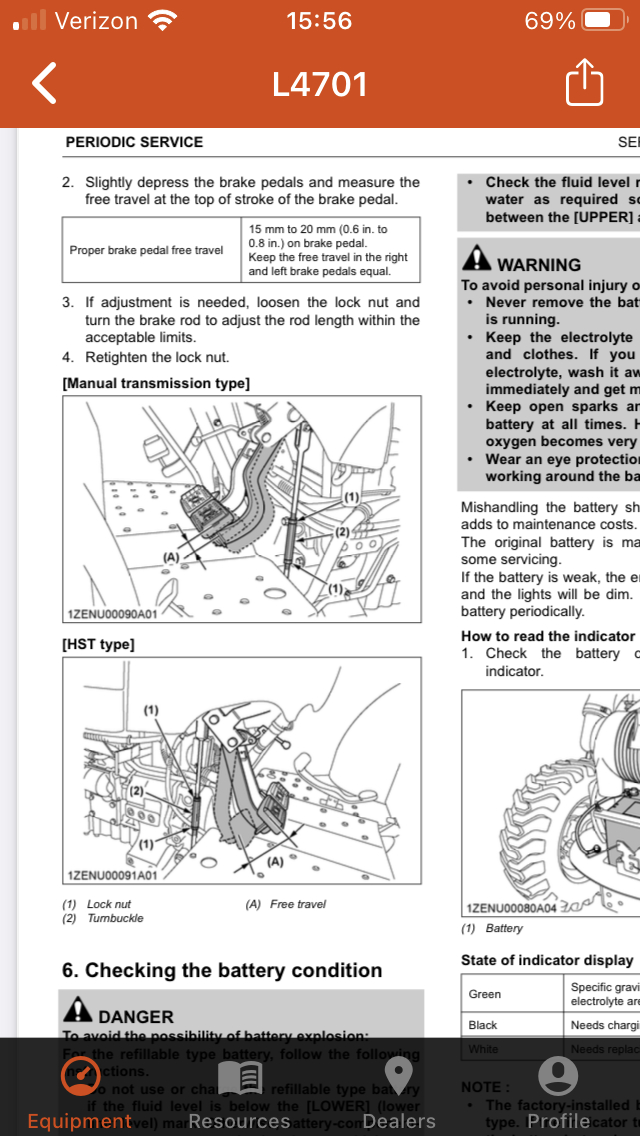

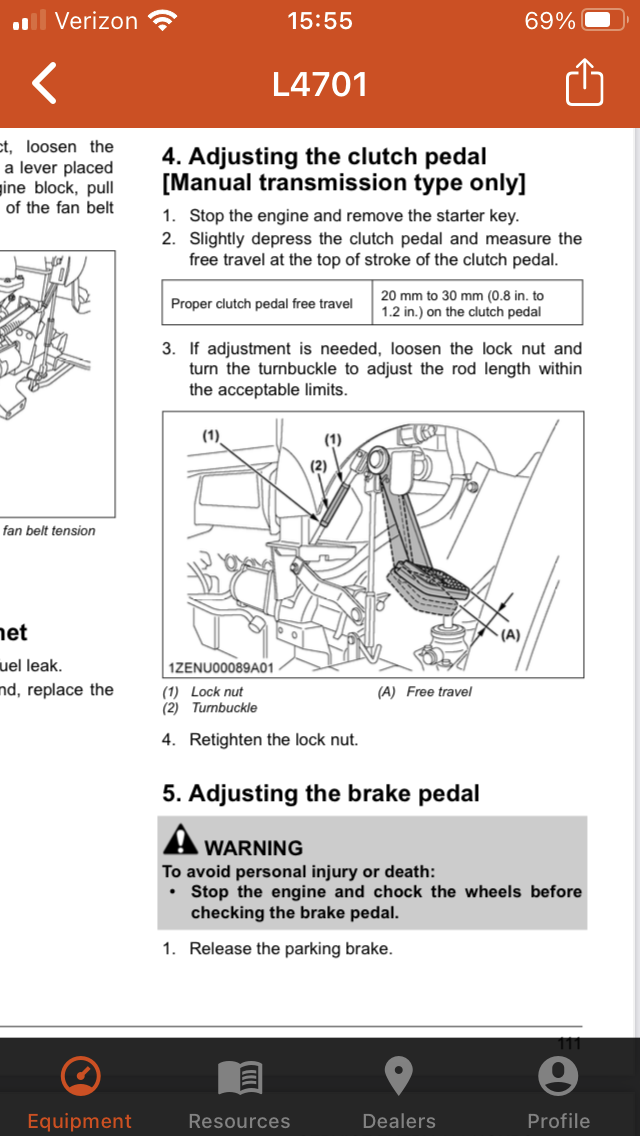

I wanted to post an update on my tractor, I have had time to use it since the repair.
The brake replacement has fixed the squeaking noise when hitting the brakes and the loud popping noise when hitting the brakes.
‘They must of done something with because the “creep” when releasing the HST pedal and leaving it in the neutral position is a lot better, it creeped 4 times faster before taking it into service compared to now.
The parking brake still won’t hold the tractor back on a hill, it will still roll. The odd part is it sit on a hill for 30 minutes without rolling but all of a sudden it started rolling.
I think the parking brake need’s adjusted, I can push the pedal past all 3 notches on the parking brake.
Does anyone know where I can buy a service manual to get the brakes adjusted properly?

I’d still suggest downloading the WSM Fordtech linked. I have that one and have found it to be quite helpful in addition to the OM.
