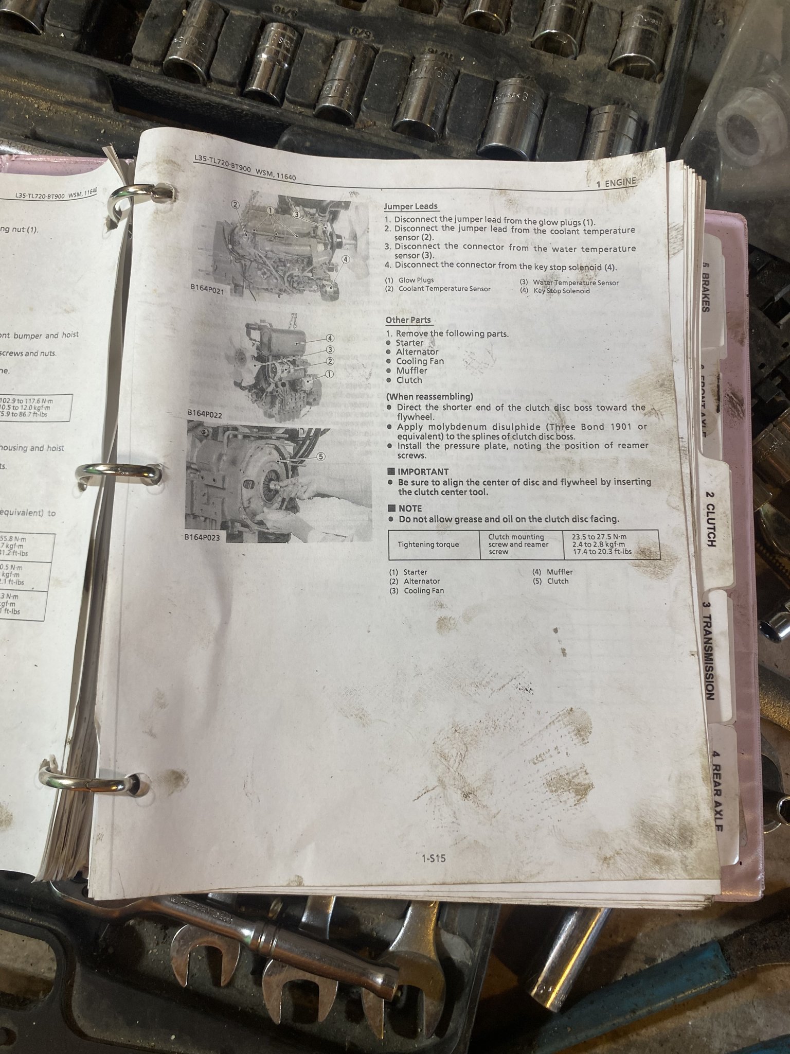

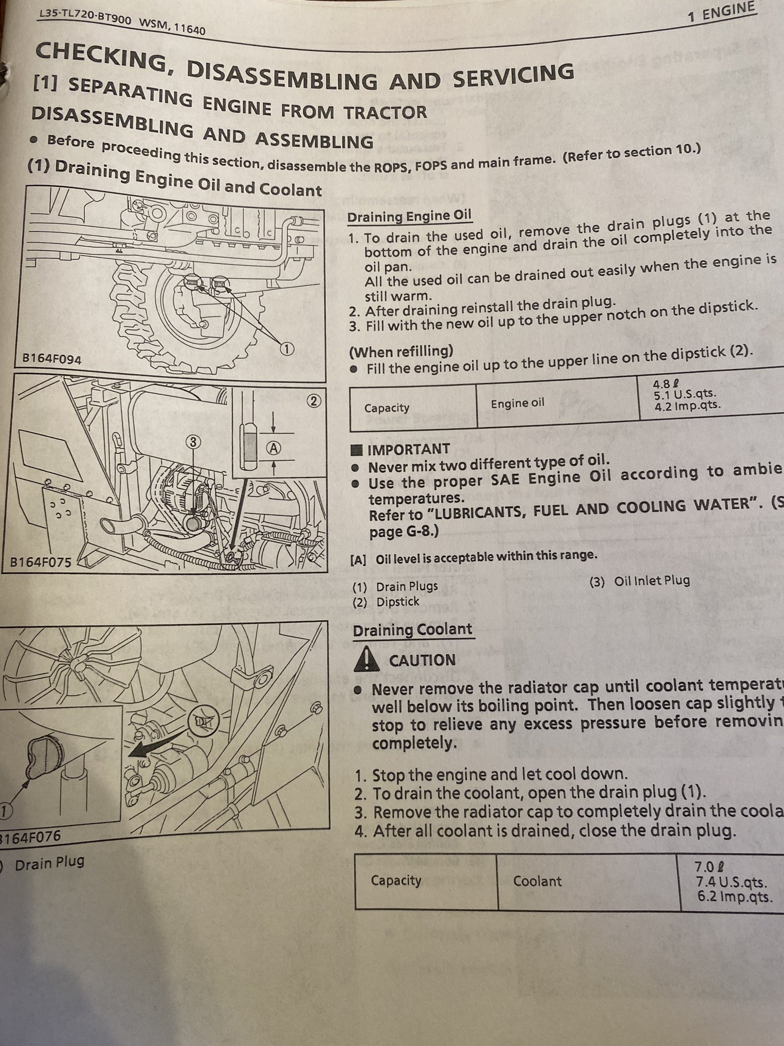

So finally got around to pulling the engine. Just looking for some direction on the next step. I was following the checking disassembling and servicing in the work shop manual. Should I continue with that. I just finished the 1-s14 page. I’ll include photos of that and the next page. Thanks
35,788
10,843
Looking good so far, keep following the manual.
I would be pulling the clutch off next.

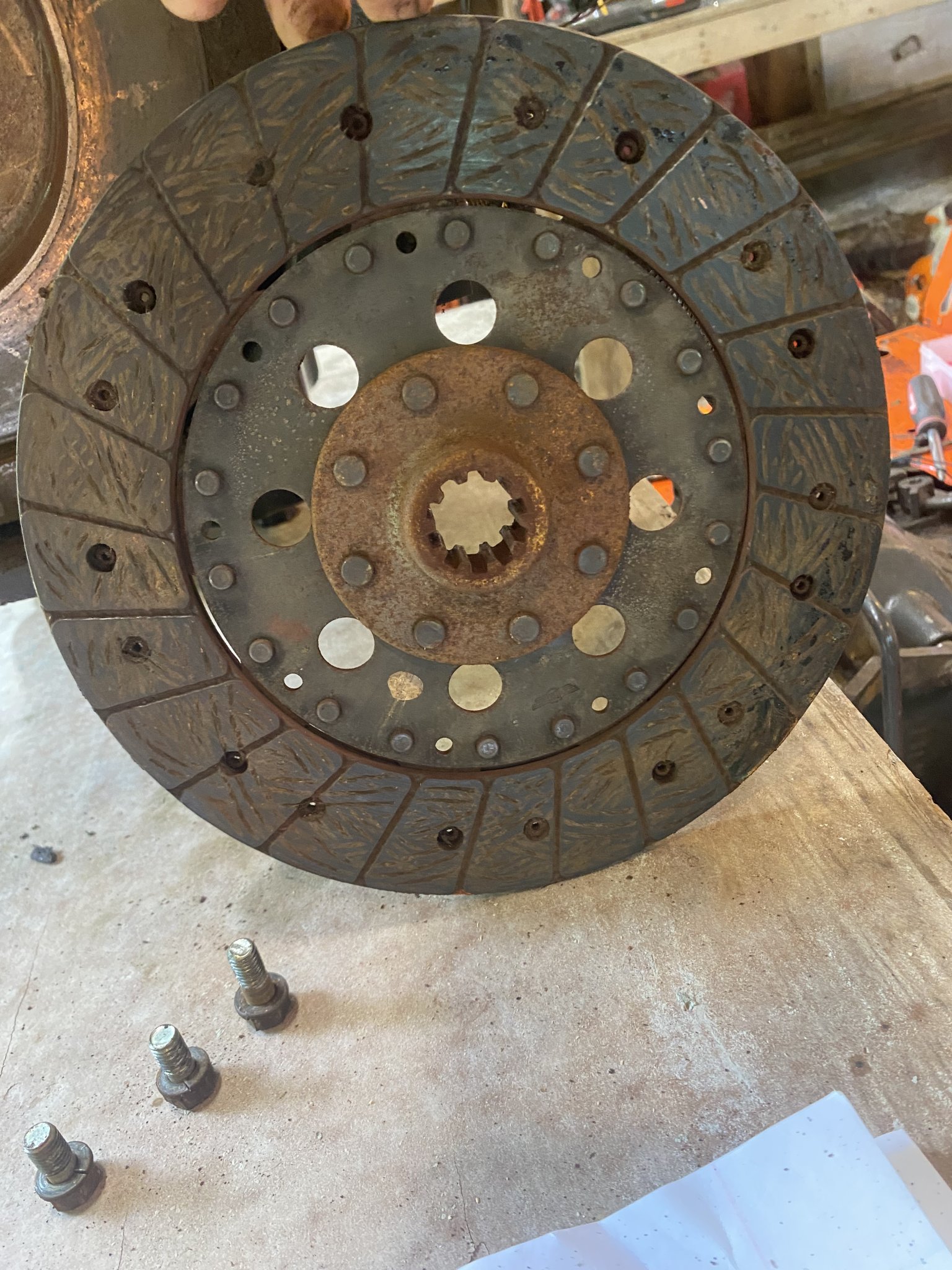

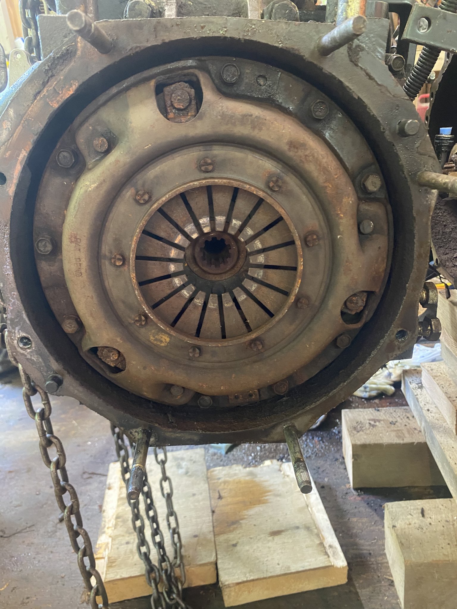

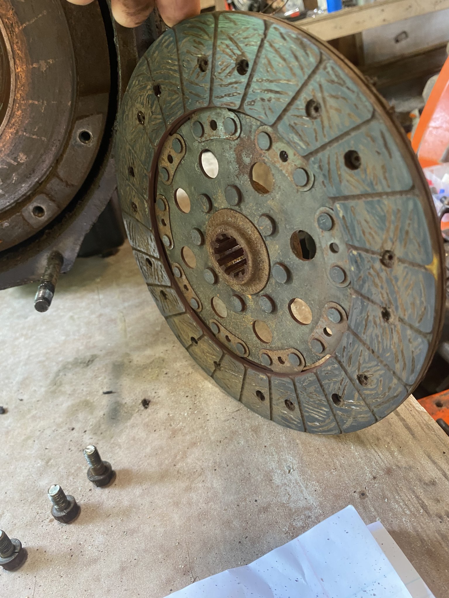

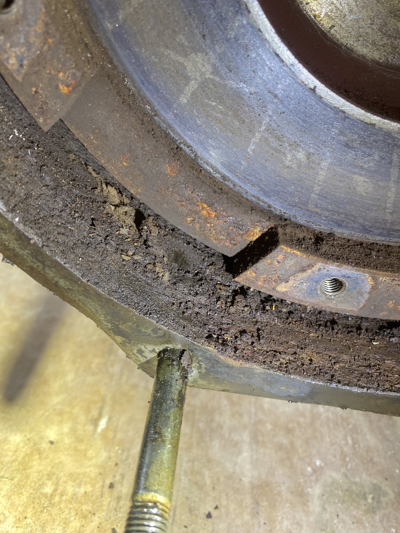

Ok thanks. Here’s pictures let me know what you think, should I replace since I’m in here anyway if it looks ok?

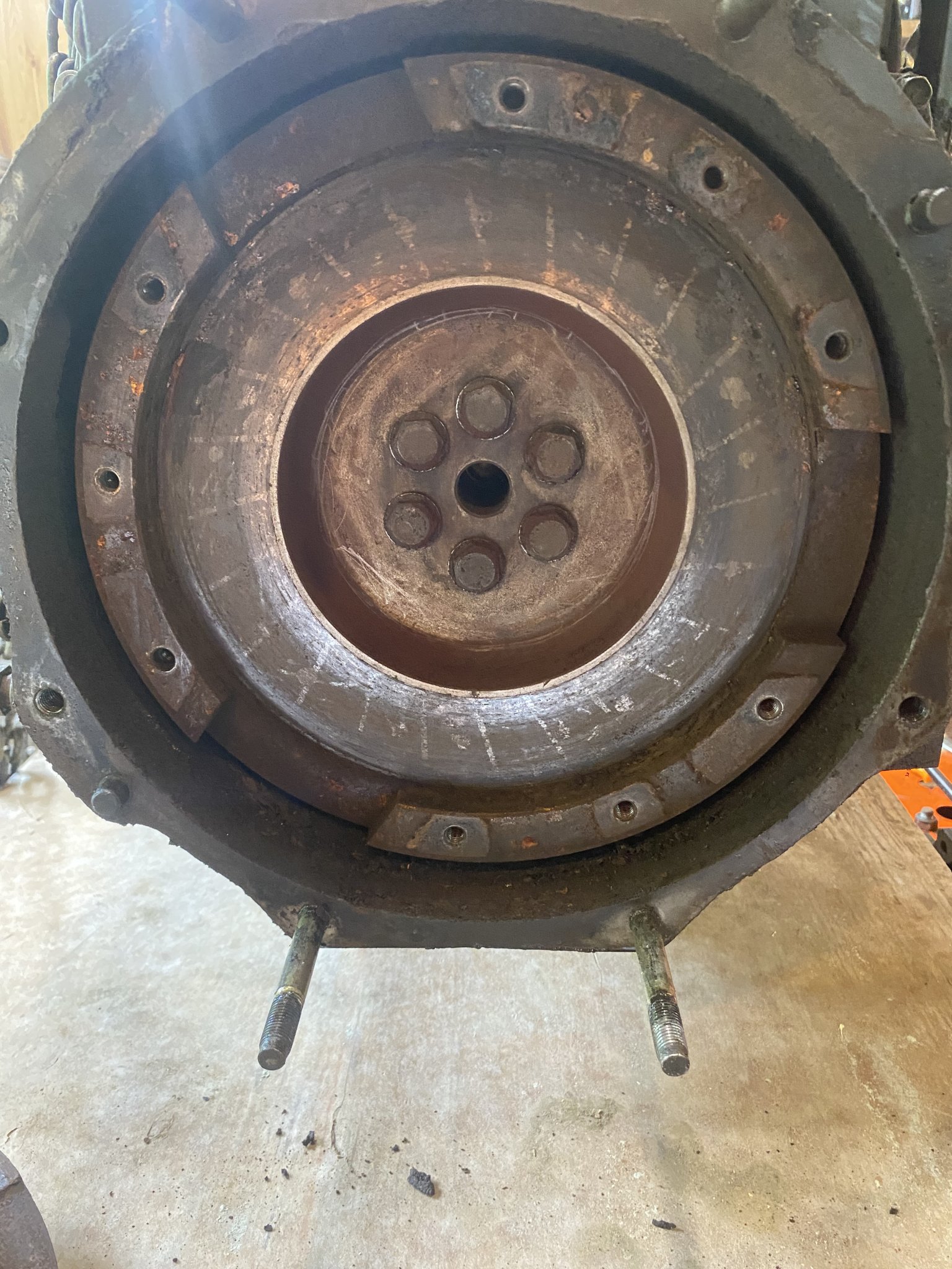

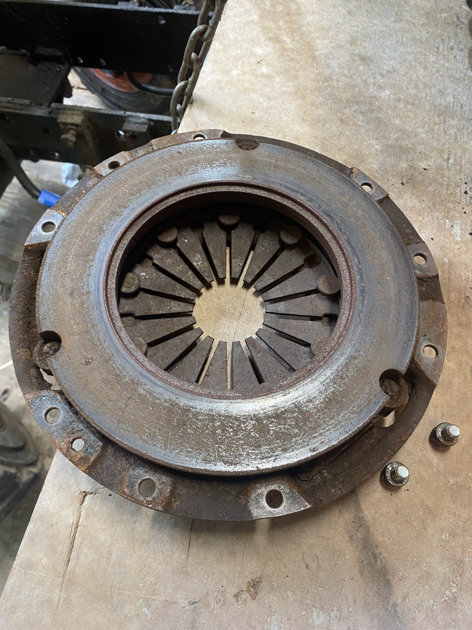

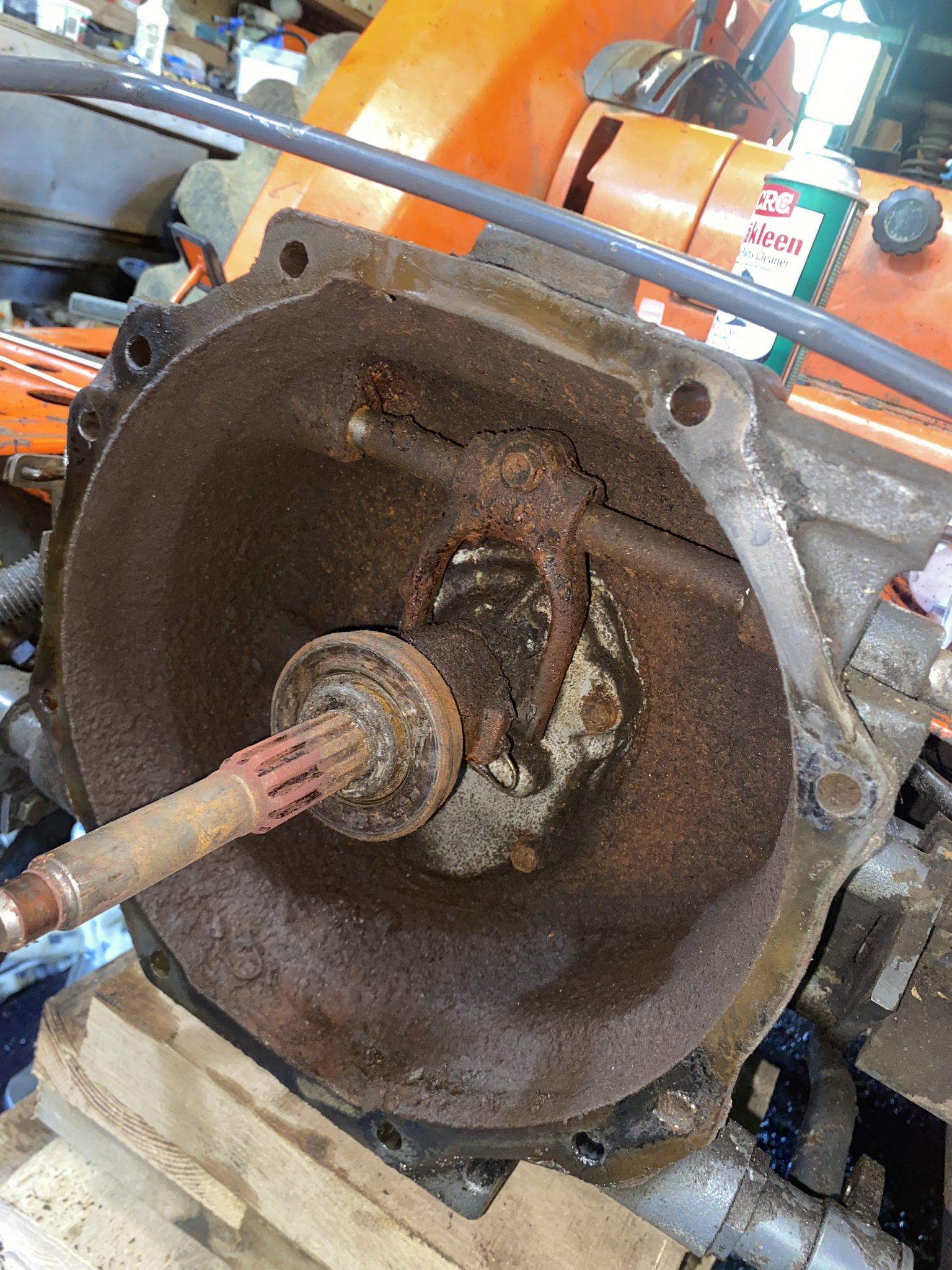

Ok pulled the clutch of here’s pictures let me know what you think. I assume I should replace it since I’m I here anyway? Should I get a clutch center tool when I reinstall? Also it’s says about applying three bond 1901 is there something recommended for that? Also looks like there’s a bunch of grime around both sides where I pulled the engine off should I remove that the best I can? I’m going to continue with the dissemble let me know if I should be doing something different also if some other things should be replaced while this is apart. Thank you Wolfman and anyone else for the help.
35,788
10,843
The WSM can tell you how to determine if it needs parts changed.
But me personally if I'm in there I almost always plan for a clutch disk, pressure plate, throw-out bearing and pilot bearing/ bushing.
You could get a alinement tool, but a simple dowel will get you lined up too.
It's not hard to center the disk.
Yes clean all of that up, a little rust remover wouldn't be a bad thing, and a light coat of paint afterwards.
On reassembly you want to seal the mating surfaces of the cases with a light coat of RTV to seal moisture out of the clutch area.

See if the engines rear main seal is leaking as well, considering it’s around 25 years old if it isnt now it may be soon. I’d look into doing one of those “while your in there” kind of thing.

Look at all the dry rust in there, I don't think a drop of oil has ever seen that space. 😜
He is going to end up messing with seals and such because he has an engine issue not a trans or clutch issue. 😉

I was looking at his installed pressure plate pic, it’s got a little engine oil visible but not able to tell if it’s from the RMS or no.

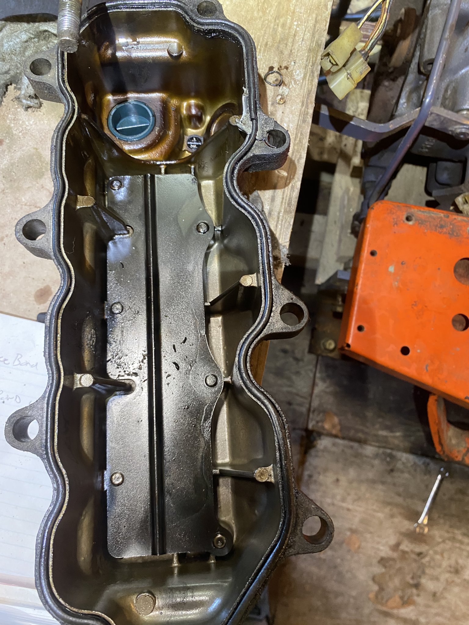

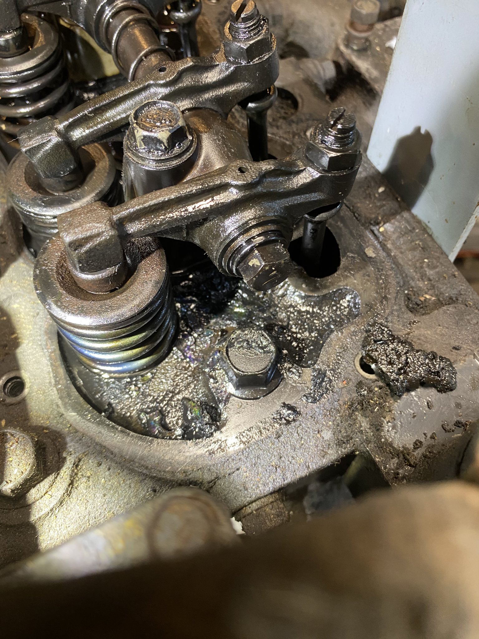

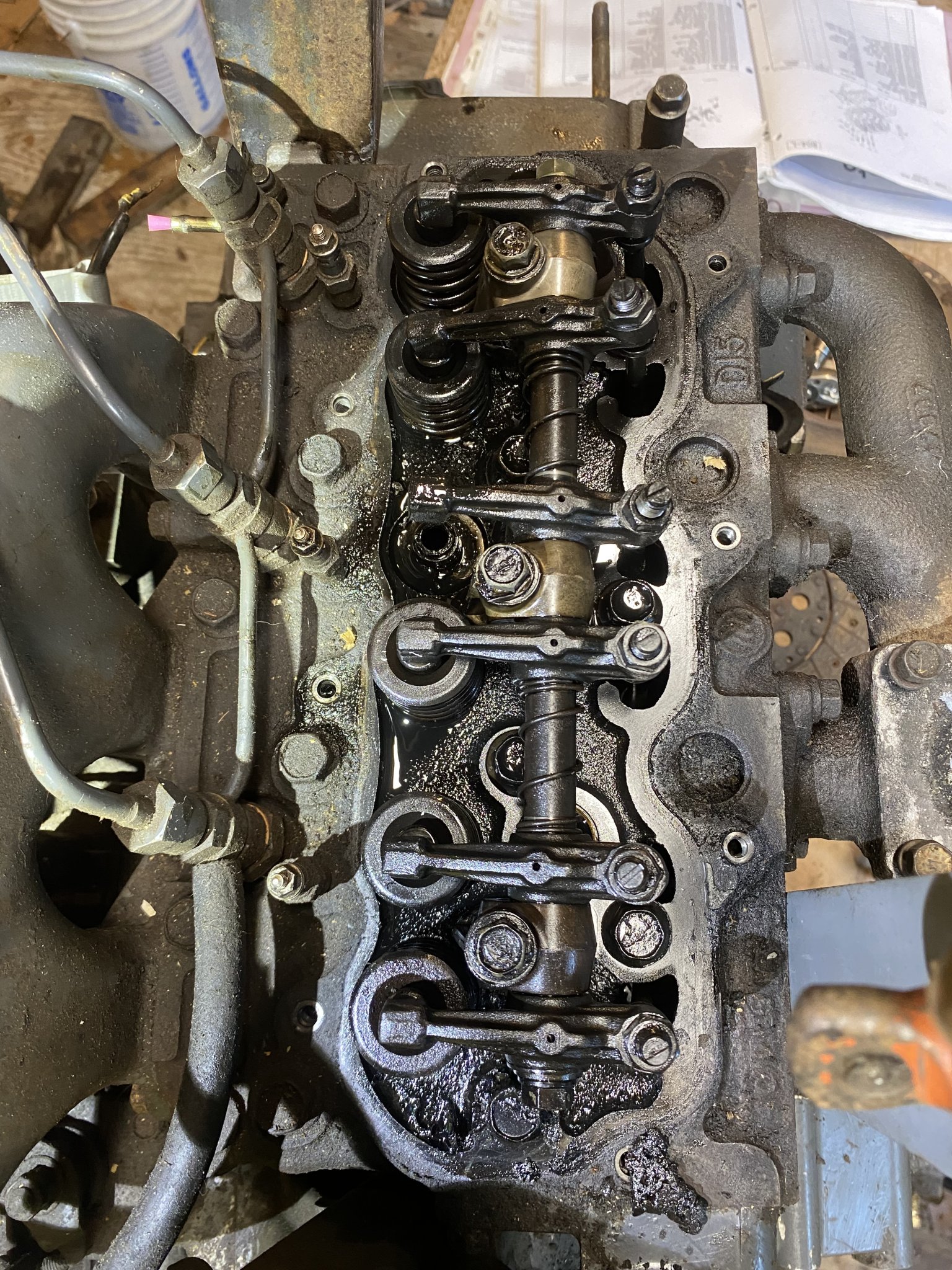

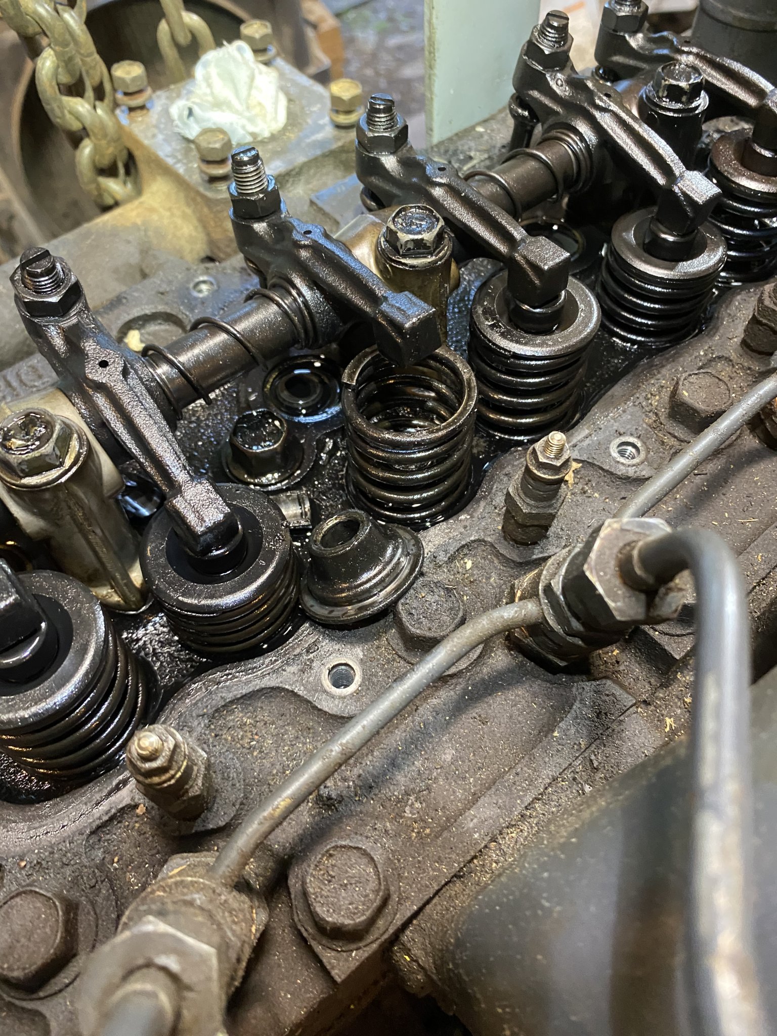

ok sounds good do you have a recommended place as to where you normally buy the parts. As should everything come from a dealer like messicks. I popped off the head cover last night and theres something broken under the rocker arm where the spring is. I’ll get pictures here soon and post.
Yes I want to see what's under the cover, it would be rather ironic if that was all of your noise.

It doesn’t show the L35 on that clutch kit just wanted to double check and make sure that’s the correct one. Thanks. Also is it ironic because it could have been fixed with out splitting the tractor? - genuine question as my knowledge is limited. I will post a picture when I get home. Thanks again

Yes that's the right clutch package, they just don't list the L35.
Depending on what you find, you might still need to get into the bottom end to get it fixed.

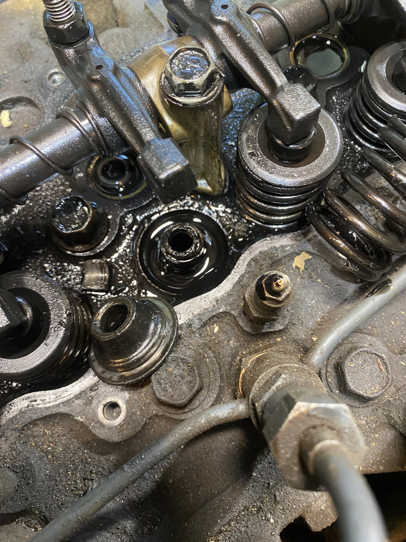

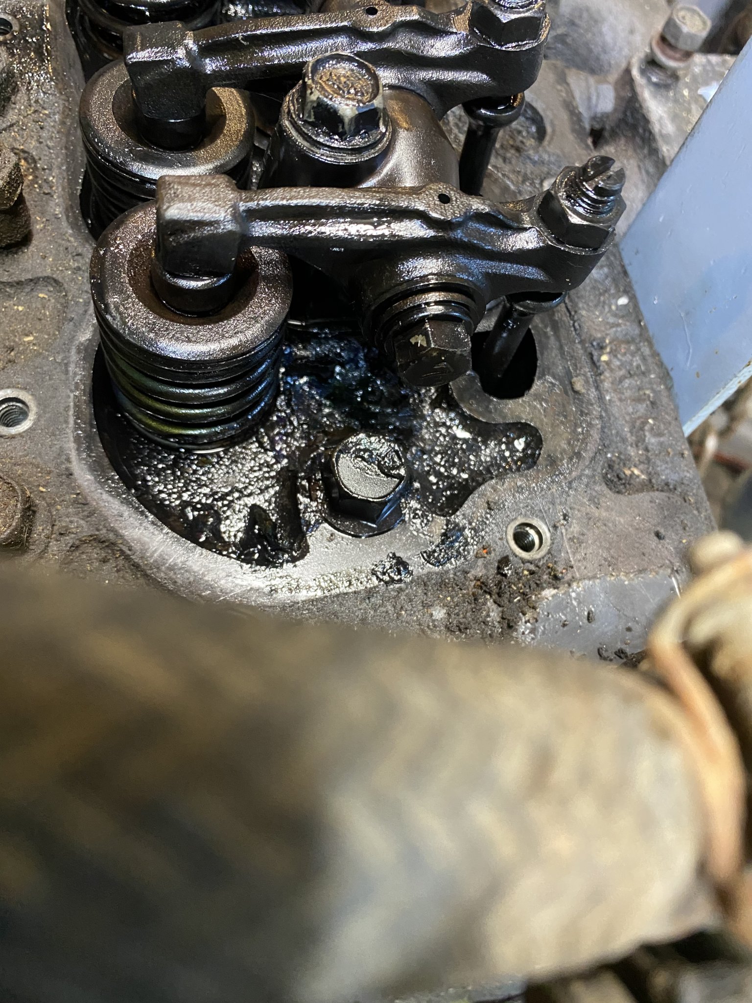

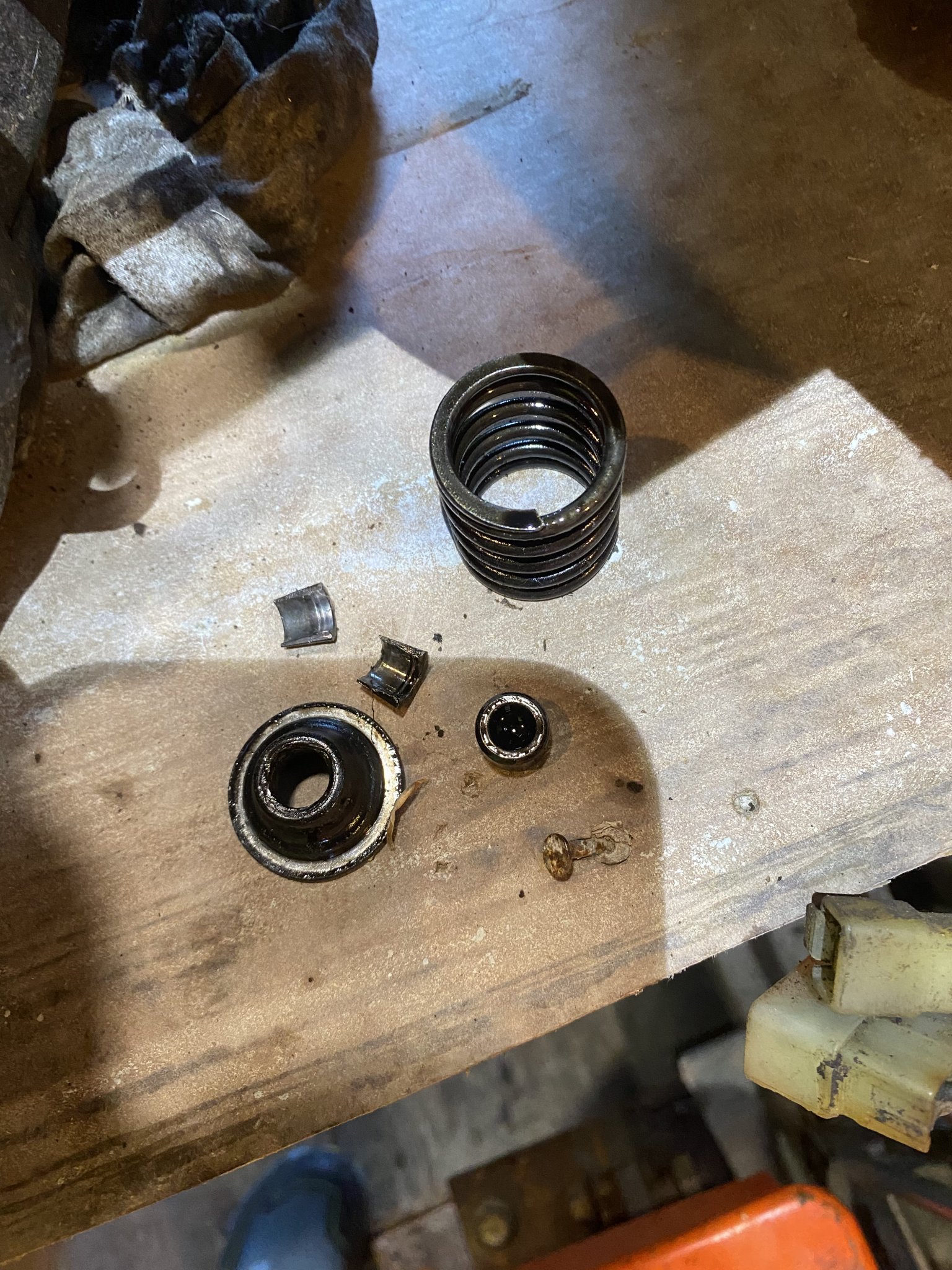

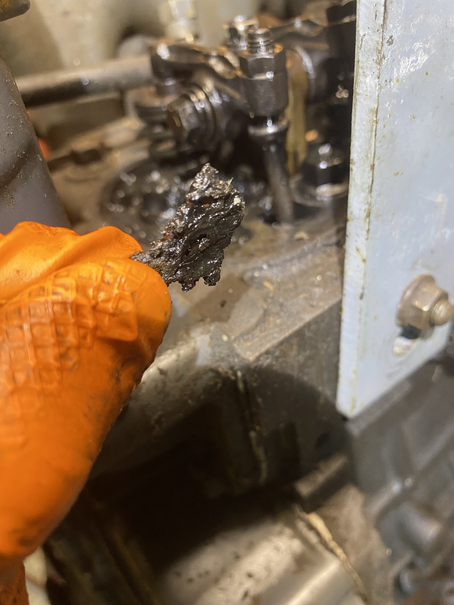

ok thank you. Here’s some photos looks like something broke on top of an inlet valve? Also on the other end under the oil cap area looks like got real hot or something like burnt oil in that area or something you can see the spring is kinda blueish colored.
