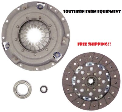

Yes that's the right clutch package, they just don't list the L35.
Depending on what you find, you might still need to get into the bottom end to get it fixed.
Yes I want to see what's under the cover, it would be rather ironic if that was all of your noise.
Clutch setup for it:

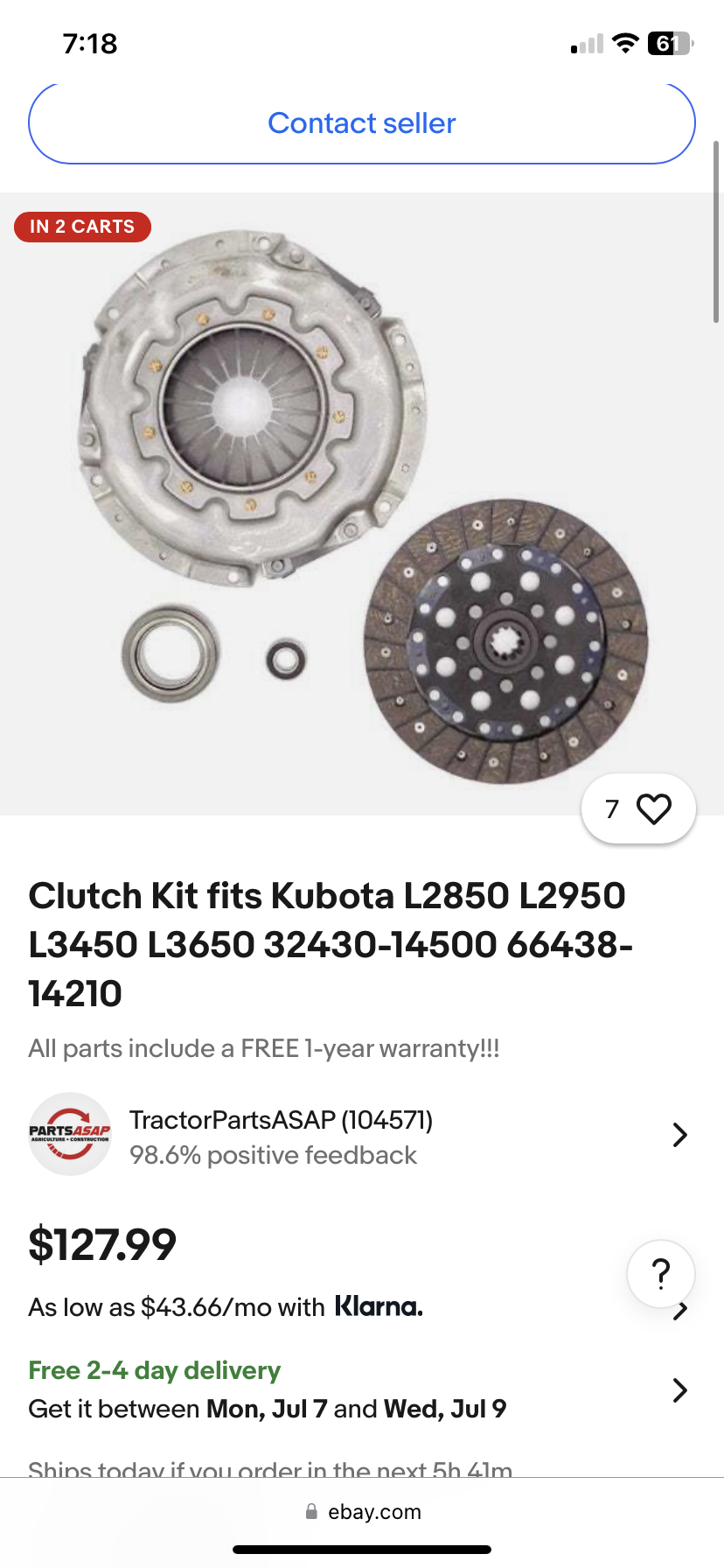

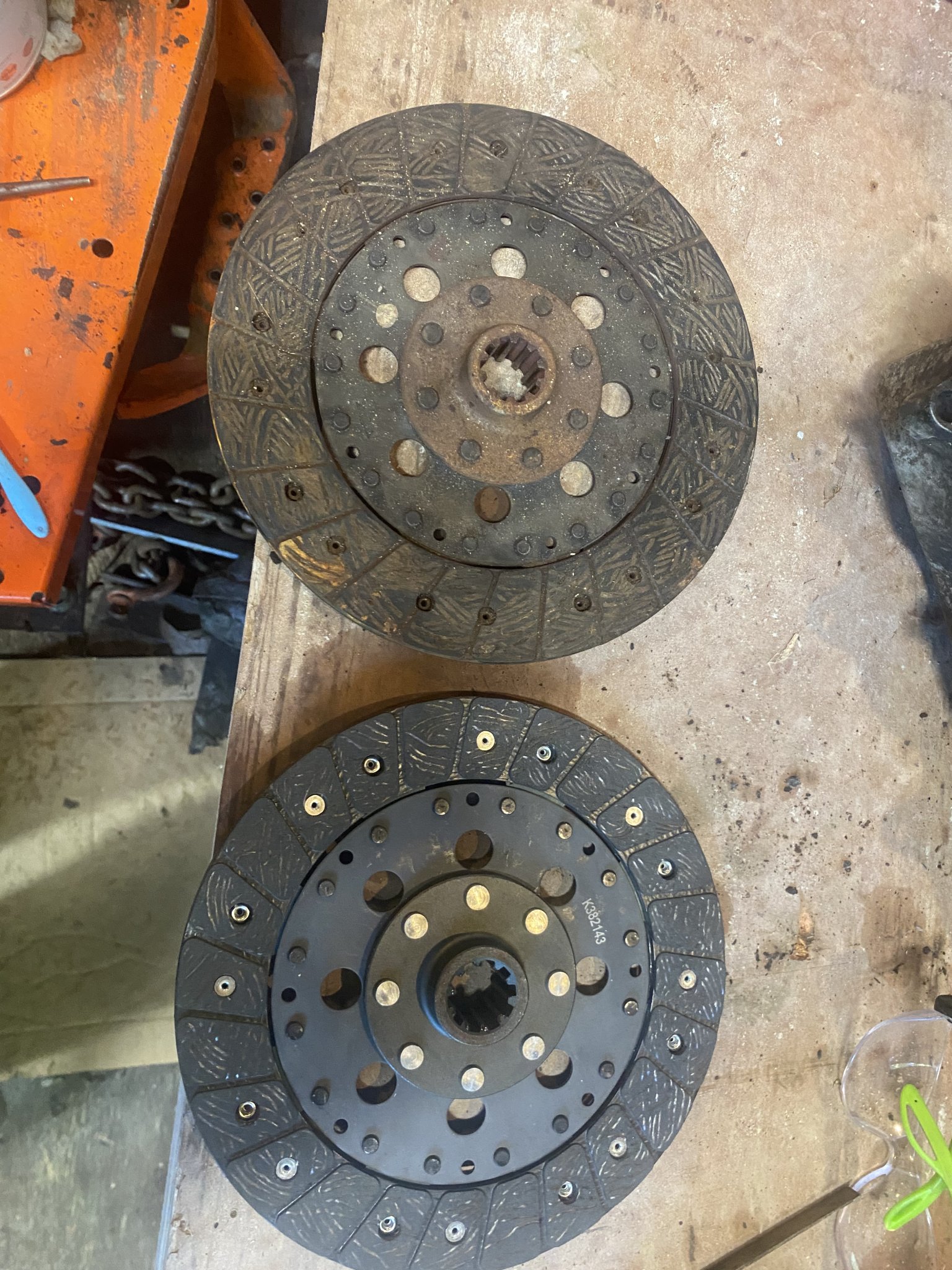

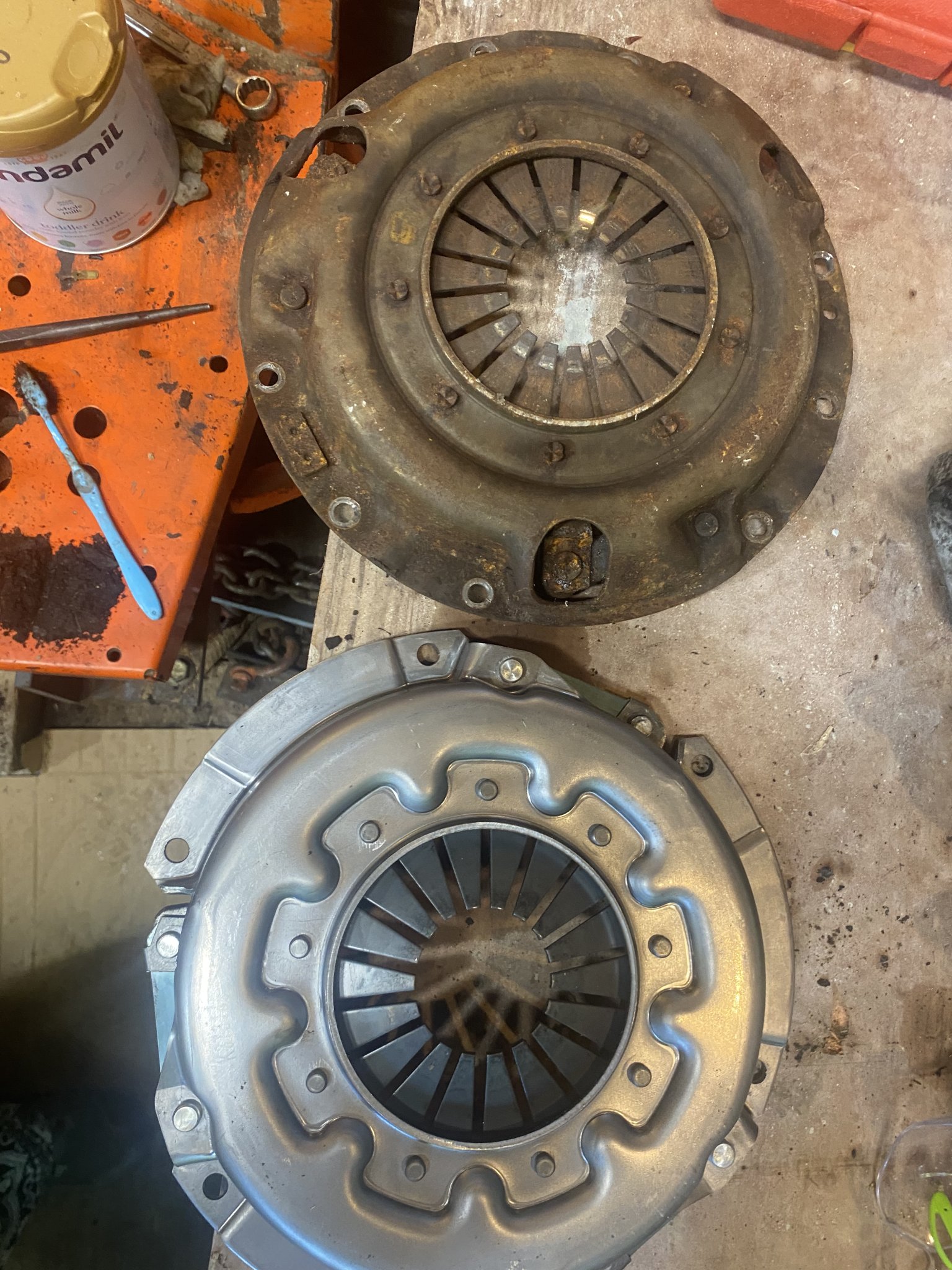

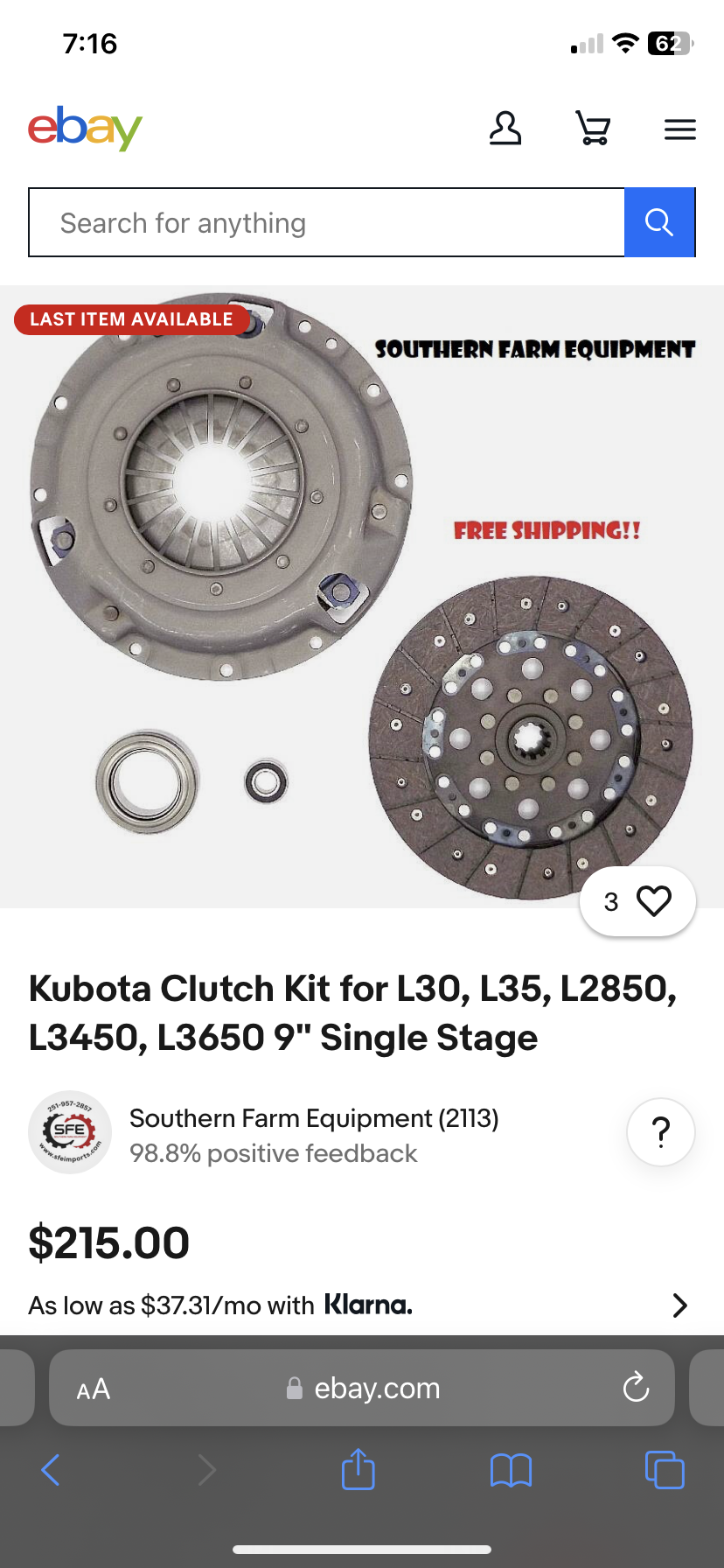

just an FYI and to see what you think maybe I’m wrong here. That clutch package seems to be wrong looks like it would still bolt Up but the pressure plate only has 6 mounting holes and the clutch disc is slightly smaller 81/2 instead of 9. The thrust ball bearing seems to be different also or maybe the style has changed?

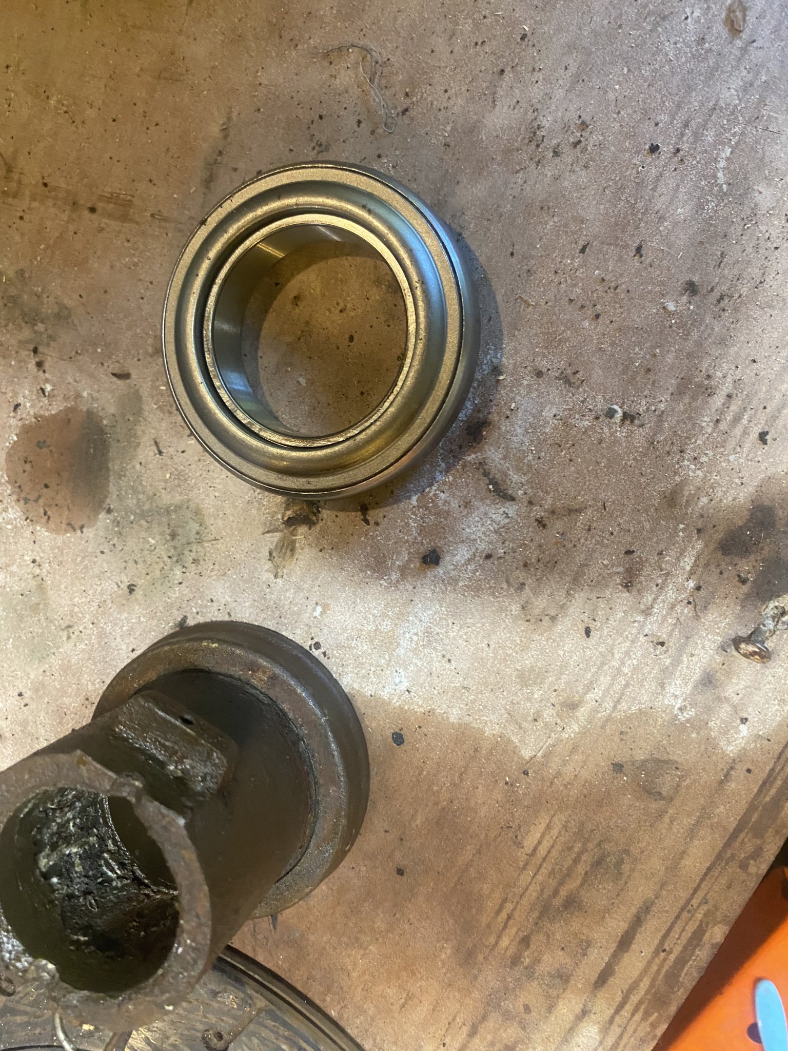

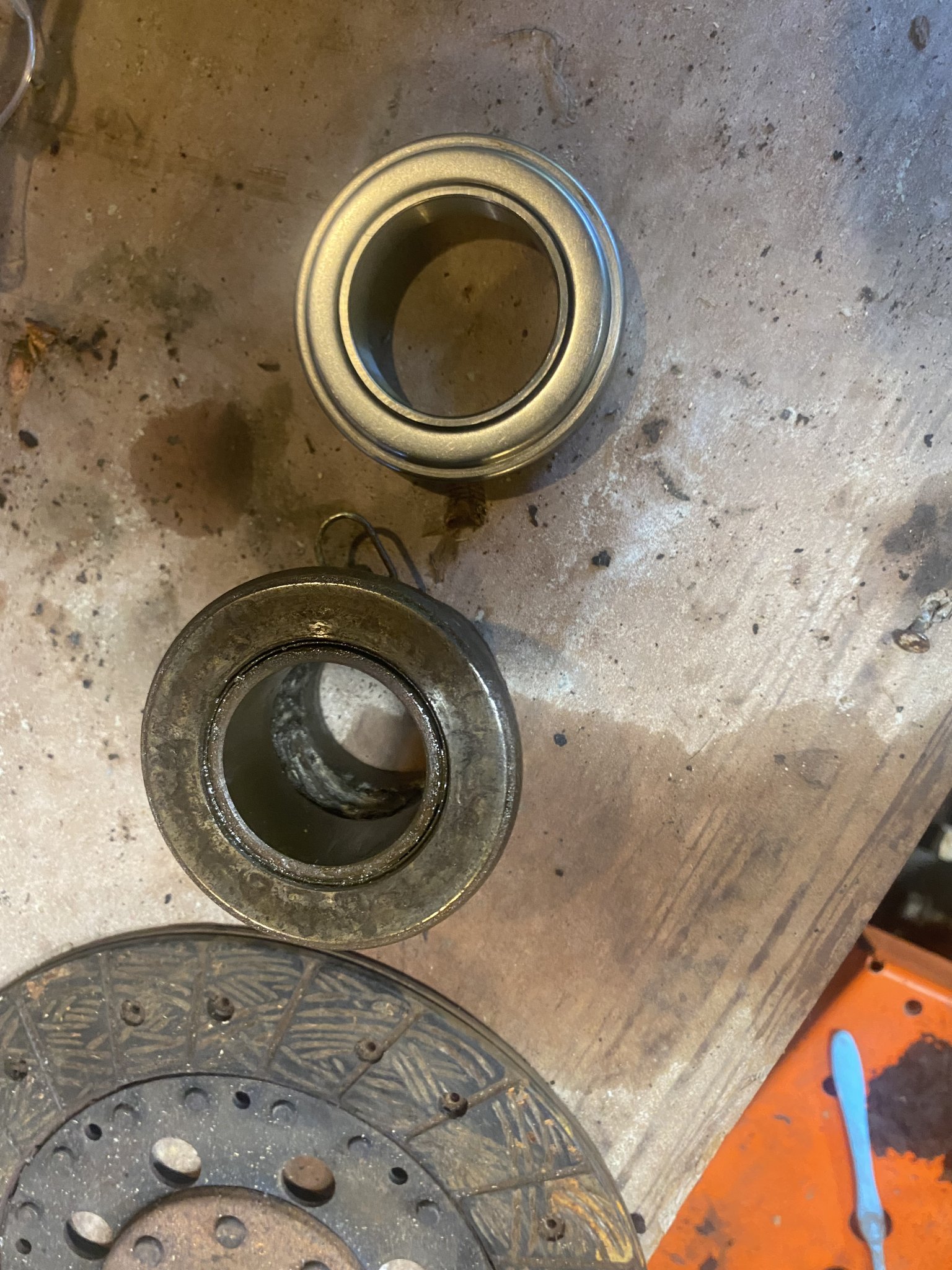

I’m taking this is the one I need the thrust bearing looks the same as the one that came though. Let me know what you think thanks. I included a screen shot of the one I think I need to order vs the one I did order. It also comes with a small ball bearing but wasn’t sure where that goes. When someone was saying throw out bearing that is the thrust ball bearing correct? Also does this need removed with a puller and then pressed on? Sorry for all the questions thanks for all the info.
