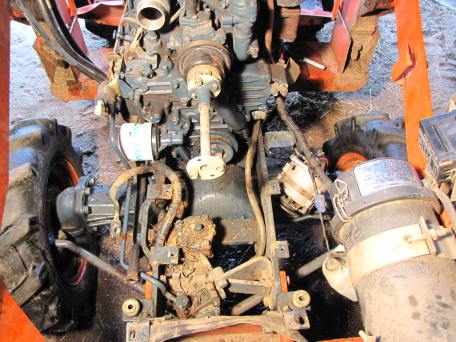

Pan removed. NO sludge build up, NO pickup tube loose. Prior to pan removal a new pump was installed and still NO oil coming to filter or oil sensor. Anyone have any ideas? Time for a hand grenade ? LOL

I don't know the arrangement of the oil pump, but is it turning when the engine turns? Is there a shaft that may have sheared on the oil pump drive?
Just a thought.

How did you replace the oil pump BEFORE you took the pan off?:confused:
