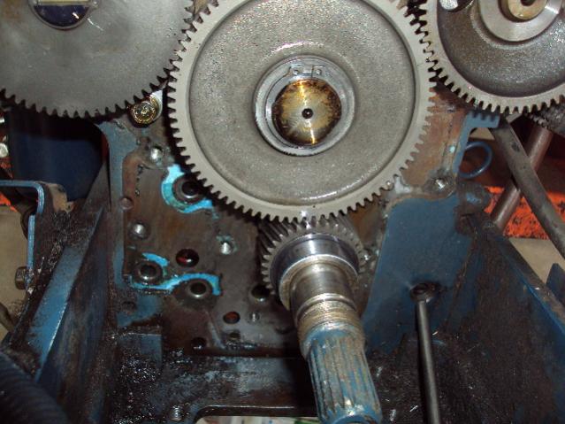

Is the pump the large gear to the left of the center gear???
I see several holes at left bottom of case. Some have threads but there are 2 that I'm assuming are feed holes to the front cover and then to the filter???

In pic pump is off, bottom of crank gear. port for pump, gasket for pump and o rings.

Notice how clean the gears are. NO sludge what so ever. That's why all I did was look at pickup tube and reinstalled pan.
