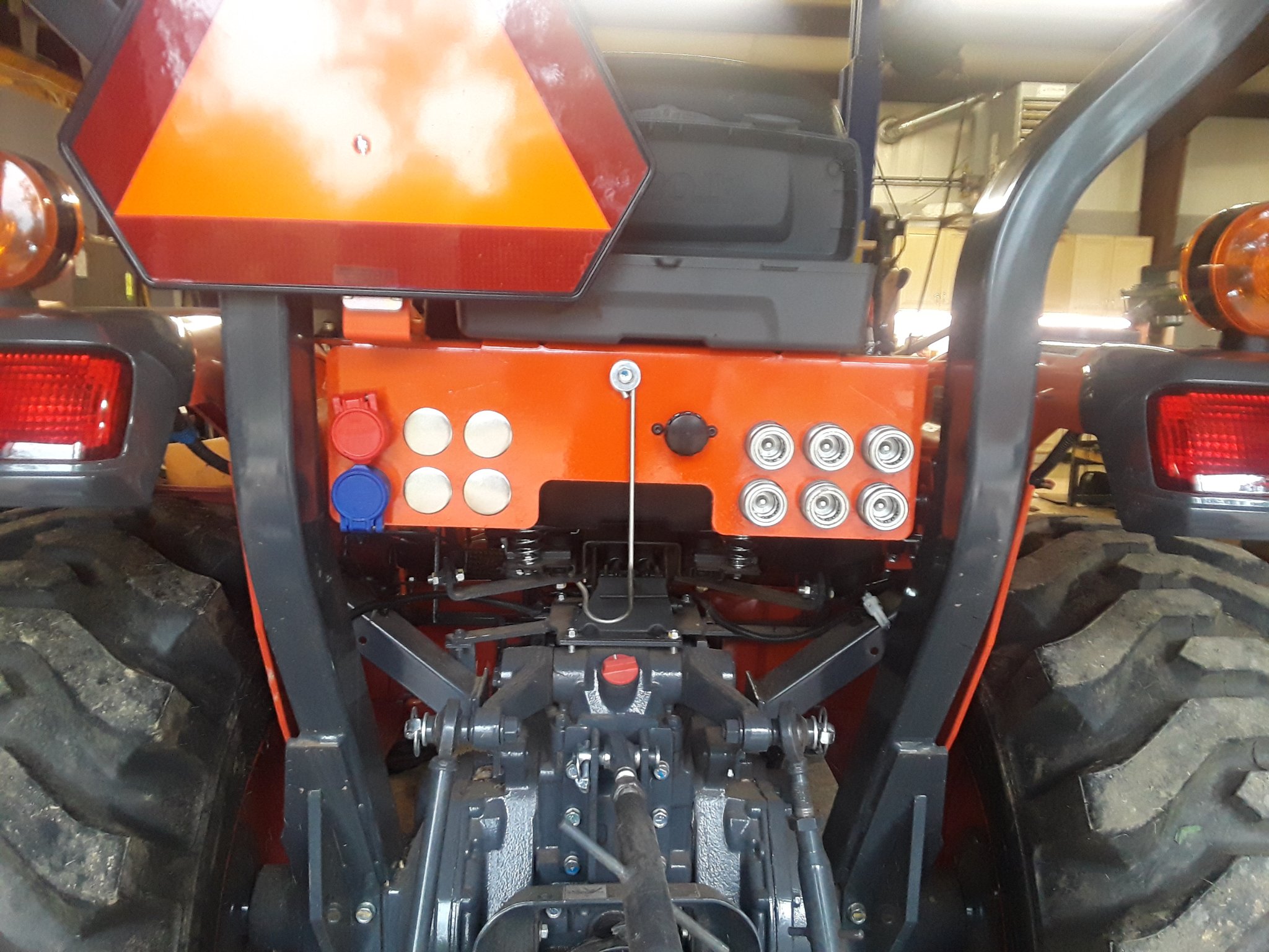

Hope these photos give enough information
I am afraid rhose picture dont help me much. That appears to be some sort of tap into the 3pt lift circuit. But based on your description of the operation you can do better. You want to add a pure pressure takeoff point earlier in the circuit. The front outlet block for loader would seem to be the easiest. Do you know if there is one on your tractor?

Right correct , while operating log splitter , lift arms wont lift .
I think my block is same as the diagram you showed twelve hours ago. i have a cab which makes it difficult to see .
Where on the block should I search for front loader outlet port ?
I highlighted the lever QC to show P and T

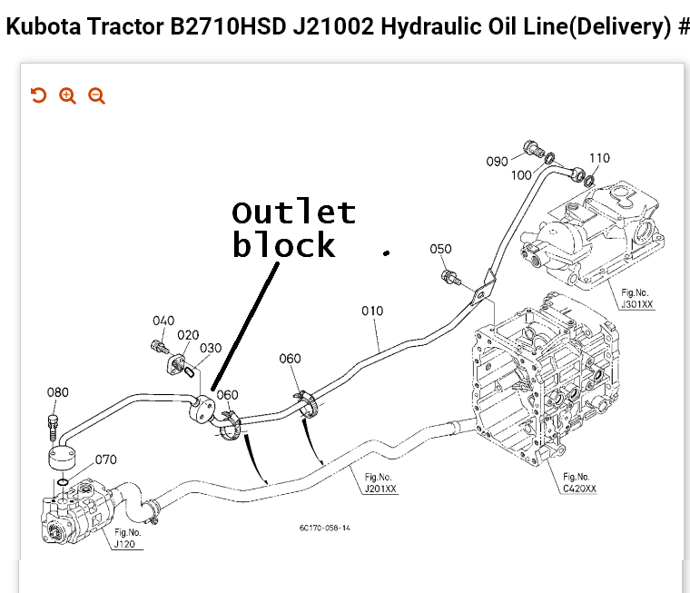

In the US the loader outlet block is forward by the engine. Here is a picture. The operators manual usually details its use. You need to be careful - I don't see a pressure relief in it so you can deadhead the pump and trash it with improper hookup. Kubota got smart with the later models and started putting a relief in the block

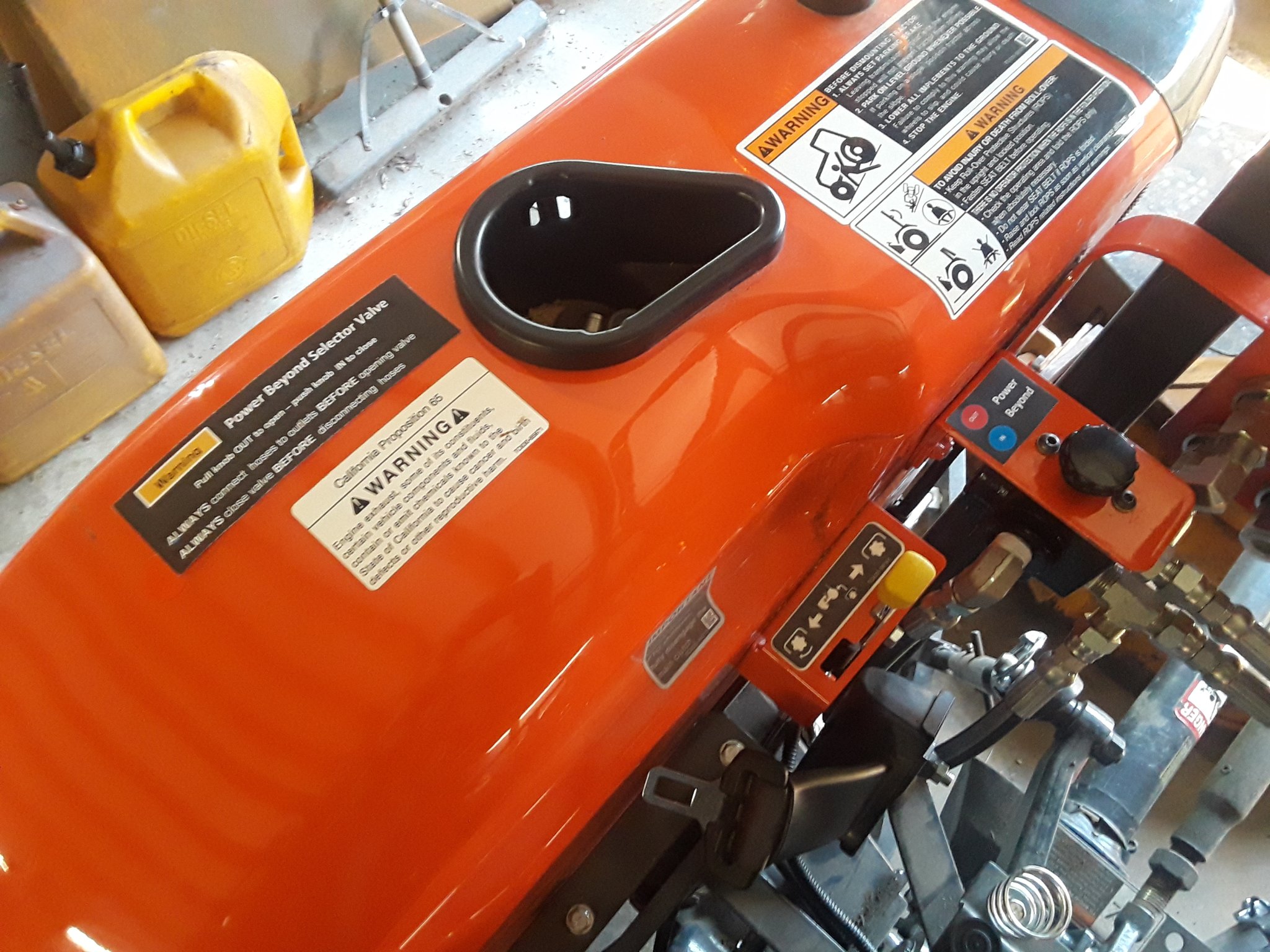

I ran a log splitter of my B7200 for many years using the same sort of setup you have except Kubota made a diverter valve for it so I did not need a bungee. Here is the plumbing on my new L3901. The Red/Blue rear outlets are constant flow and the selector valve (round knob in second picture) is used to direct oil to them when the splitter is connected and to loop it back when the splitter is not connected. Out for rear remotes and in for loop back. Works real well.

Do you have a parts list and/or numbers and a supplier? I'm looking to do EXACTLY what you have done! Down to the selector knob! Have the same tractor as well. That is an amazingly clean set up!
12,734
7,241

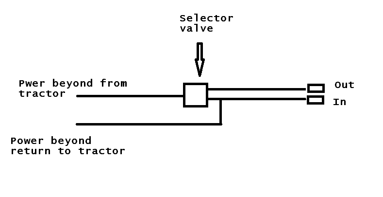

Are you looking for just the log splitter hookup? Its a simple circuit with a 3 way selector valve and two outlets. I can give you a diagram. The hoses and brackets are all custom made by me.

You don't need a p[ower beyond with tank return for a 3pt mounted log splitter - just the following loop. Splitter must be last device in the loop just like a Kubota backhoe. Plug the log splitter into the loop and open the flow. As long as the only load on the 3pt is lifting the log splitter back pressure on the splitter valve stays low enough it is not a concern.
