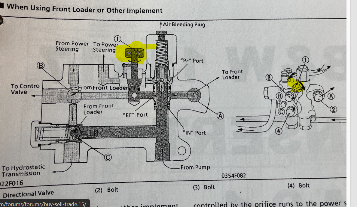

I got the three point to go up and down. If the tractor is moving, when I move the 3-pt up, the tractor stops until it’s all the way up and the tractor moves again. 3-pt going down doesn’t seem to make that much of a difference. On medium speed, the tractor moves only on flat paved surface. On high speed, the tractor moves at times but only in the garage on flat concrete floor. This is frustrating!

Turn this valve a 1/4 turn and see what it does to the operation.

I bought it as is unknowing the condition. I heard the engine run and I know the clutch was bad and it was leaking from a seal on the shaft. The clutch and the seal has been repaired by the dealer. I do remember we had a hard time getting in the trailer, but I assumed it was the clutch. It had been sitting for a long time. So should I open the valve all the way and then close it a 1/4 of a turn or close it and open it a 1/4 of a turn? The loader is not on it and I have the loop connected.

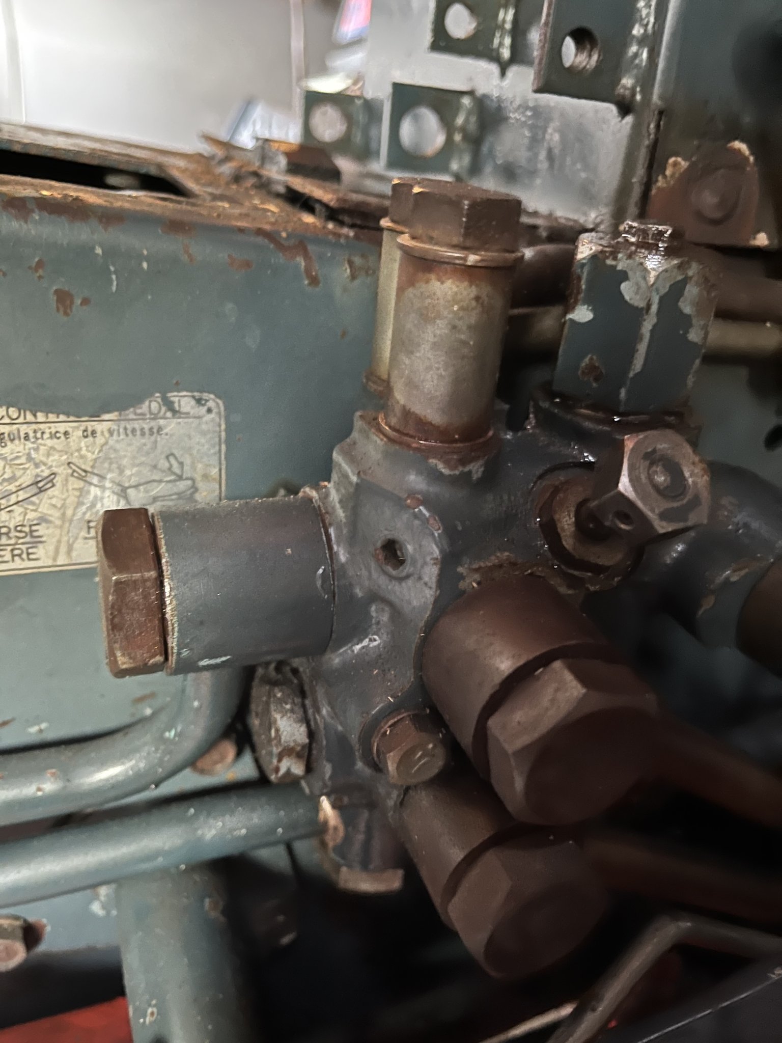

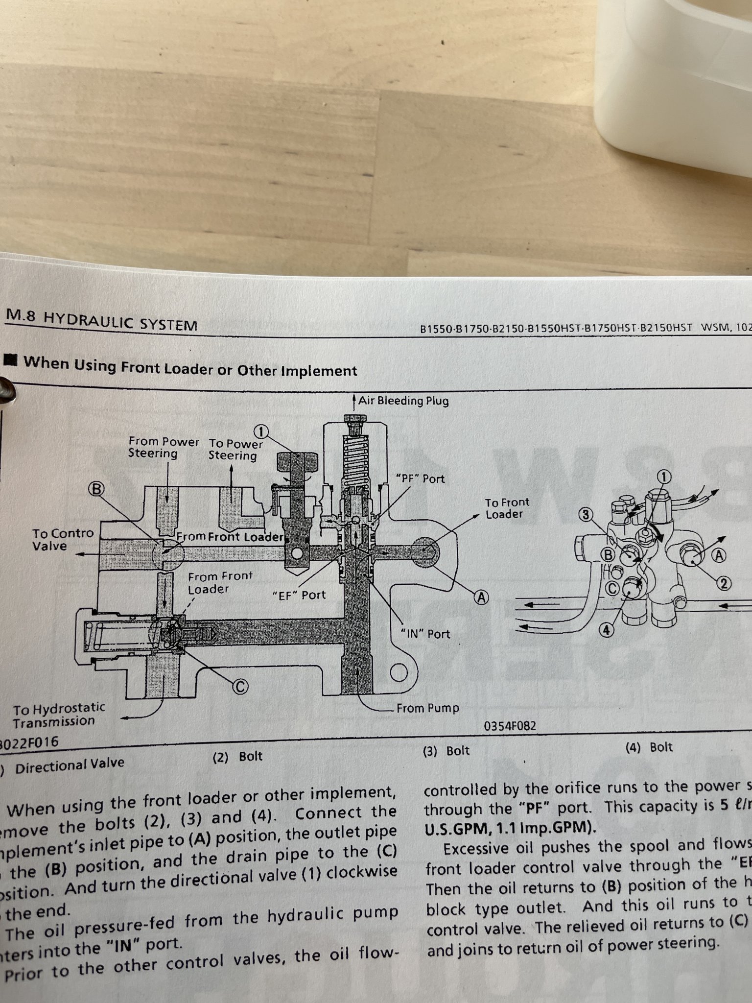

The selector valve only should turn 1/4 turn, there should be stops (roll pins).
It turns off the loader loop and makes the hydraulics take a direct route to the three point and HST.
When the loader was on and working, was it strong and fast?

It runs and acts the same way no matter what direction I put the selector. I also unscrewed the air bleeder bolt and a small amount of air came out before hydraulic fluid flowed out but runs the same. The hydraulic cooler in front of the tractor looks “newer”, does that have a bleeder bolt/screw? I can’t find one and I’m thinking maybe air is trapped blocking fluid flowed? Is that possible?

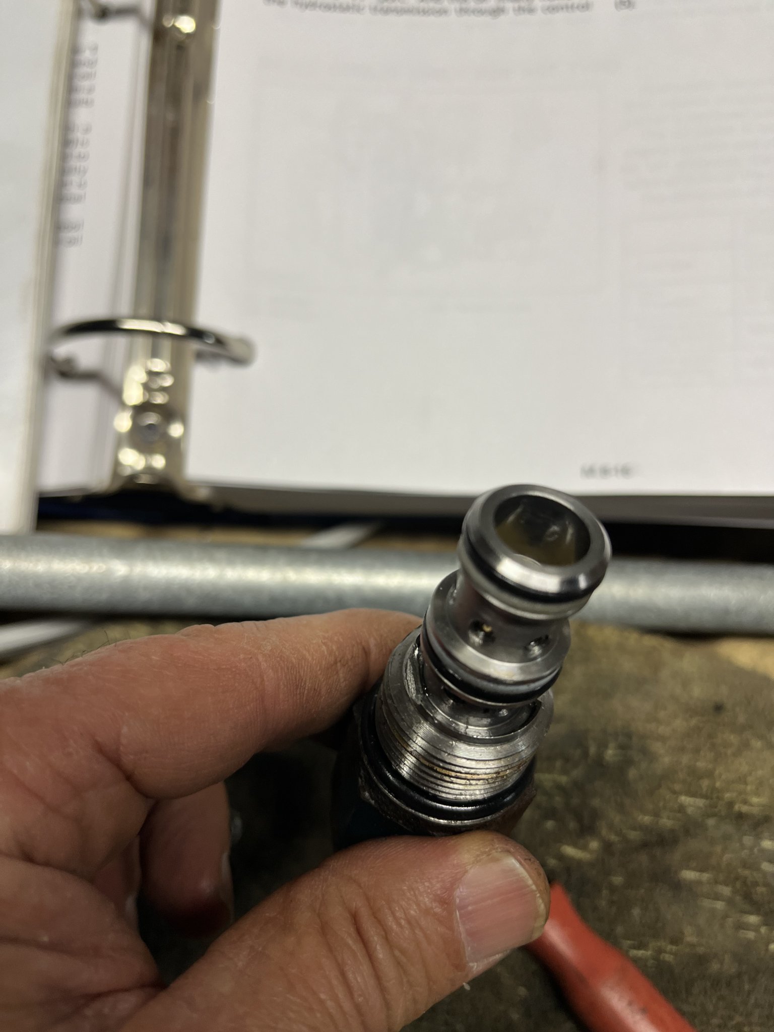

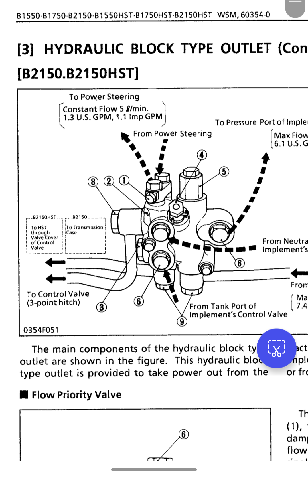

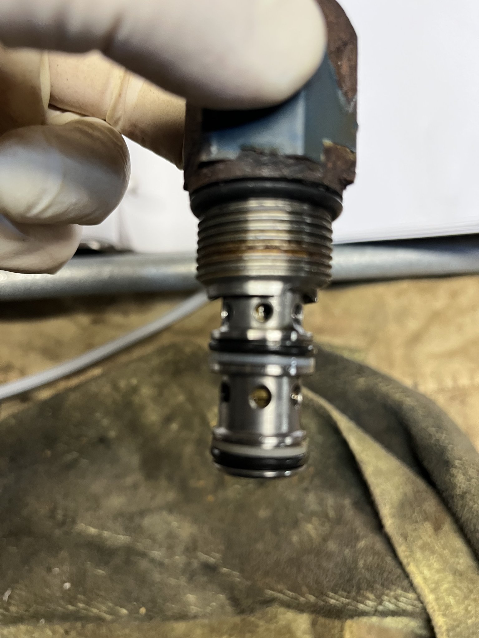

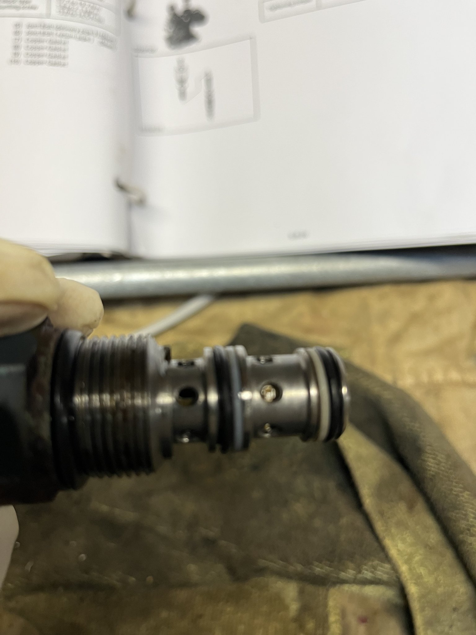

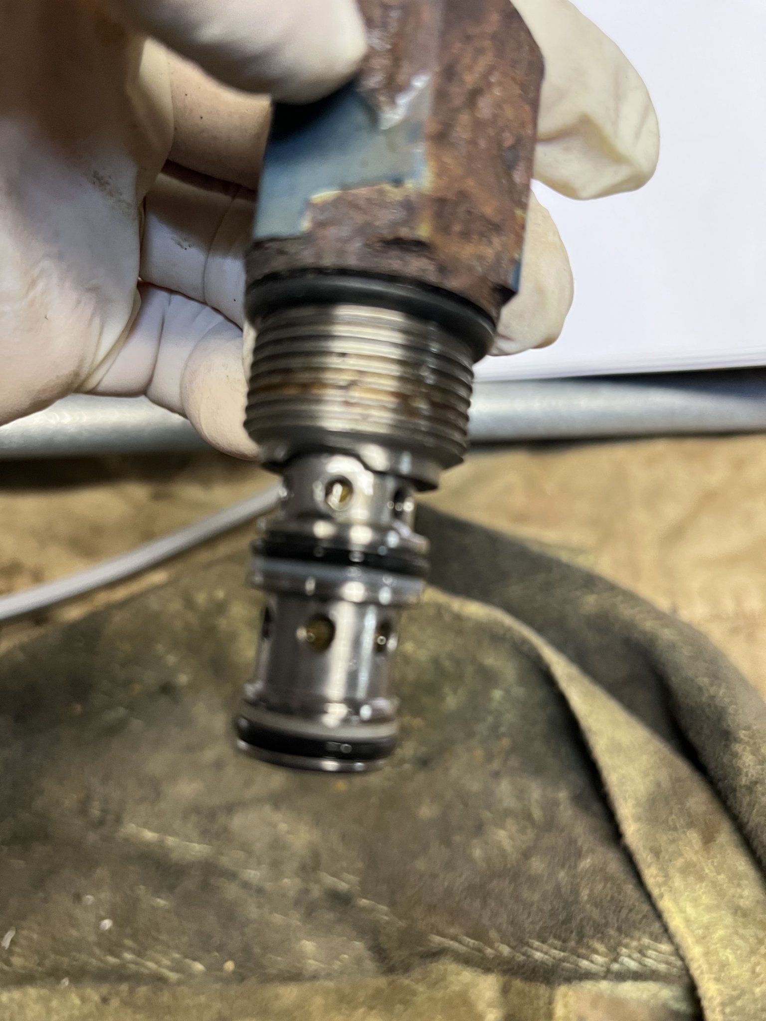

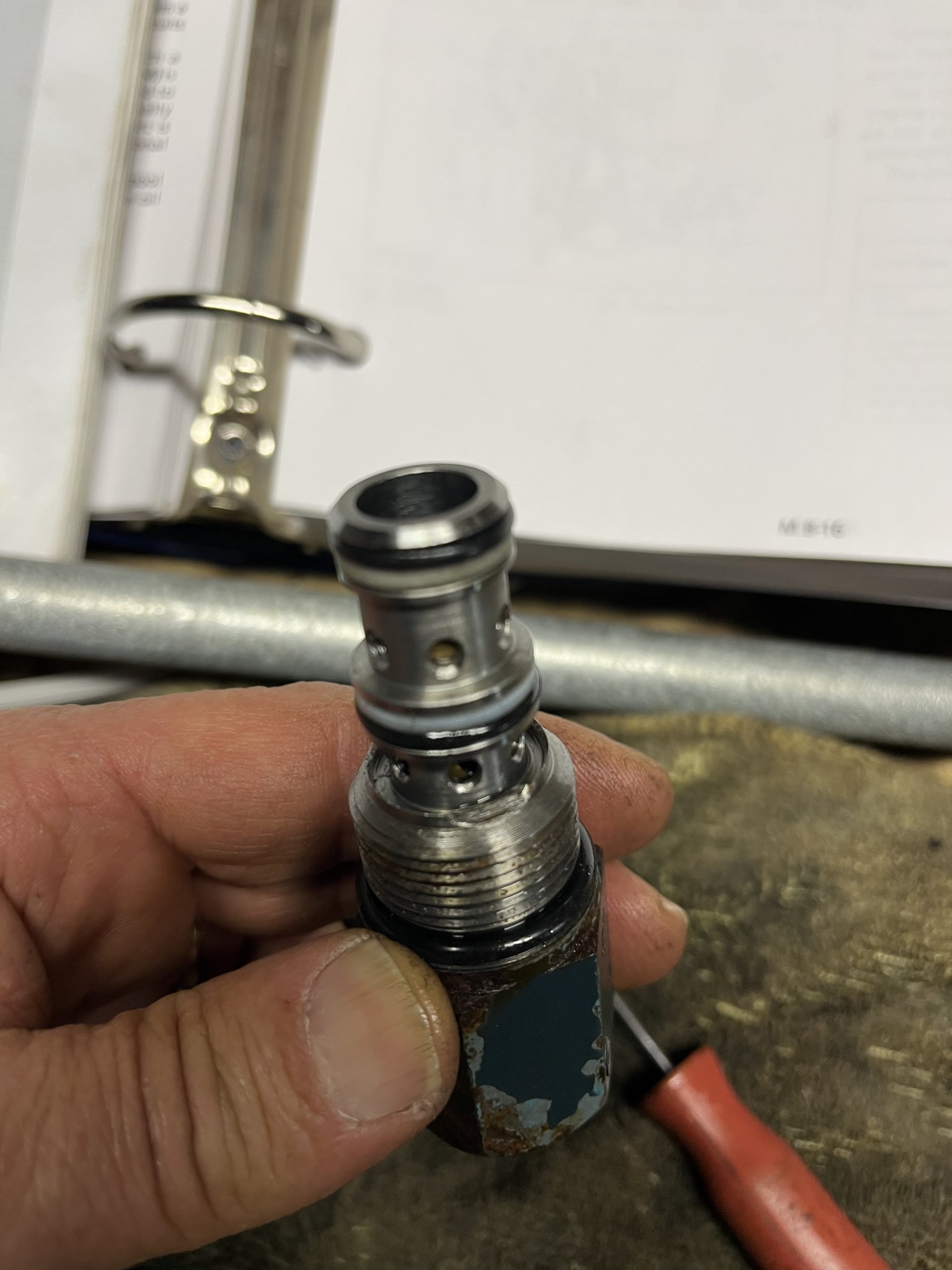

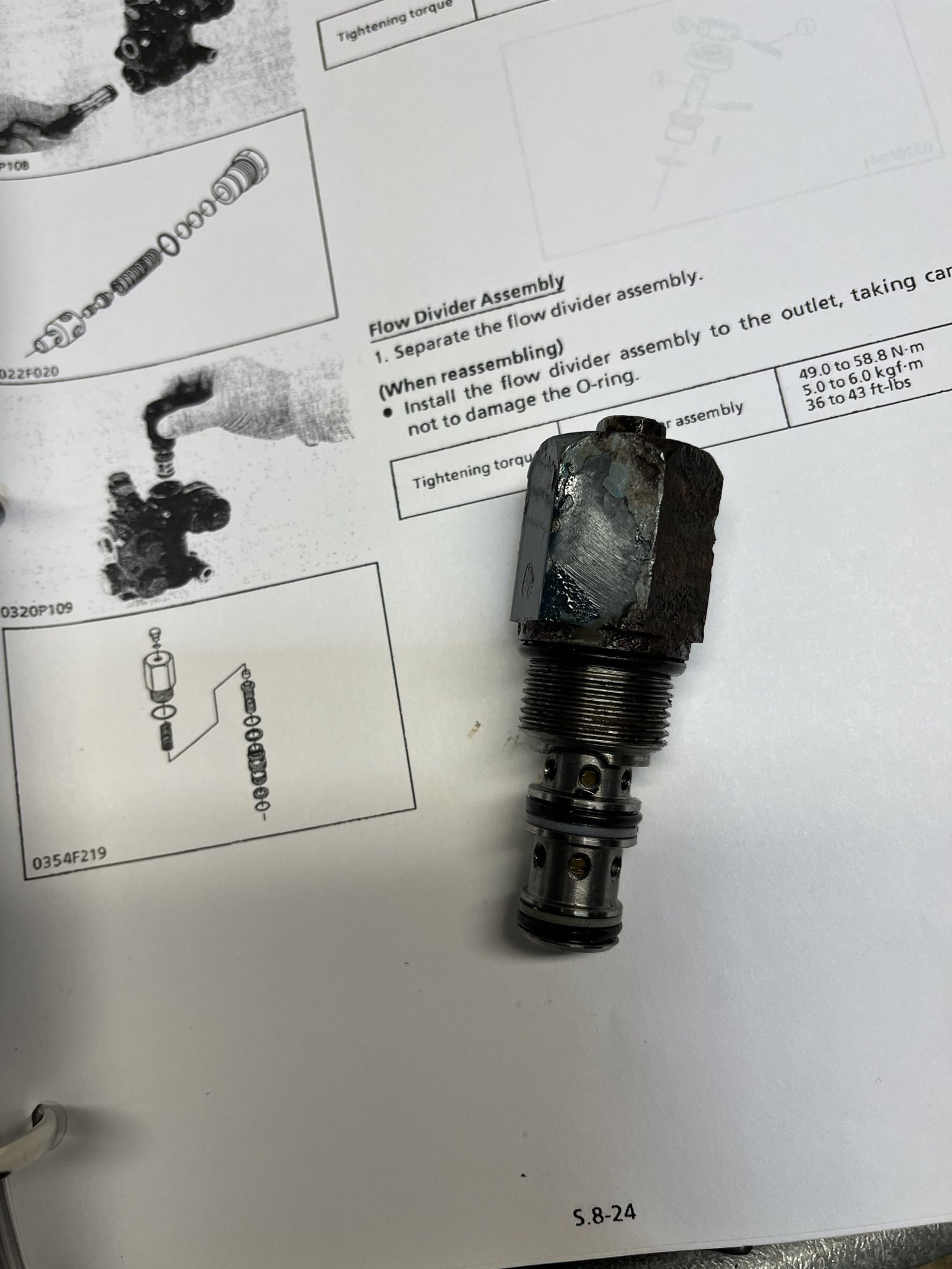

Is there a spring and poppet in there? I think that's the orifice in the poppet you're showing in one picture.
Nope. Just what’s in the pictures. The WSM doesn’t seem to show a spring for the flow divider assembly. Unless it’s in the middle of the assembly but I can’t get it apart. They bend some of the edges to prevent it from coming out. IMG_9367.jpeg IMG_9366.jpeg

Nope. Just what’s in the pictures. The WSM doesn’t seem to show a spring for the flow divider assembly. Unless it’s in the middle of the assembly but I can’t get it apart. They bend some of the edges to prevent it from coming out. View attachment 153342 View attachment 153343
Ah ok, I was wondering why it stayed together. Yes the spring and poppet are inside there, looks like the poppet is brass? With no flow, the bottom holes should be blocked by the poppet. I can't really tell from the pictures. Is the orifice hole open and clean? Can you stick something in the bottom to compress the spring and make sure the poppet is free to move? When you reassemble it, I'd use new o-rings. If it still doesn't work, you could remove the line to the power steering/hydrostat, start the tractor and measure the flow- should meet spec.
I think there's a relief valve in the transmission that could also cause the problem. I'll go look.

I was able to compress the spring and I did clean the whole assembly, as much as possible since it doesn’t come apart. I changed the o-rings and sadly no change. The only thing I noticed is that the holes on the top row don’t all align up with the inner “thing” where all the holes are open.
Can you remove cap 1 and catch the flow to measure it? Should be 1.3gpm.
