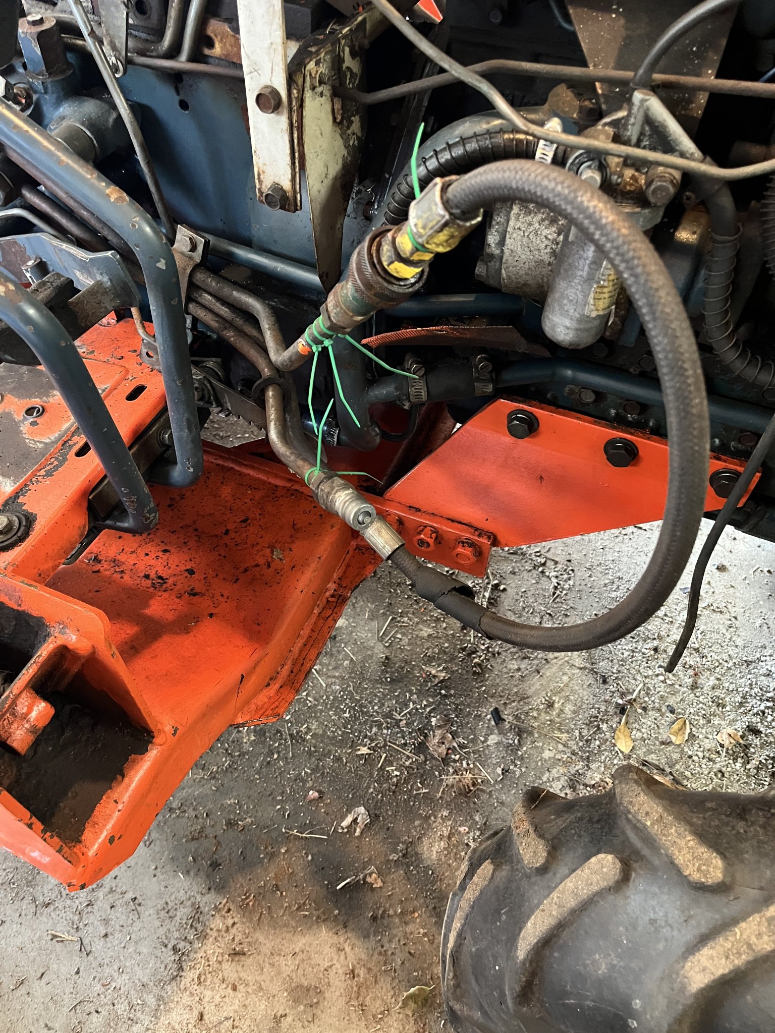

I’ll send a picture of the loop when I get home and run those tests.

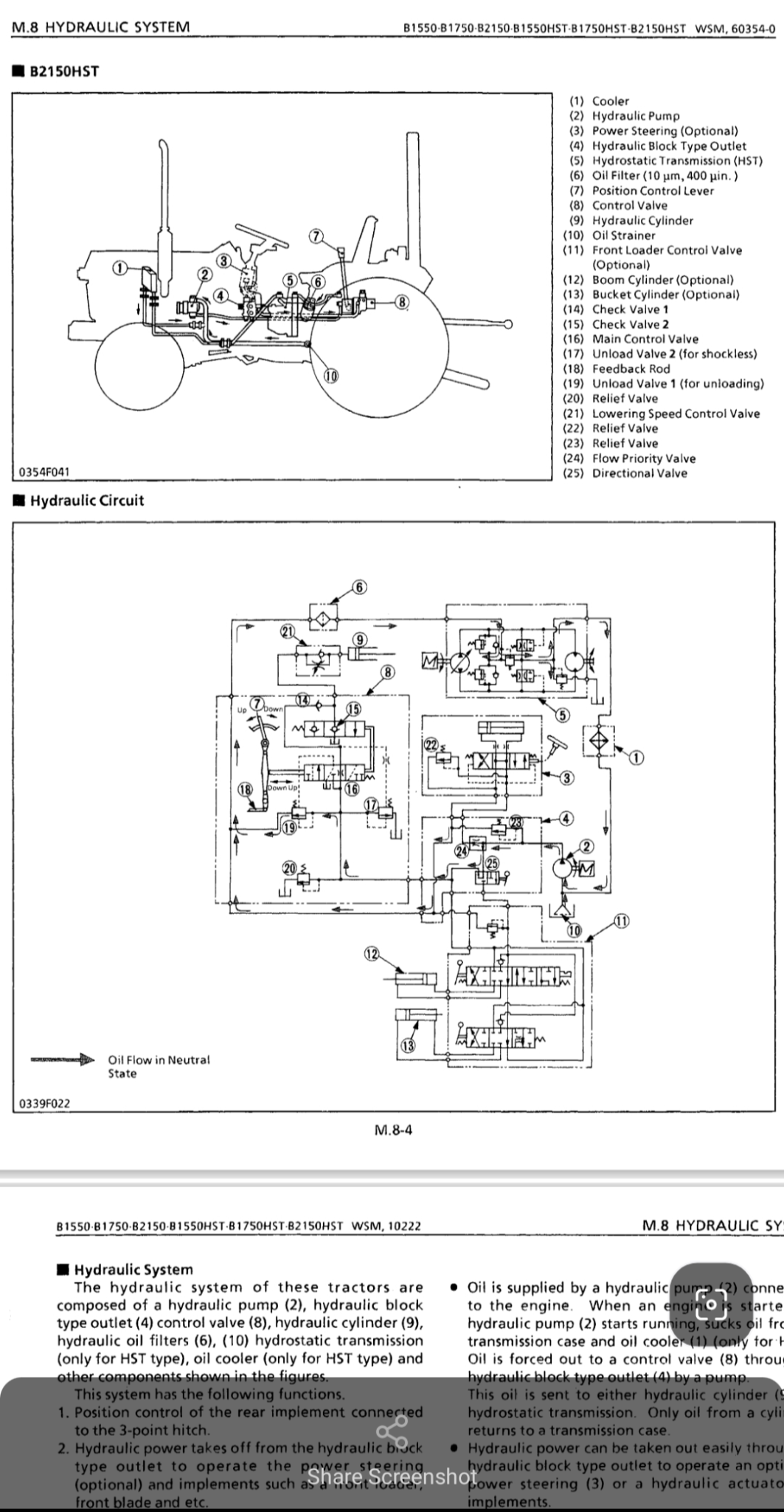

Wolfman's right, of course. I was going to warn OP that the WSM covers several models, and there are some subtle differences. Then I fell into the trap, the figure below shows two strainers and a separate charge pump, but it's not for the 2150. The correct diagram also shows why the other hydraulics interact with the hydrostat.

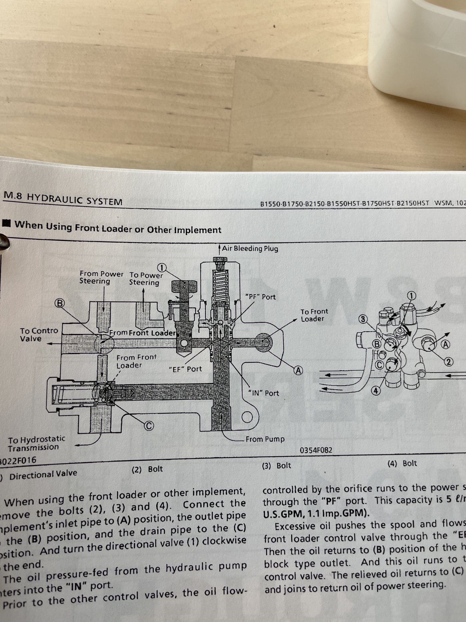

That sounds like the priority valve isn't working right. I've included the hydraulic flow diagram for your B2150HST, and I must say it's one of the most complex.
Inside the hydraulic block 4, is the priority valve 24. Its function is to route the first flow (higher priority) of a certain amount to the power steering and on to the hydrostat charge. The remainder is available for loader, 3ph, etc. If the priority valve isn't functioning, the flow can take the path of least resistance which apparently is the unloaded 3ph. The power steering and hydrostat are in series; that's why I asked if PS also quits
The priority valve consists of a spring loaded plunger and restriction orifice. Maybe it's propped open with debris or the spring broke. The WSM shows the hydraulic block, but it uses the same figure for the models with and without the priority valve, so it's confusing to me. Hopefully, by looking at your block and comparing it to the WSM, you can remove the priority plunger and clean and check it.
Edit: I didn't mean to jump in Wolfman's way. Reading back, I see he had OP working in logical steps. He probably has a better plan.
does the flow priority valve just unscrew?
