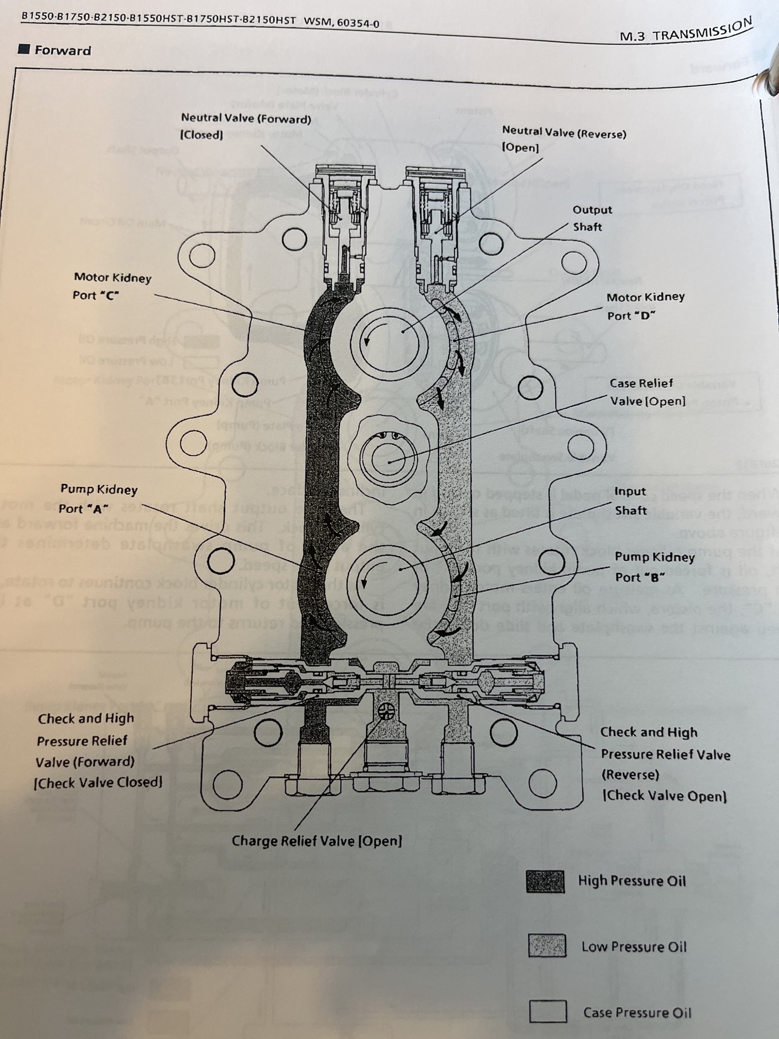

Can I unscrew the check and high pressure relief valves and the charge relief valve to inspect them?
If you can't test the relief pressure, take it to the dealer and have them do it. The relief valve doesn't come out that way. That view is of the end of the relief valve.

The charge relief is only able to be removed from inside the case. The charge check/high pressure relief can be removed but unless you see something visually wrong there is no way to determine of the are faulty. If the issue is with a check or high pressure relief it is generally in one direction and not both. And if there were an issue with a neutral valve it would also likely be one direction not both.
