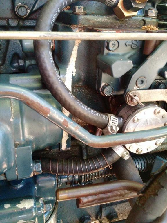

OK, went to Kubota and talked with the service manager(Great guy, his name is Joey and is the manager in Kubota at Plant city Fl...strawberry capital!) He told me that the tractor must be losing prime in some of the rubber hoses connected from the bleeding valve in the top of the lifting pump). So went to auto part store and got some fuel lines and replaced some of the lines, also got a new bleeding valve and replaced it( when I was tightening, broke the banjo screw and need to replace it{carefull!! Kubota doesn't make it anymore...got last one at the store after searching for a week}) also empty the fuel tank(for cleaning), replace the fuel filter and fuel lines. Now I got fuel at the fuel filter, got fuel at the entrance of the lift pump and at the end(pump bleeding is pumping) but a can not get fuel at the injectors. Cracked the nut and ....nothing!! no fuel. How long I have to crank the starter for the fuel bleed at the injectors? Also, before I sprayed DW 40 at the manifold and the tractor will start and run, but now is not getting fuel. How can I bleed the top lines? The bleeding Cock valve is different, should it be open or closed? Thanks in advance.

All the lines have to be tight, air tight. The banjo bolt you replaced needs a copper washer on each side to seal it. The throttle needs to be at maximum fuel when bleeding air out to get fuel to injectors. Have nuts at the injectors loose a few turns so air can escape. Turn engine over in 20 second burst, then wait 20 seconds for starter to cool, so it doesn't overheat. May take 5-6 attempts to get air out. Patience required!!

Wolfman, I use the auxiliary tank, as you told to do, to directly sent fuel to the injection pump cracked the lines at the injectors but...no fuel. Can I remove the manifold(needs to be done?), remove the fuel lines at the injection pump(nuts very close together, needs to use crowfoot wenches?), to see if the injection pump is pumping fuel?? Difficult to do? advisable? Thanks.

Do you have the ability to take some pictures, like from a phone?
If so let me see what you have and then I can walk you threw some other steps to do before you remove the lines or the pump. ;)
If you can't post pictures on here send me a message and I'll give you my contact info to help out further.

Update, I managed to bleed the lines to the injectors(lose banjo at lift pump) and the tractor started!! but if I turn the key off, it will not start if I don't spray the manifold with starting fluid (i mix it with DW40)also needs to be in 2000RPM or higher if not tractor will stall!!! But it's running
