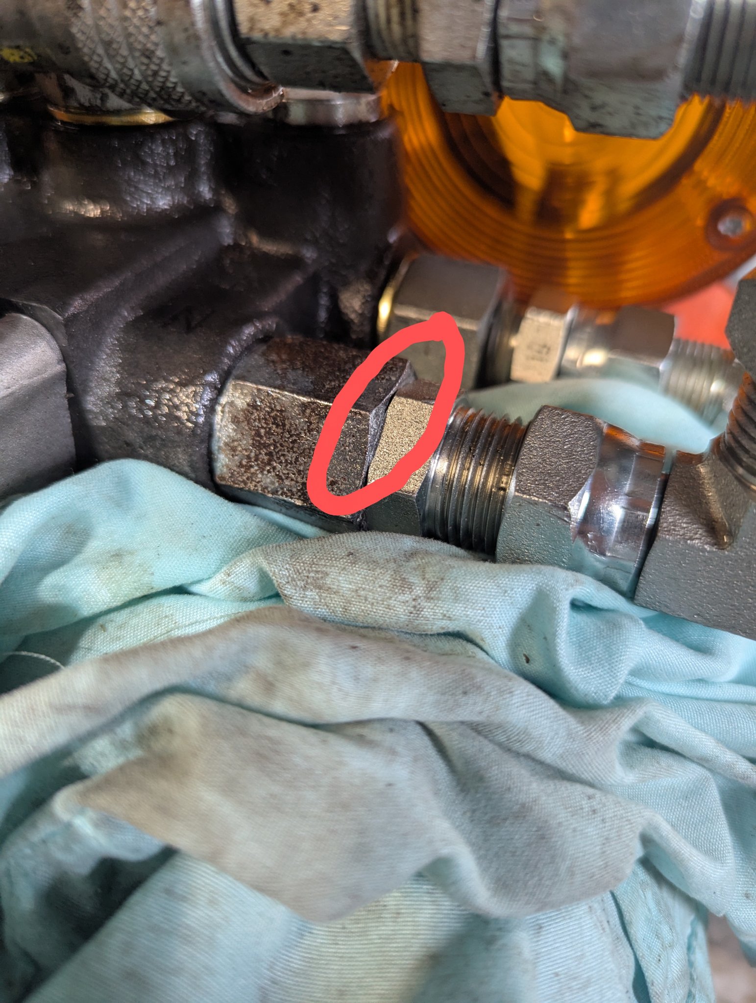

But I get a leak from there:
That's the section between the PB sleeve and JIC fitting. Am I supposed to have a seal in there? I noticed that the sleeve goes deeper than the lenght of my fitting, so it wont press against the bottom. So am I using the wrong fitting or am I supposed to have a seal in there?
If the port in the sleeve is JIC you dont need a seal.
If its BSPP you need a sealing washer.
What say the company that sold ypu the valve?

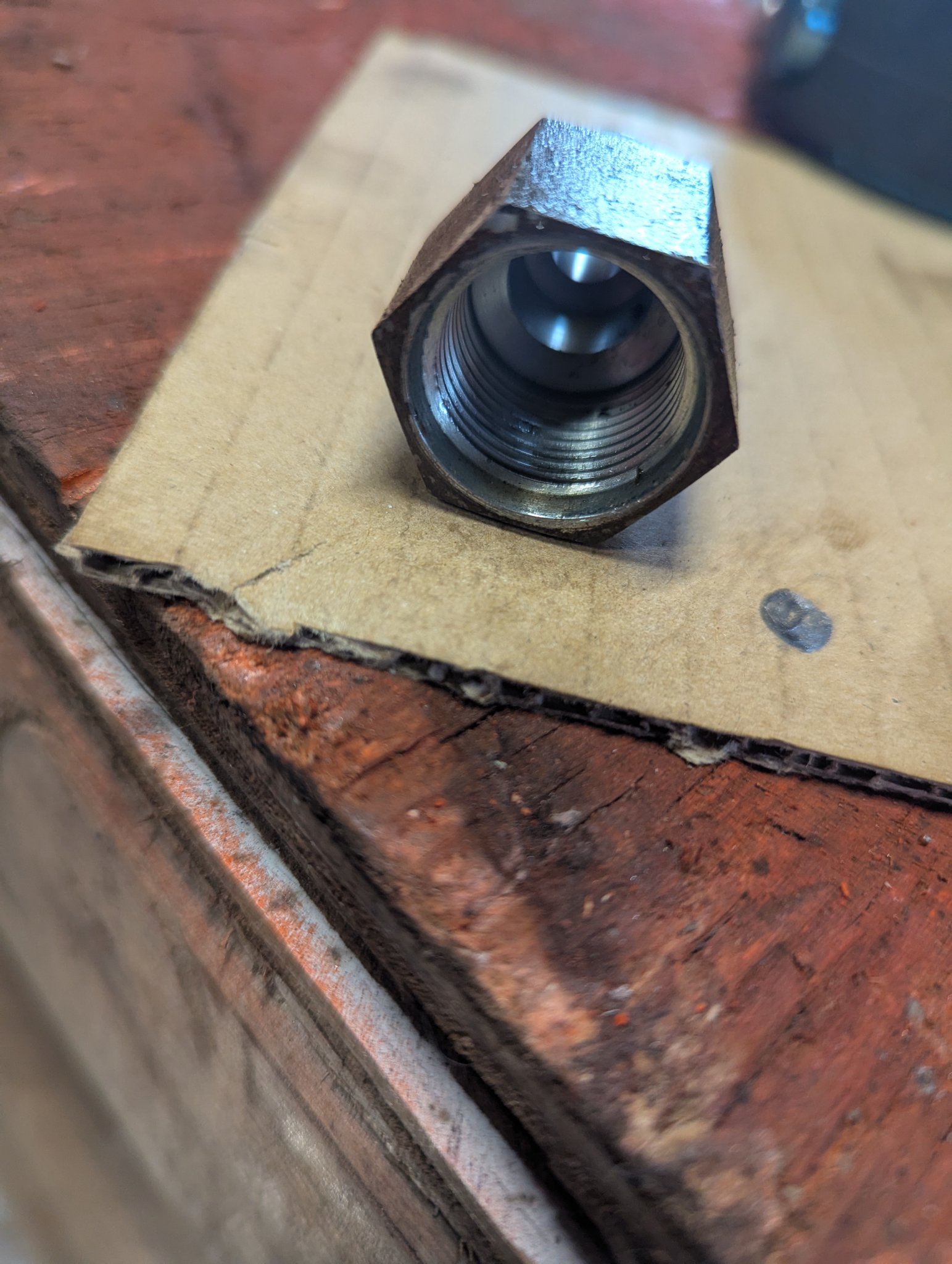

I got it from princess auto. The inside looks like this
Really looks like a female JIC but much longer. So way the fitting can touch the bottom of the sleeve

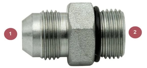

So end #1 is "sae" ? And I need an oring?
My fitting looks like that except that end #2 is npt for me

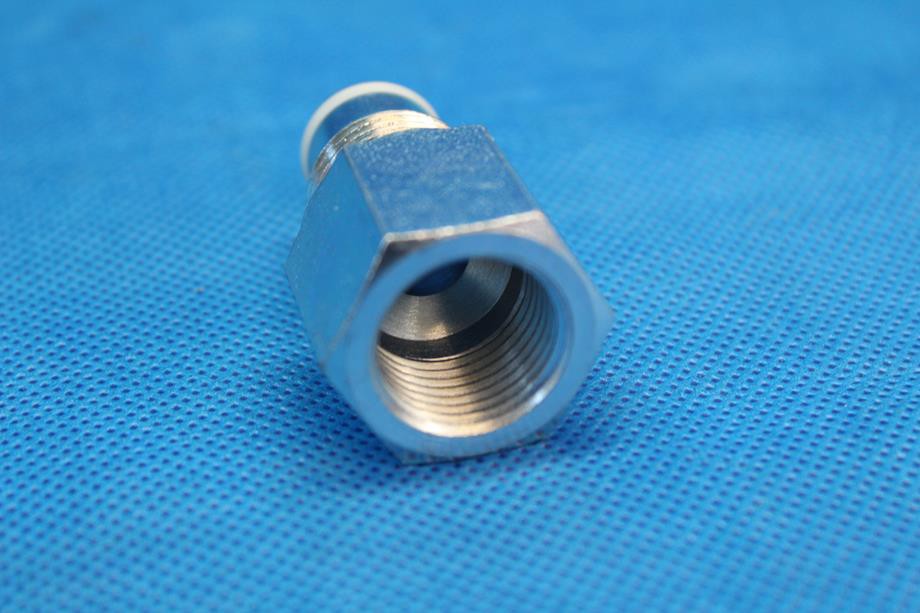

I'm sorry, I'm confused. Which part goes in the sleeve? The SAE?
My valve has G1/2 ports. I have bspp-M to npt-M adapters on the other ports.
I want to connect a npt-m hose on my PB port.

I suspect the female port in the PB skeeve is SAE oring boss. Same thread type abd size as JIC .If your hose is male NPT this would work

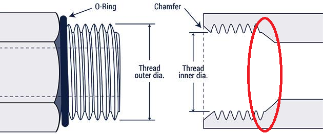

Ah, now I understand. Thank you.
I just looked at images of SAE oring boss and yess, it does look like that.
What confused me is that this section looks like JIC
