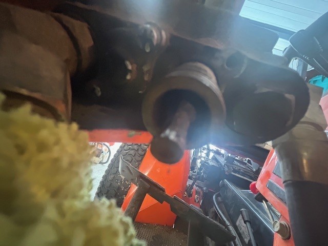

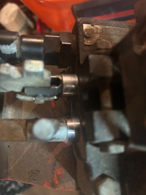

Dan - see pics
Neutral Position
Activated Position (it does somewhat appear that the loader spool is not going in as far as the bucket spool)
Retracted Position
Well its moving which was my main concern. There should be two positions when you move the lever to lower. Can you push it into the second posution? It takes a little force to get past the detent.

Either your pictures are wrong or something is a foul with your linkage, as 2 pictures are the same spool position.
And if your only moving one spool the other is moving too. :unsure:

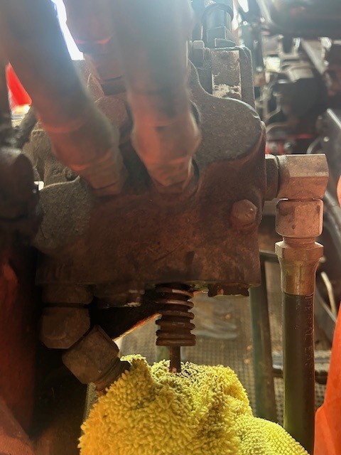

Back at it again...A local tractor guy told me to remove the spool end cap and that it is likely the set screw that has backed off loose (said I would need an allen key to tighten). I have removed the end cap and can see the spring...but not sure where the set screw is located? Is there a service/parts manual that shows how to disassemble?

Put it back together before you break something. Have you determined the spool is or is not moving the proper amount?
11,522
6,548
Yes...I have determined that the spool is actuating in and out and appears to be the proper amount...goes in as far as allowable.
Then there is absolutely no reason to have that cap off. Put it back on and turn your attention to checking flow into and out of the valve.
