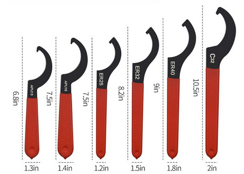

I used my spanner wrench (adjustable) to wrench on motorcycle shocks. It's come in handy on many applications.

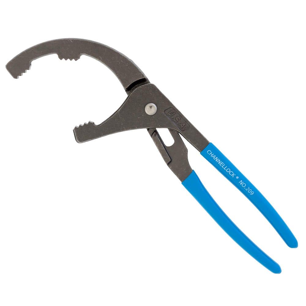

@Dustball : I've found several wrenches like your photo, but their smallest limit is 2-3/8 inches or more. The fuel filter outer ring is about 2-1/8 . Anyone seen a different smaller size?
"without squeezing it at only two points." is the main point. Strap wrench meets that I think..
That particular one goes down to 2-1/4" which is too big.
This one goes down to 1-3/4" and may be in stock at your local Home Depot for you to physically look at before buying.
CHANNELLOCK 209
