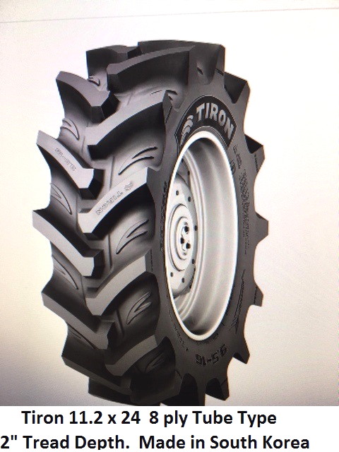

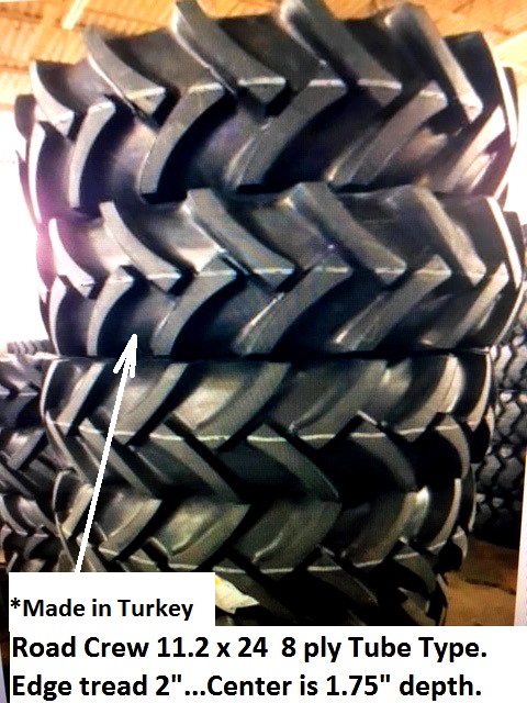

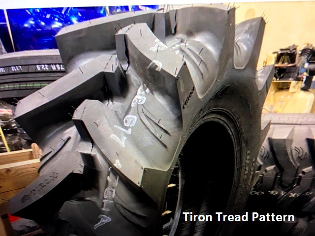

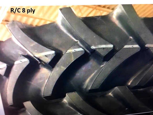

It is time for new rear tires on my L2350DT. But I have a few questions first...perhaps the members here can help me with.
A little background info on the tractor and its usage.
Its a compact tractor (25 hp), 4wd, gets no more than 50-60 hrs use a year (at most).
Tractor is 27 years old and is just now about to turn 1,000 hrs use. I use it mostly where my bigger tractor won't fit (down in the woods, between trees or for quick projects not requiring more HP).
My property is mostly Sandy Loam soil BUT I also have some wet, muddy spots and this is where the smaller tractor is most apt to have to go. With that in mind.....I am thinking I'd like to have a tire with a pretty deep tread.
BUT.....I don't know if I will regret that or not. The two tires I am looking at right now (open to other suggestions) both have tread depths of about 2". Plenty deep enough for mud and soft soil, but I also go across exposed roots sometimes, on occasion gravel roads on the ranch.
I am judicious in how I drive the tractor and try NOT to spin the tires. However I am wondering if the deeper treads are prone to 'chunking'. They won't do me much good if they tear away.
Both tires am I currently looking at are the same price, both 8 ply, both tube type, both same load capacity, but they have different tread patterns.
Looking at these, is there anything about one over the other that would make you choose that tire (or stay away from it).
Thank you in advance.

I‘d go for the Turkey-Tread myself.

That one appears to have more tread surface area overall and certainly through the center, but doesn't look like it would 'self clean' in mud as well....but who knows.
I am on dry (though loose) ground MUCH more than I am in mud....but I really, really need to make it through the soft spots.
I'd wager the Road Crew (Turkey Tread) would last longer, but hell.....either one is going to outlast ME.
So I don't know. Would like to hear your reason(s) for preferring one over the other. Thanks.

Tie breaker - which one's cheaper :p?
The bars on the Tiron look really tall. I think the Turkeys will ride smoother on hard surface. Spin 'em fast enough they'll clean out!

Either should do well in mud/loose dirt.
Turkey likely would ride better if you ever road it. Looks like a pretty typical agricultural R1 like I’d see on a tractor in this area. Quite similar to what we had on the right rear (left rear was a R1 but different pattern) of our 9N except not half worn out.
Korea may not technically be a rice paddy tire, but it’s getting close. Might limit your speed roading, and it’s likely to tear up the ground more than the Turkey tire. But it’s also likely superior in a swamp.
Unless the manufacturer is using very poor quality rubber compound, I wouldn’t expect either of them to chunk out or rip lugs off.
Comparing the two for mud shedding ability I’d suspect they’re similar enough the amount of sidewall flex has more to do with any differentiation than tread pattern. A R1 style tractor tire should have a pretty flexible sidewall. If one is a radial and one isn’t, I’d lean toward the radial for traction and mud shedding although it may not make a huge difference on a machine that size. Running tubes, you should be able to keep pressure low enough to keep them squishy for more bars on the ground and better mud shedding.
Depends on what you want. Max performance in the swamp with more damage to the ground and potentially limited road speed = Korea. Good (but not as good) performance in the swamp with a bit more balanced all around performance = Turkey.
Just an opinion, but that’s what you asked for. 🙂
